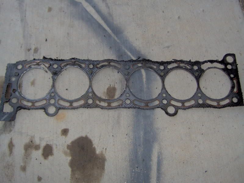

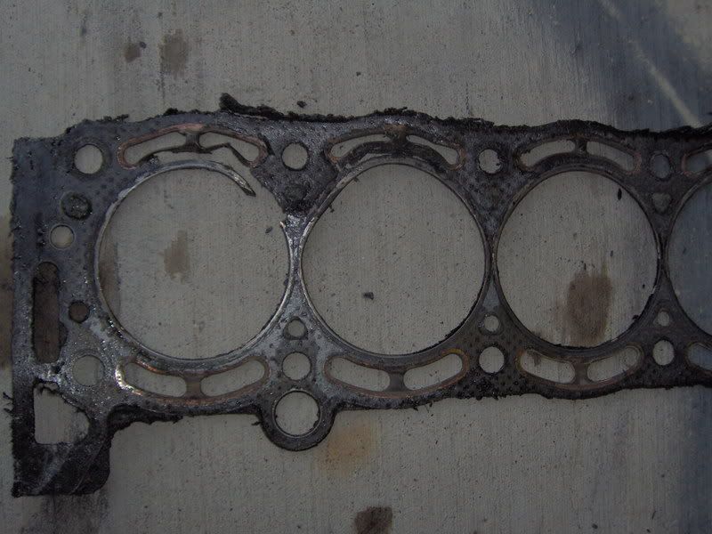

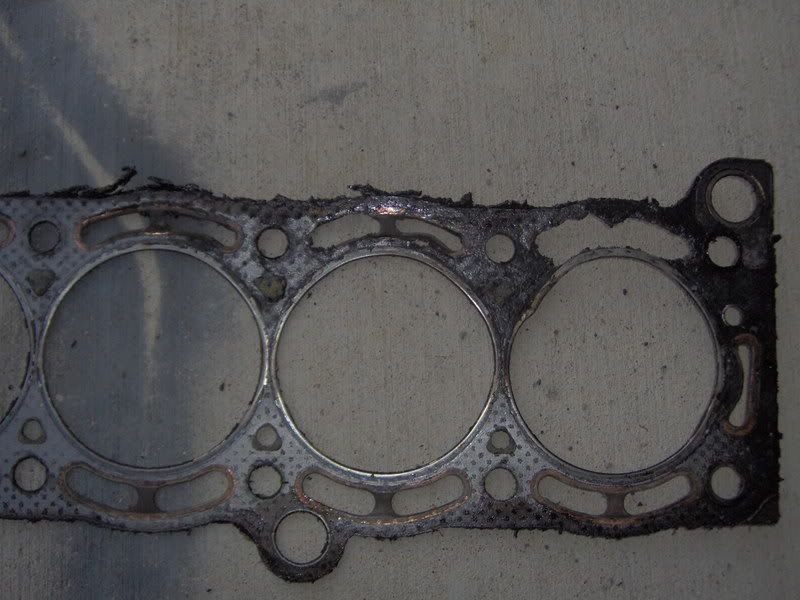

Today I got the head off. Most of the head bolts were scary loose. I think only the number 9 bolt was hard to break.
The headgasket pretty much fell apart when I pulled the head off. It was definitely blown. I don't how the car ran so well. Ok, here's some pics.

Jeez thats some nasty looking HG Looks like I see 3 places blown lol.
I cleaned my block with carb spray and light bristle brush. I used a plastic paint scrapper to take off any large spots of gunk. Just don't scratch the surface of the block. Get it as clean as you can and I cleaned the cylinder walls and piston heads. The carb spray does pretty good job of eating carbon deposites. You can also spay some on it and let it sit for awhile.

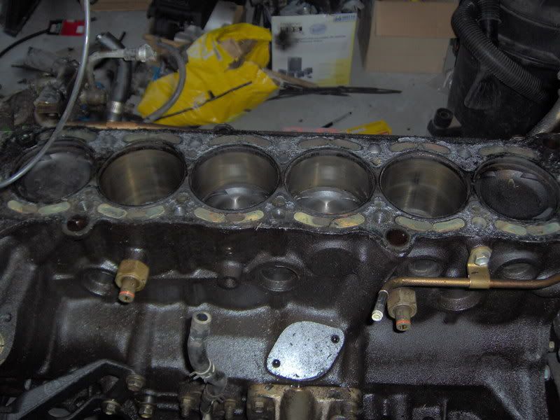

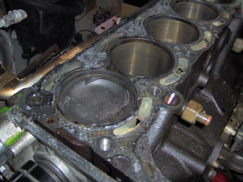

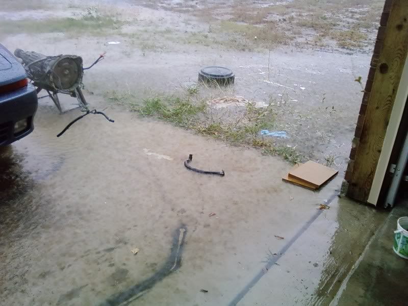

Today I took the head into the machine shop. Not feeling very confident about it. Some of the valves had enormous amounts of some kind of build up on them. White crusty shit. They are going to pressure test it and resurface it. I really don't have the money to do a rebuild on it.
So after dropping off the head, I went back to the house and started cleaning things like the lower intake, the hard coolant pipe that wraps around the block, the tranny wing brackets, valve covers. I also took a gasket scraper and started cleaning the deck. There was a lot of carbon build up on top of the block where the fire rings had shifted. I also found a pretty big pitting area but it should no affect anything as it's by one of the water jackets.
It started to pour down rain and lightning while I was there. Then it started flooding. Water began gushing off the hill in the back yard and down under the car. I left a lot of bolts under the car from undoing the tranny mount and such. I fear they are washed on down the driveway never to be found again. Soooo I may need to find some bolts. :3d_frown:
Another kick in the ass is that the fan clutch is bolted down so fucking tight that I cannot get it off the water pump. I doesn't help that the corners of the four nuts have already been partially stripped. So I'm going to just buy another waterpump. I've also got another pump pulley and will just need some studs. I've already put the 10 blade fan onto another pulley.
Picture of water gushing under car washing away my bolts. Yes the transmission is outside. I literally have no room in the garage for it.
And here's the block after scraping and goo gone. I still have some more cleaning to do on it to meet my satisfaction.

The block looks good and the cylinders look good. I use 3m scourpads to clean block surfaces along with plenty of brake cleaner or carb cleaner.
