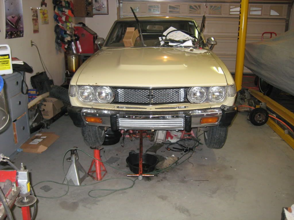

Hole in the bumper finished, I plan on putting some sort of mesh or grille in there still

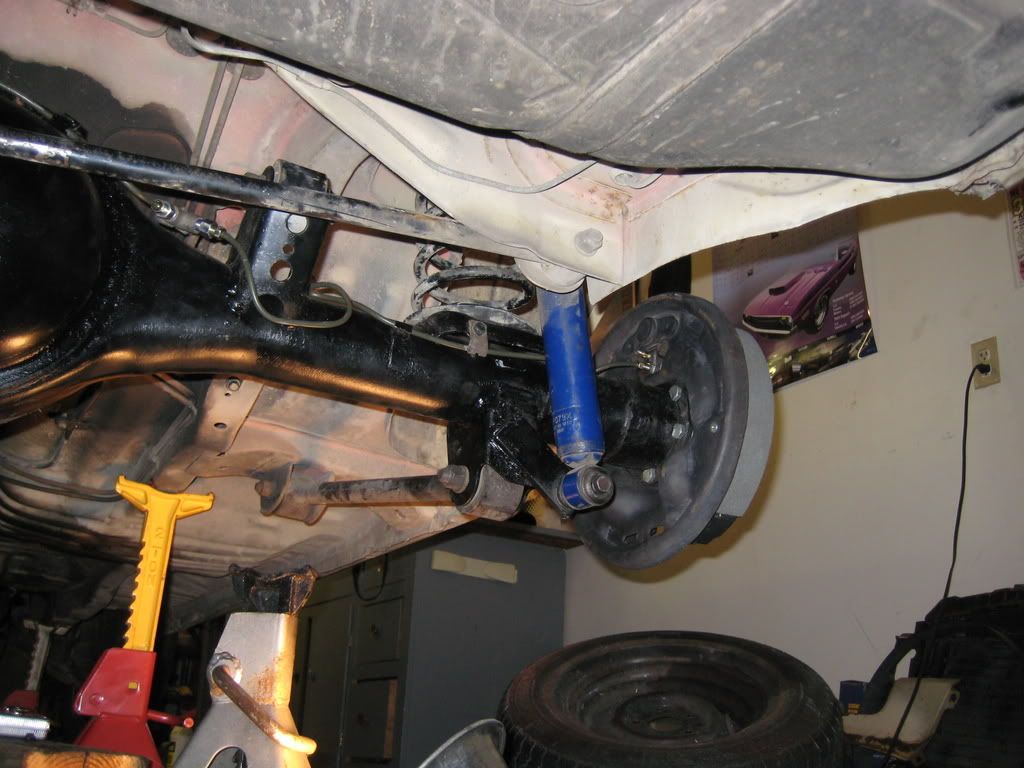

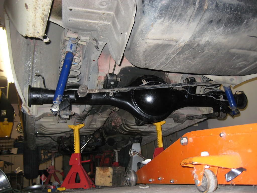

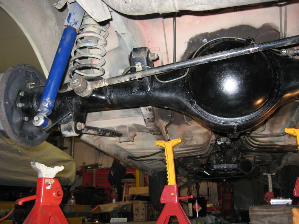

rear end in for the final time

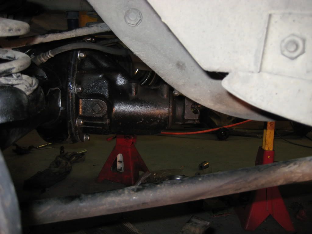

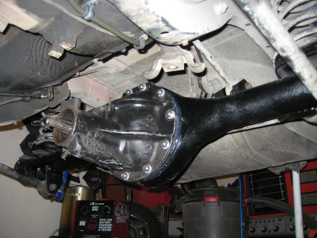

Diff pig mounted, 3.91 ratio and limited slip. only thing I am missing now is that damn pinion seal, ordered one already but it was the wrong one, new one should be her today.

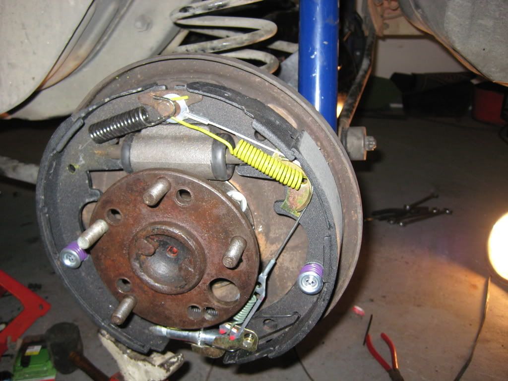

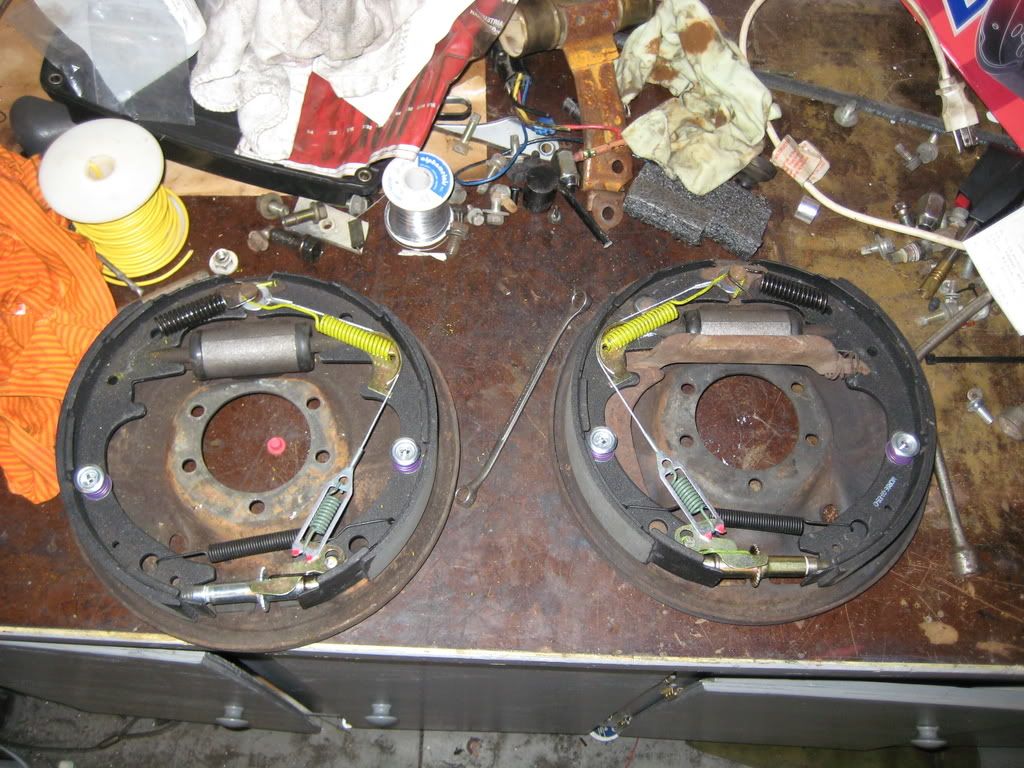

Rebuilt rear brakes with all new stuff

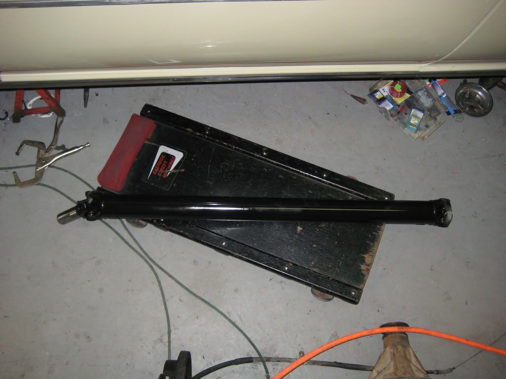

DRIVESHAFT:

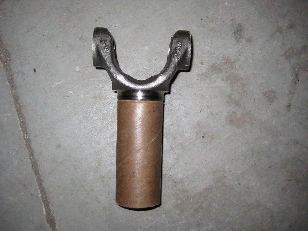

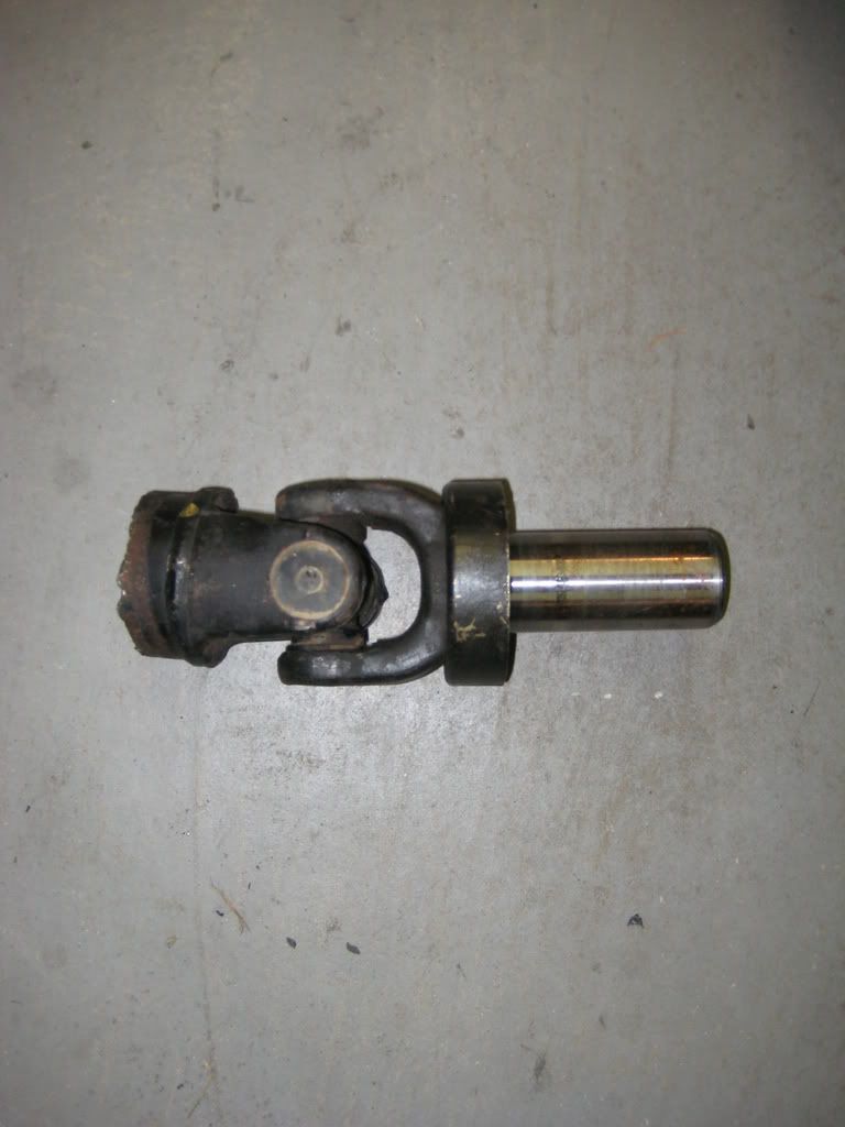

I had SHAFTMASTERS out of Lincoln Park make me a driveshaft, I had to buy a new yoke though that has capabilities of using a bigger u joint for stregnth though, pics....
stock:
Shaftmasters yoke:
I called them at 7am on saturday with my measurments and picked up the driveshaft at 11:45am! FAST!!

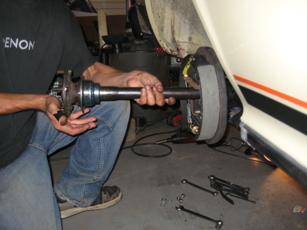

after packing the bearing getting ready to install the passenger side.
installing passenger side axle
ready to go

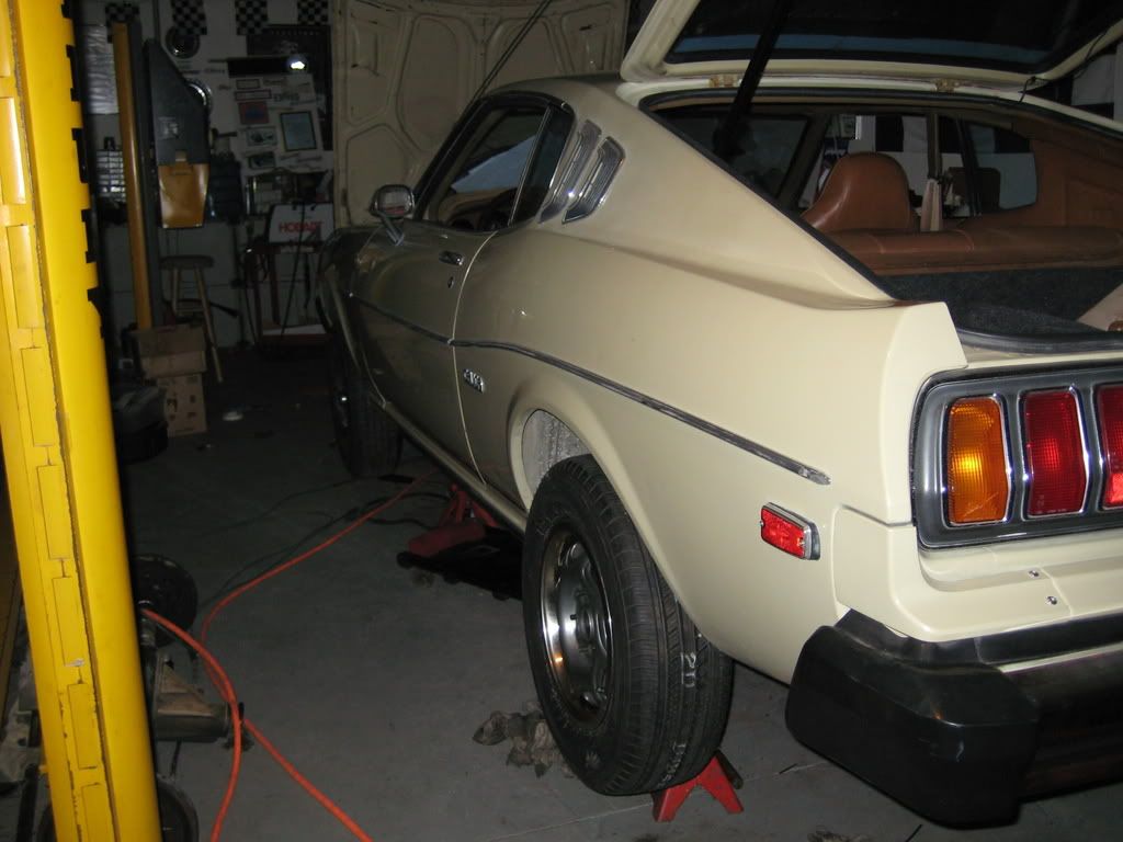

Wheels I picked up from MADDSM with new tires installed, fit under the wheel wells pretty nicely, too bad I will not get any traction :(

Bending the panhard bar will mess up the alignment... it's a common suspension issue on 3rd gen F-bodies, and it causes issues...
I would have spaced it back farther by moving the mounts.
I just bent it a littttttle bit :naughty:
I really hope it doesnt effect too much... but thank you, I will keep an eye on it and take some side to side measurements after that first drive.

i whould space out the panyard bar thou they move around alot when you have good amonte of power espily if the busgin are all oem rubber
