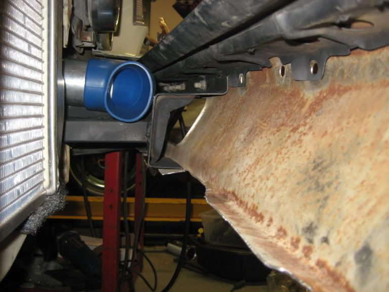

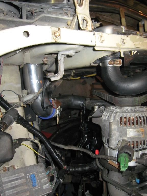

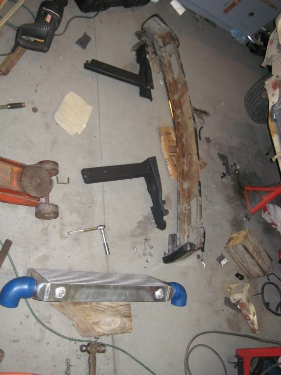

I found another problem last night...
I will not be able to mount the intercooler as low as I expected to. The factory bumper mounts (shocks) are stopping me from lowering the intercooler enough to clear the center piect under the grille.
I found some square tubing in the garage that is about 2.5 wide and 1" tall, I think it would be a good replacement for the factory mounting and yet would still offer *some* protection in the event of a crash.
I plan on cutting the mounting pads off of the end of the celica bumper shocks, and welding them onto the ends of the new bumper mounts I will make. That way I will still be able to unbolt the bumper if I need to....
I'll take a bunch of pictures tonight while working on it, I may need some help on this one...

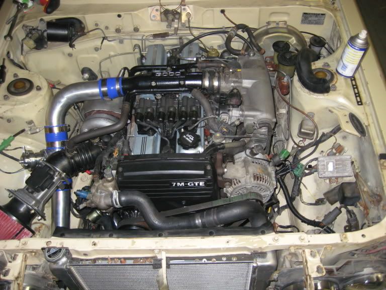

Ok.... I worked on the car literally all day yesterday... Here is what I accomplished!

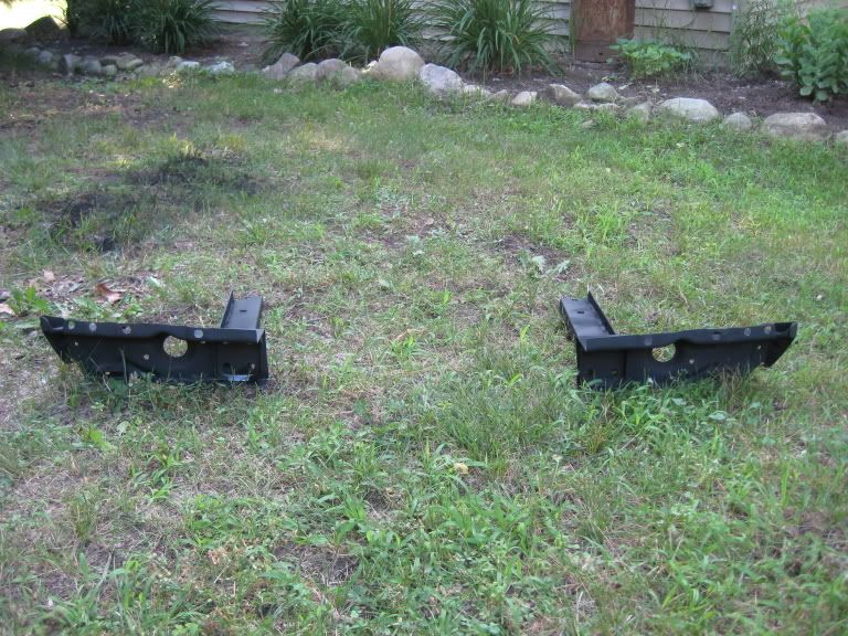

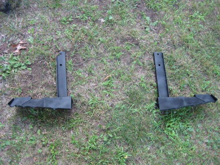

-Cut bumper bracing.
-Made up newbrackets to hold bumper.
-Painted them for protection.
-Bolted bumper onto car.
-modified front radiator brace....again
-Install battery box and install carpet, trunk area now finished.
-Removed old rubber fuel line and filter, plugged.
-Took 8 3/4 axle to a friends to have the brackets plazma cut off.

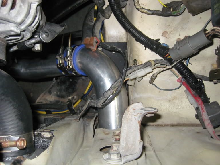

-Laid out and tightened down all intercooler piping and BOV, it turned out pretty good.
-bent dipstick tube for clearence of IC piping.
-installed driftmotion ss adapter for oil pressure sender for autometer sending unit (oil press).
-Cleaned out passenger area and vaccumed, ready to reinstall carpet and seats.

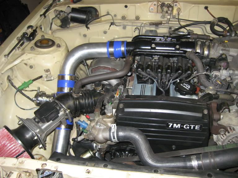

-Cut the accordian hose intake to make air filter fit.
-Installed IAC valve hose to accordian pipe.
I am sure there is more stuff too... but it was a long day haha.

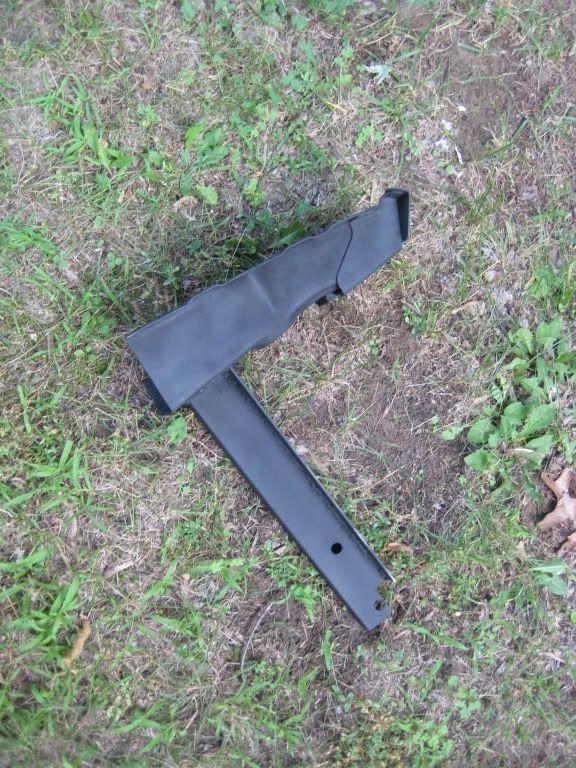

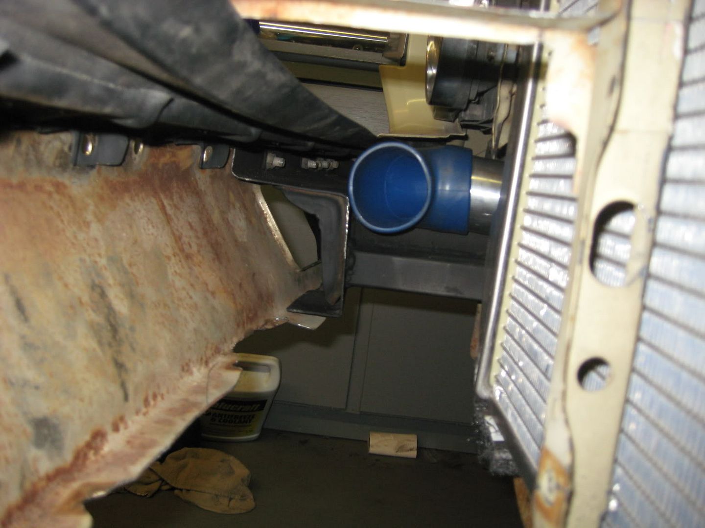

Bumper supports cut for intercooler clearence, new brackets made for IC piping clearence and intercooler height, painted.

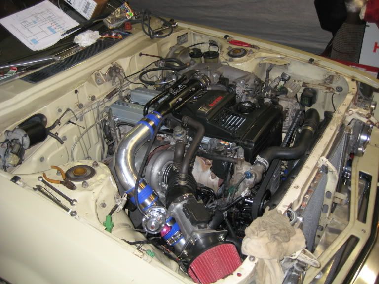

Intercooler piping installed and accordian hose cut

Please tell me you arent using those cheap rubber elbows from your intercooler kit on there. Those things suck and wont hold much boost. I used a set like that for mockup as well but when it came time to actually run the car they were replaced with real silicone couplers.
speedfreak426
Mar 31, 2008
380
Brighton, MI
I am ordering some new ones today from extremepsi.com, definently a lot more expensive :( like 35 each.... oh well, need them

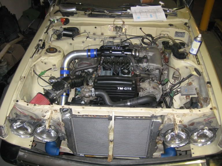

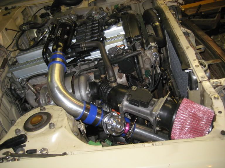

Picture updates....
everyhting is in and it runs pretty good, haveing a problem with the bov so I will have to use the stocker for now.

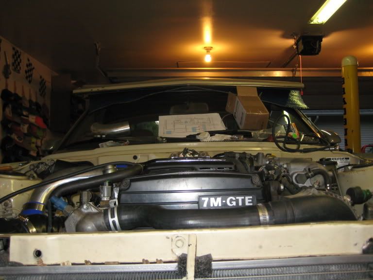

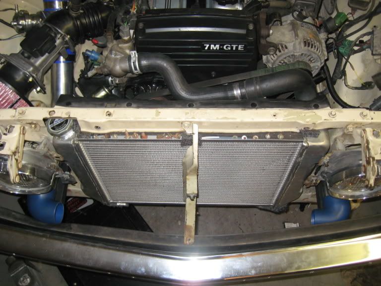

Hood clearence is realllllly tight.

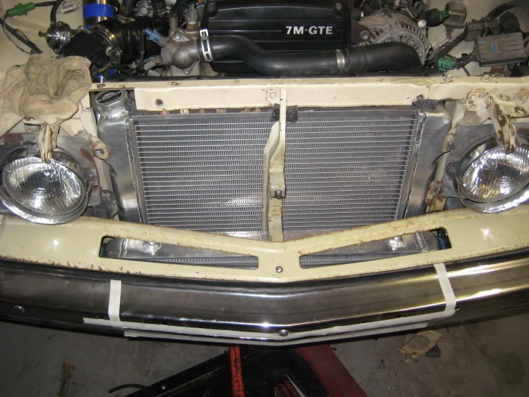

Intercooler is hidden pretty good.

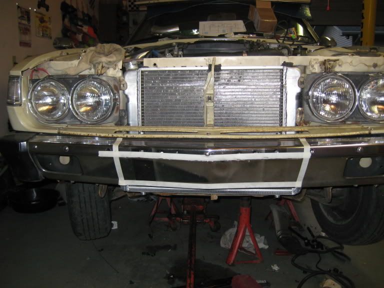

Intercooler sticks out the bottom slightly, but most should never notice it. I am going to cut a hole in the front of the bumper there for air flow... also shouldnt be tooooo noticable. suggestions? I already started cutting.

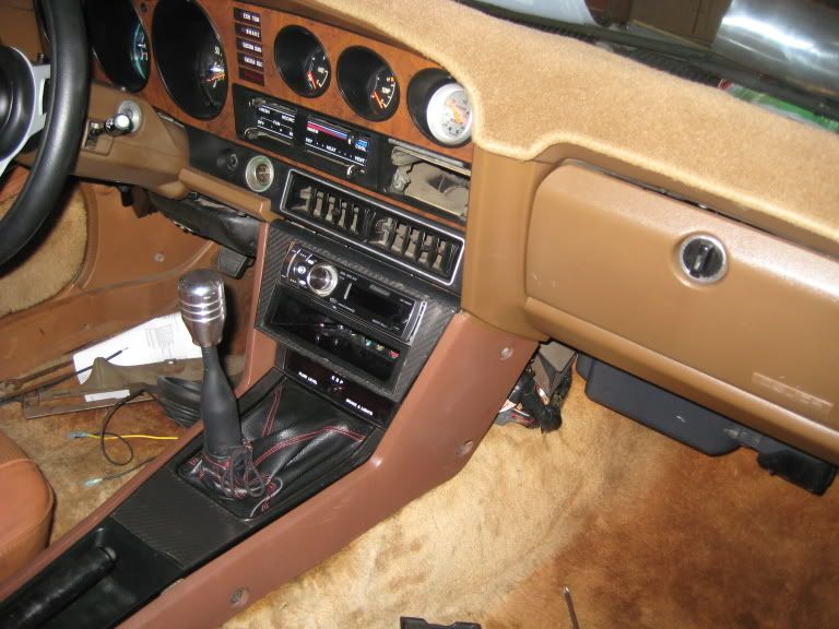

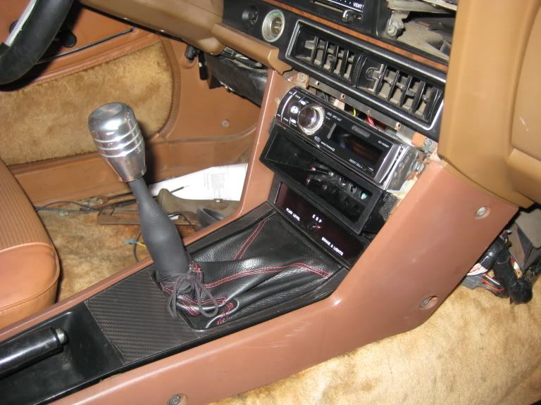

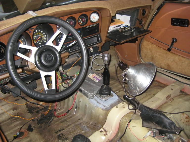

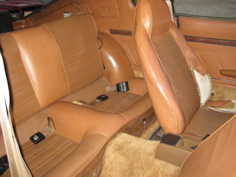

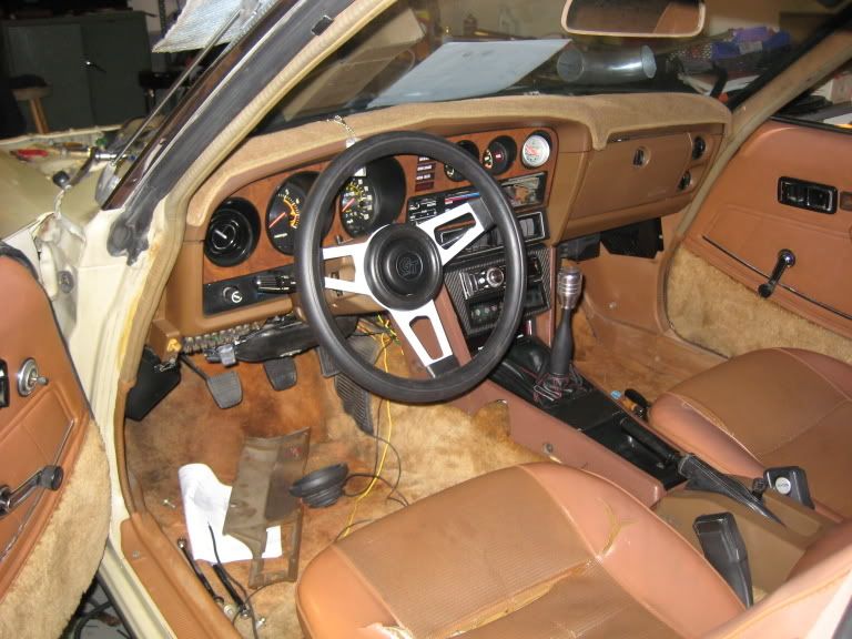

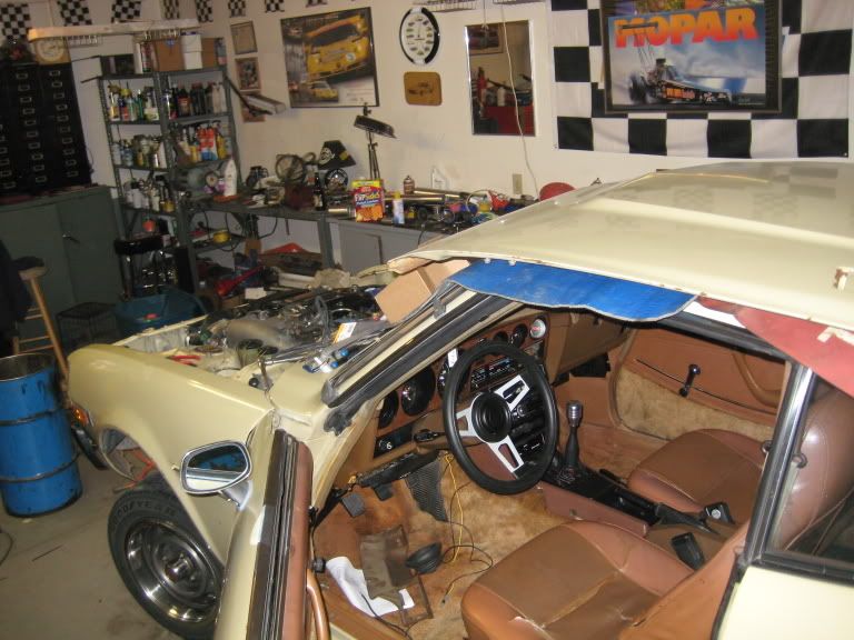

Interior is in.... I need a new drivers seat.... or seat covers lol.
Interior back in....
I hate this interior color sooo much

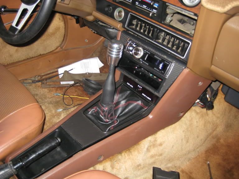

And now for the moved shifter I was worried about
Neuteral
3rd
4th
It looks like the shifter is hitting but it actually isnt, it worked out pretty good.
I just had to slide the shifter boot down so it didnt stretch out too much. I am just going to leave it like that I guess, I would rather not cut it up.

Corvallis OR
honestabe;1086447 said:
Looks good bro. Maybe you could put in a wire mesh screen in the hole in the bumper to make it less noticeable.
I was going to suggest the same thing.
Motor looks right at home in there. Great job on all of it. Now get us some video of it driving :naughty:
