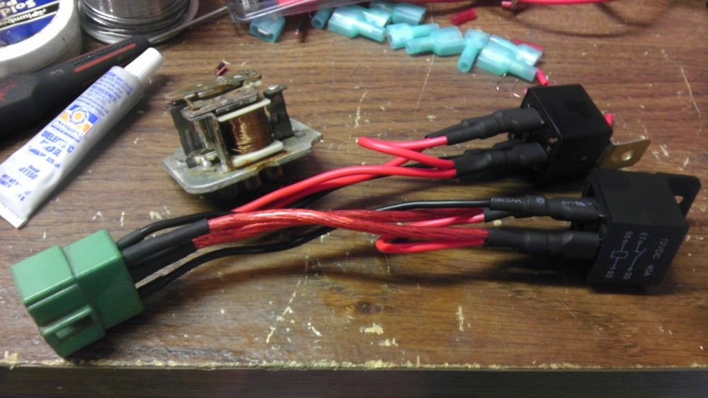

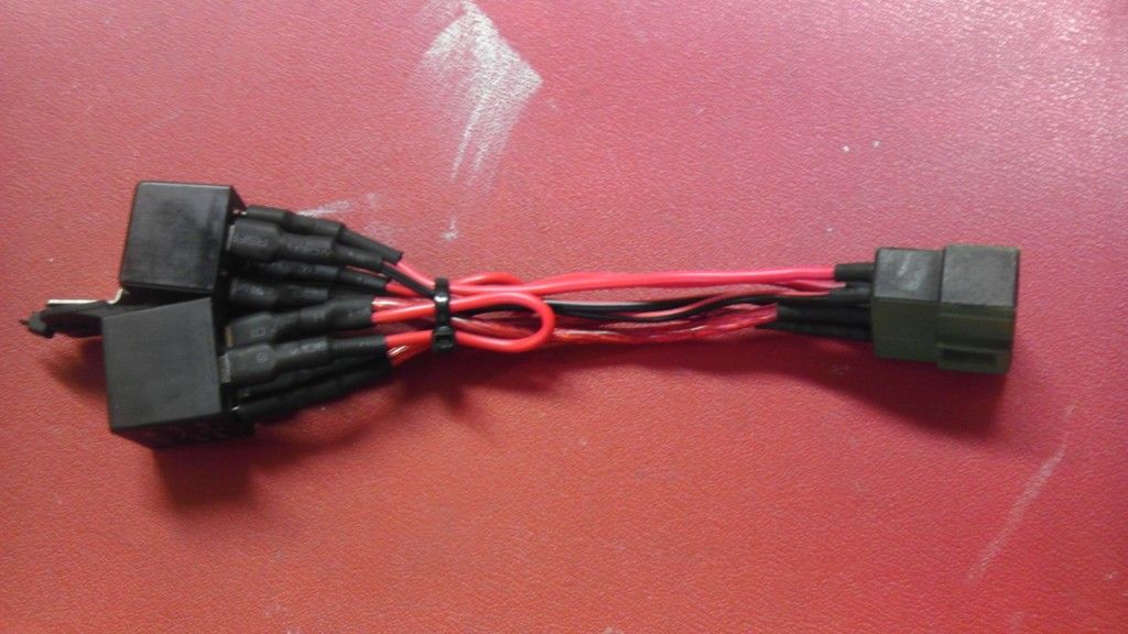

I have had a few minor issues, mostly with 35 year old electrical connections! This only put the car down for a few days while I worked out a solution.
I did not have my headlight/marker light relay mounted properly, and it was upside down in the engine bay. This caused it to get water stuck inside of it, which lead to it completely falling apart inside. The contact points eroded away and the metal one was on had completely fallen off and rotted.
I could not find a factory relay anywhere, and since there were two sepreate relays inside, I figured I would try to find an OEM replacement. Well, No dice.
I gave up shortly, and since I am handy with wiring things, I just grabbed a few relays, and a connector that was similar to the harness, and just repinned it to match what it needed to do.
Here is what I ended up with, works great.

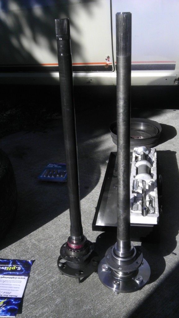

Changed out my axles for the 8.75" rear axle, since I had bent the splines a little on the old ones.

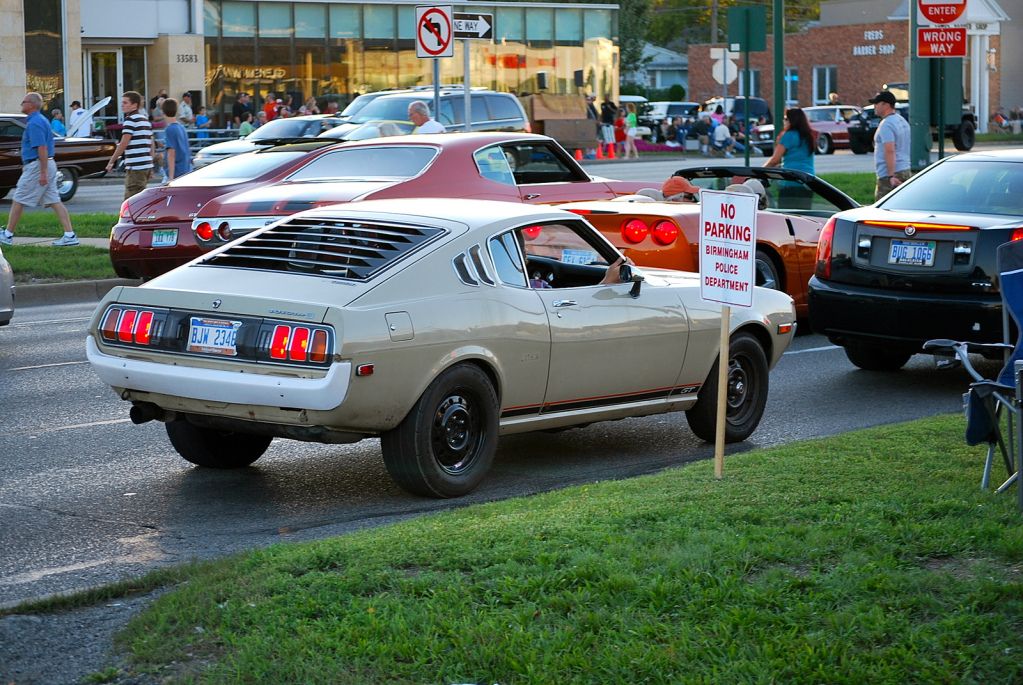

I went out to the Woodward Dream Cruise and someone(SSYELLOW) had taken a great pic of it!

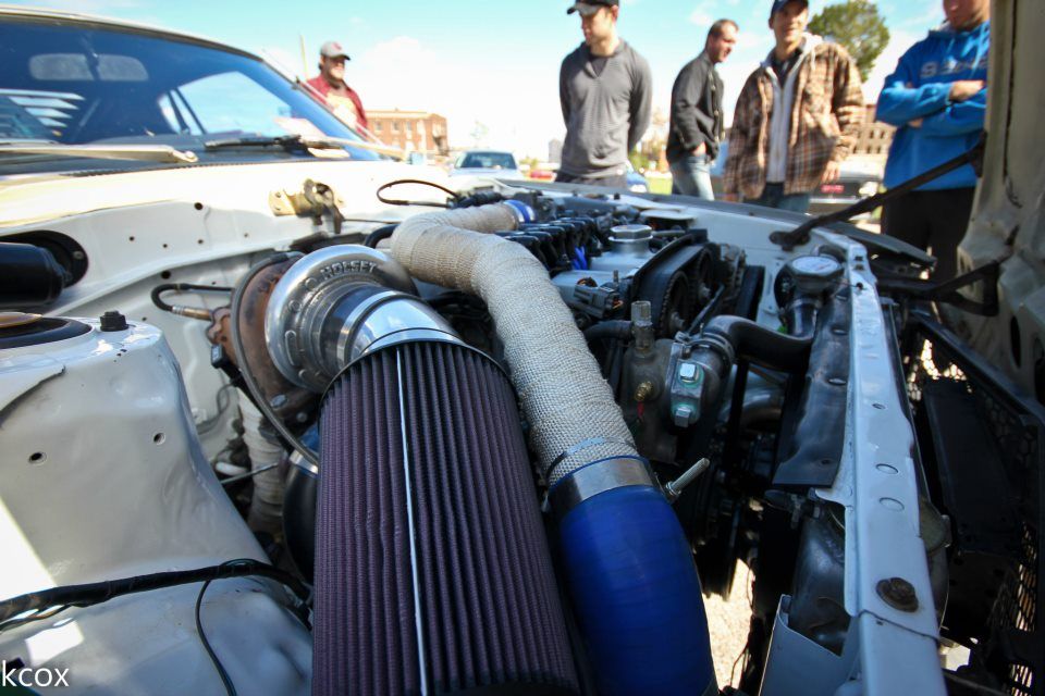

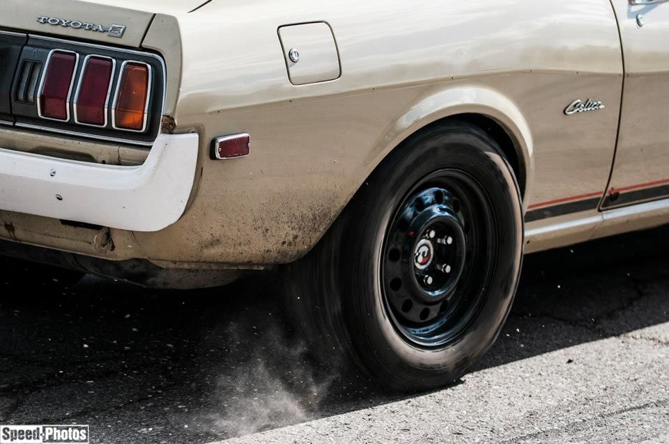

Thanks! It is just a 3" from the turbo back to a 3" Magnaflow turbo muffler.

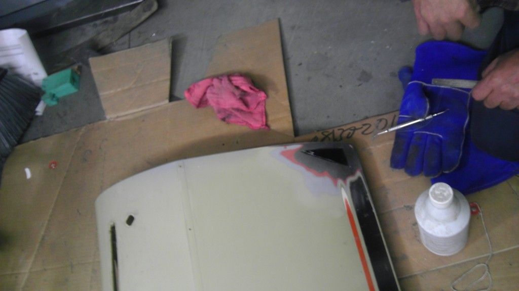

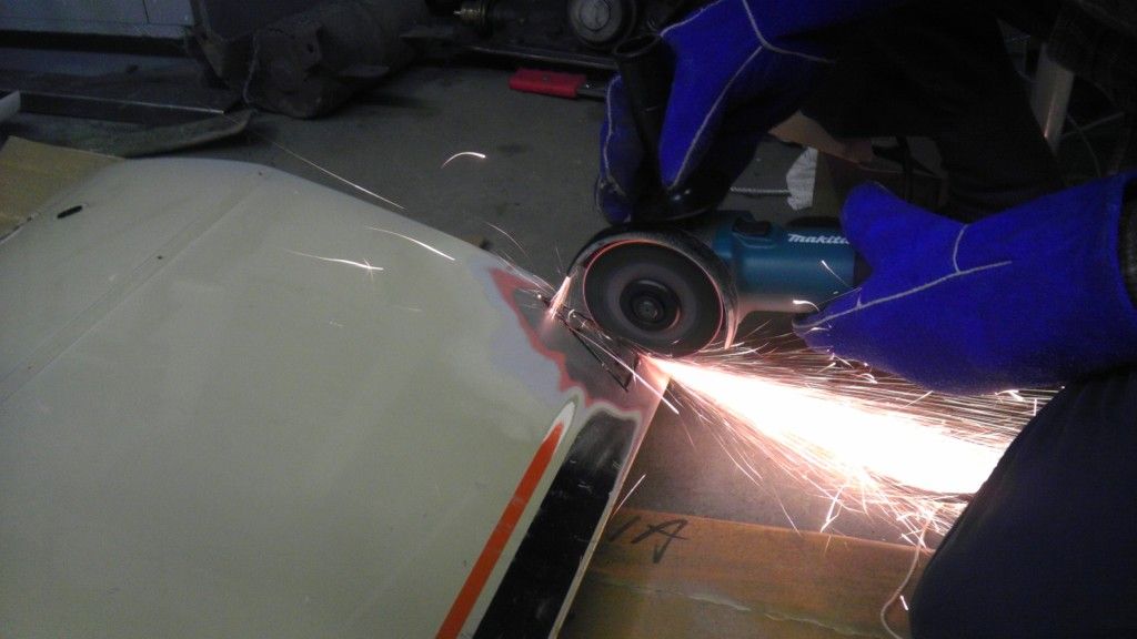

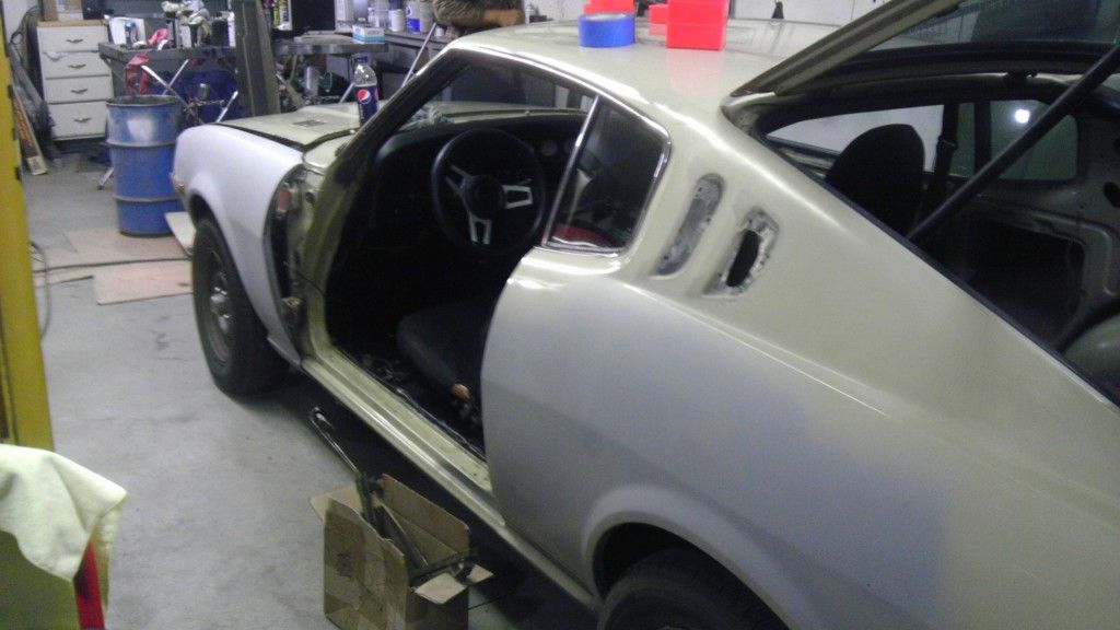

Well, decided to tear it apart again!
Before going in the garage
Repair time
Driver door
Also have a lot of other plans for this winter, but I just need to try to keep the motivation level up

If you're running that grinder for extended periods of time, might I suggest hearing protection of some sort? Couple minutes probably won't hurt ya, but when you're exposed to it for hours at a time like I've been these past few days, it would make you hate life without ear plugs.

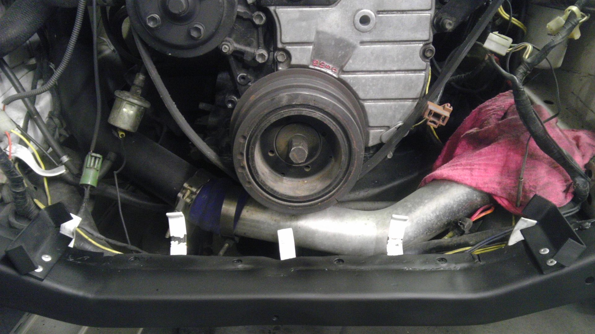

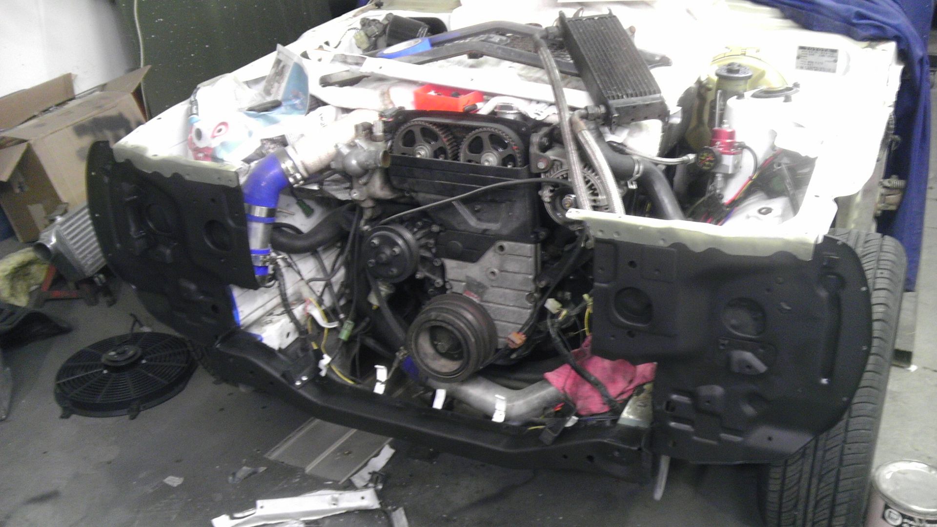

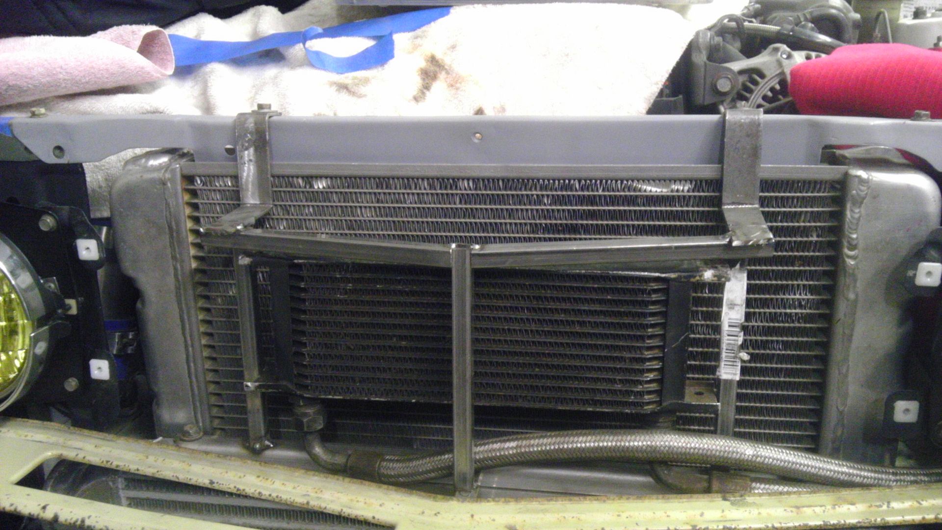

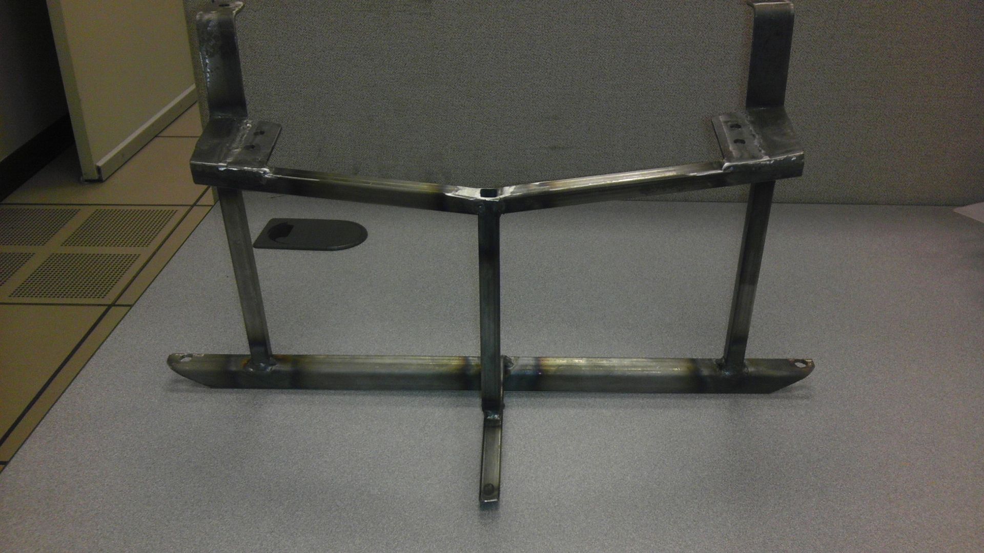

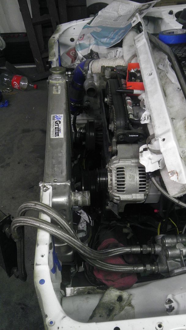

Finally fabbed up some brackets to mount my radiator properly! It's going to be secure and work great. Also moving the radiator back about an inch or so while doing this..
Made some more clearance for the intercooler pipes and got it painted black
Perfect, holds it upright and secure by just the bottom so far even. Also rubber insulated
Since I moved the radiator back, I am going to have to modify the radiator inlet, it's literally an inch away, and pointing right to the alternator pulley.
Talk about a tight fit...
I have also been spending a considerable amount of time restoring all these small parts. Only half of the stuff is done so far. Old on the Left and bottom, New and refreshed on the Right side

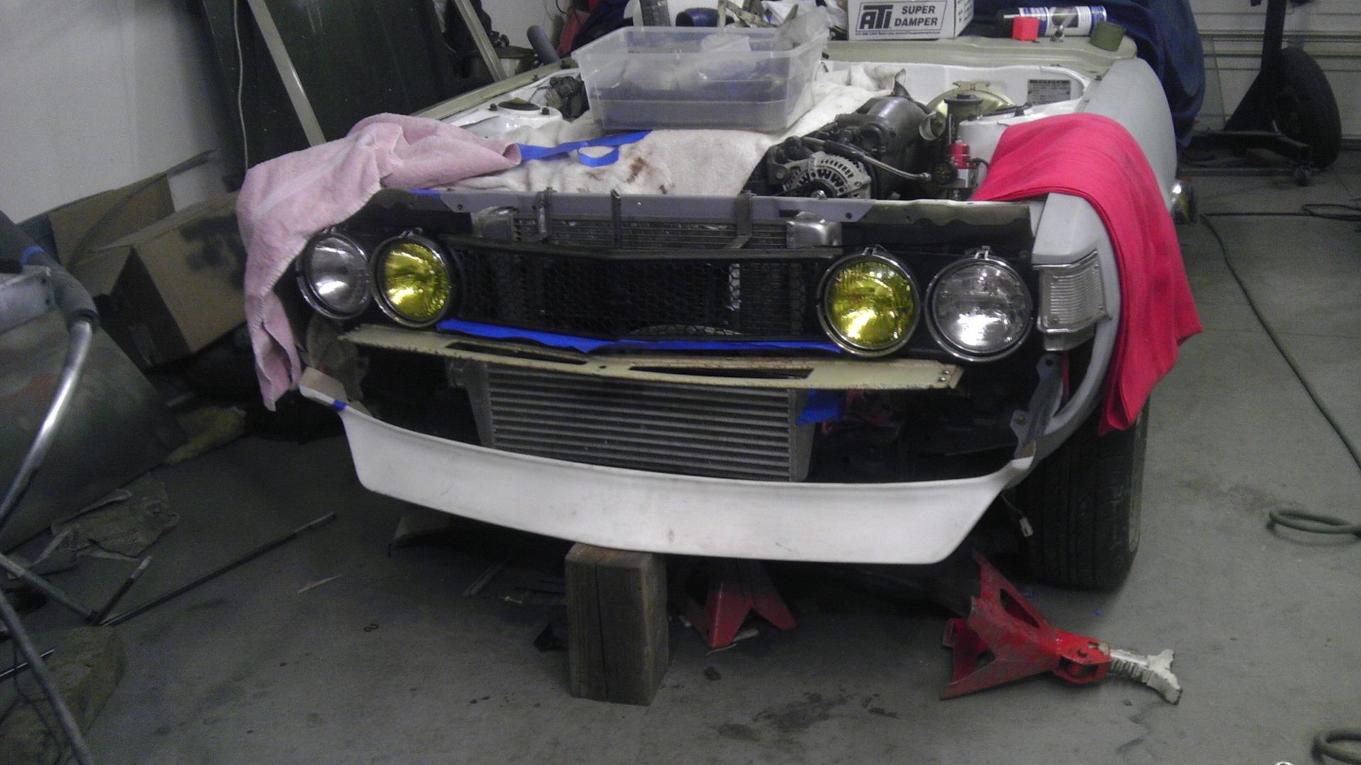

My reason for moving the radiator back is so I can also move the intercooler back some in order to try to make enough room so I can fit the OEM front valance back on. I have the orig. piece, but I just left it off becasue I did not want to cut it up in order to make it fit... I wouldn't be able to find a replacement in case plans changed, so I had just opted to leave it off. I may still have to cut off a mounting bracket, but I am going to try not to butcher the whole damn thing like I would have had to do with the radiator and intercooler up so far.
I'll post up some pics with what I am talking about
Well, here is the (last few years) state of the front end.
Here is what the OEM valance looks like, this is the piece I have in good condition, I am not sure how the intercooler will fit behind it yet.
Or another option, I can buy a front spoiler like this one, and direct airflow a little bit, and I wouldn't mind cutting into it a little bit. But this way will cost me more $$, and i have already put too much money into this thing.

Another thing I also bought in order to move the radiator back, is an ATI crank damper. I needed the shorter pulley without the AC belt farthest forward, becasue it interefers with my fan. Never knew it would cost so much just for an extra inch :lol:

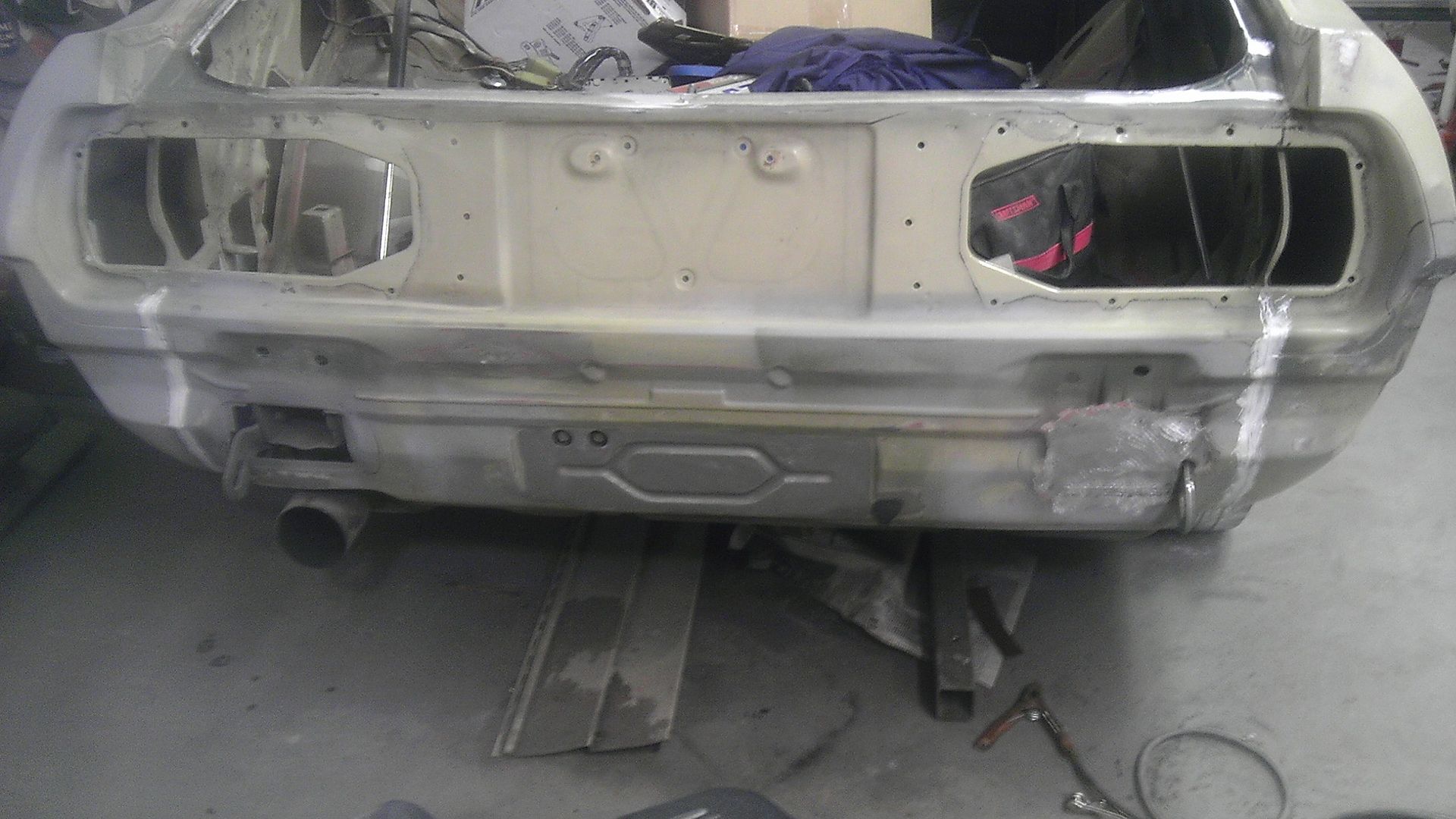

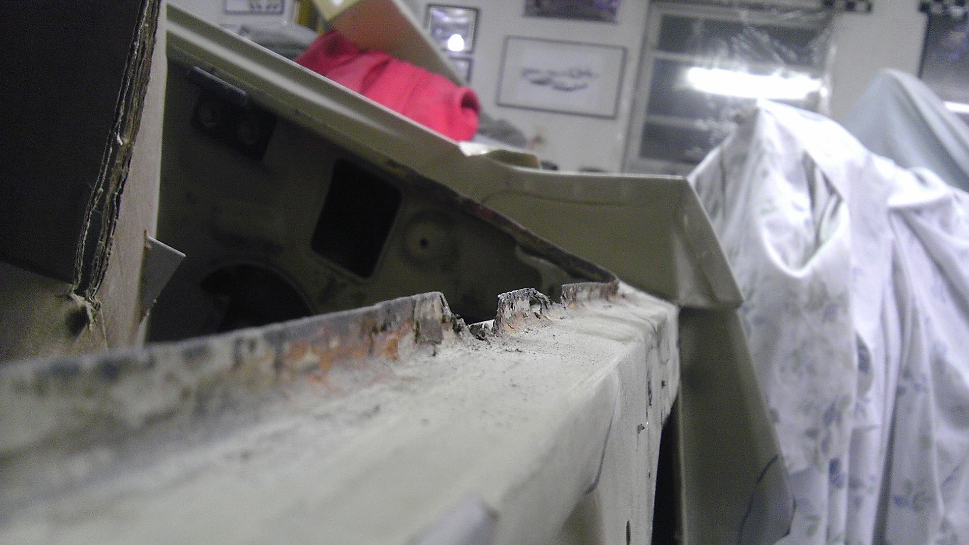

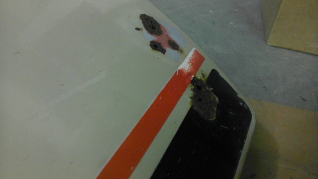

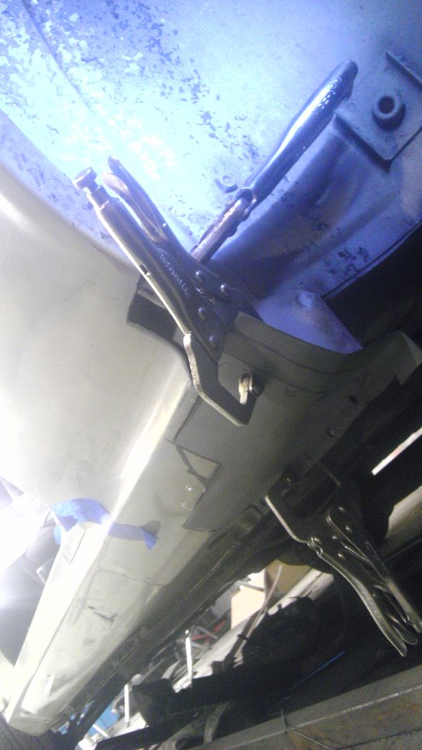

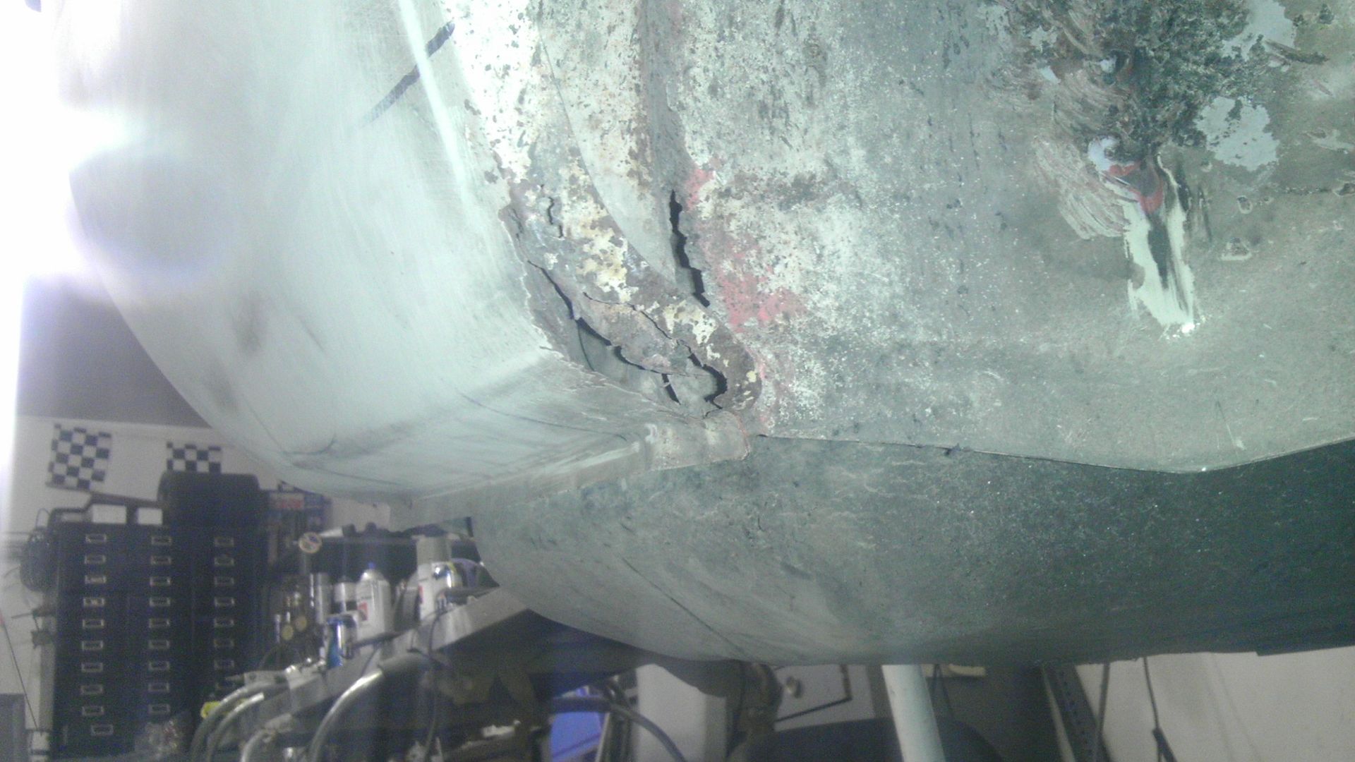

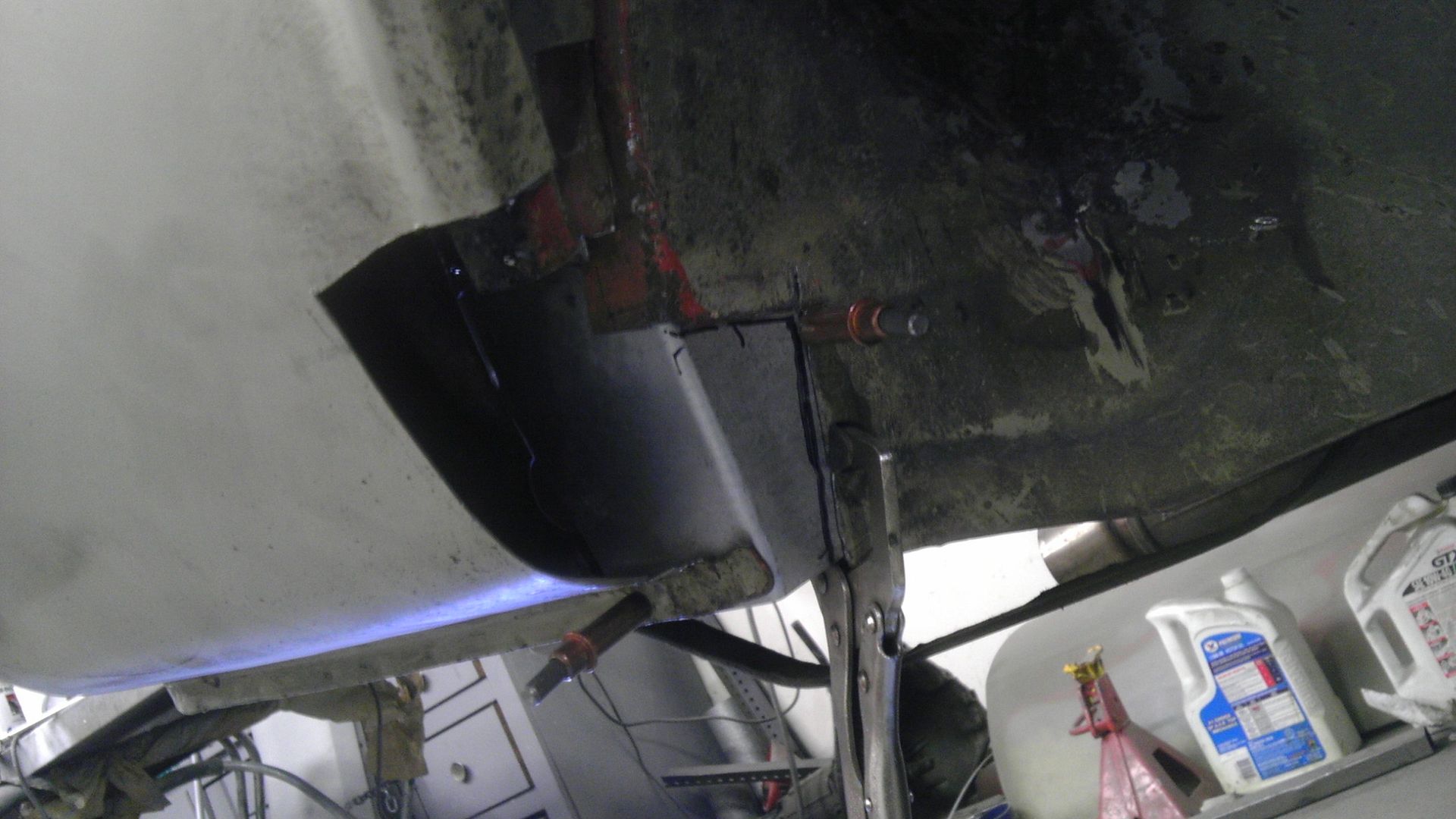

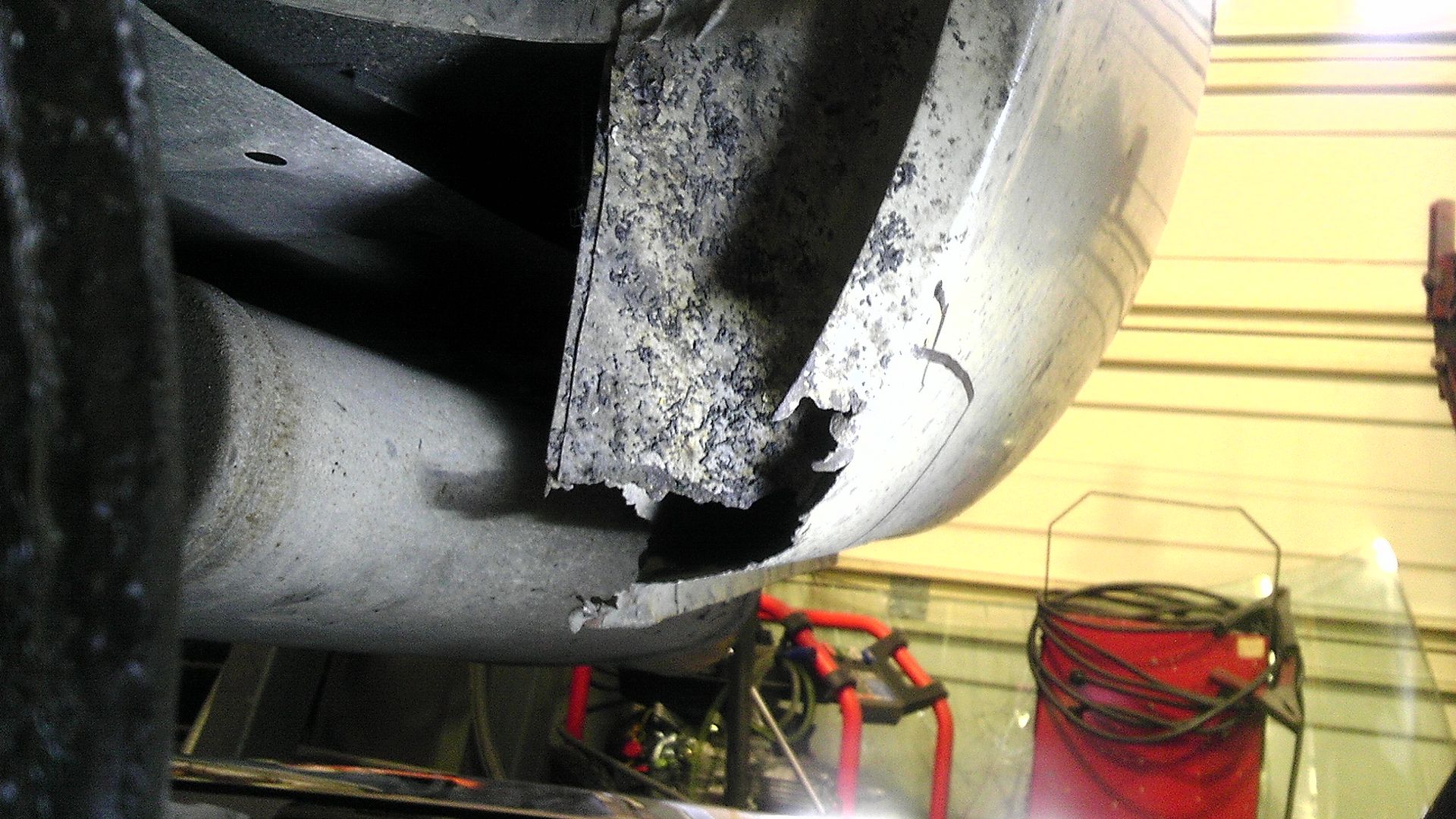

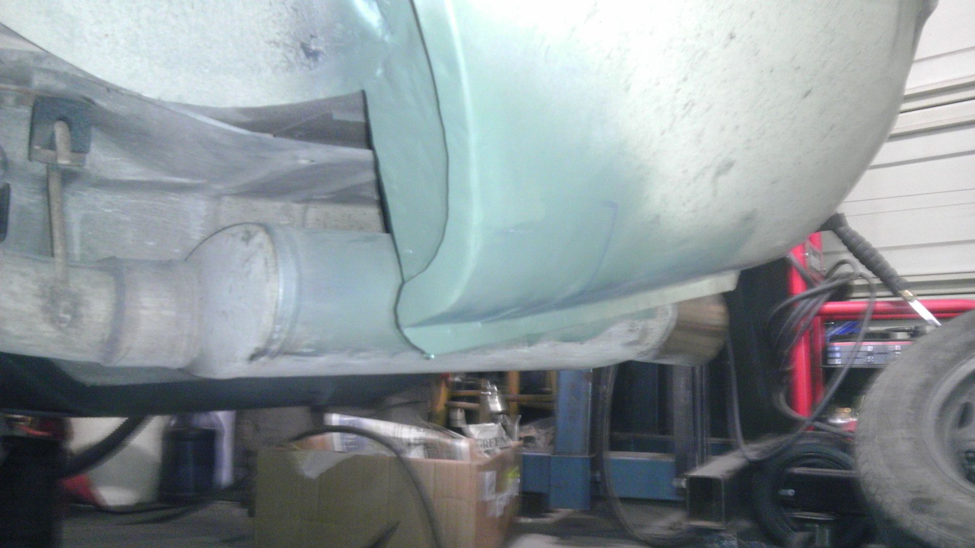

Here is a what I have been doing.

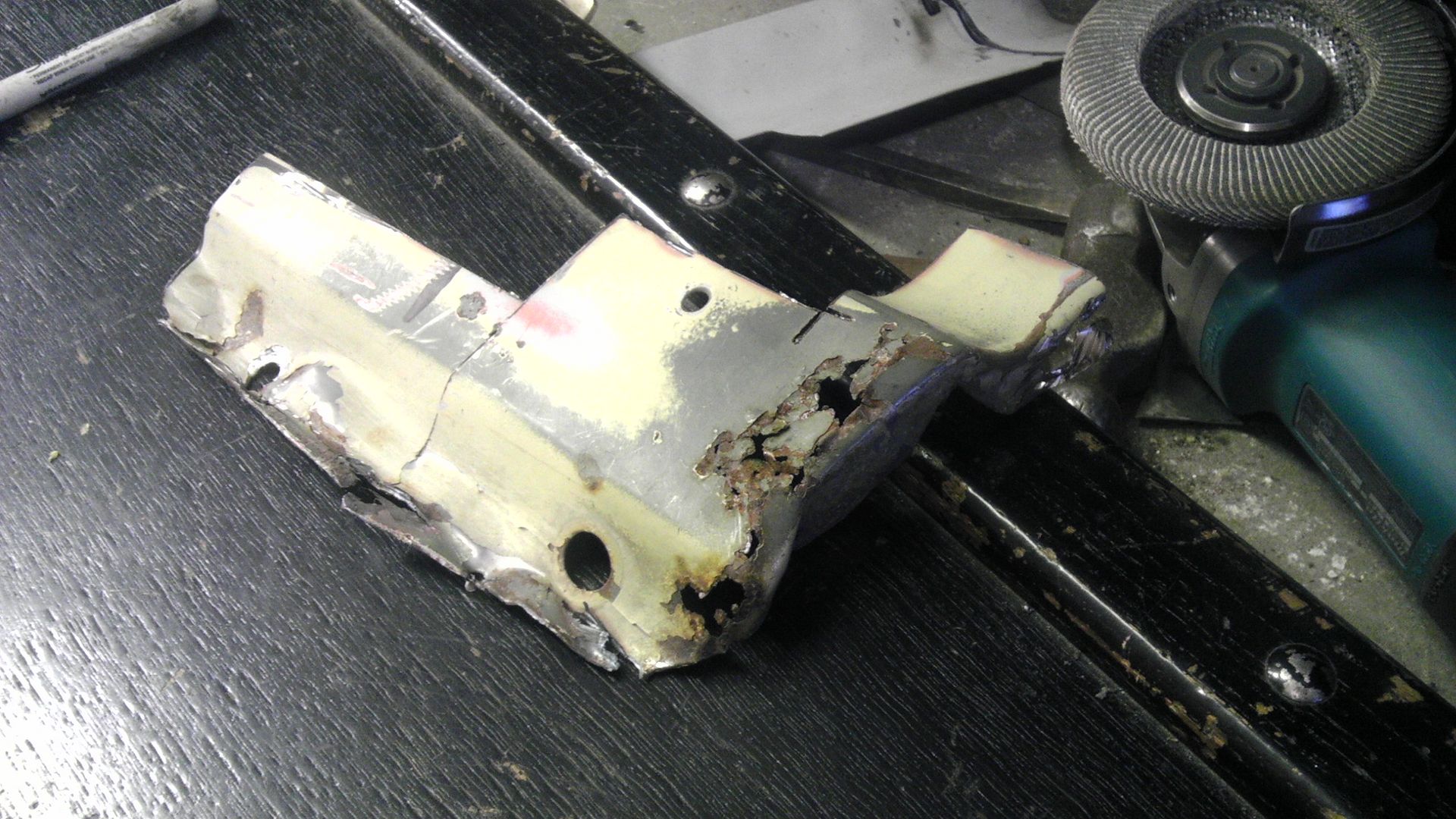

I cut out some rust and replaced.... no pieces are available for this car, so I have had to make every piece by hand from sheetmetal.
Lot of work went into it.
In front of rear wheel
Before
after
Behind rear wheel
before
after
front fender... no before or after pic, just mid progress, but its finished now
I have finally made brackets for the intercooler, grille, oil cooler, and front end parts. All with one bracket.
I also moved the radiator and intercooler back a bit so I can have more room for my new front lip

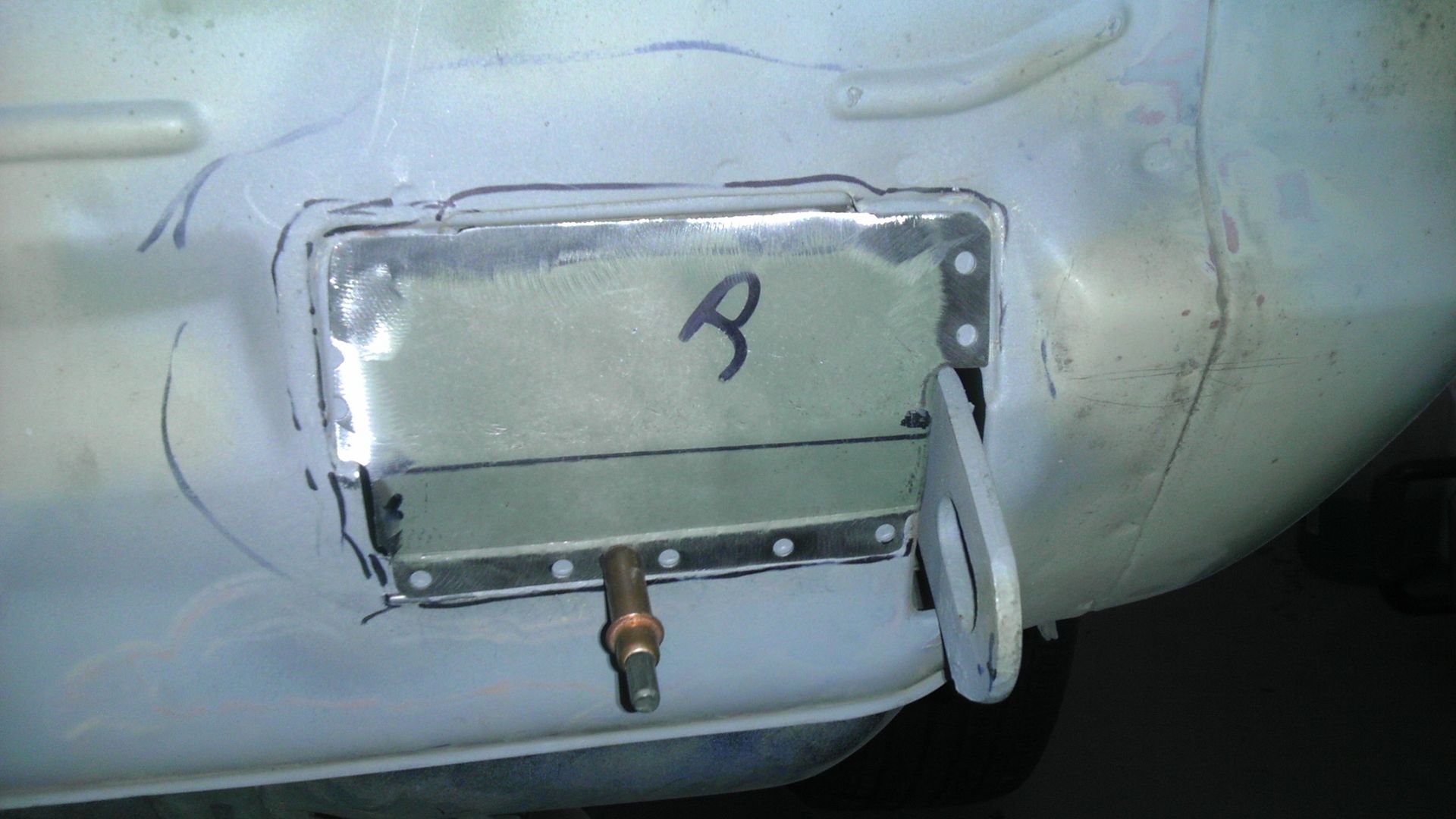

I have not updated this thread in quite a while, so I feel like I am a bit overdue.
I have had a lot of things happen over the last 2 years of missed updates, but it’s mostly been pretty boring, so I haven’t really wanted to share. I am getting closer to my end goal of it being white, so I will bring everyone up to speed with my slow progress.
On the left you can see the huge hole where the “impact absorbing shocks” mounted into the frame
These were for the huge bumpers, but since I now have smilies, I eliminated them, as on the right side of the pic.
The piece I made to cover the holes

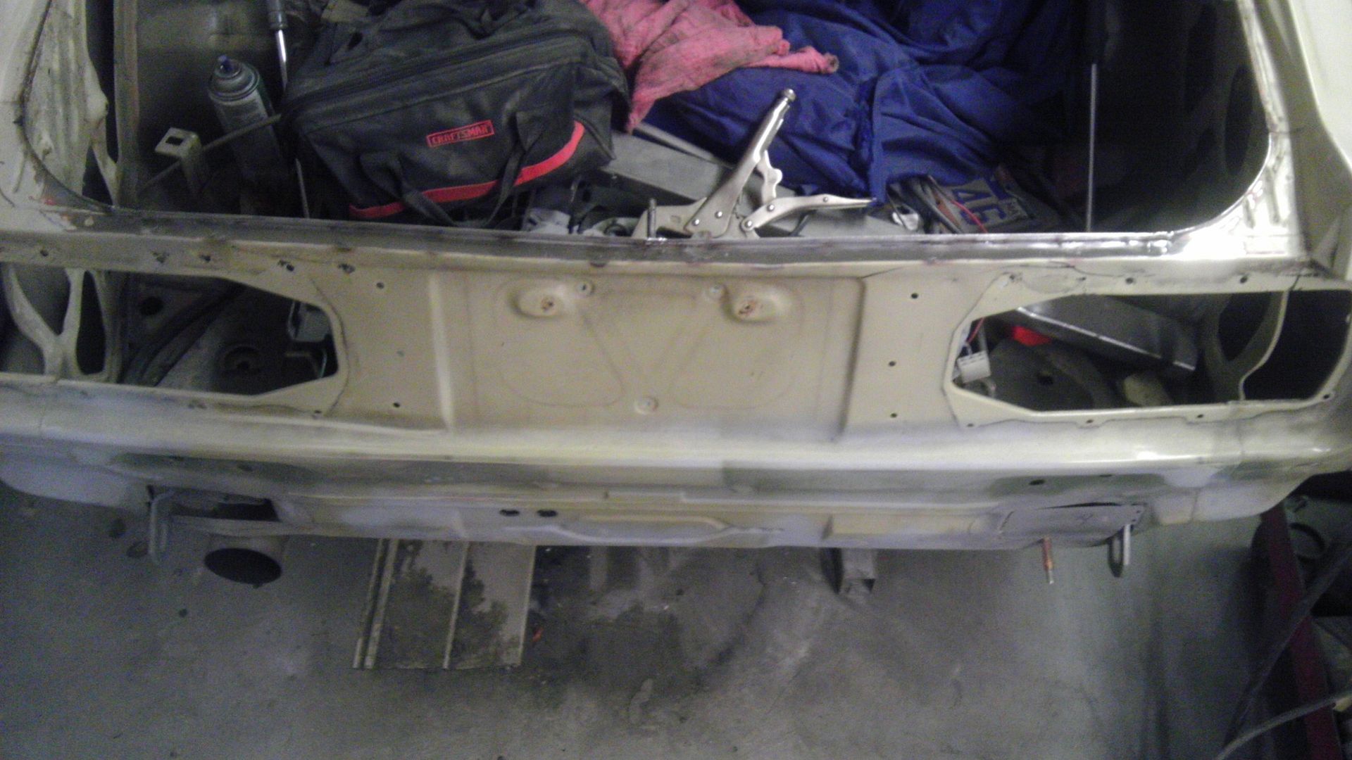

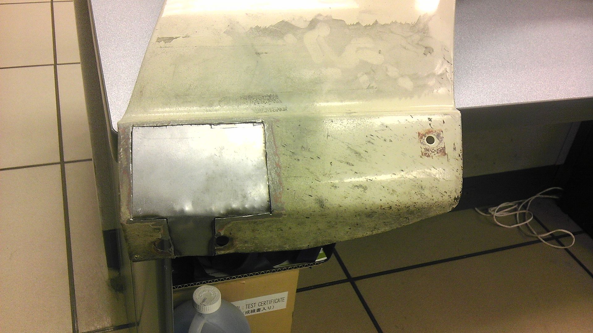

Lip that holds the hatch seal was rotted out
I took some strips of steel and used a break to make new pieces, turned out great.

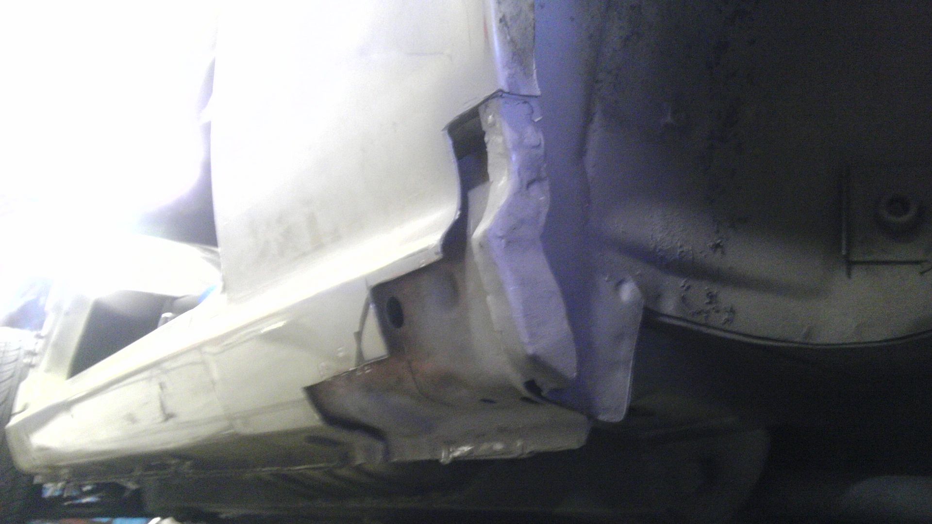

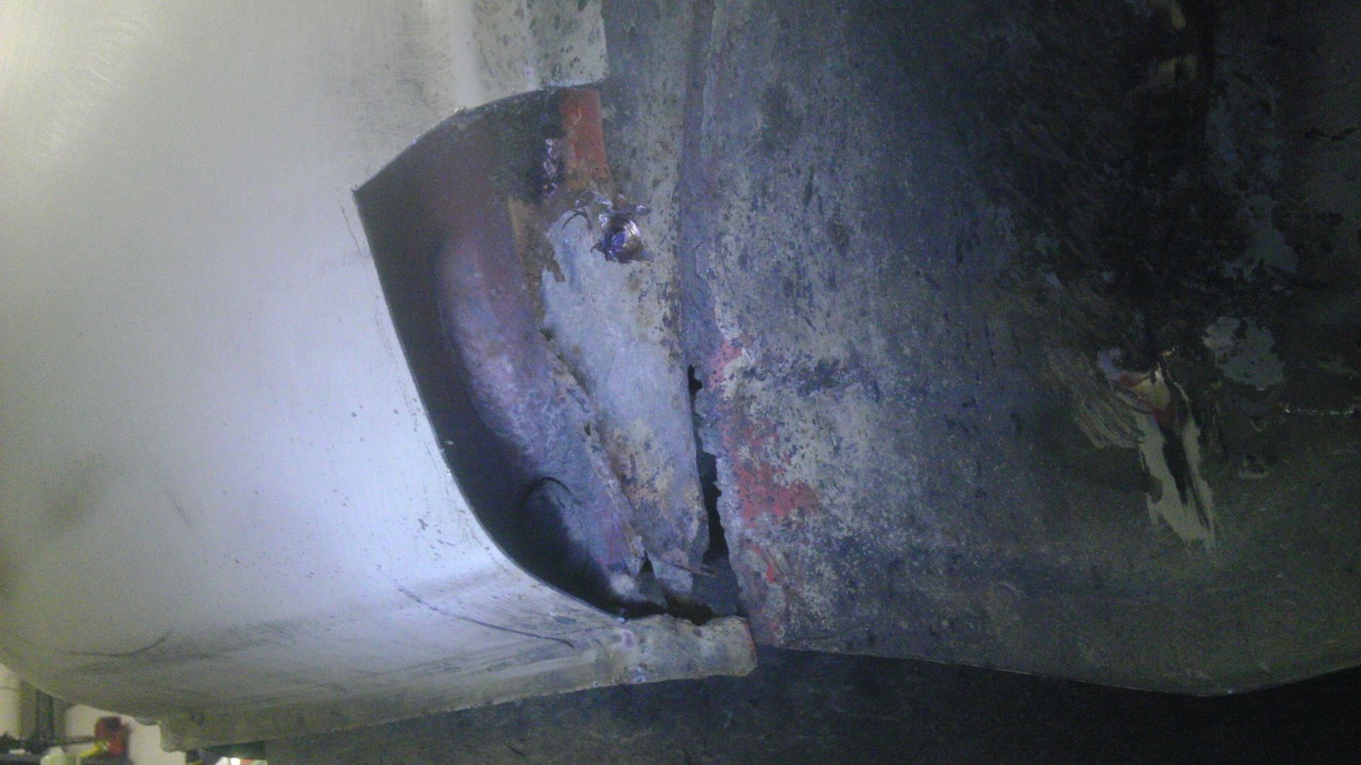

Moving on to the drivers side quarter panel behind the rear wheel, this was the worst rust on the car.
I just cut it all out, it ended up being 4 separate pieces I had to make.
