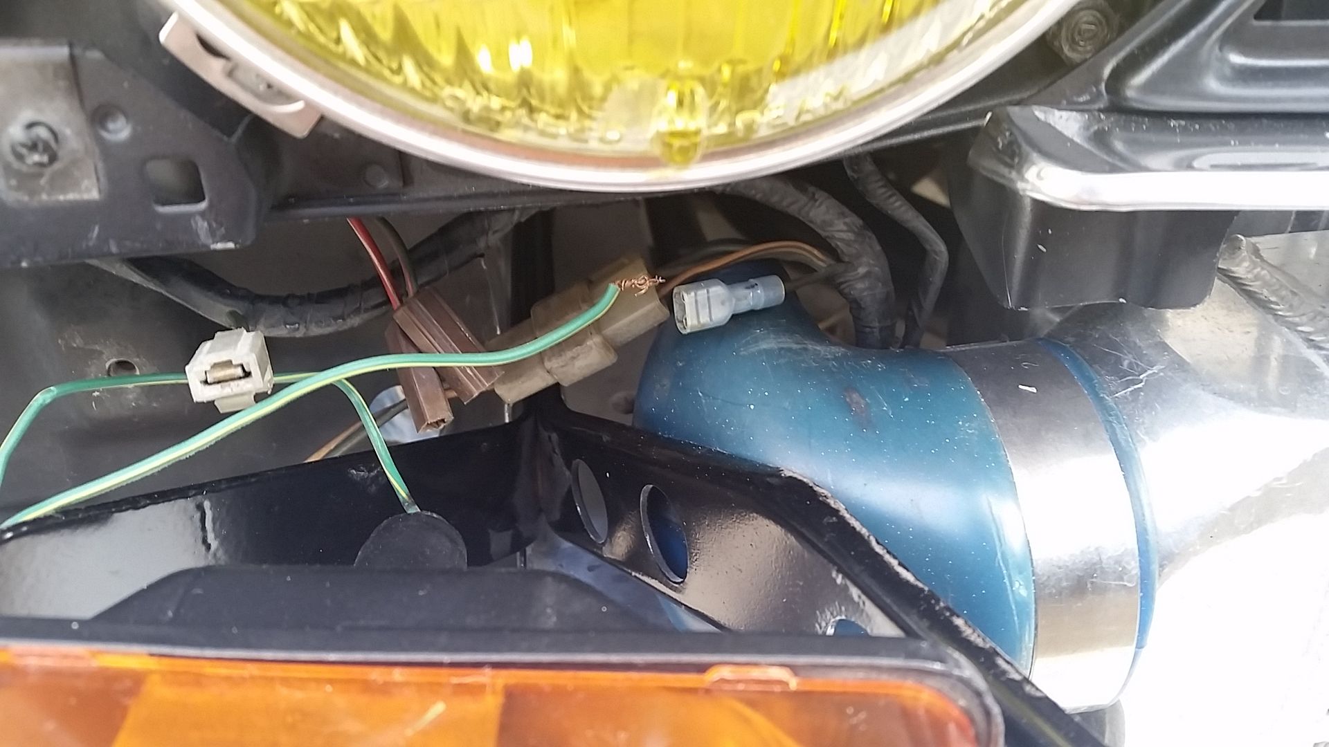

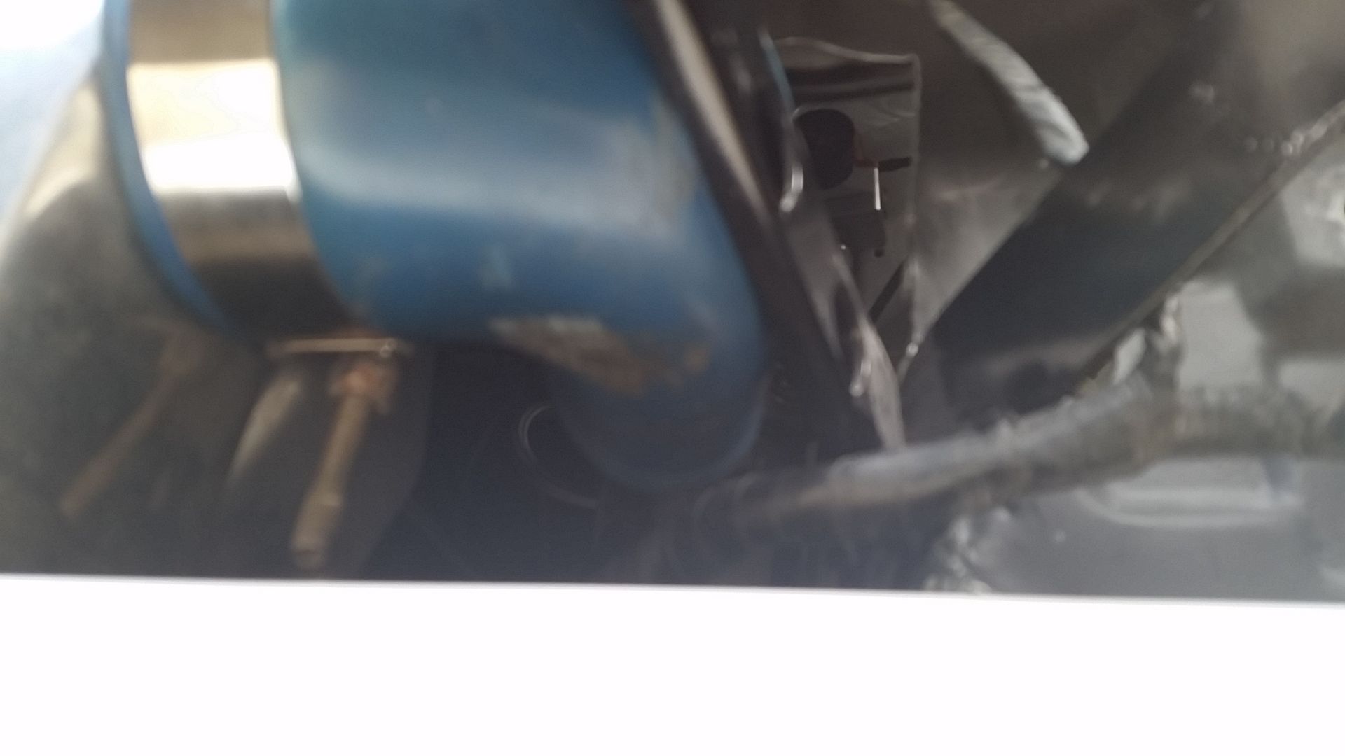

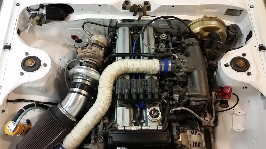

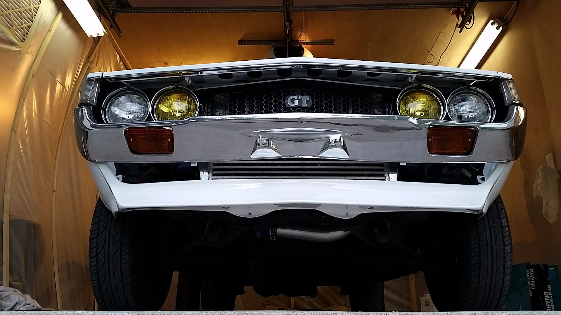

I do need to remove the front bumper and modify the mounts. They interfere with the intercooler pipe elbows, so I will have to cut them and make some space. Rare mounts.... but I don't want to go through the trouble of selling them and making new ones.
Pic from under bumper looking at black bumper mount and blue elbow
from the top. I had to remove the pipe just to get the mount in.

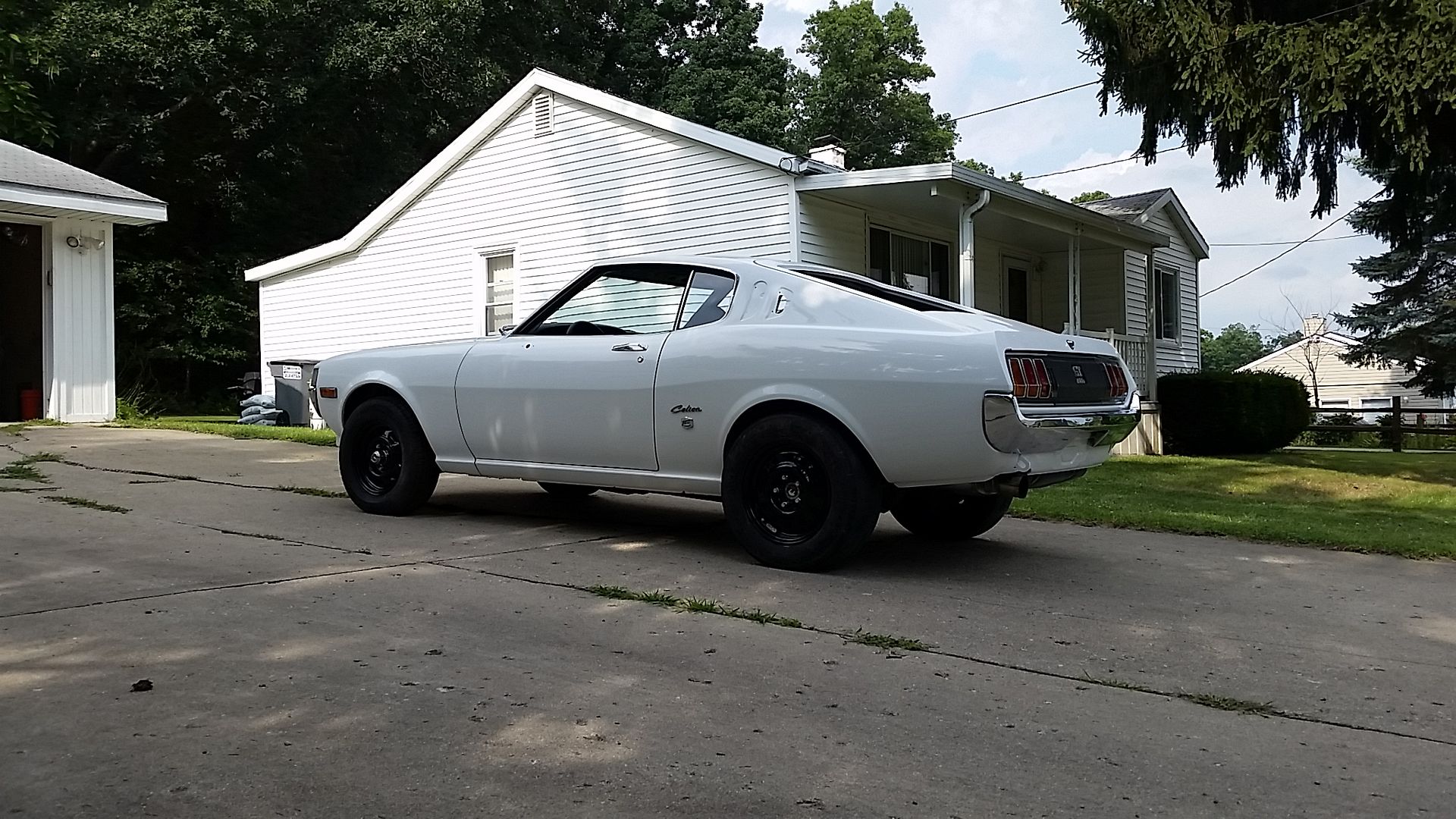

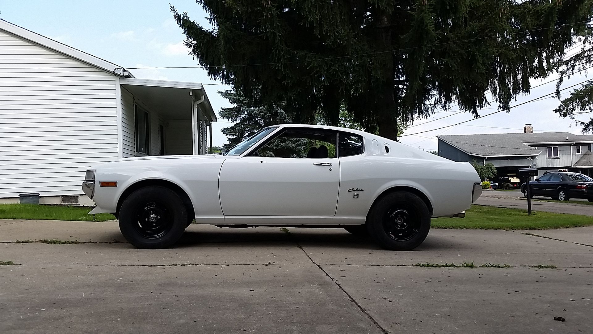

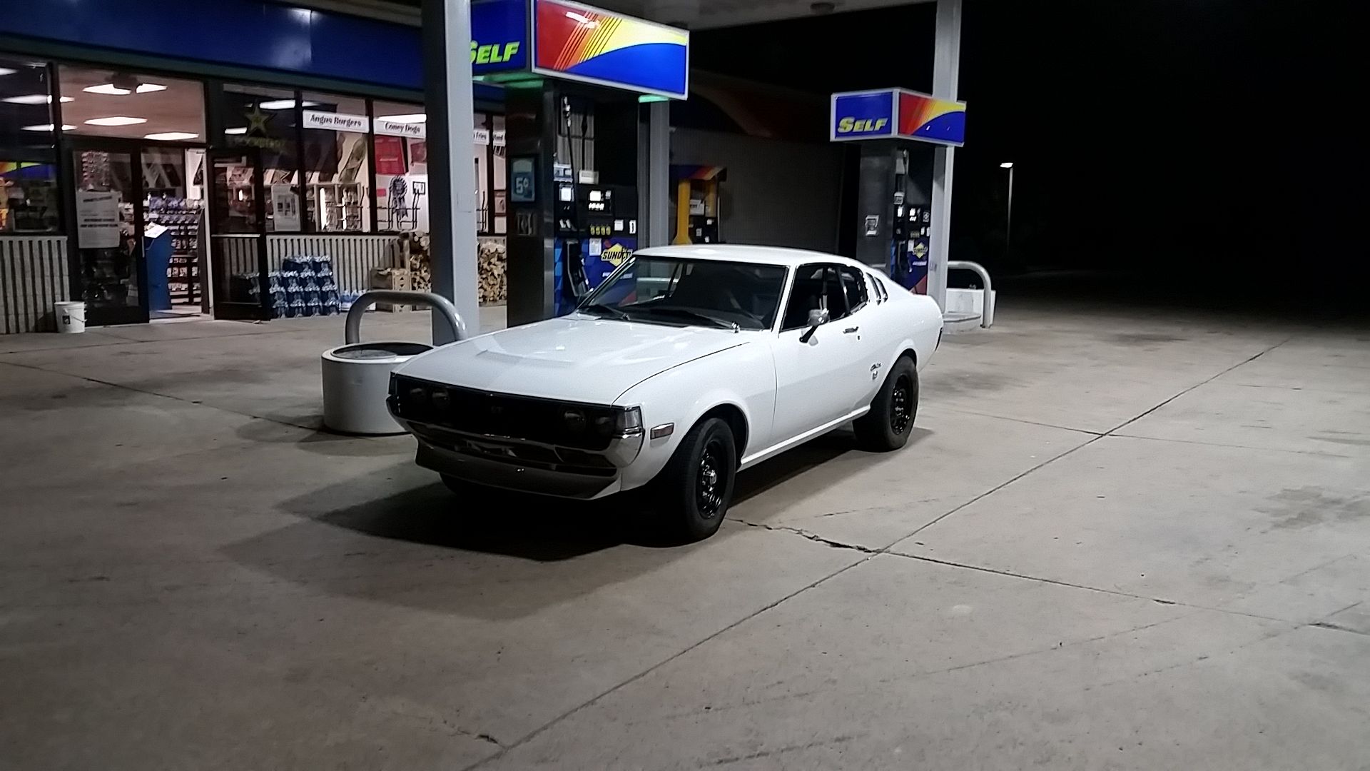

Maiden Voyage last night. I forgot how squirmy the suspension on this things was! Sure is fun though
Too bad rain is forcasted most of the week! I am ready to bring it out.

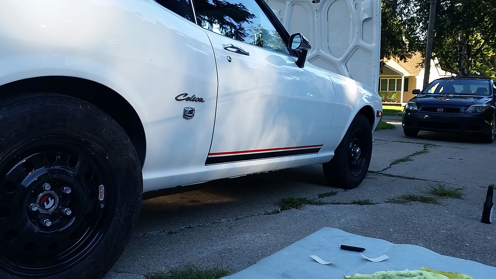

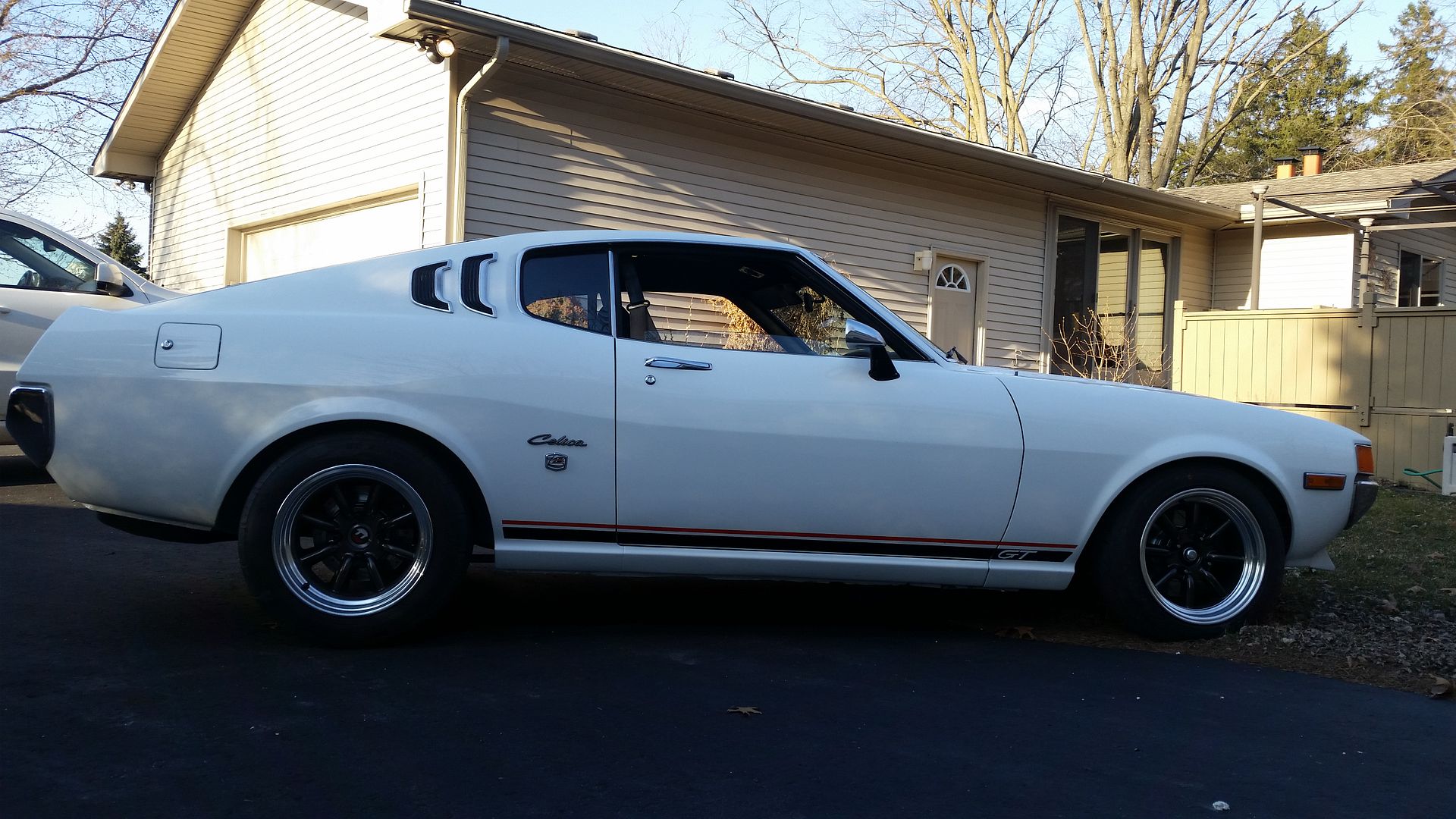

I have a stripe to put on the side, but I found that 2 pieces of it are missing. I took the pieces that I needed duplicated up to "Kevo Dafro" on here at W4 signs and he is helping me out. Thanks Kevin! As soon as I can get those pieces the exterior of the car will be complete for this year (still need to finish the front above the front bumper, but I'll do it over the winter. Going to just leave it open for now.)
Preview of stripe, I think the red and black look great on the white.

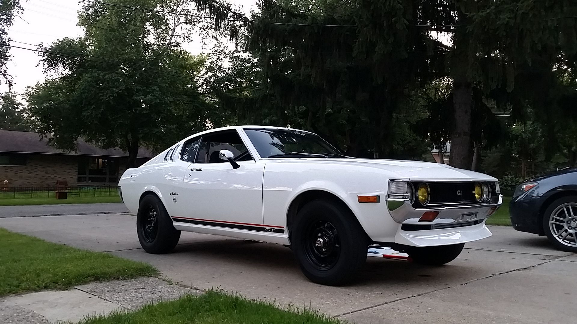

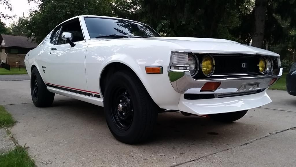

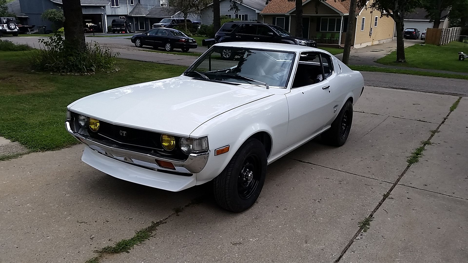

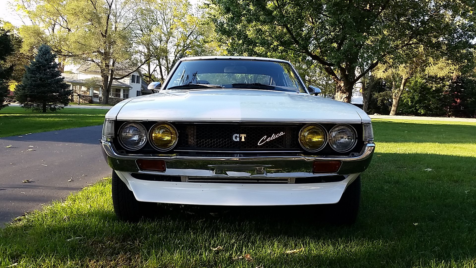

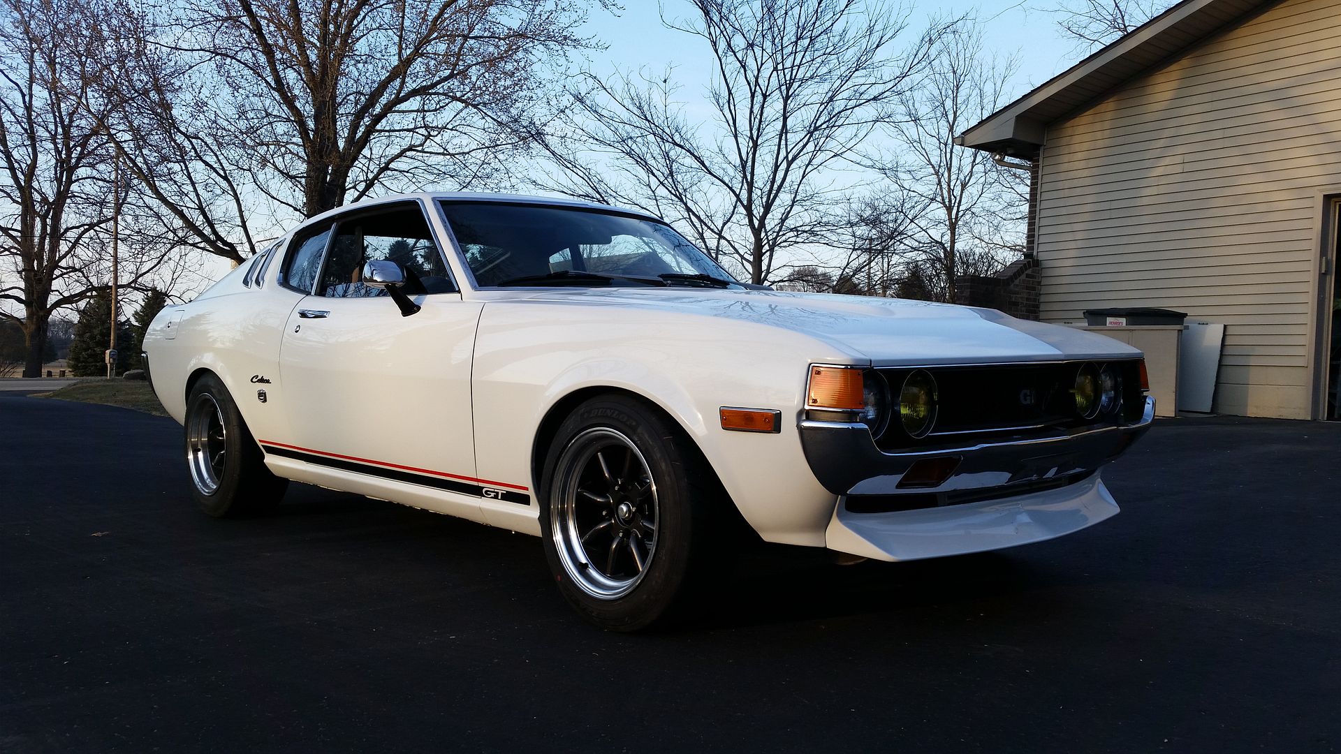

Here are a few more pictures of the car mostly finished (except for 3 pieces of stainless that I have been avoiding restoring)
I received the rest of my duplicated stripe from W4 signs, and they are a perfect match and look great.
Let me know what you think!

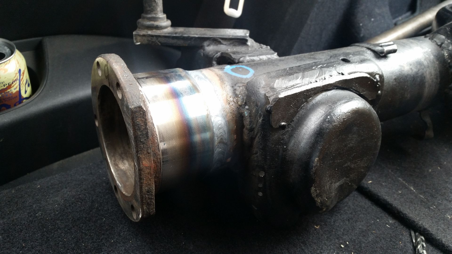

I have discovered a couple major issues with the car though.
Leaky head gasket I believe, not a big deal really, but annoying because I don't want to take it apart.
Also... The rear differential housing is cracked, in several places! I thought it was the gasket that was leaking again, but it actual big cracks in the housing! I guess that all of my... Beating on it constantly, with a stiff clutch, drag radials, antilag launches, and no lift shifting had taken quite a toll on the big 8 3/4" Mopar axle. It never crossed my mind that the housing itself could be a weak point with a little inline 6 with less than 450hp in a light car, but I guess I was wrong.

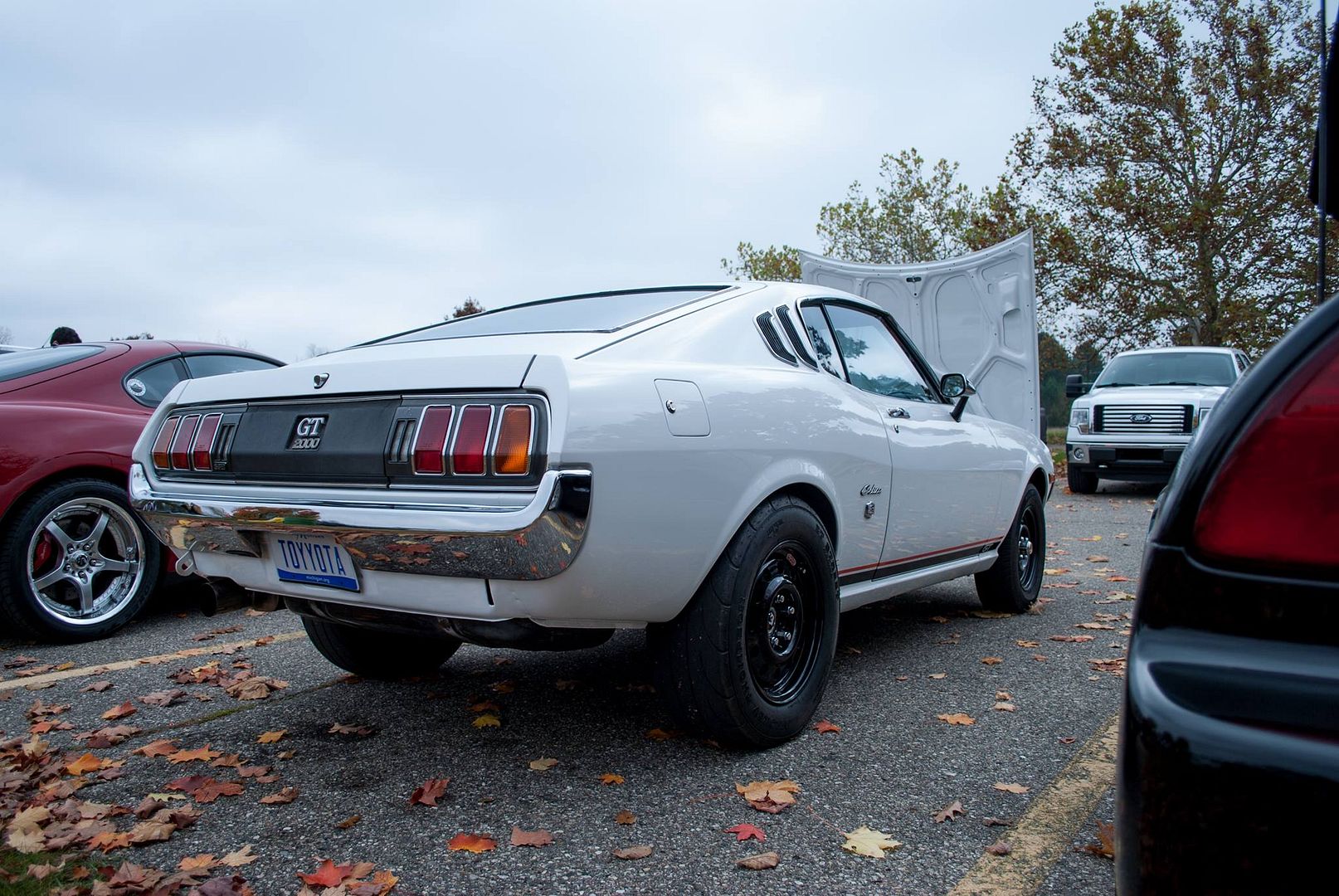

I finally caved and got a custom vanity plate "TOYYOTA"

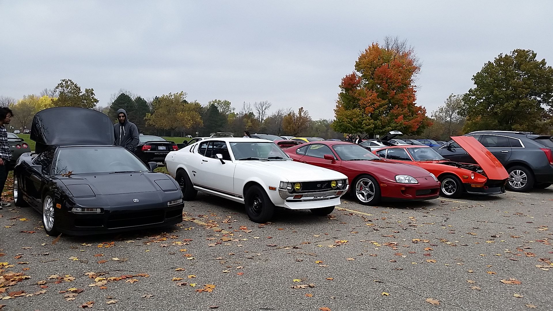

Local Fall car meet

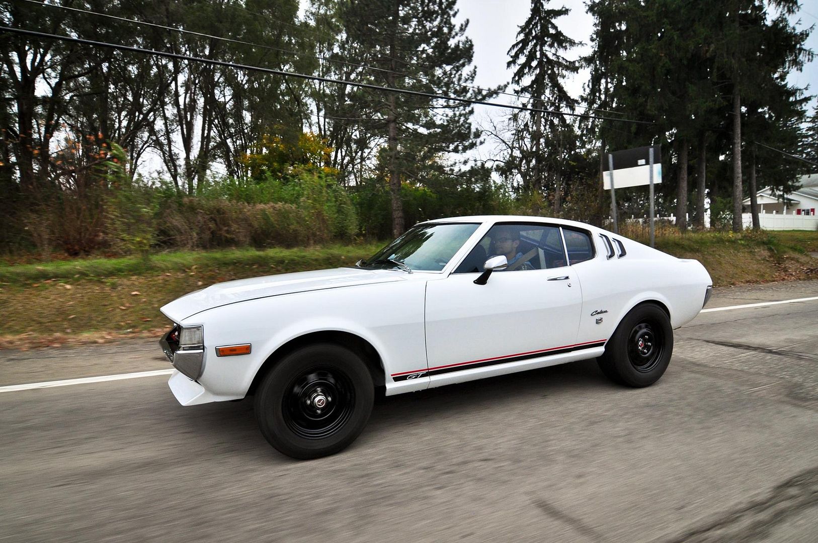

A friend of mine, Sarah, took some rolling shots for me at the end of the season...
6,618
Good company you keep at that car show man, representing the old with the new. Add a 2000GT and maybe an R32-34, toss in an S2000 for fun, and you have quite the good spectrum.
You know... I think I need to figure out how to make a similar picture happen. Probably not gonna happen around here, but I really like the idea. :)

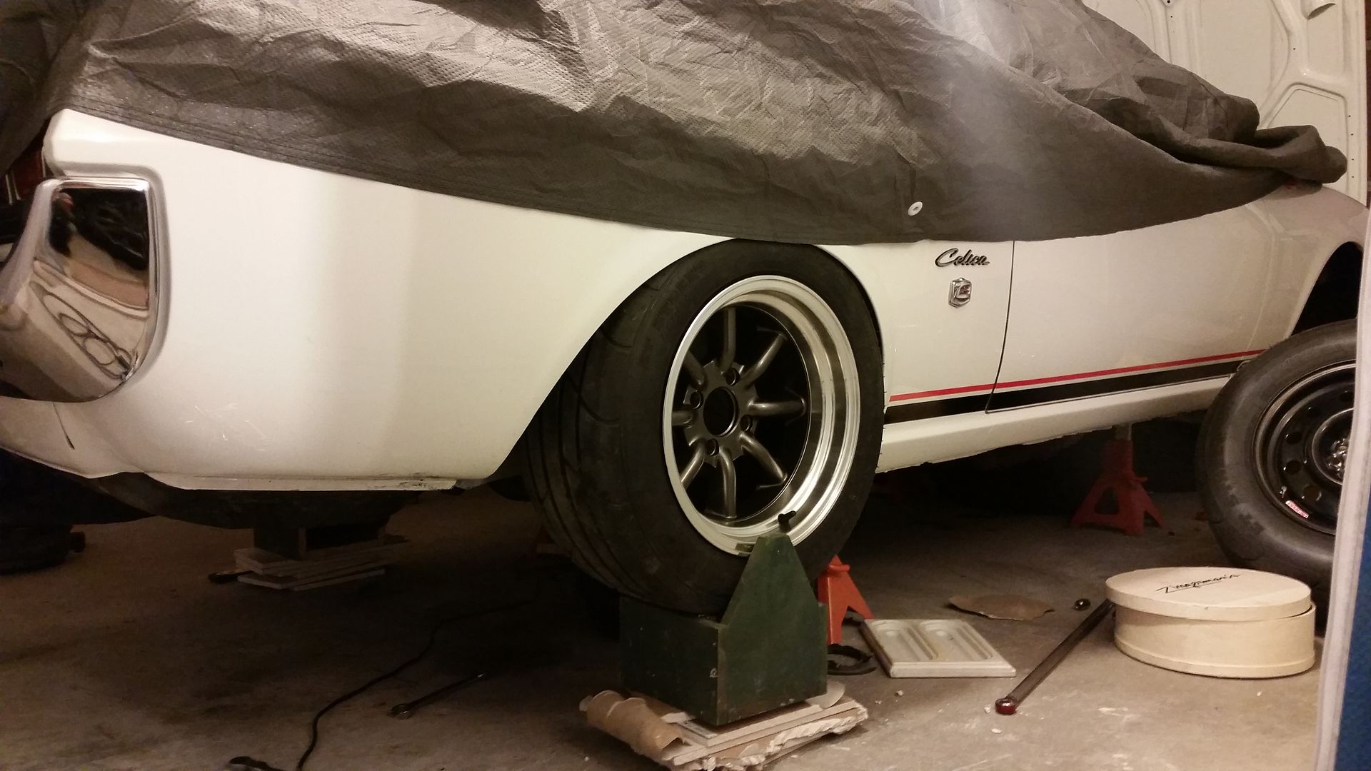

As you may have read previously, I had some issues with my rear axle. after weighing my options, I figured that it would be best to fix what I have, and to get it narrowed like I should have a long time ago. I cleaned the housing for a few hours, ground material out of the cracks, and then welded up all the cracks that I could find. I am confident that it will be fine with the new tire setup. After I fixed it, then I took it to DTS to have it narrowed, trued, and to get some new axles, In 4 lug. In total, I had the housing shortened by 5". Should make quite a difference!

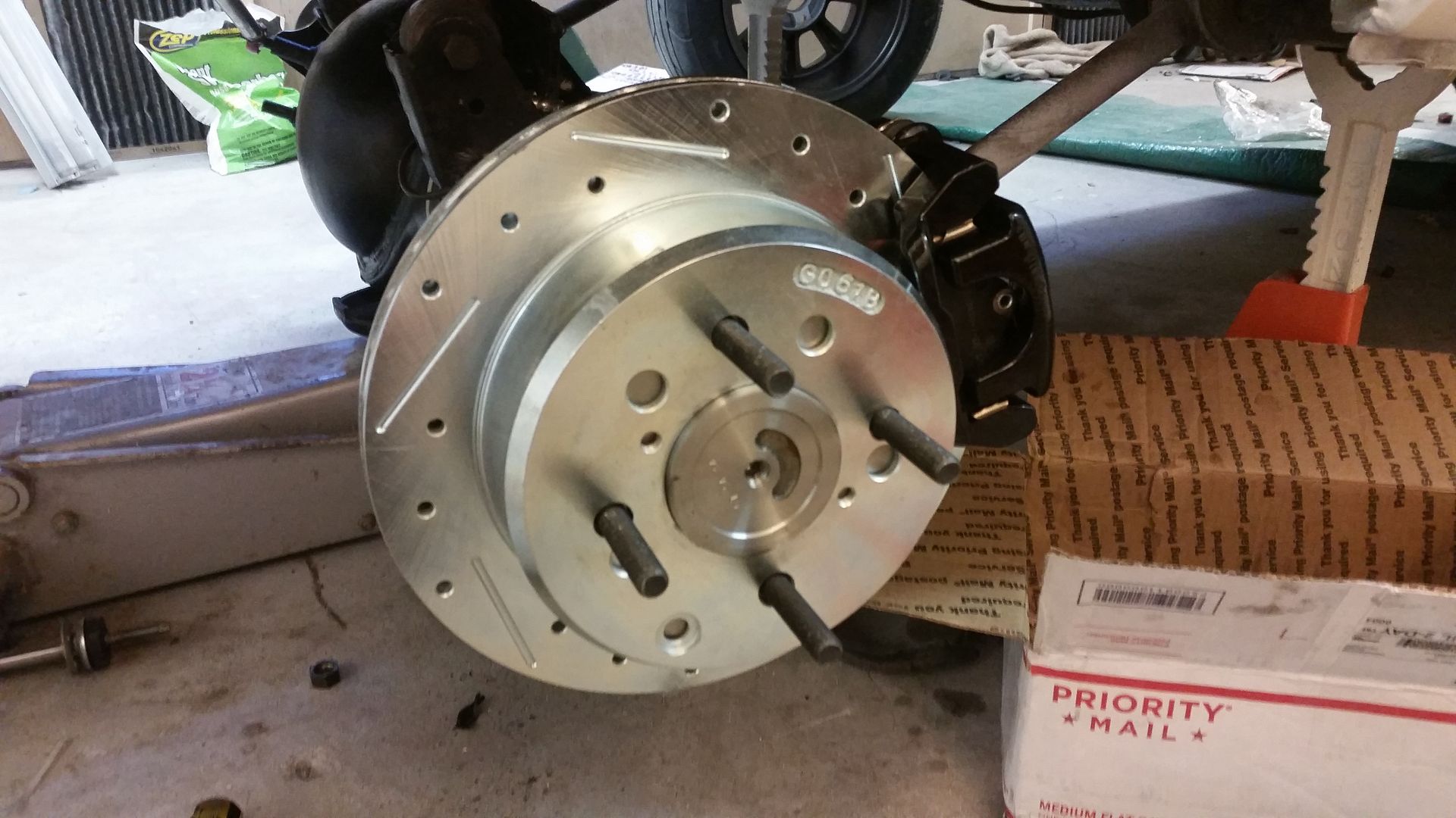

My old rear drum brakes had seen better days, and were never really set up correctly in the first place. Now was as good a time as any to final upgrade to something with a little more stopping power. These are Toyota Cressida Drilled and slotted rotors, with a Mustang Cobra Caliper. Should work nicely!!

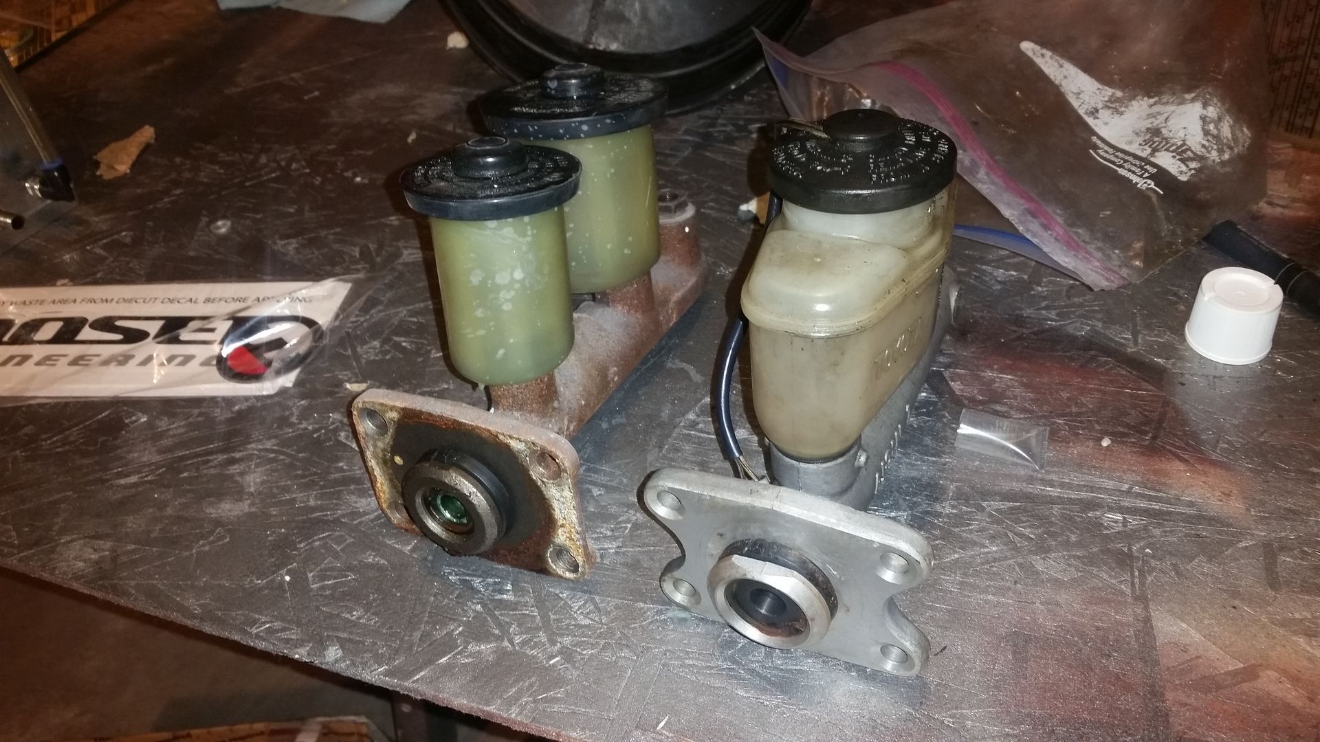

The Celica came from the factory with single piston brakes up front, and small drums in the rear. Now that I had a total of 10 pistons that needed to be filled when I wanted to stop, I needed to upgrade the small Master Cyl. The Celica Master is 13/16" and the MKIII Supra is 1". That seems like it will be enough! I got my digital caliper out and measured the mounting points, and the depth of the hole for the push rod. It is IDENTICAL, thanks Toyota! :lol: I was going to use the Supra booster as well, but I didn't really see a need for it at the moment. I can always upgrade it in the future.

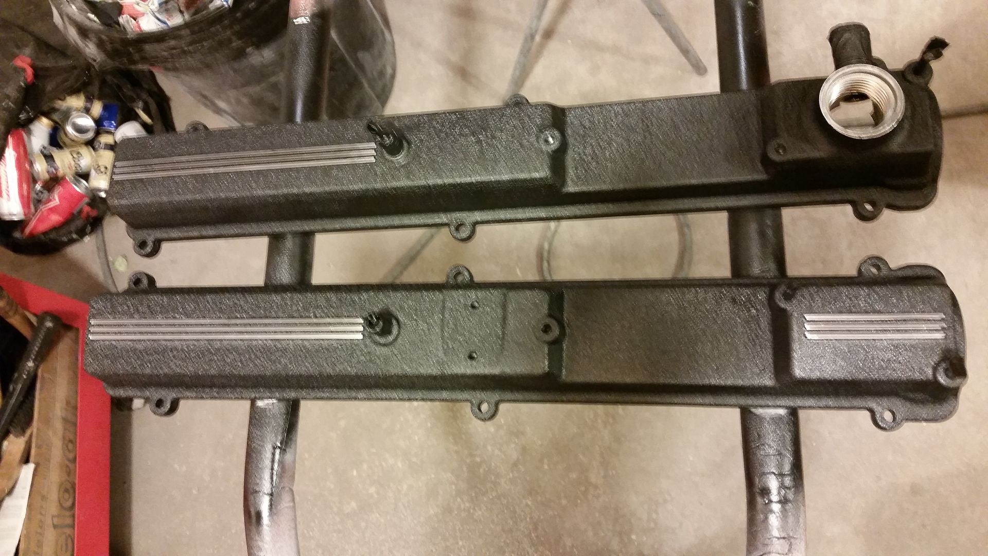

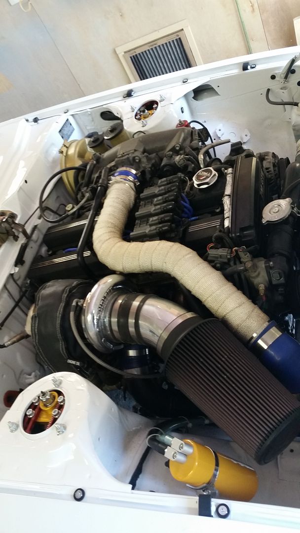

I have known about some issues with the engine for a while now, typical 7M issues haha. It pushes air out of the cap after beating on it, so I am just assuming that the headgasket had a bad seal. Pretty safe assumption with this engine. I mean, it sucks and all, but I have already dumped too much money into it over this past winter to really be able to fix it properly. I just pulled the valve covers since they were leaking pretty bad anyways, and retorqued all of the headbolts, which I never did again after initial engine assembly, years ago. That can reall only be a Band-Aid for a larger problem, but it is all I can do for now. It still runs fine, doesn't smoke or use or mix coolant, so I will just run it for this season, and pull the engine next winter for a proper fix, since I have the feeling that the block is pitted and will be need to be decked a bit more, or even replaced.
I painted the valve covers silver about 5-6 years ago, so I refreshed them while I had them off. I used VHT Wrinkle black, they came out great!
Also, I finally bought that turbo blanket that people have been suggesting for a while. To hide the ugly rusty turbine housing in an otherwise nice engine bay. Looks good!

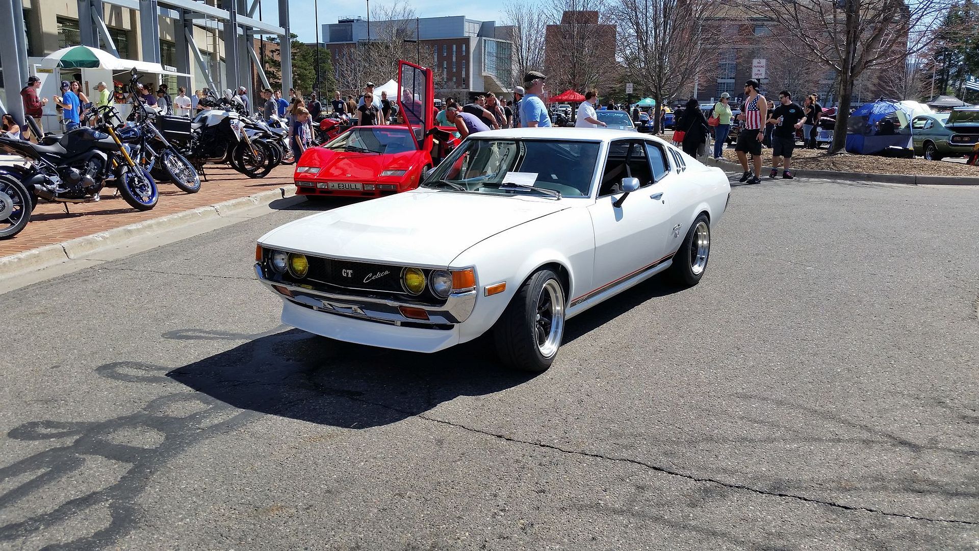

I've been enjoying the car quite a bit this year. It's not normal for me to have it out so early because I always end up just working on it all summer!

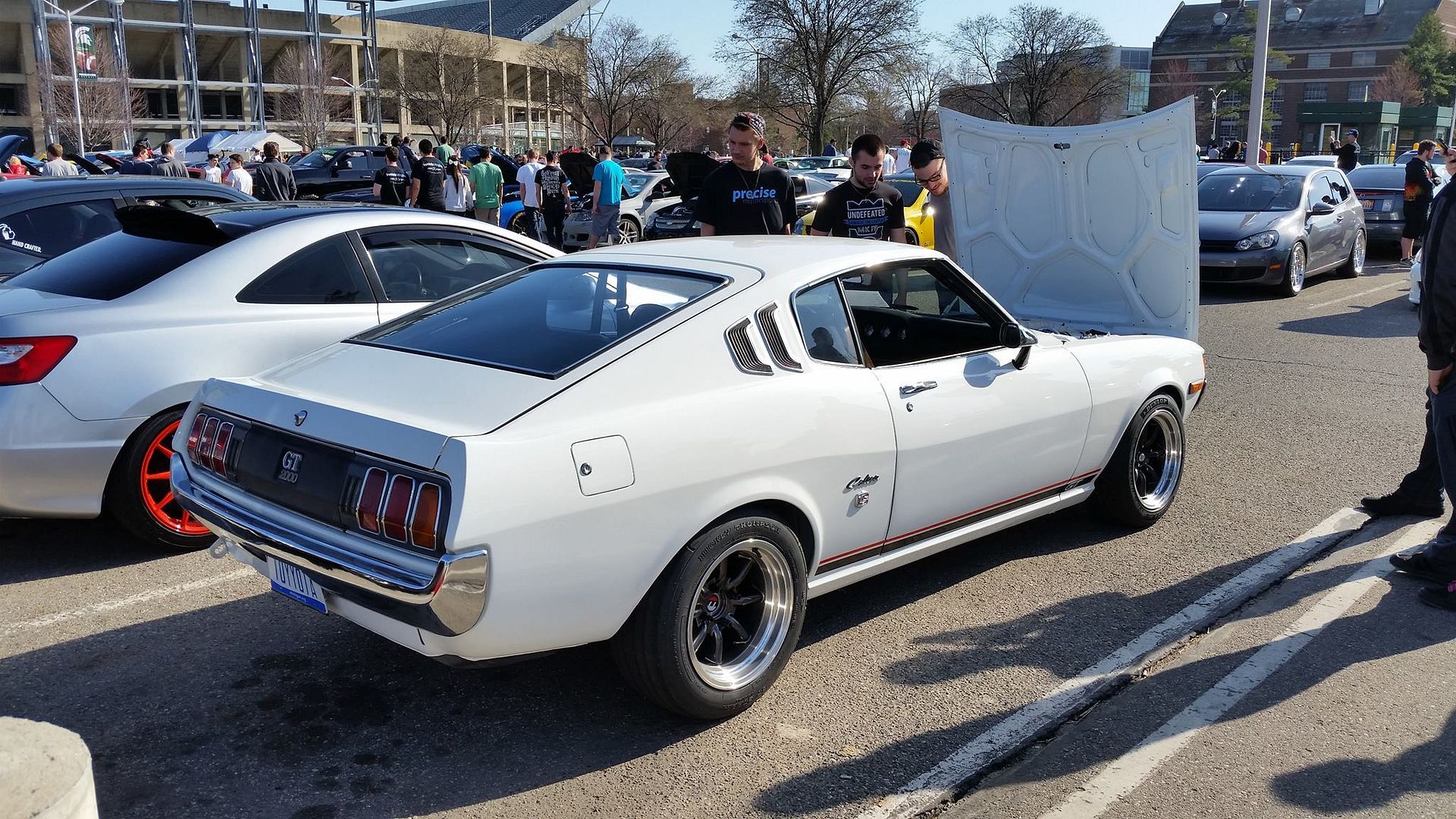

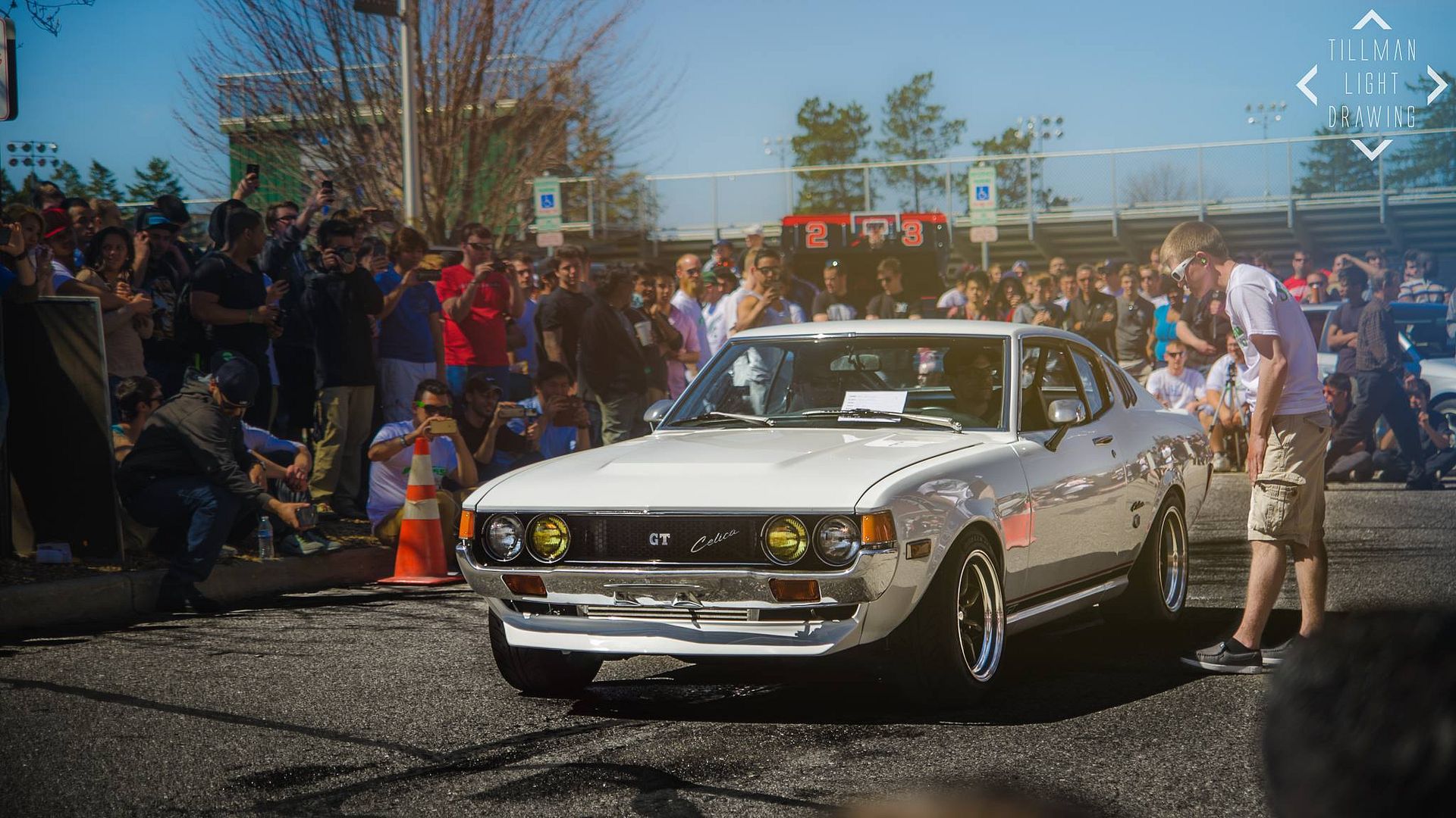

Here are some pics from the MSU car show.
This one is my favorite! I have it framed on my wall now!
