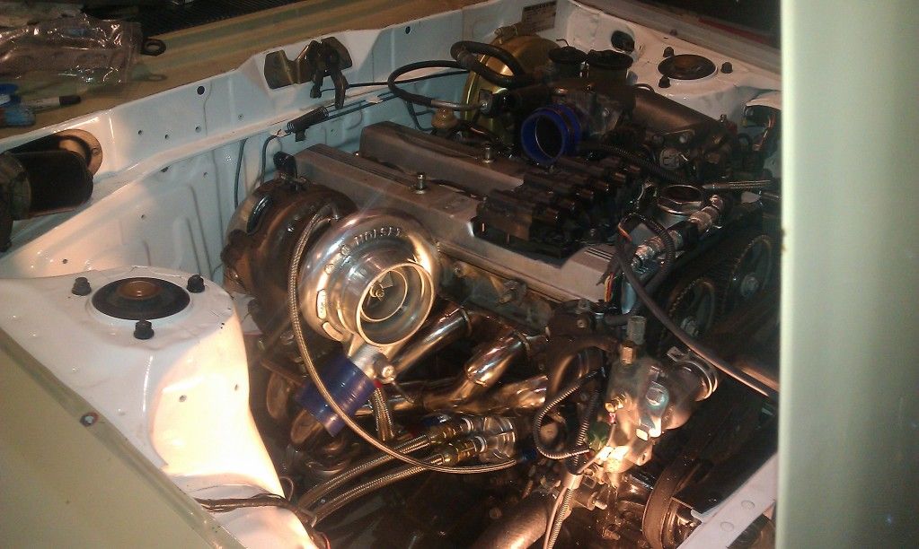

Been working on the car quite a bit more than uasual. Trying to work on it as much as I can while the weather is still iffy.

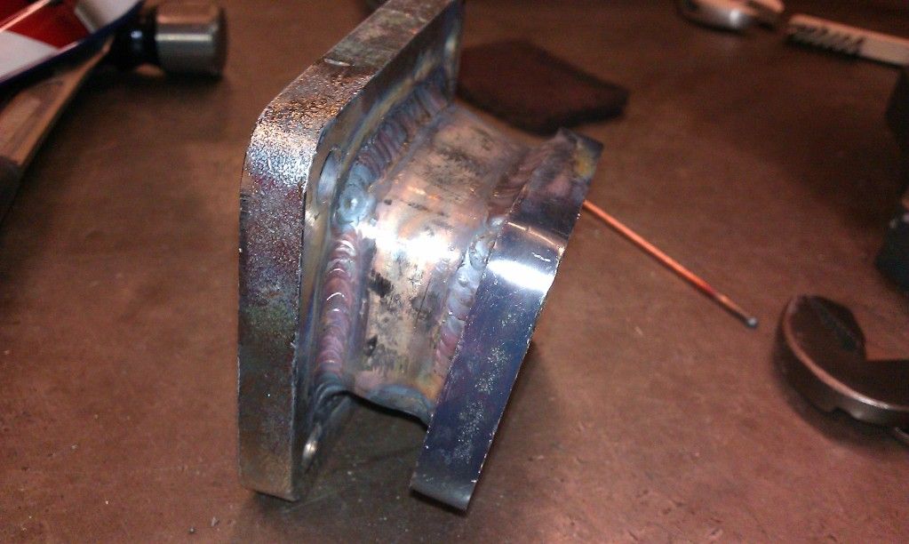

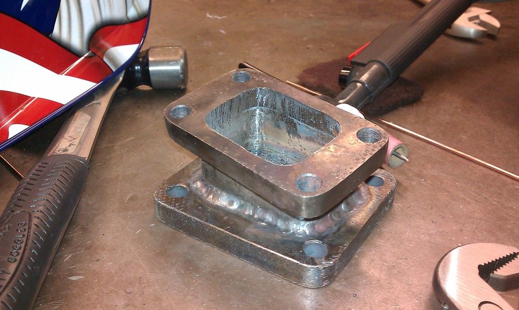

The Holset is a T3 downgrading and my new manifold is a T4 flange, and I didn't like any of the adaptors out in EBay land, so I just decided to make my own so I could fit the bigger turbocharger more easily.
Here is how it turned out, after a few hours of work. It was pretty tough to make because I rotated the housing away from the head, and angled it towards the headlight a little bit so I could make up a new intake pipe. My old intake pipe will simply not fit, the turbo is in the way, so I will just have to get creative with a new one. A front facing intake manifold would really help here... But I don't have that kind of $$ right now. I would rather just make one myself, but the TIG welded that I have acccess to is only good for welding steel.
This is pretty much my first time doing any real TIG welding, but I think it turned out pretty damn good for not knowing what I'm doing! Pretty excited about that haha

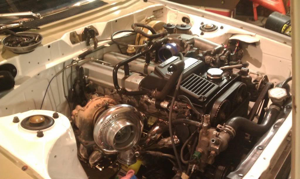

Now I could finally set the Holset on there properly so I could get a few other things mocked up.

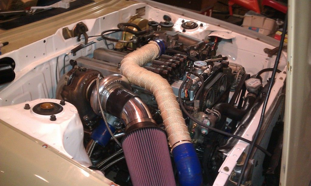

Here is my idea for the intake pipe as well, it will have to he heat wrapped like the last one since it is right over the exhaust.
Up next:
Make turbo oil drain line
Fab new downpipe
Weld intercooler pipes
Change oil cooler system and add remote filter adaptor.

Not the turbo exhaust, but the manifold really... I think it will heat soak pretty bad sitting right there.
I was worried about using a turbo blanket, since it's only oil cooled, I don't want to trap too much heat in there, since my downpipe will be wwrapped as well.
6,611
7
Routing of the IC piping looks quite similar to Tyler's car... I forget his screen name on here, but it's a pretty well sorted car. Is coating the pipes an option?

meh it will be fine the way it is
if you are worrie about heat just tack on some nuts to the charge pipe then weld on sheet of steel or half cut pipe to the nuts thus maken a air gapper heat sheild
6,611
7
Make something similar to the stock heat shields... not sure what exactly that material is, but it does a damned good job, pretty similar to what Nash said.

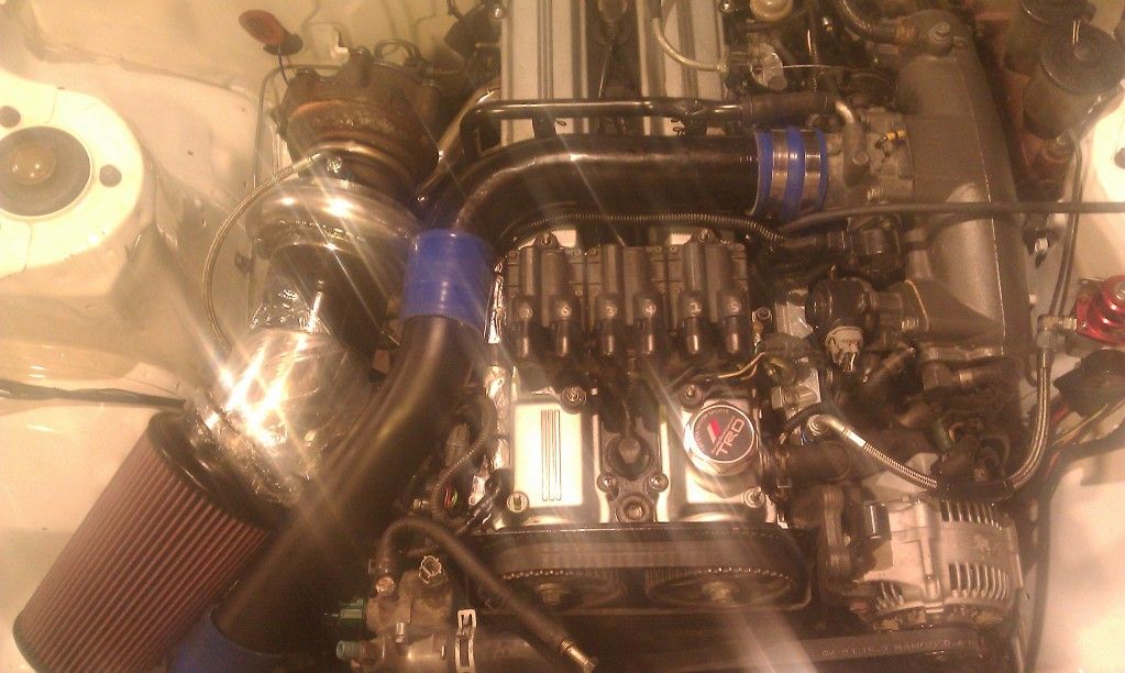

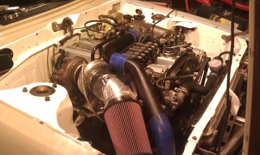

Just a few things left to do before it's ready for the road again...
Oil filter relocation and thermostatic cooler is pretty much done, currently making a new downpipe. New intercooler pipes are now all welded up, just have to button everything up!
