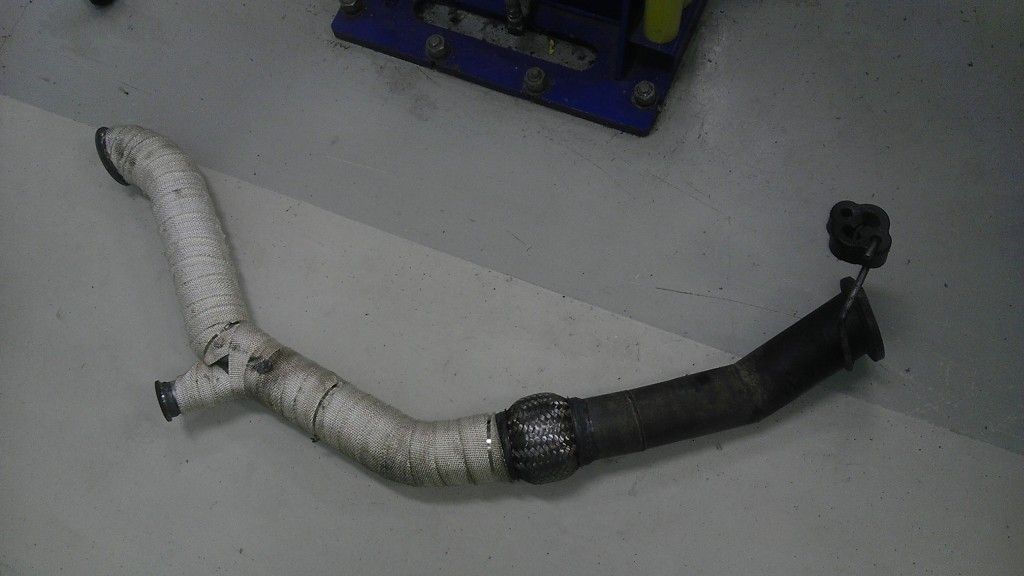

Last night I welded up a new downpipe and recirculated the wastegate into it as well... I have been debating weather or not to recirculate it, but since it is such a small hotside I figured it would be super loud from a real low RPM, and that kind of gets rid of the sleeper effect.

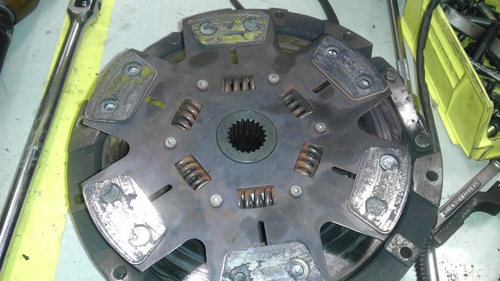

I drove the car for a while and enjoyed it til I finally found some motivation to pull the trans out to swap the clutch out. It's not exactly easy to get the trans out of the tiny little tunnel that it is in..
I ran into a few issues.
I have about 4000 miles on this clutch/flywheel combo since I built the car

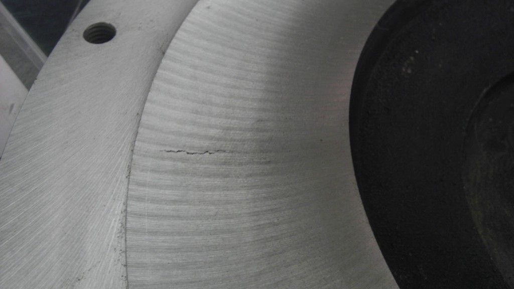

Disc is toast

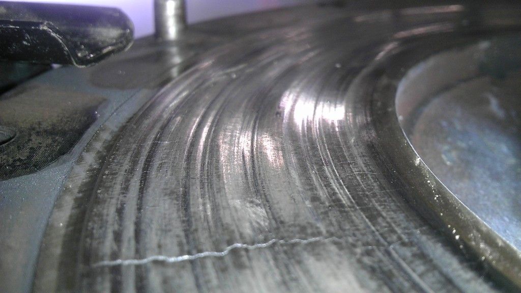

I saw a bunch of cracks in the flywheel
Splines on the axle shafts are twisted.... oops
No pic, but I'll take one when I pull them back out
I thought I would still try to have the flywheel machined to see if the cracks were just on the surface
They were not :/
And since I haven't posted it, here is the the downpipe that I made myself

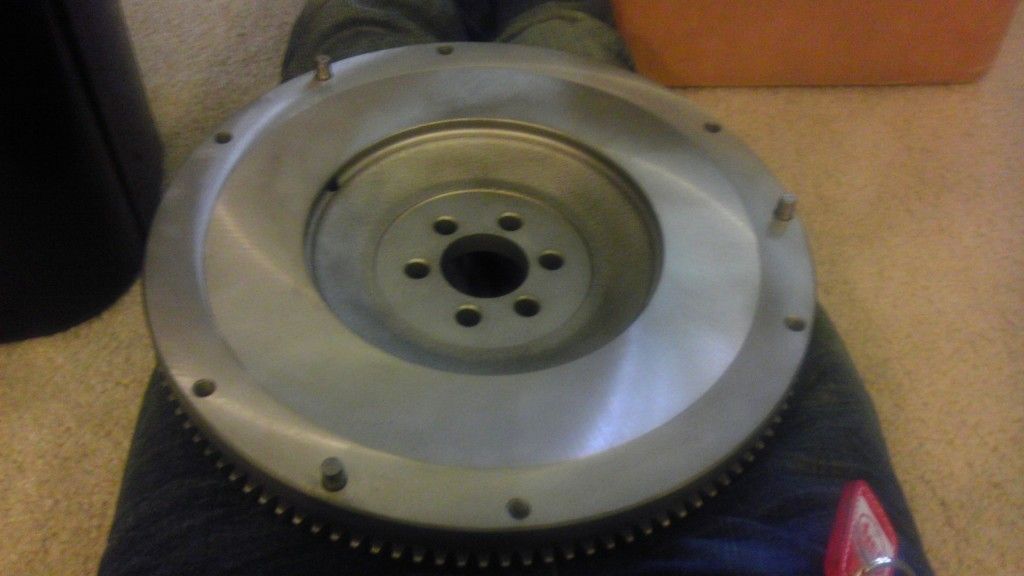

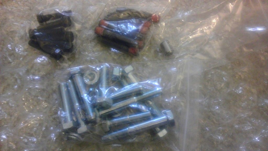

I had a hell of a time finding a OEM flywheel.... Dealers said "Not available in North America" No good.
I found a ton of lightweight flywheels for cheap, but I didn't want anything to do with those.
Eventually Aaron @ Driftmotion hooked me up with a used and already machined one
Purchased a bunch of new bolts, studs, dowels, to hold everythign together. Also new ARP flywheel bolts becasue my old ones I messed up getting them out (not pictured)

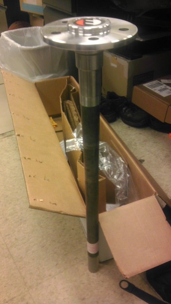

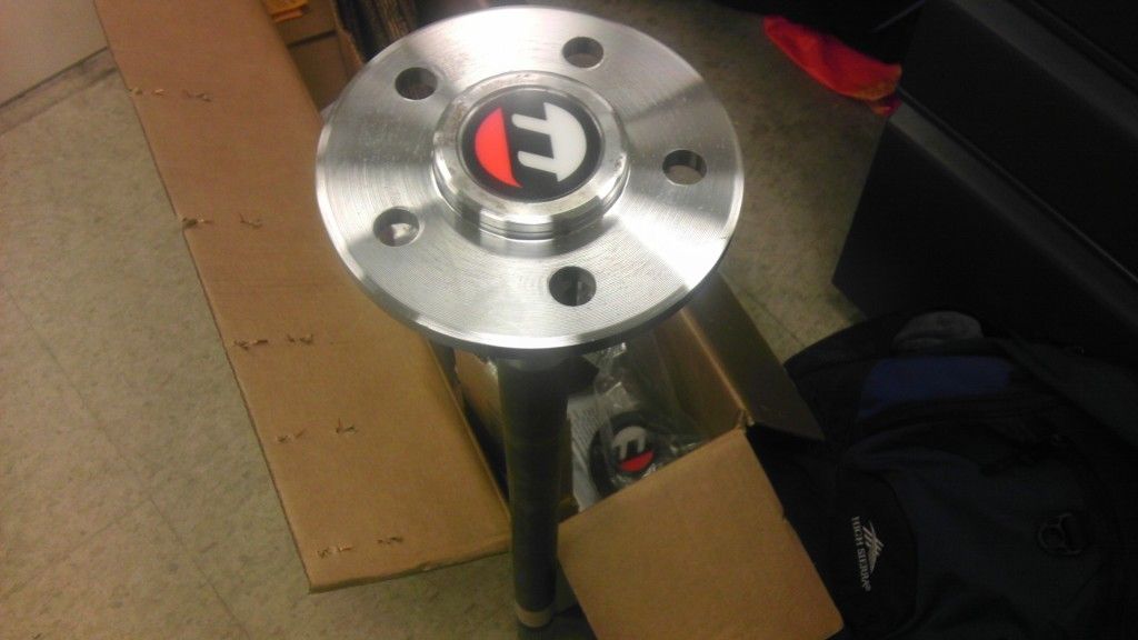

Since I have been traveling a lot lately, I had a little bit of extra money, so I bought some new Moser drag axles so i could replace them before they broke :D
They are amazing
Will be getting everything all put back together within the next week.

Always like shiny new stuff...
As for the flywheel, double check the JZ Swap for Dummies thread (not saying you're a dummy, just a lot of good info in there), IIRC, you can use the 2j flywheel with the R154. Could be wrong though, so check my math.
Curious why you don't want anything to do with a lightweight flywheel. Mind my asking why?

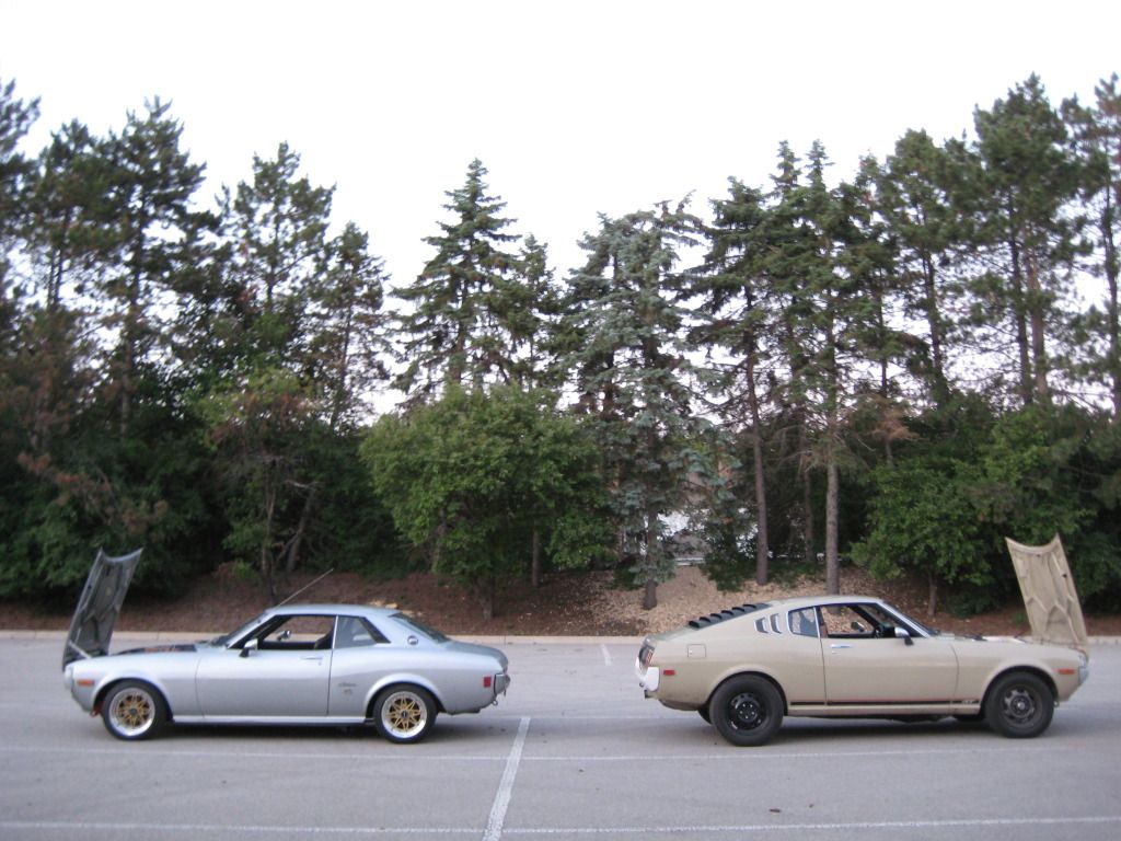

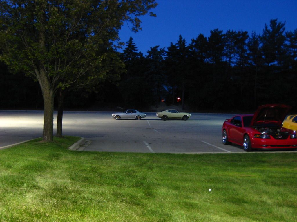

I did a LOT of V8 Killing over the weekend after the "Woodward Dream Cruise"
I got about 15 ish races in, all pretty quick cars, including... Z06 Vettes, Modded new M3, X5M, Fox body stangs, an AMC Rebel, and my buddys modded Grand National running 20psi and E85.
Here is the list of cars I lost to:
:woot:
Still the ultimate sleeper out there, nobody had any idea what was coming, the car is quiet, and all you can hear is that big Holset spooling up....when it's already too late! Goodbyeeeeeeee
Also, Friday night I met up with a member from here
Meeting up with Halik with his 1977 1UZ powered Celica
