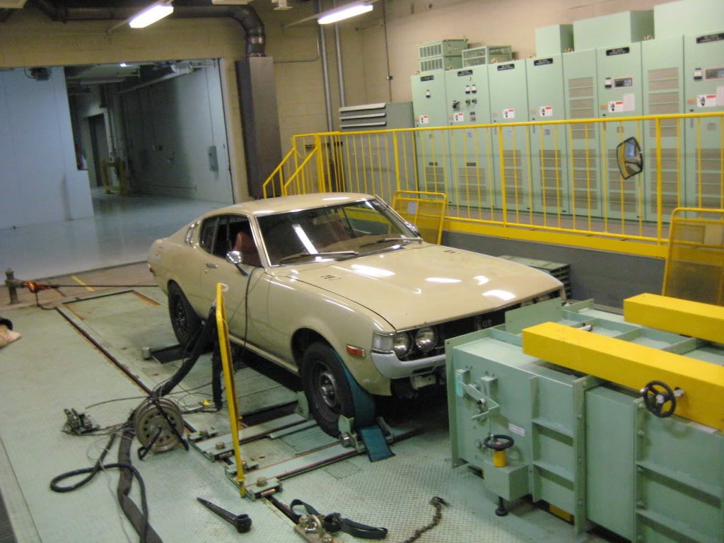

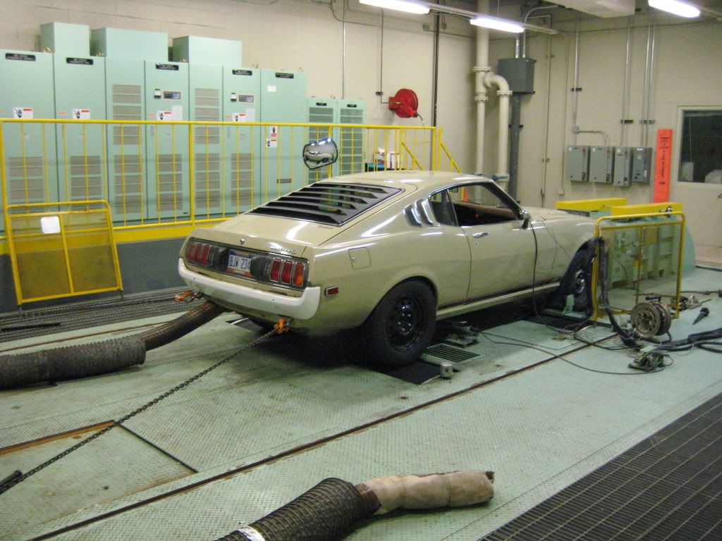

Success, completely driveable now, still have some work to finish with tuning timing though.

Interesting place you're tuning your car at there... that looks very official, like an R&D facility or something! :D
Hehe, I am a very lucky guy to be able to use this dyno!! Absolutely amazing piece of machinery! (At my work, yes a R&D facility)

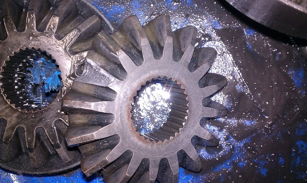

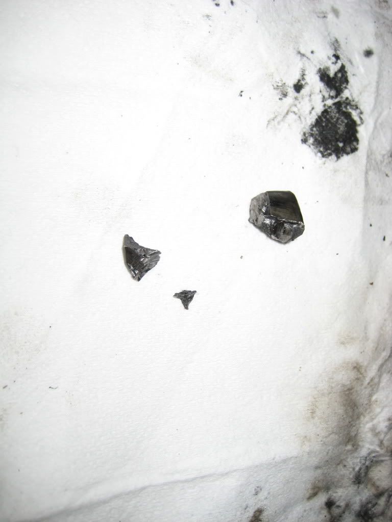

When I made my runs at MILAN, I ended up breaking a tooth off of the spider gear inside the diff carrier. So the car is going to end up getting a Torsen Trutrac (which should be AWESOME on the street) and a 3.55 gear instead of the current 3.91. I'm already at redline in 4th crossing the stripe at 122, so the 3.55 should push the 4th gear limit to 135 or so.

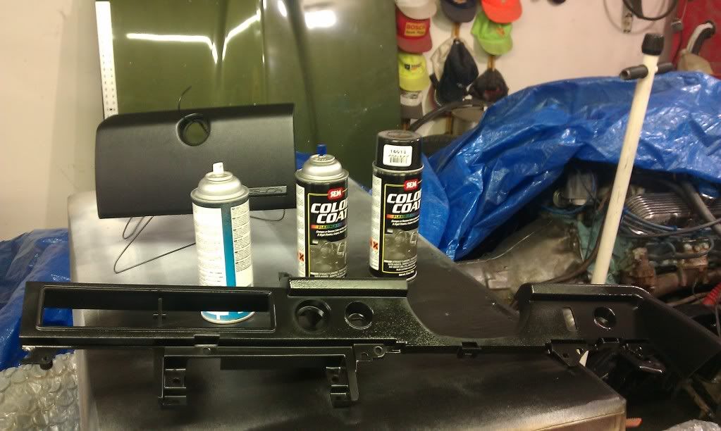

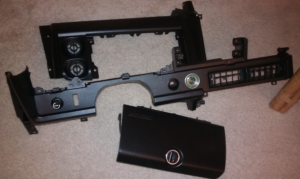

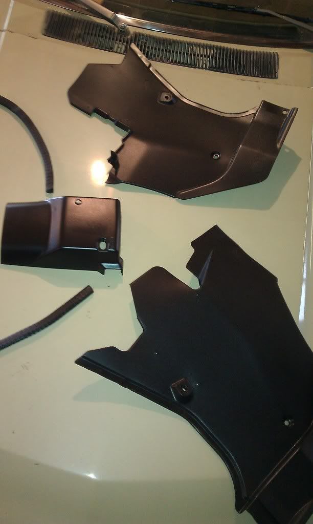

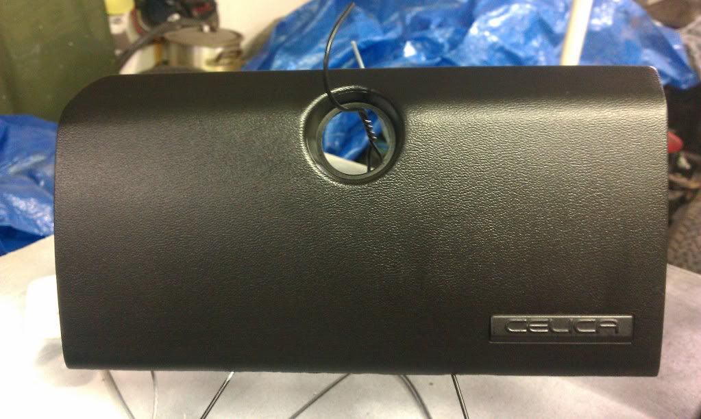

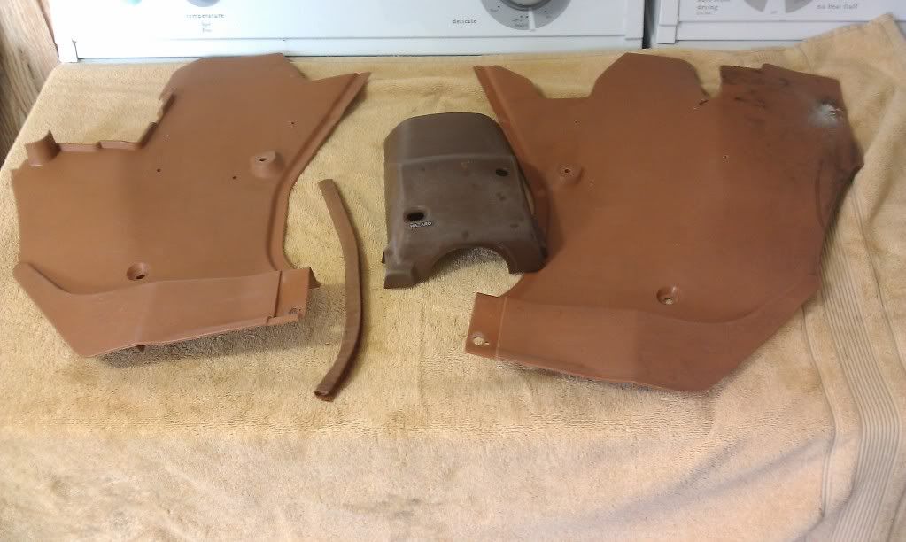

In the meantime, while I was trying to save some cash to buy those differential parts, I decided to do something about that horrid color of the interior.
The dye/paint is still wet in some of these pics, it looks much better when fully dry. Turned out great! I have many other pieces done as well, just no pics.
Reference before pic
Parts after black coating
speedfreak426
Mar 31, 2008
380
Brighton, MI

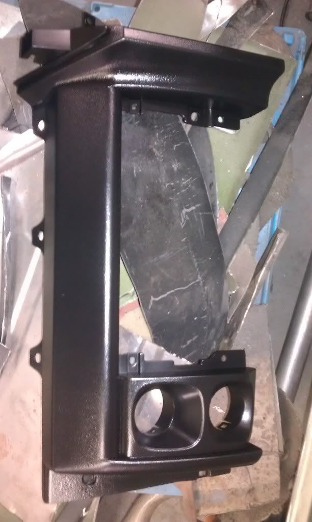

Here is another before pic, just becasue I would like to keep a record of everything.
some dash pieces after

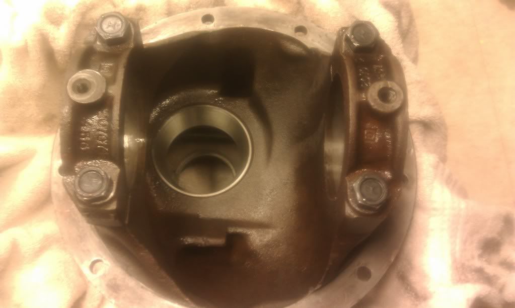

and while I was over at the garage, I took a picture of that actually happened to my differential at the race track.

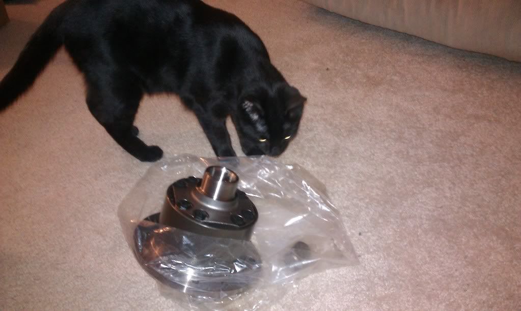

Here is a my new Eaton "Detroit Trutrac"
"Ratchet" approves!

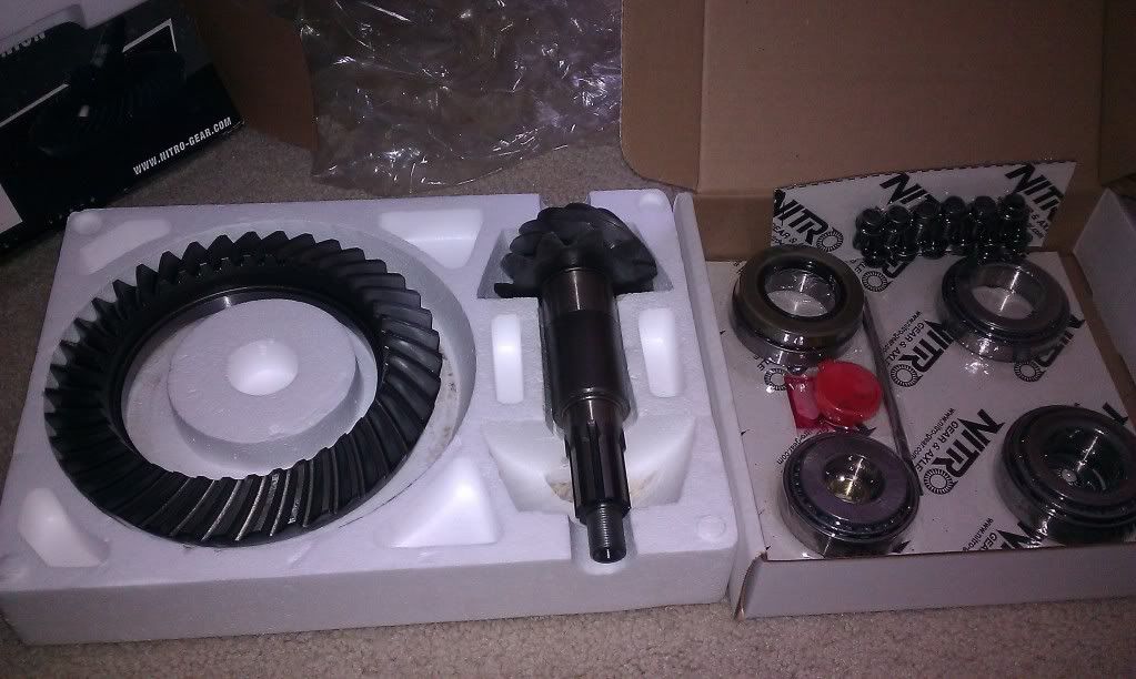

More new parts!

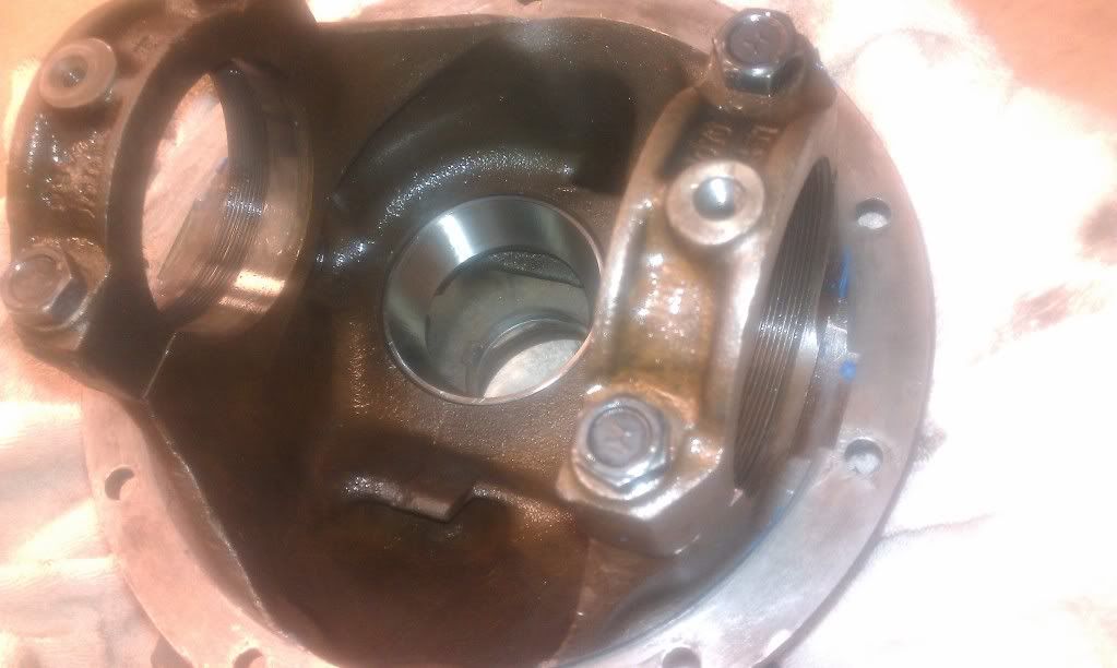

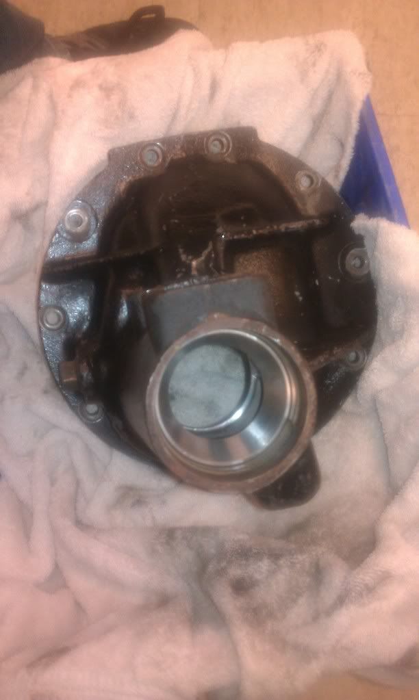

I recieved my 3.55 R&P, and master rebuild kit... ya know, bearings and such

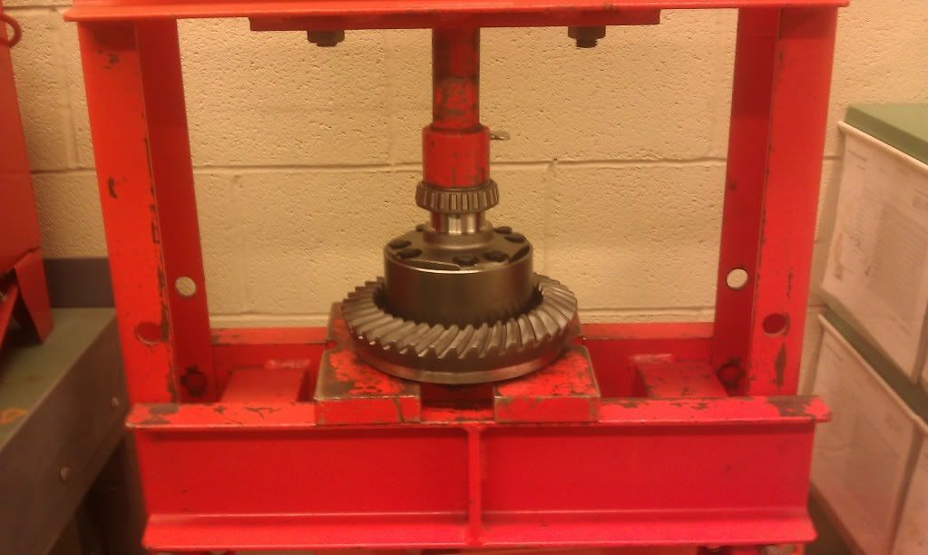

Started to put it all together last night, I will be doing this myself of course.
How can you learn and educate yourself if you just pay someone to do it for you?
Pressing on the new bearing after getting the ring gear on there. Having some issues with the company I got the ring gear bolts from... they are useless garbage, so I will be delayed on getting it completely together until I can get some good bolts
Drove out the old races and pressed in the new ones.
Also repainted the dash parts the way it was from the factory, with some silver. The part around the air vents, and the "CELICA" lettering
