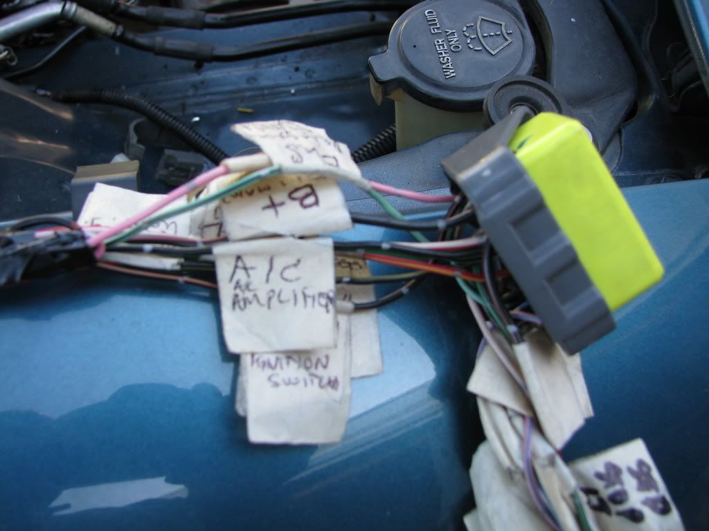

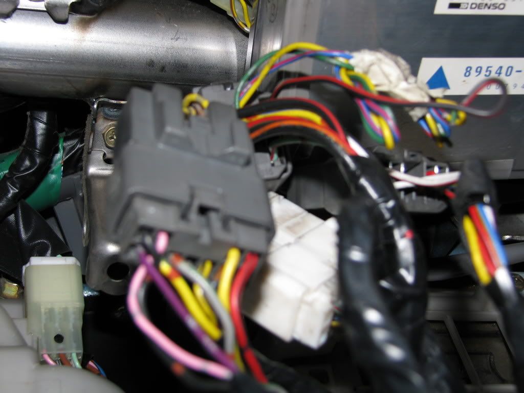

Took off all the plastic crap and ran the wires to see how much extension I needed. From the looks of it, I would only need to extend a few really. most of the reaches adn the Greddy fields harness I have gives me 6 inches extra on the wires length . :)
I decided to strip off ecerything from the harness and will label ALL the wires I am going to use.
Then I am removing all Atomatic tranny and traction contrl and a few VSV wires from the harness altogether. This will simplify things and make the harness neater.

Anyways, I removed all the Automatic and traction crap from my Harness. Its so much thinner now lol. Now Im laying it down in the car and it seems most important wires will reach without extending. Im trying to take a different approach this time. Instead of just cutting every wire and extending them, I am only doing the ones that come up short. This will save time and keep the mistakes to a minimum.

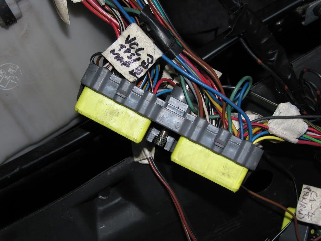

I also went through all the ecu pinouts and marked all connectors and which ones to use so I don't have to guess. It's time consuming but outcome will be worth it.
So far so good. The wires are layed up in the engine bay and I have made notes which ones will get extending and which ones will need to be added to the harness. Still working on it.

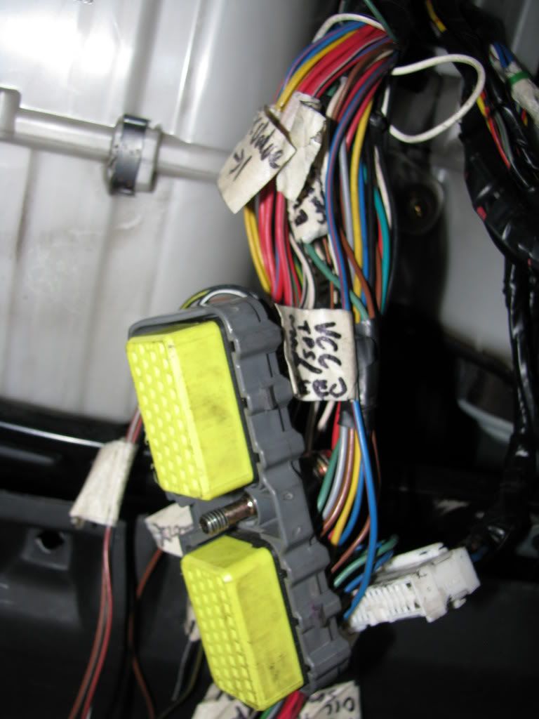

Need to transplant some wires into the ecu plugs. I smaller 40 pin plug I got does not have any wires for the M-REL and BATT - basically all the power wires....sucks. Need to pin these slots with wires..shouldn't be too hard as I have a spare plug.
Alright........the snag is no more :)

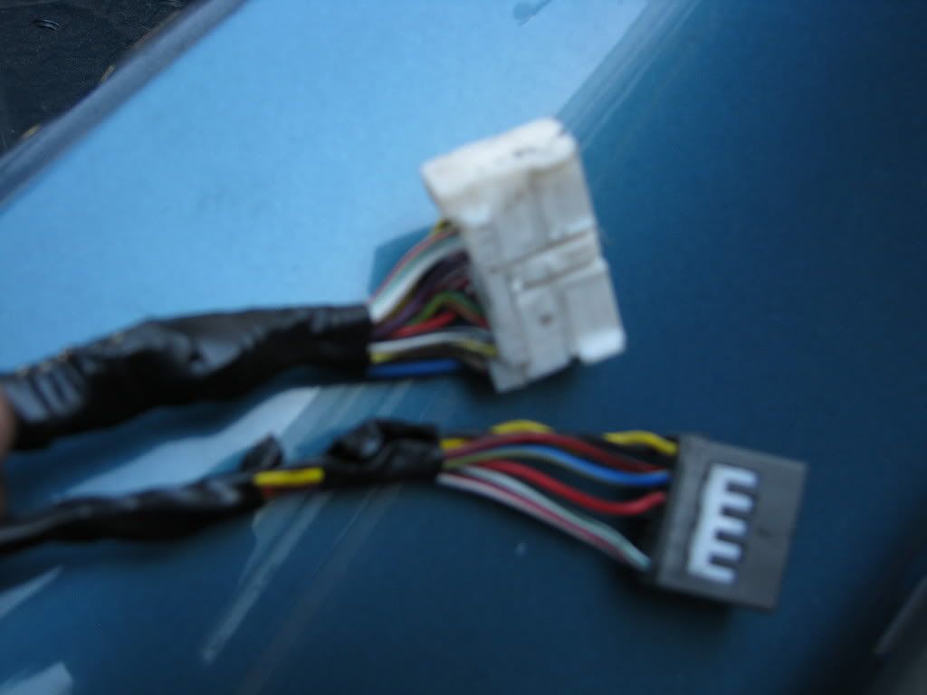

Looks like I have soldered on all the needed wires for the power/sensors/signals on their respective 7mgte plug so now this harness is plug and play :). I won't be srapping it yet until the car has started and is runnning without any issues.
Only thing thing needs to plug in is the reverse lights but the wires and connectors are already layed in.

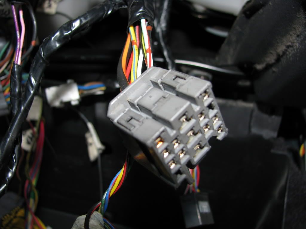

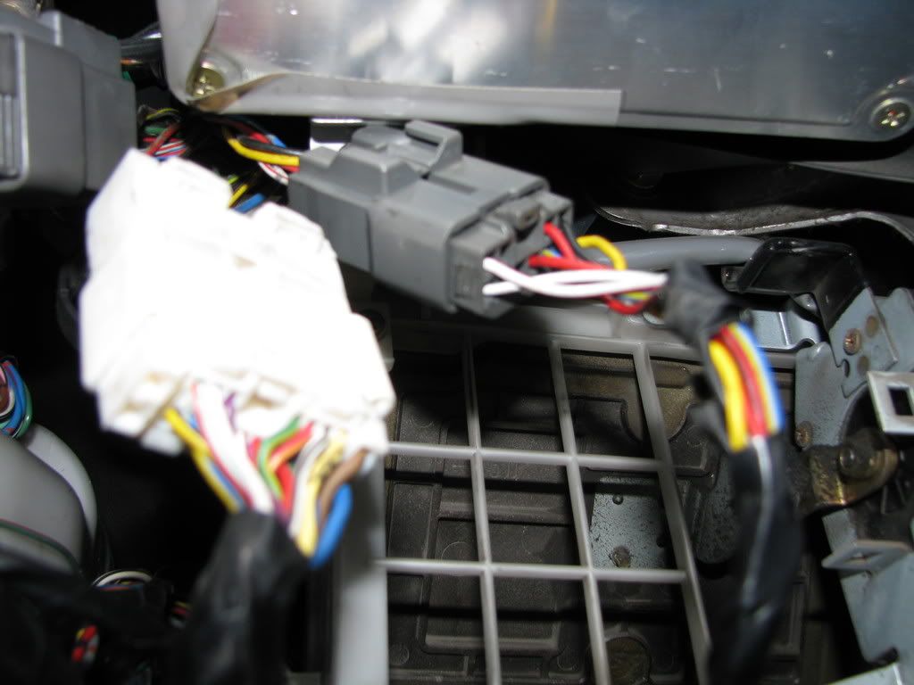

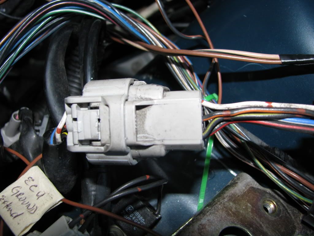

Whew....finished the wiring of the plugs and wrapped it up and shoved it through to the cabin. Looks factory length and seems to fit in with no issues.
Now the rea test comes - after everything is completely bolted up...I have to see if it fires up lol.Aiming for the weekend to turn the key :)
Note :
I did not cut and extend my harness. I removed all the covering from the Aristo harness and layed it down and plugged averything in its place. Then I shoved the harness though into the cabin and reached the glovebox without issues.
Instead, i only wired in the 7m connectors to the Aristo body harness signals and left the ecu plug as is. This has cut down on the extra wiring and cost as well. I did have to extend all 12 injectors wires and spliced the power wires. I have to say , i did not make more than 10 extensions if I did.

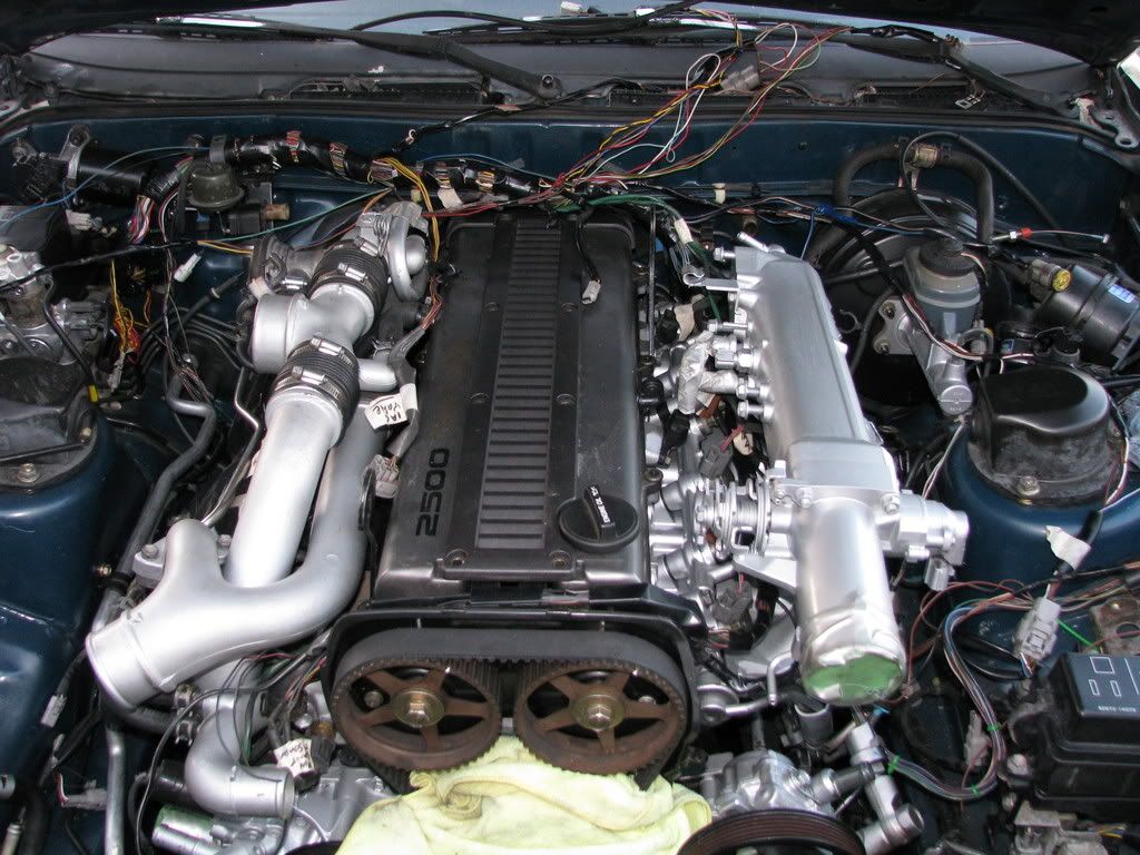

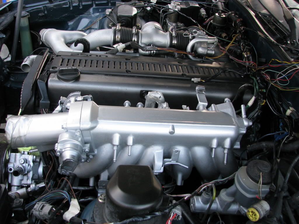

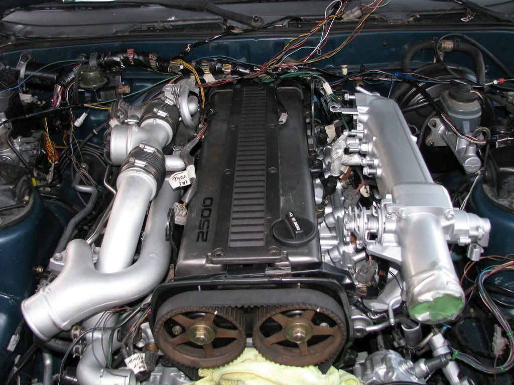

All right, a bit more progress.
I lost my fuel line from the dampner to the fuel rail :( sucks and held me up from bolting on the manifold. Thank god for the parts car sitting on the driveway lol. I will do the bypass mod later though.
Anyways heres how it looks bolted up . It will stay messy like this untill the engine starts and runs, then I can start wrapping the harness and making proper routing arrangements etc to clean things up.
Harness is done with 7m plugs mated up :
