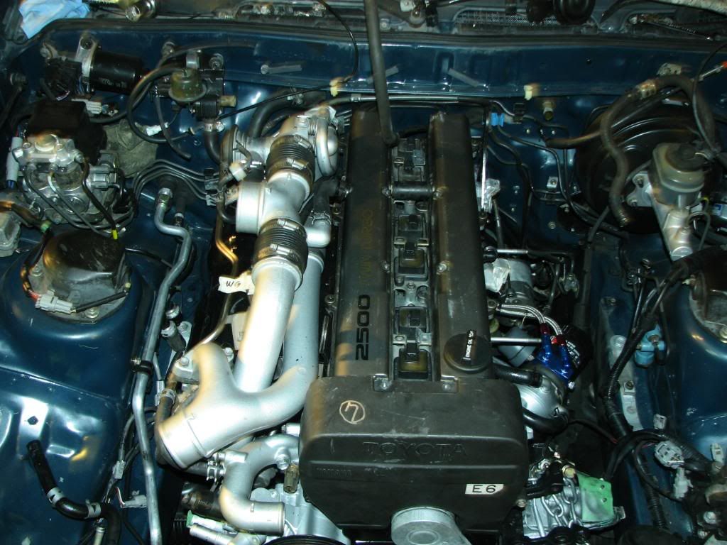

Well I had a window of opportunity today and decided to forgo with the engine install.
Enlisted two of my visiting nephews and go tthe engine in without much hassle.The clutch line is in the stock location .
I think it looks pretty good in the engine bay as it sits lol. I still have to bolt everything up though.

Looking good moe. I hope to be doing somthing like this very soon. I know how it is with the soccer thing to. Lol

Thanks man. Yeah I was glad I cut practice lol. But id not take too long to et this in. Now its all downhill from here. Cant' frigigin wait to drive this car :) .:biglaugh::biglaugh::biglaugh::biglaugh::love::love:

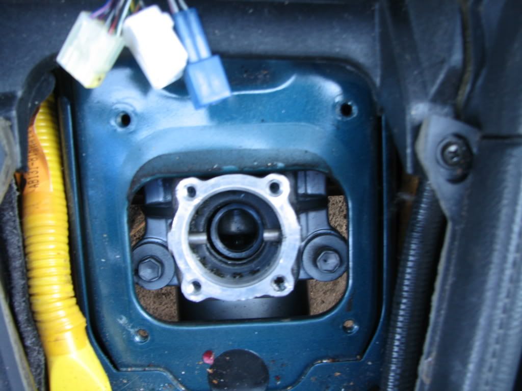

Did you have to cut your shifter hole to clear the R154?
Could you take me a pic if you didn't because it looks like i have to.

Yeah the auto hole is almost half the size of the 5 speed hole. I looked and it seemed to have lined up to go through, but did not pay much attention.
I will take a picture tonight and post it up. If I have to cut it, I don't think it will be more than a couple of inches.
The clutch pedal shouldn't be too hard. I have down pretty good as I have done at least three - twice to remove them and once to install lol.
Easy if you remove the driver seat and use a nice long extension with a wobble.:biglaugh:

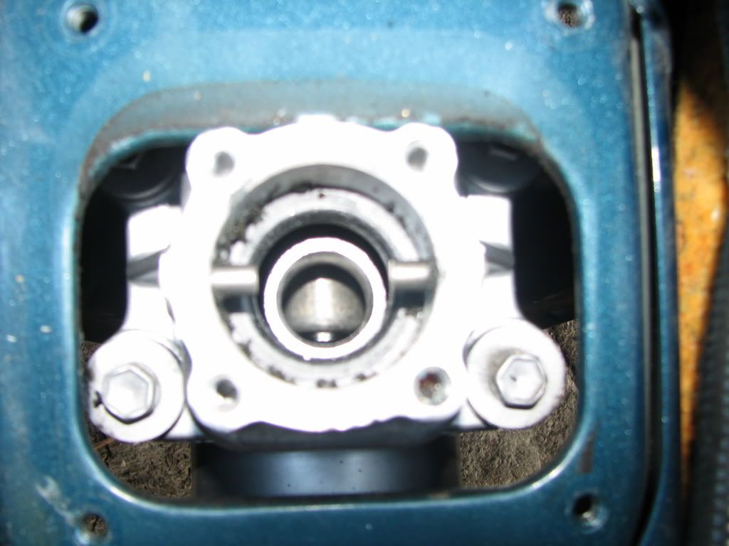

Okay so I may trim a little so that it does not contact the metal and vibrate.
Here's the picture of the auto tranny hole with a 5 speed as requested:
There is about a 1/4 inch clearance.
Strange; Everyone told me i had to cut the section towards the back. :confused:
That's enough Clearance for me.
You better show up to silv.
Thanks A LOT MOE!
Saved me from hacking my car for no reason. :)

Oh before you hack anything up, mock it up first as you may not have to cut anything. The 1JZ bell hosing is a little shorter than the 7m one and that may be the difference here.

Nah its not the shifter. The plates for the 5 speed will need new mounting holes made for. I willl use some self taping screw once everything is ready to be bolted.
