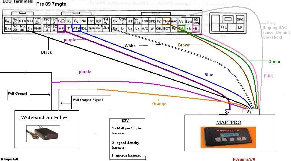

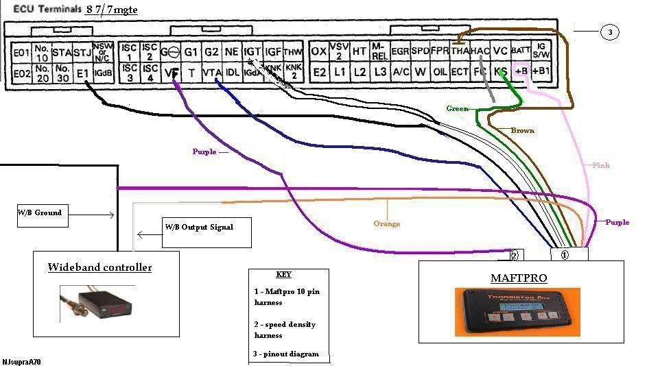

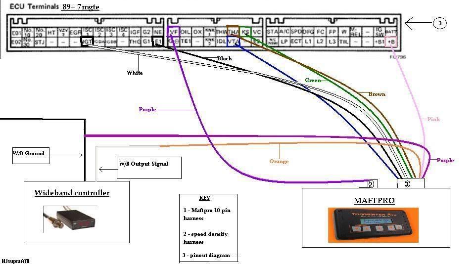

drjonez said:
no idea of your orientations, etc. make sure it's hooked up like this:
'89+
'87-'88
I wired mine up the same way NJsupraA70's Maft Pro wirte up had said + the Mpro Directions, and The only thing that is diffrent than the one you posted here is where the pink goes to on the ecu
I hooked the pink wire from the 10 Pin MaftP to The +B or the + B1, Bolth of the Pics of the pin out are diffrent? The MaftP would not turn on if that was wrong, correct????
I looked and I think +B +B1 are EFI main relays........
Other than that The rest of my wires are correct, But DrJ you had said that "location varies w/yr." Is there somthing Iam missing?

jkbmkiii said:
I wired mine up the way NJsupraA70's Maft Pro wirte up, and The only thing that is diffrent than the one you posted here is where the pink goes to on the ecu
they are different because you are looking at a 89+ diagram vs. pre 89. BTW - WHO edited my 89+diagram and made that one? I know my wiring diagrams are not exactly kosher but that one is real sloppy and I dont like the fact that my name is credited to that one!!. PLEASE ERASE IT! Thanks! :) Here is my pre 89 diagram:

i belive nj is right, i made that fake copy and i forgot to right any thing edited about it on there, i set my car up as of nj's diagram. i was getting code 11 with the pink wire on the other one..
