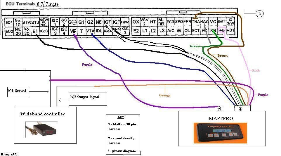

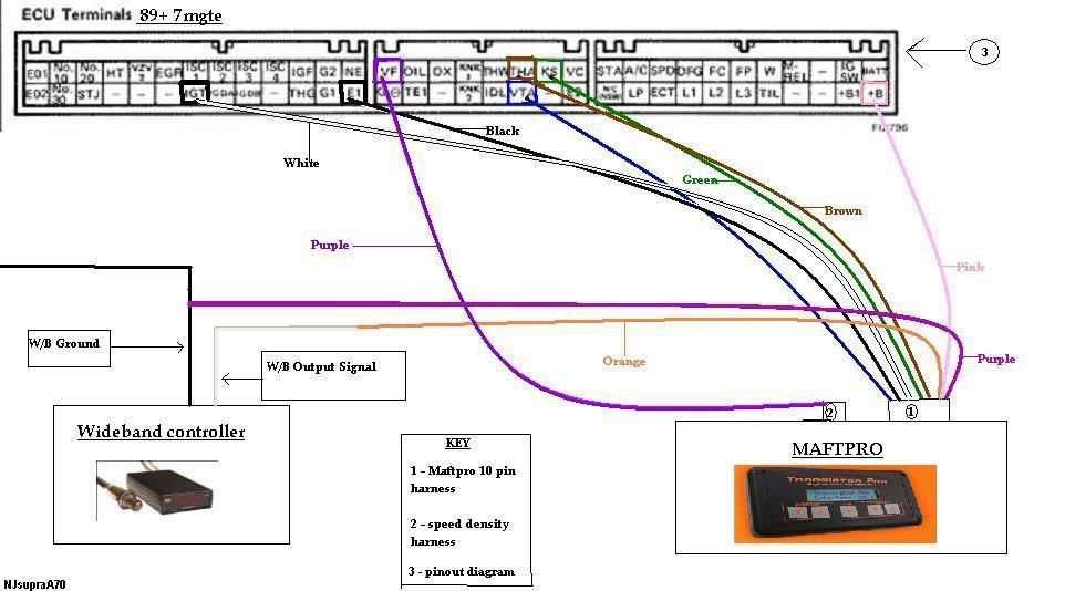

no idea of your orientations, etc. make sure it's hooked up like this:
'89+
'87-'88

i fail to see where the difficulty is. you have a mountain of resources at your disposal:
-you have 50 pages of q+a here
-you have the thread on SF
-you have the FAQ on MKIIItech.com
-you have the instruction manual
-you have the online TSRM
-you can get in touch w/me personally
installing and using the MAFT pro is no more difficult than installing any other piggyback. there are no secrets, no magic. if this install is out of the scope of your abilities, you should seek help- whether that be a local supra guy or a qualified shop.
i've reposted the install images above, they've been on this thread and the FAQ on mkiiitech.com for months....your wiring MUST be as above, if it's not then that is your problem.
