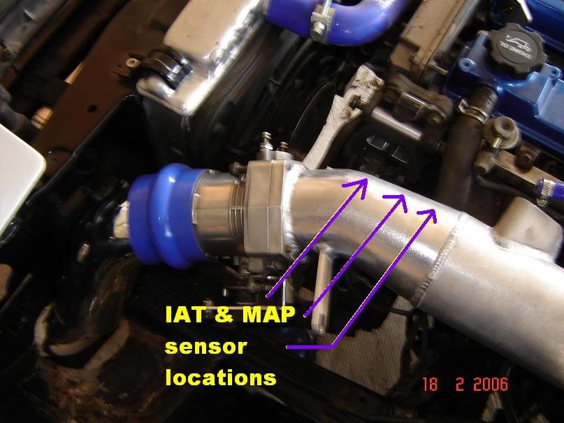

So Bob would just past the t/b be ideal? If you can see on the pictures above I was thinking to tap it on the elbow pipe of my manifold right past the t/b.
That sounds better. Its somewhat hard to tell from the pics. You want a good clean vacuum signal for your fuel pressure regulator and the MAP sensor.
Bob

I mean one of these three locations, prefferably the one on the left.
Also, will there be any implications by having the blow off valve port and the IAT sensor port less than 1" apart?

Put the IAT in the intercooler pipe, near the BOV is fine. The neck of the intake is ok too. Any of those are probably fine for the MAP. You want to watch for "Throttle Steering", i.e turbulence from the throttle blade messing with the MAP signal. If you stay on the side like that, parallel with the throttle shaft you should be fine.

Ok, so basically I have to tap the map vacuum pipe on level with the throttle shaft, right? I mean if the t/b shaft is located (clock indication) 8:45 to 3:15 then my MAP vacuum pipe should be parallel to this plane, right?

Close is fine. What you don't want is to be at 90 degrees to this or at part throttle the air will be shooting off the top of the blade right at the MAP port.

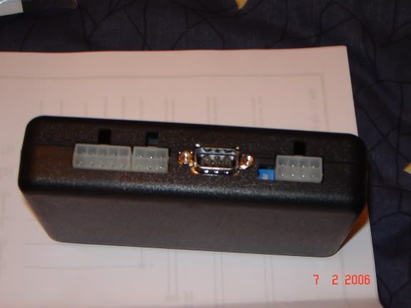

can someone tell me what type connection is made between the maftpro and a laptop? as in usb,serial or what? a picture on the side or back of the unit would be cool so i can see where the connections are located. thanks.. i want to know so i can find a good place to mount when i get mine..
It's a serial connection. Here's the back of the unit:
