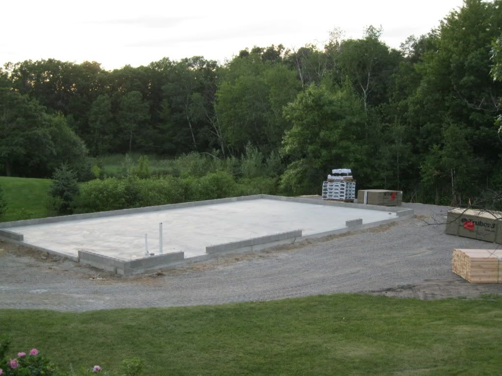

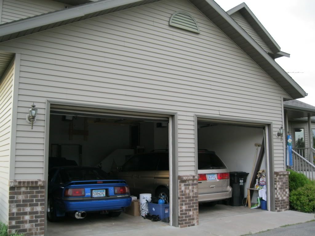

Rob, Here are a few. The garage is going to be 30 x 50 with 12 ft walls. Hoist and bathroom. Heated and floor will be epoxy coated. The house is just south of St. Cloud on Highway 15. You can see it is a big upgrade from the old shack. 2 story house with 4 bathrooms. BTW, what sold my old house was the garage and hoist. You and Amanda are welcome anythime for the grand tour and a few brews.

Thanks Rob, I have your new # recorded. Today the boys hope to have the walls up. Lot's of small problems as I think the crew is a bit rusty. But so far looks awesome. I had the guy who will put in my septic holding tank out today and the guy who will epoxy the floor was here as well. No price quote yet, but if epoxy is like everything else, it won't be cheap.
