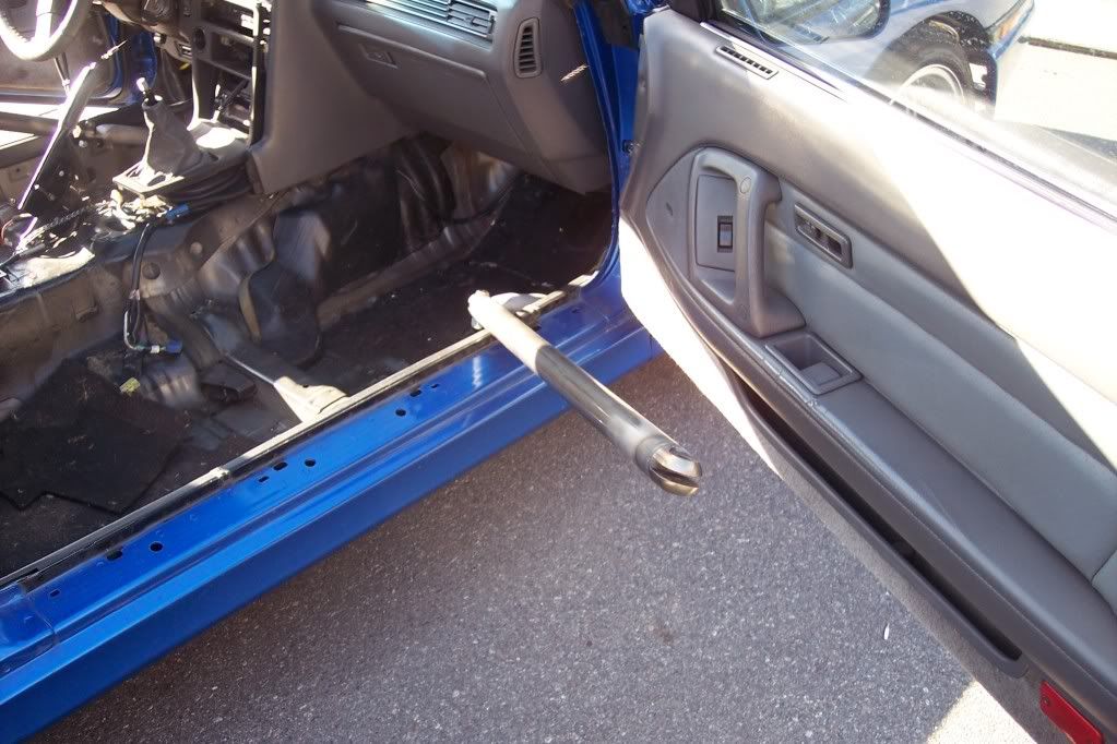

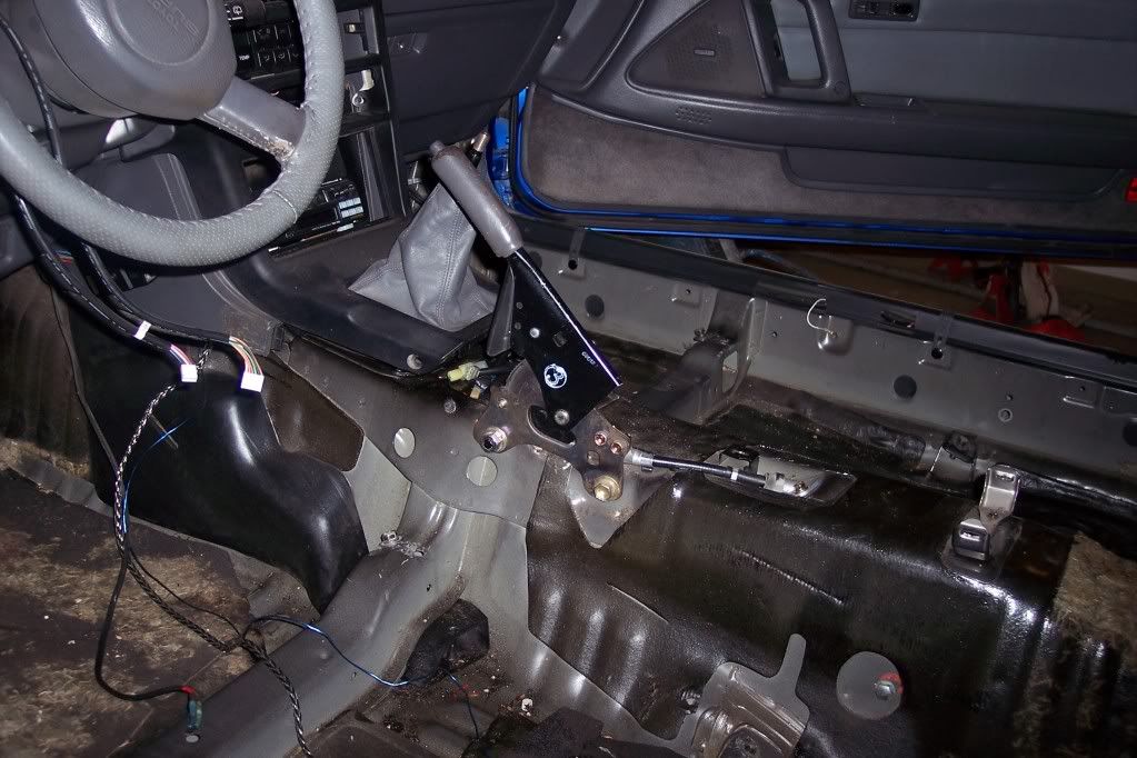

Tonight we are finishing up several issues before the Supra goes to cage builder on Wednesday.Interior is pretty much out. I am going with Chrome Molly roll bar with removable door bars. This will be certified to run down to 10.0. If we want to go faster, the full cage can be added to the bar. Not cheap but if I get into the 10's, it is essential.

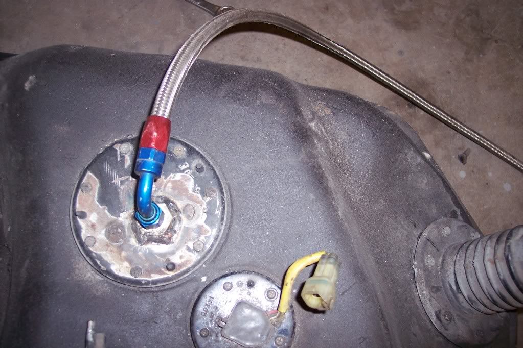

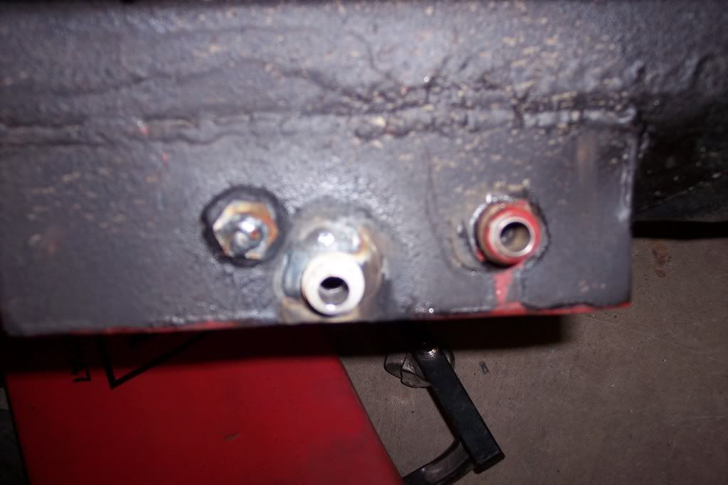

Last year we had issues with the custom sump Sean built so tank is off and we will rebuild it similar to Sean's set up as we have identical tank and sumps. This is mine as on car now.

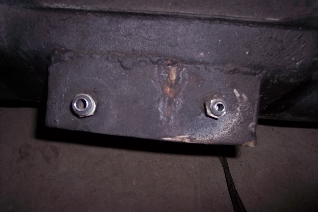

This is Sean's solution to the low gas issue. Next photo is return line.

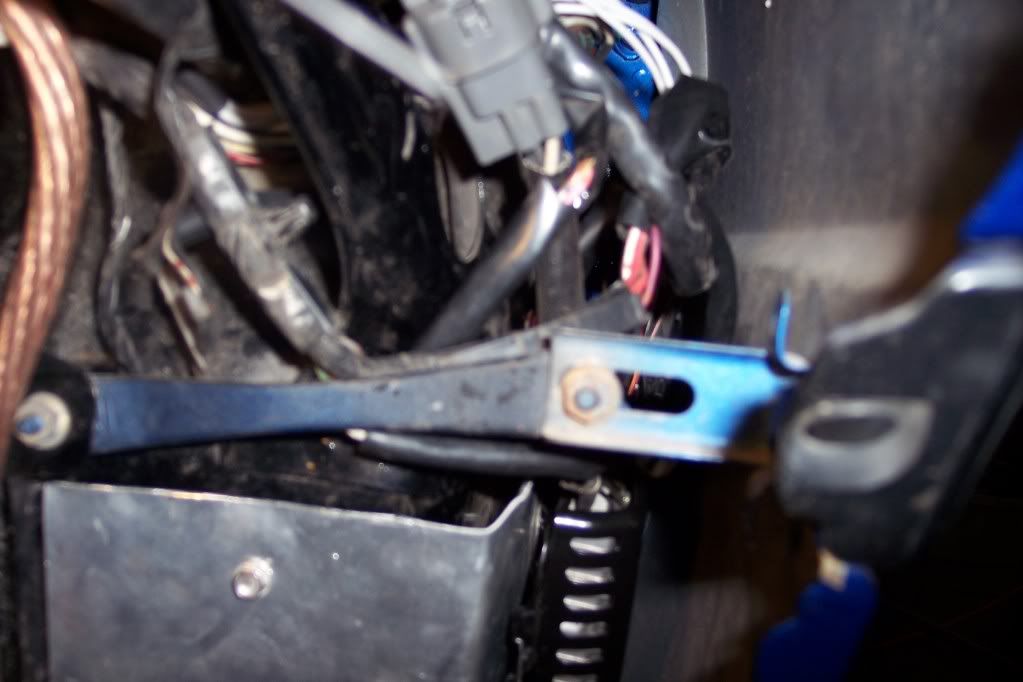

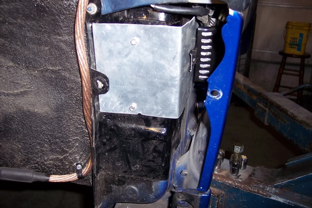

Next is a pic of drivers side inner fender. Sean built a bracket where ignitor and coil drivers sit. Also did a wire tuck. HKS DLI will sit beside shock tower under hood.

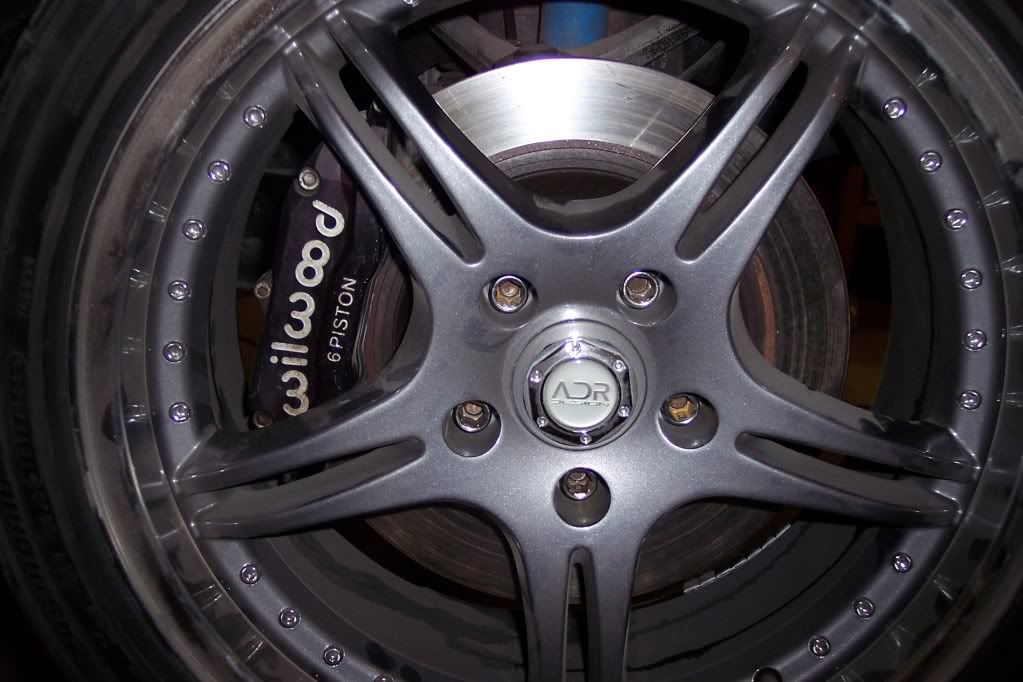

Last photo is of Wilwood caliper and wheel. We added a line lock and a proportioning valve to control front/rear braking. I will eventually add MKIV rear calipers. Probably next year.

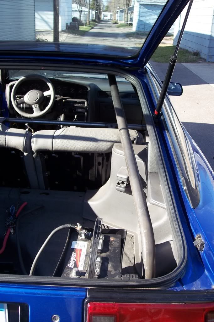

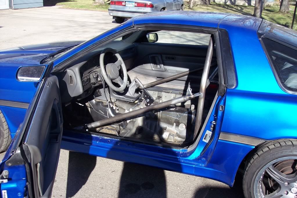

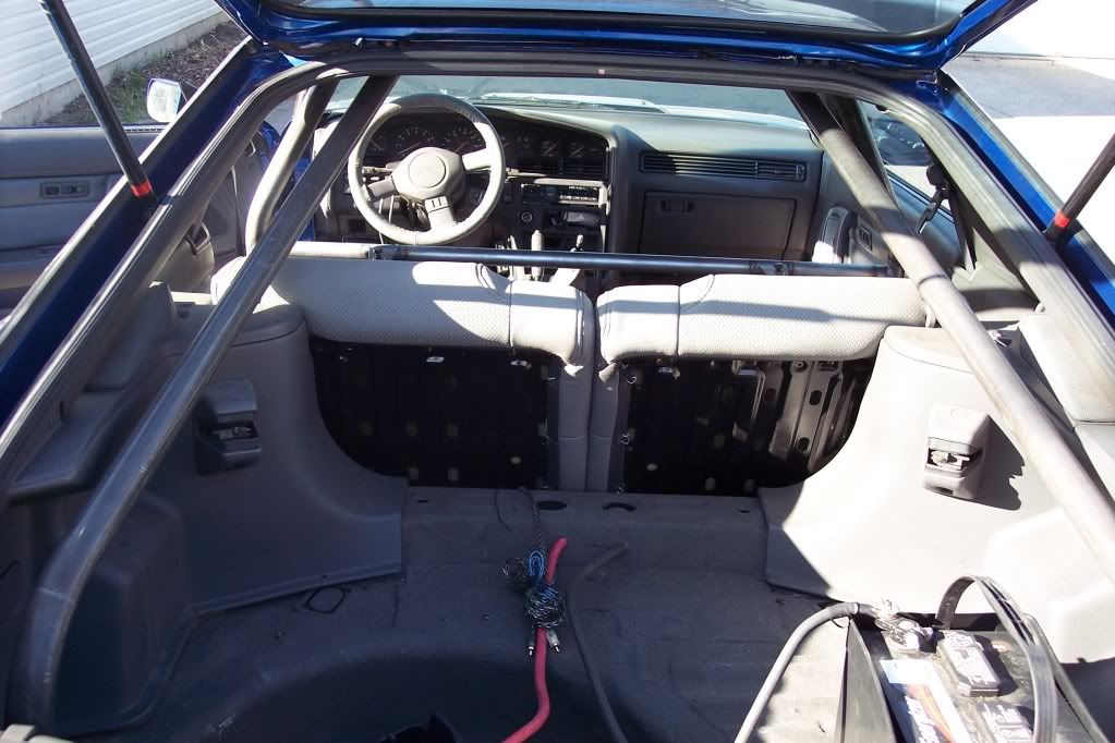

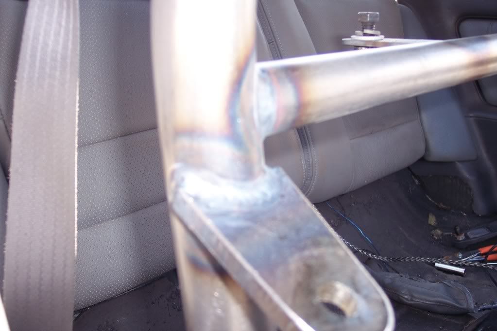

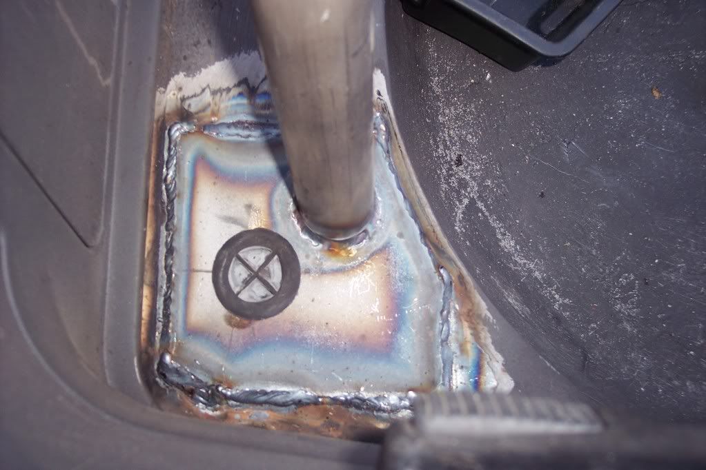

We got the car back from cage builder today. My assessment is an awesome job. What do you think. It's chrome moly. Certified down to 10 secs at the strip. Removable door rails. Only downside is my targa top will have to go into back seat from now on.
Also got word from Sean that Comp turbo will be ship[ping my turbo in a few days. I will have the first Comp Billet 67 TBB in the USA. We are scrambling to get car back together and down to dyno.

Scotty,
We left the seats in to simply assist Joe in welding the bars in position so they would not interfere with the rear seats and because I have no plans in removing them. My goal is to see how close I can come to running 10s just the way she is. I am also going to put the front ones back in that weigh 70 lbs a piece. Drive her to the track (60 miles) away, drive her home. Spank a few Corvettes and Rustangs along the way and at the strip. I suppose if I can't break that magical number, we may try a few runs with her stripped. Last year I was a complete novice, we were only at 21 lbs of boost, no 2 step engaged, and with the idea of not breaking her, still managed to run 12.3. The cage is a safety measure. Besides if I run 11.5 or faster they boot you from the track.
Tonight I will be cleaning the bars and then using some gray primer and gray paint to color them as close to the interior color as I can. I installed several sheets of stick on insulation to the drive train tunnel as well. Last year my leg would start to get hot after running around on a hot day.

Every one has some sort of first from comp turbo. IIRC this is now the 3rd time I have heard this, some thing is starting to smell like fish.
Ummm.....Targa top in your rear seat, = fail with major scratches.
You night as well not even carry it with now if it wont fit in the rear and just pry it wont rain. Leaving it on, well that equals unhappy driver and sweaty balls when the mercury goes north of 85 degrees with out A/C ;)

Rob, To be honest I don't think Sean even tried to fit it in there. It looks pretty close to me. If I have to carry it in the back seat. Will keep a blanket to wrap it in if need be. The cage really out weighs the small hassle for the targa in my book. Text me if your around this weekend, perhaps I can buy need lumber for the woofer box.

Wow, I had no idea you guys were putting a cage in the car. It looks like nice work. How is your head clearance to the main hoop?
