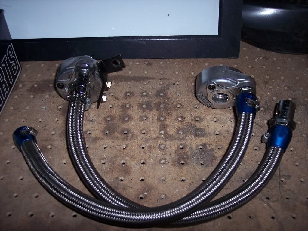

Got my Greddy oil filter relocation kit in the mail today. It looks like the guy who had it didn't know how to properly use the high pressure lines as it was leaking. These dudes are expensive but got her for a great price.

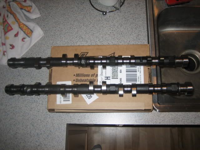

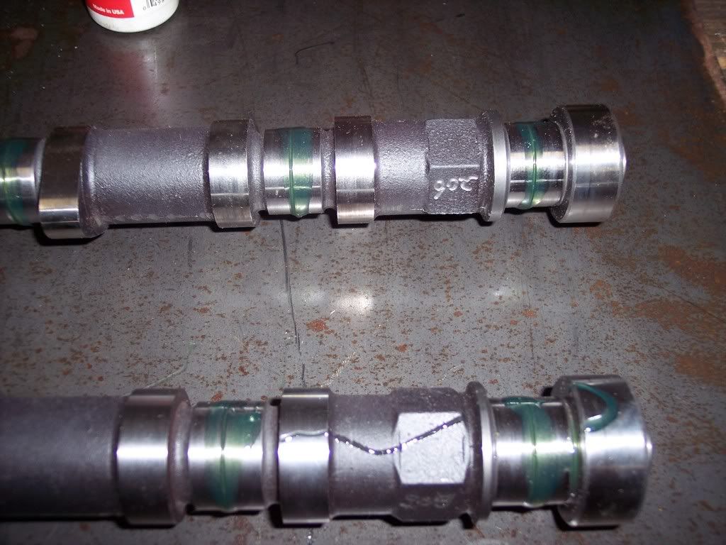

Latest update: Thanks to Funky_Monkey's phone call I was able to snipe these HKS 272s for $300 tonight. Used but acceptable. I had planned on the 264's but since I was going to replace valve springs anyway, why not? This is going to be a real bad ass car come spring.
I am posting up my turbo, manifold, downpipe for sale this weekend. Getting ready for the custom triple ball bearing Billet 67.

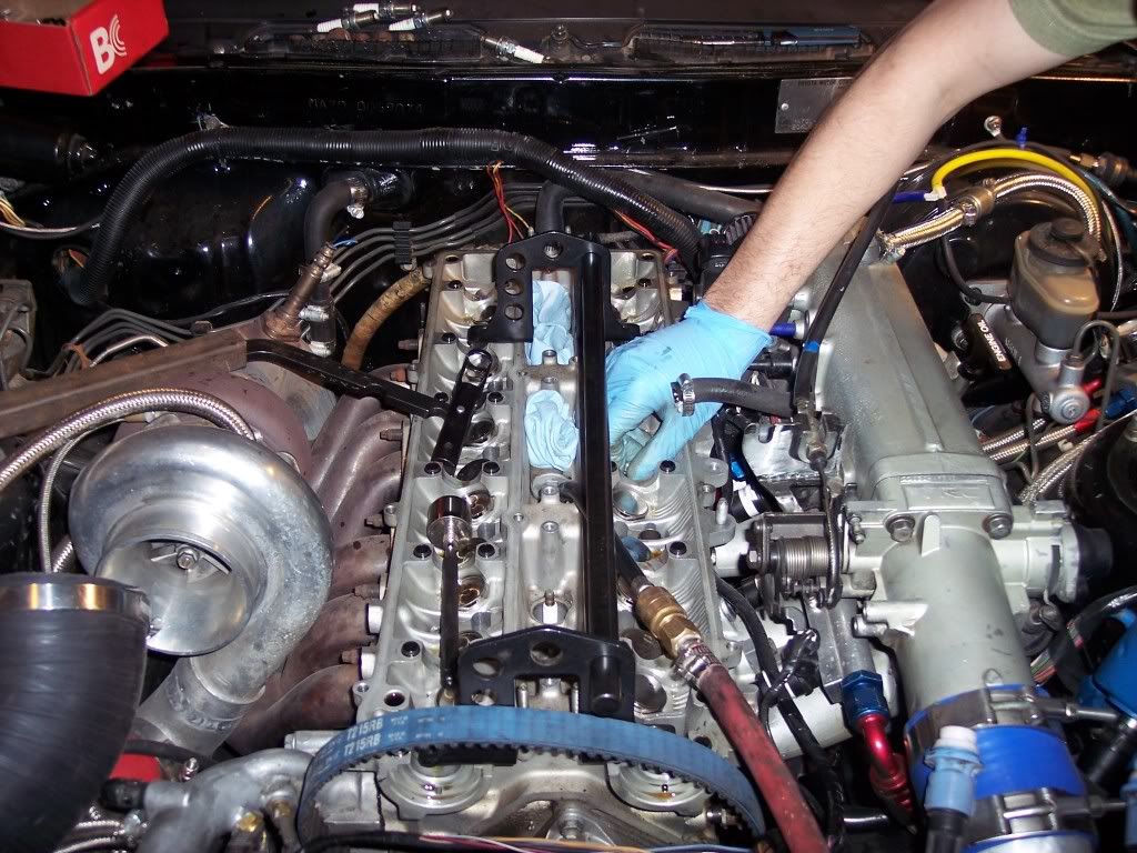

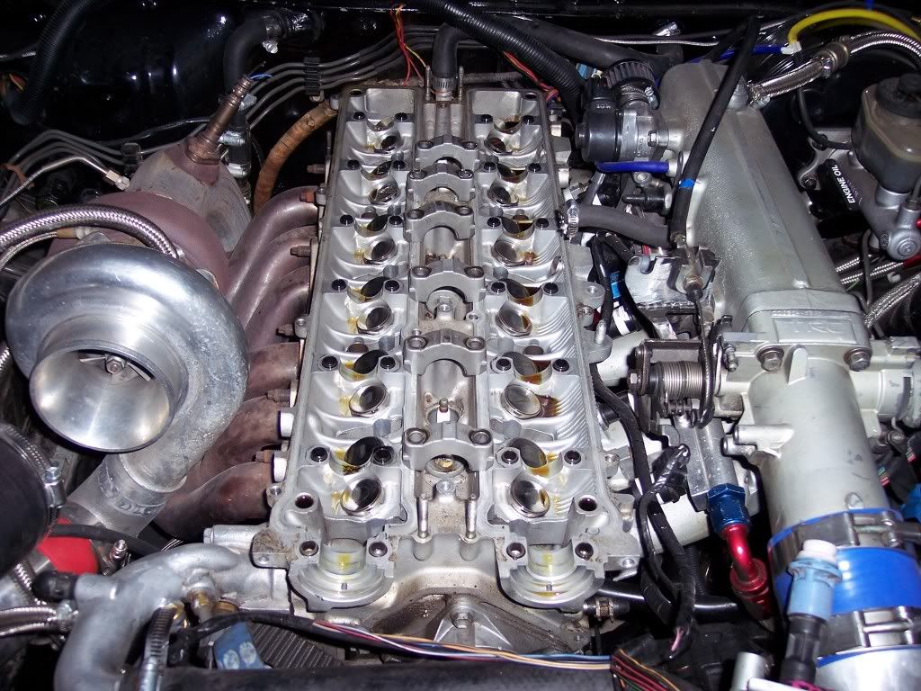

Well my wife, Lucia and I are flying to Puerto Rico for a week in the sun. We are planning on relaxing and we are actually going to meet Luis and his GF. Sean and I have a small Christmas present for him of recycled Supra parts.
The latest on my 87 is: Sean pulled out the USDM cams and we are now checking clearance's. As soon as we know them, Dave Henry from Fargo is going to let us dig through his bucket of shims. We may have to buy a few. I also got notification today that the valve springs were shipped out today. So after we get back for PR they are going in.
Haha, just so you know, I was the one who told Sean about those cams. You should be thanking me! lol, just so you know, Sean talks about you and your car all the time, it's getting mildly annoying. Anyway, car look great!

Thanks Alec,
It really was a sweet deal on the cams, considering new they are almost $900! I had planned on 264's but what the heck!
Sean should be talking about his own car. It is looking very good. Tonight he is in the shop tonight working on wiring. We want to be super ready this spring. I still haven't decided 100% on turbo size. It seems the Billet 67 makes the most sense in a divided housing but the 6265 also seems a damn good choice. I know I want quick spool and good #s.

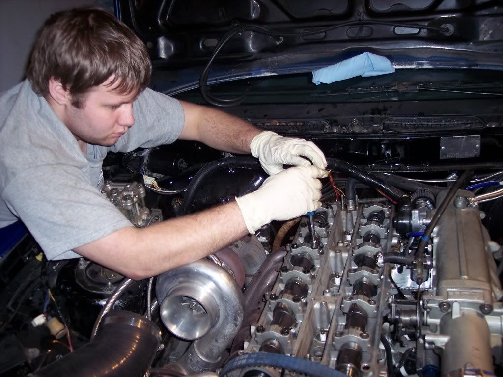

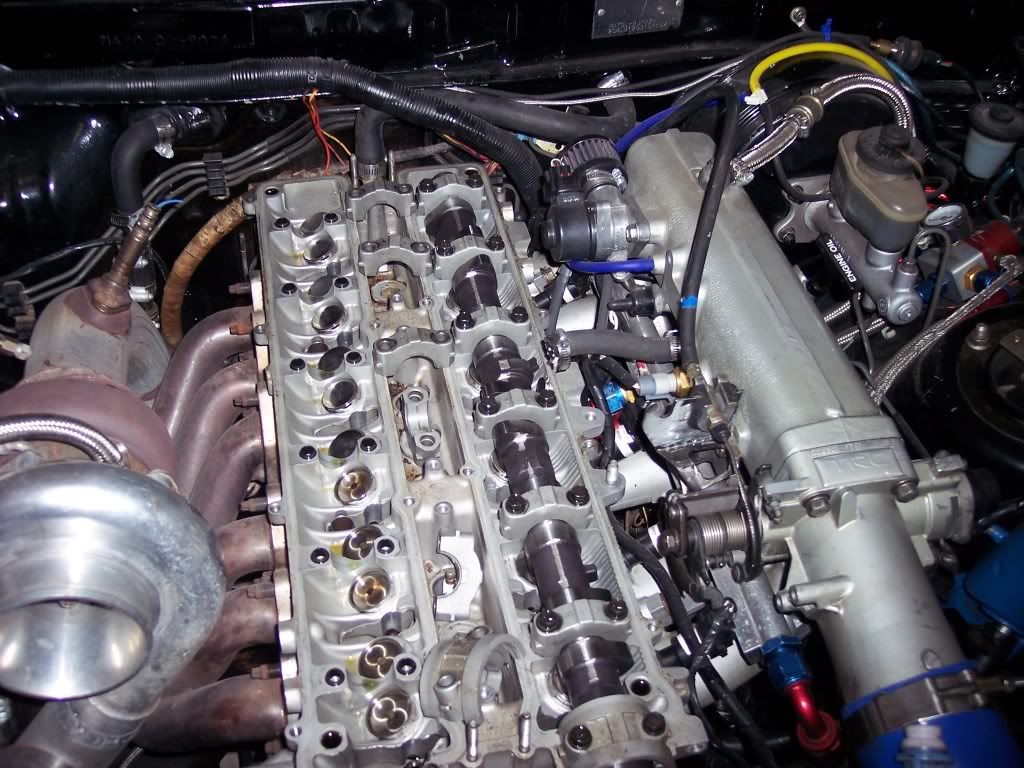

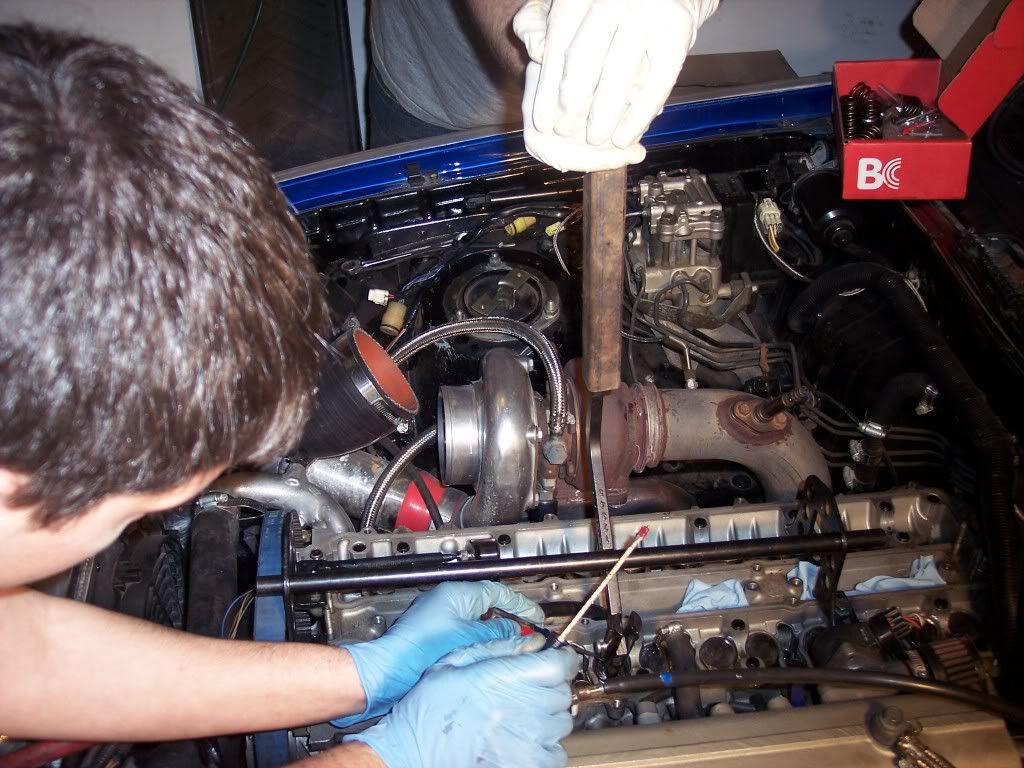

Today Steve (Toyotanos) and Sean (funky_monkey58) worked on installing the HKS 272's. All went pretty well until we figured out we need several more shims. Luckily Toyotanos works at a Toyota dealership and can get the shims quickly. I shot a few photos. We also installed Brian Crower springs, retainers and new Toyota valve seals. Steve found 4 seals that were not seated correctly. This may have been the source of the small puff of blue smoke on start up.
With a bit of luck she will be running again by next weekend. I still have a list of stuff to do. Spring is still 3 months off here on the frozen tundra!
Dan

Tonight Sean and Steve and I got the cams installed. We also installed the low miles coils I picked up on SupraForums.The 2JZ had not been running sine late October and one we turned her over a few times she fired right up. Initially she had a few misses. Once she warmed up, she revs just fine and has that nice lope the HKS 272s are known for.
We are now going to work on pulling off the ABS systems and cleaning up the wiring. Slow but good progress. Big thanks to Steve aka Toyotanos and Sean aka funky_monkey58 for all the help. Nice having a certified Toyota mechanic helping out.
