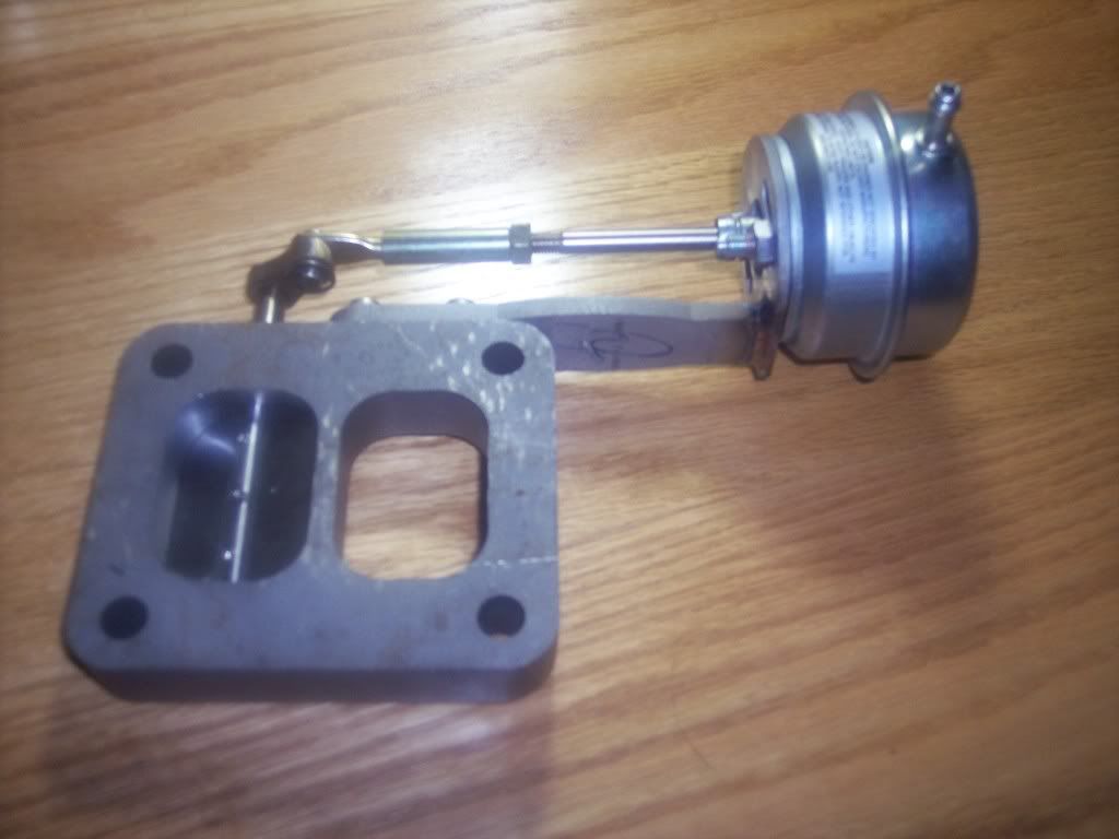

Latest addition:
Sound Performance Spool Valve. New turbo ordered from Comp. Thanks for the sweet deal Sean aka funky_monkey58 Even though my new turbo is bigger, with the spool valve and triple ball bearings, it should spool as quick as the GT35 did, but bring me up to near 800 rwhp! More pictures later. Today Sean got the valve covers tapped along with the Greddy Catch Can. He has been working on the Wilwood BB install. This Saturday we will be finishing her up, tweaking the inter cooler pipes.
