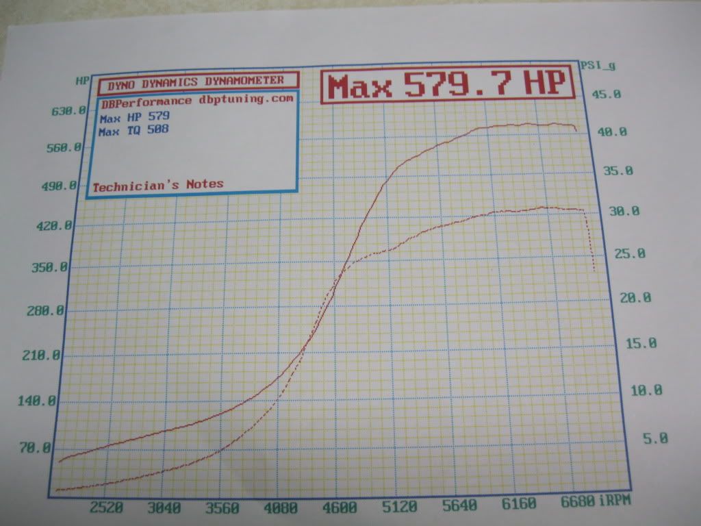

Today's update: Sean and I pulled the Supra to DB Performance and had Shane dial her in. I am happy that we didn't break anything, but unhappy we didn't make more power. I had expected in the 725-750 range. According to Shane, my 3" exhaust and 1.0 A?R on the turbo aren't big enough. Here's the dyno sheet. We made almost as much on wastegate as we did with boost controller. I was not happy.
Sean and I then pulled her 90 miles to Brainerd, where I made 2, 1/4 runs before electrical issues stopped us. I launched at 3800 rpm, and immediately the car cut out for a split second and then a huge back fire. Sean told me it looked like confetti blowing out of my exhaust. It then did it again but not as loud in 2nd gear. I still had a 116 trap speed, but poor e.t. The next run was even worse. Sean asked me why I was driving like an old man? I told him we had mechanical issues. He then drove her outside the track and proceeded to make a run with me in the passenger's seat. The first pull she really took off, however on the way back, ran like shit. So it wasn't me after all. Other good news, we easily passed tech inspection.
I am ordering my new 4" piping in near future and much large a/r to go with the spool valve. Once in, we will go back for another touch up tune by Shane. It was a long day but all said I am decently happy. The Supra has over 500 rwhp on the wastegate spring. Tracking down the electrical issue should not be too hard, as Sean already thinks he knows what the problem is. He thinks it's related to the wire tuck and the sensor for the tach.

That graph looks like you cut the revs around 7000 rpm? Wow, I'm going to be spinning higher than you, Dan! :p
Did you mess with the cam timing when you were on the dyno? I wonder if there's something there. I am VERY VERY happy to see your power coming on at around the same RPM as mine does, even with your slightly bigger hotside! :D
A 1.0ar divided like dans is more like a .68ar undivided, the goal was quick as hell spool....

Steve, she really pretty much topped out at 7k. Not sure if it was the restriction or if it was the cam timing. We didn't play with it. I wish now we would have unbolted the cat back and just ran the down pipe.
Even with a larger a/r we should still do pretty good with the spool valve.
