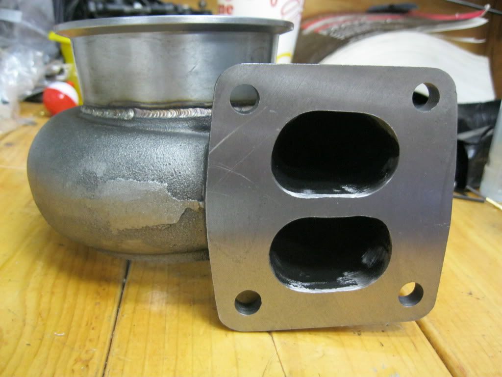

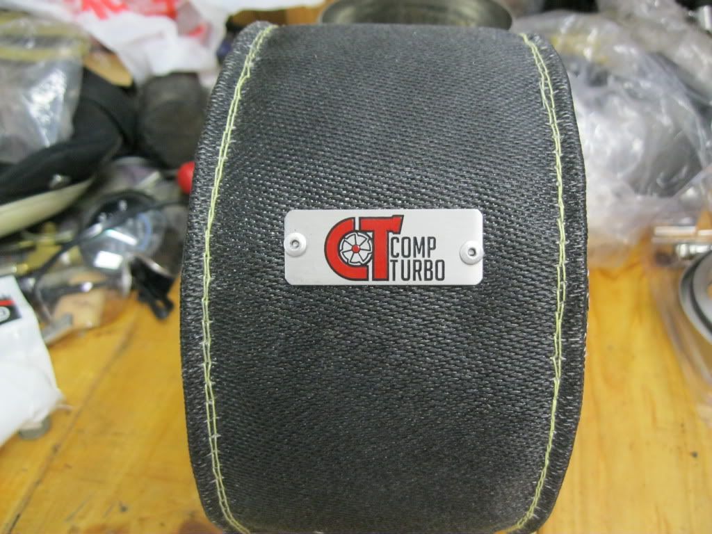

Sent the turbo housing back to Comp yesterday. The new one will be 1.32 A/R with 4" outlet, v-band set up. Joe (owner of Comp) gave me a smoking good deal on it, plus another great deal on a turbo blanket. After a lot of searching, the plan is to do a 4" down pipe, 4" back to the Greddy cat back and then drop her to 3". Will either buy a cutout or just v-band her together, unhook the 3" when on the dyno or at the track. This way I can keep my relatively decently quiet exhaust. Seems like a decent compromise. The research on the full 4" systems, all confirm, that 4" is good but difficult to quiet down. Hope to be driving her next week.

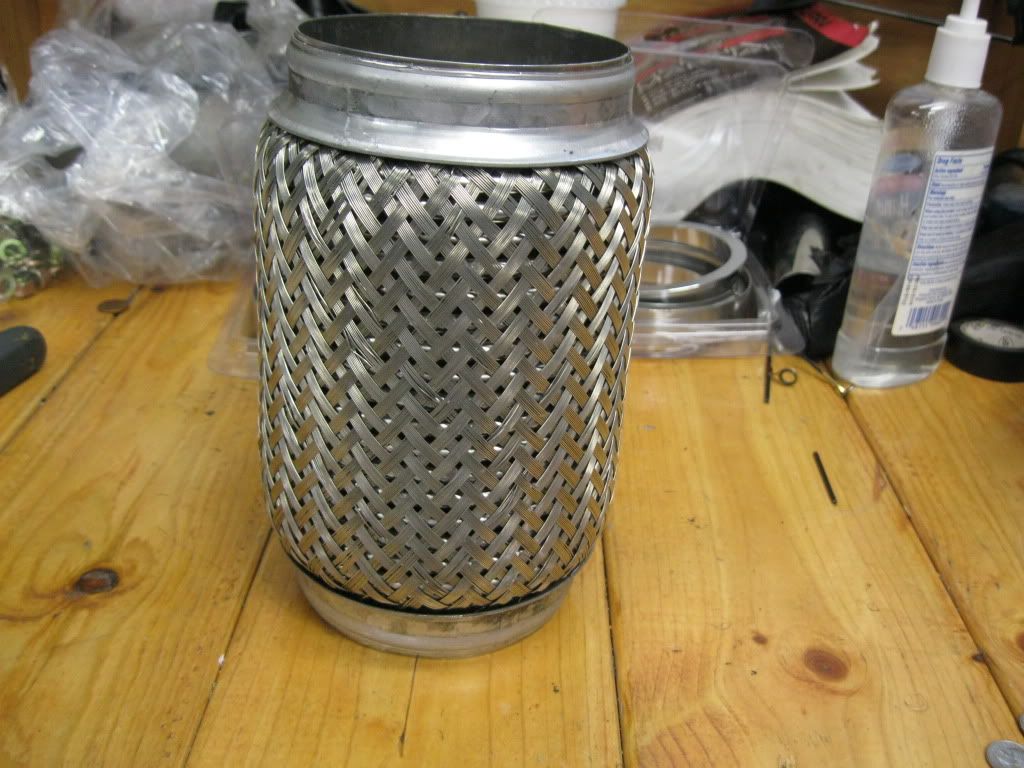

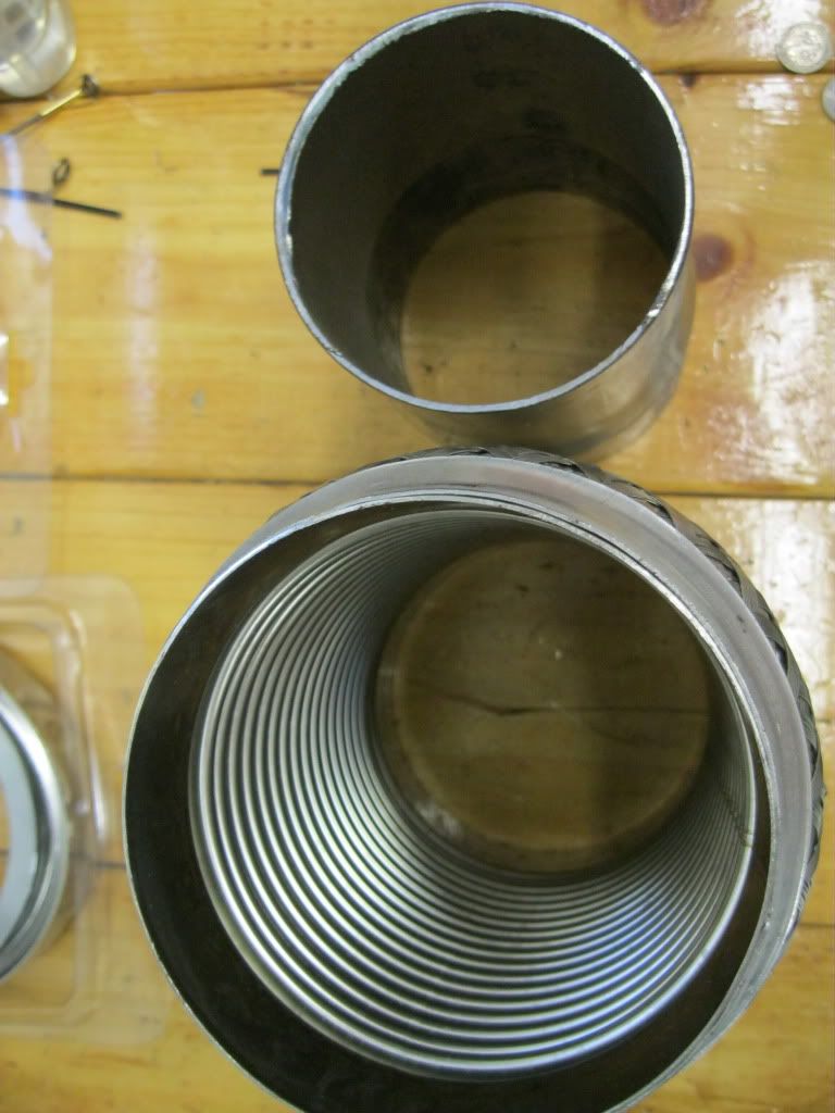

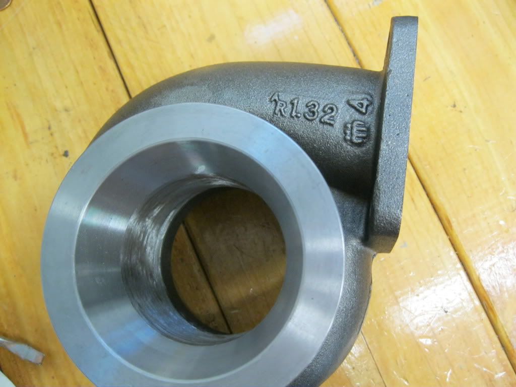

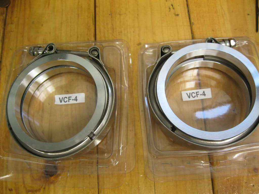

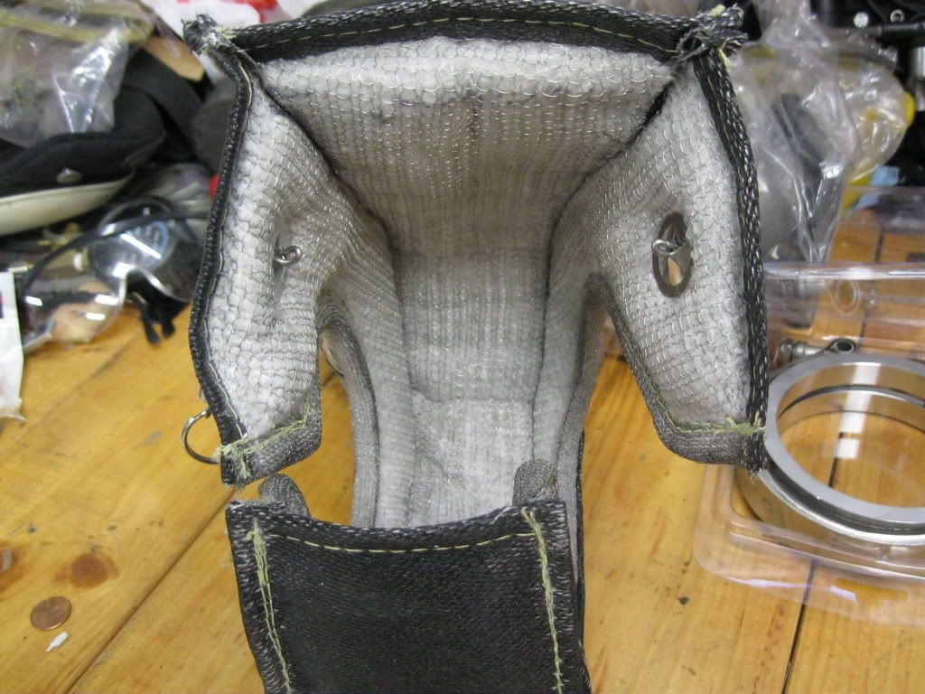

Turbo exhaust housing came in today, 1.32 a/r with 4" outlet cut for a v-band, turbo blanket, damn, its thick and nice. Great deal on it. I also have a pic of the difference between 3" and 4" exhaust, plus pic of flex section.
Gonna be interesting once we have her back up and running. Hopefully Saturday

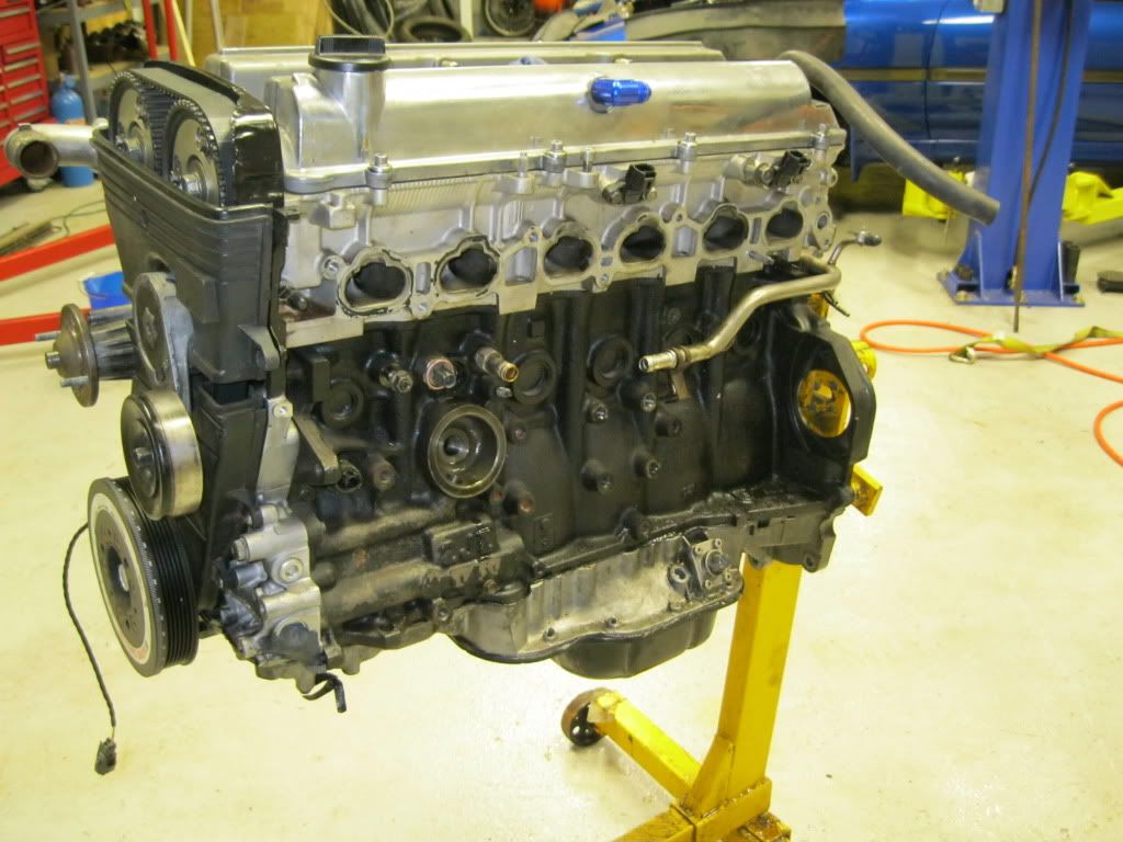

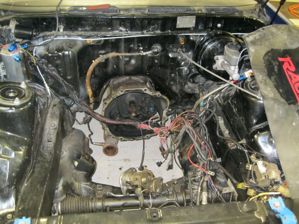

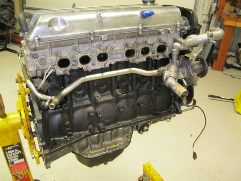

Tonight Sean and Dallas pulled out the 2JZ. He had her out and on the engine stand in under 3 hours. I was busy working on the house, it might have been even quicker. Now the ATI pulley needs to come off, and then she will be on the way to the machine shop in a week or so. As of right now, the plan is to use the shop recommended by Dave Henry. Will be starting the process of looking for rods, pistons and bearings. I will probably be running 9.5/1 compression. Might as well since I run e85 exclusively. Also thinking of painting the engine bay the same blue as my car. What do you think??

Today I hauled the 2JZ to Fargo. I am using the same machine shop Dave Henry uses for his rebuilds, Quality Engine. I have never seen so many blocks and heads in one spot. Must have been a couple hundred of them. They look crazy busy. Once I get the call as to what sized pistons, and bearings. I am going with the flat top 10 to 1 compression, as recommended by DaveH and Mark Conte. It takes about 4-5 weeks once ordered. So I am done driving her for the season. Frustrating year, next will be better. I have now had my 87 for 10 years. I bought her from a guy in New Jersey.

No worries, Dan. Cars break/wear out- all you can do is rebuild and upgrade what you can! Looks like I'll be going the same route as you with the bumped up compression. Just ordered an ATI for myself too!
I kinda like the black engine bay personally- makes a bit of contrast to the body but its whatever. Those details... ;)
