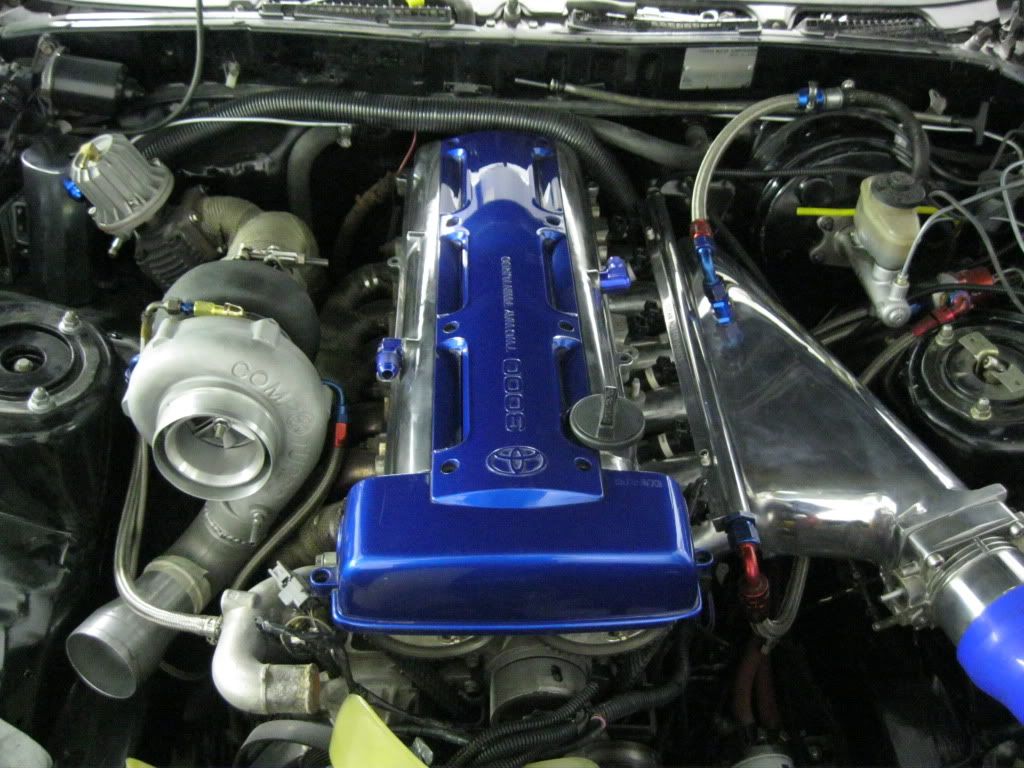

Here is the latest photo. Sean has been sanding and buffing and I have some as well. The manifold is bolted on. Tomorrow the throttle cable, intercooler pipes, and fuse box stuff get done. We are expecting more snow tonight. I hope this is the last batch for the season.

More progress. Sean mounted the Q45 throttle body, hooked up vacuum hoses to the intake manifold. We also have been playing with the radiator shroud. I thought we had enough room but didn't. After bending the side lip of the Moshimoto it looks like we will have enough clearance for the shroud. Tonight we checked the tranny fluid level and swapped in Sean's custom under tranny bracket. Solid now under there. I still have some concerns about a minor leak, but the fluid level was normal. Lastly we bolted on the lower intercooler t-clamps. With the custom hard pipes, we should not have boost leak issues this year. Now we are just waiting for a small piece to hook on the custom power steering reservoir, vacuum lines, bleed the brake lines and should be ready for a tune. PICs tomorrow night. Also need to do a bit of under coating where the coating burned away when the cage was installed. We are close finally. Can't wait to take her for a spin.
