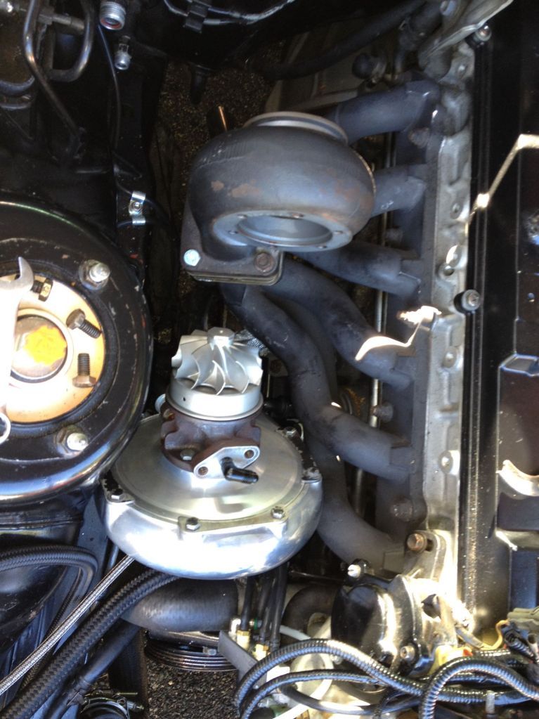

Got the turbo back, was fixed under warranty!!! yay!!!
I've got it pretty much all bolted up, just cant get to one of the bolts to the manifold. its so close to the chra and oil flange that i can't get a wrench on the nut.

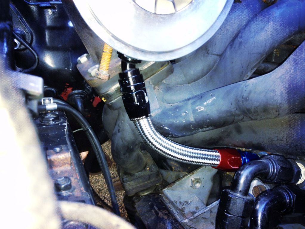

Today I made a new oil drain for the turbo. 30degree fitting on the turbo straight on the engine, -10 size.
Then I went to bolt up the turbo and couldnt get to one of the bolts to the manifold, so gotta pull the turbo apart to reach it. Thank god for stubby wrenches!!!

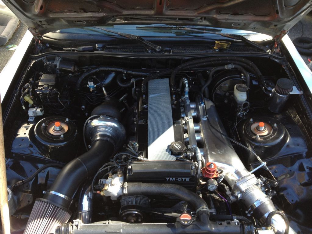

Got everything bolted up including downpipe, rest of the exhaust, O2 sensor, IC piping, intake, etc.
It Runs!!!!

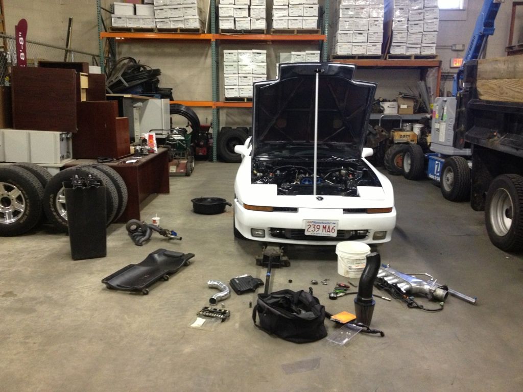

HG is all fixed now, looked like it was slightly blown out between a couple cylinders. Fixed the issue with the hardline as well and now my heat is blasting hot as hell once again. Just in time for the chilly weather thats arriving.
I replaced the plugs but didnt have my gapper at the time, so now i think i'm getting spark blow-out at boost. Gonna have to look into that tomorrow.

During the Hg job
