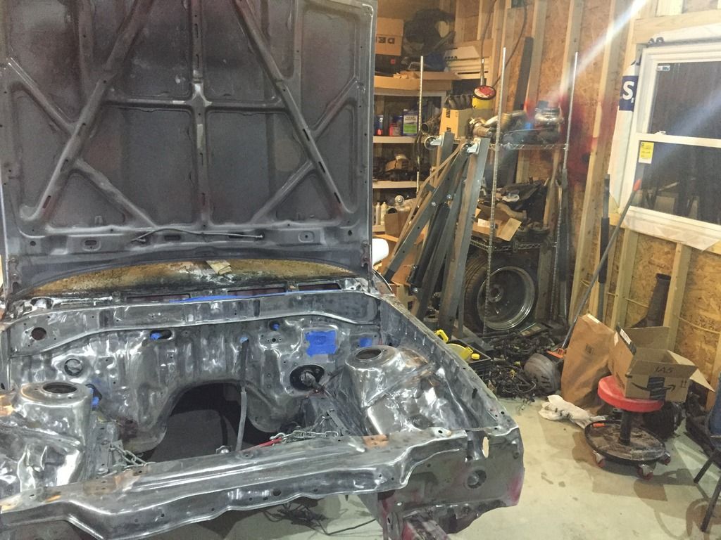

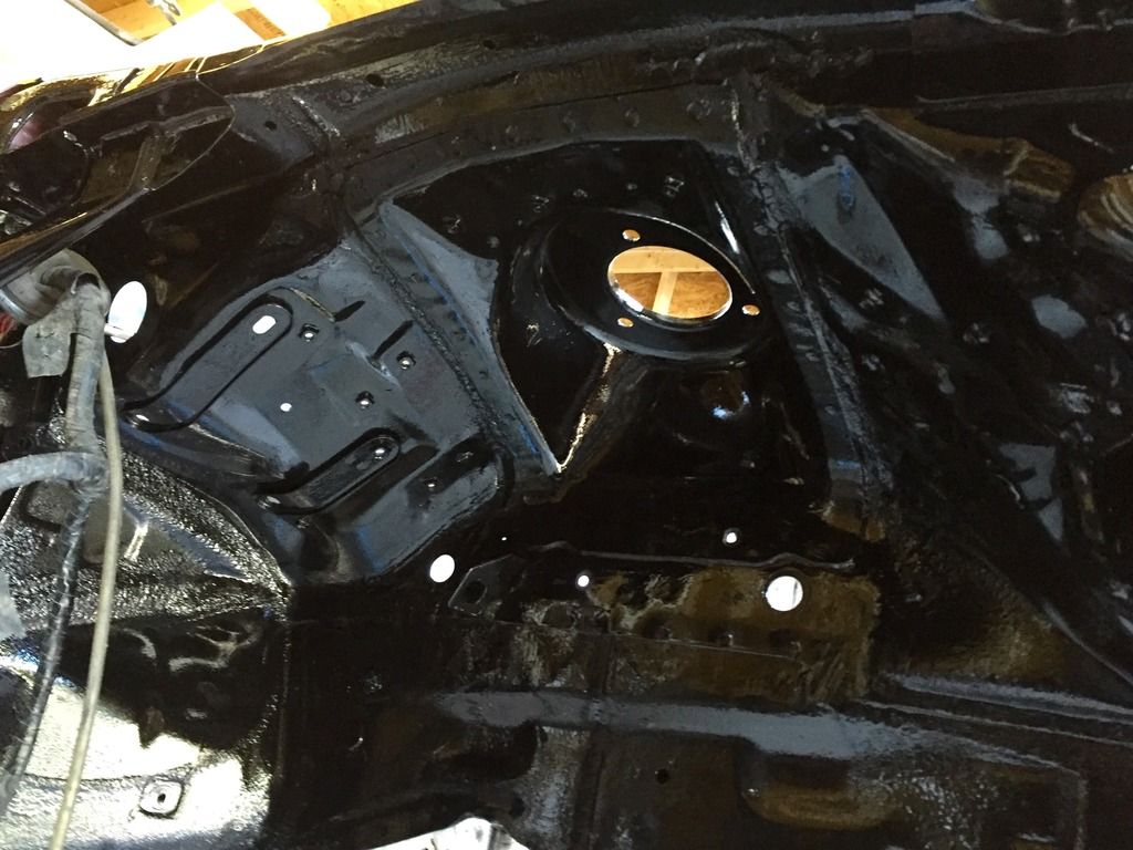

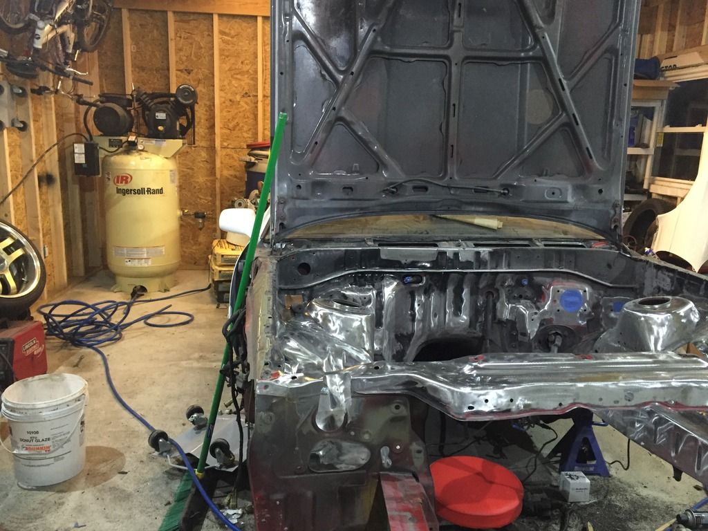

Soda blasted the engine bay

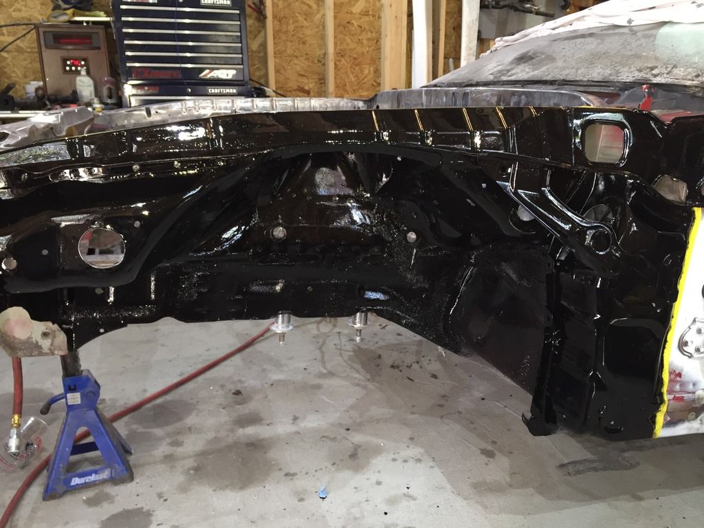

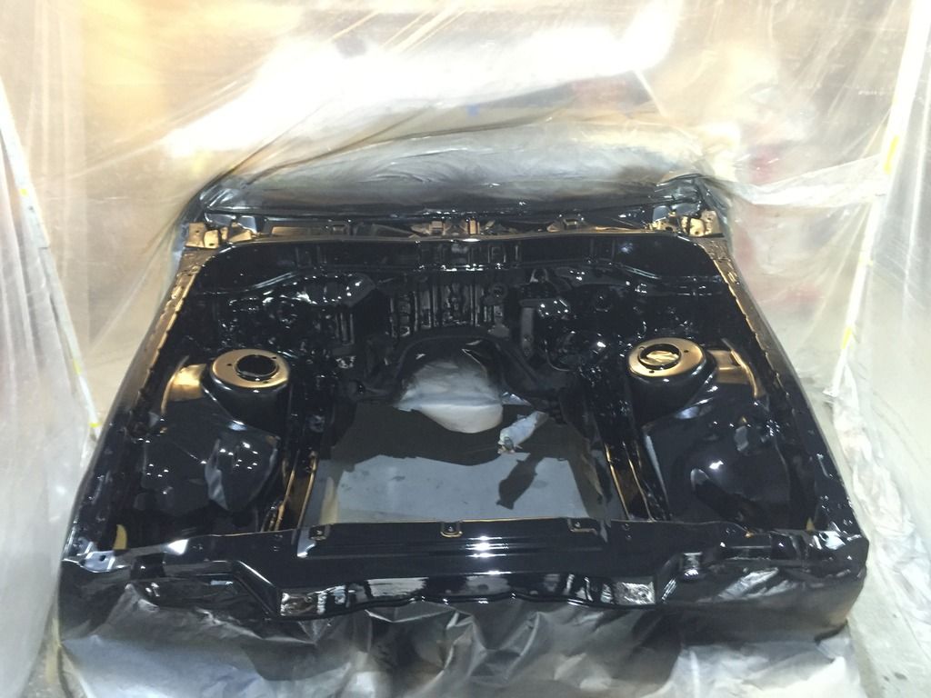

underside of fender wells got 2 coats of chassis saver. This stuff is super glossy and goes on real easy. This was brushed on.

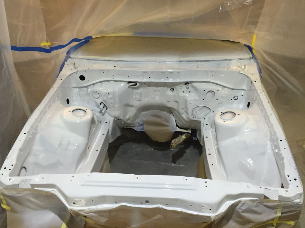

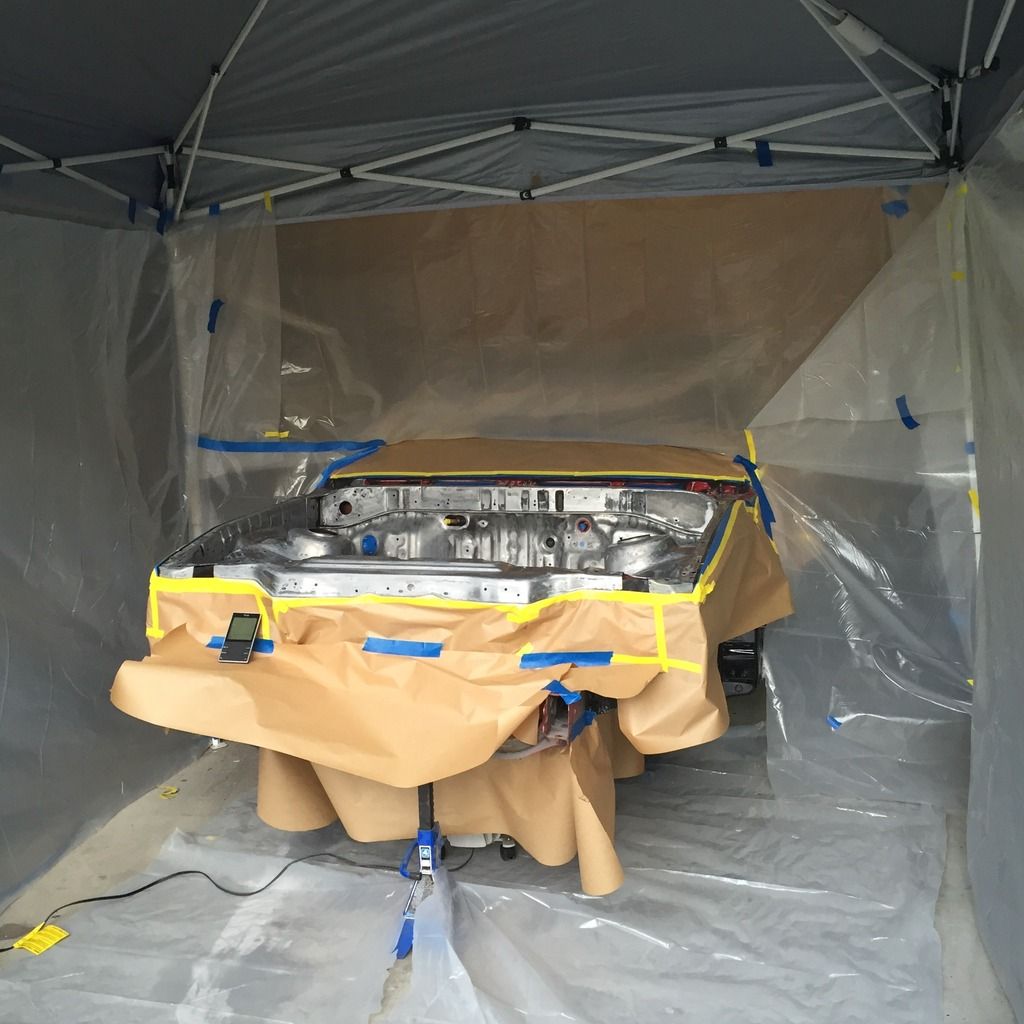

Getting ready for primer. This was after the bare metal was treated with fast etch to chemically clean the metal in preparation for epoxy primer.
I'm happy with the way the primer sprayed. This was my 1st time using Eastwood's Epoxy primer and will definitely use it again. I had to wait until it was halfway decent temp outside and ran a 4200W electric heater to keep the garage at least 65* Fahrenheit.
After about a week of contemplating while finshing up some sanding work on the engine bay i decided to Change the color of the car yet again. I will be going Black, starting with the front end of the car.
Base/clear from sherwin williams auto. Extremely happy with the way it turned out as i only got a few small dust spots in easy to fix spots.

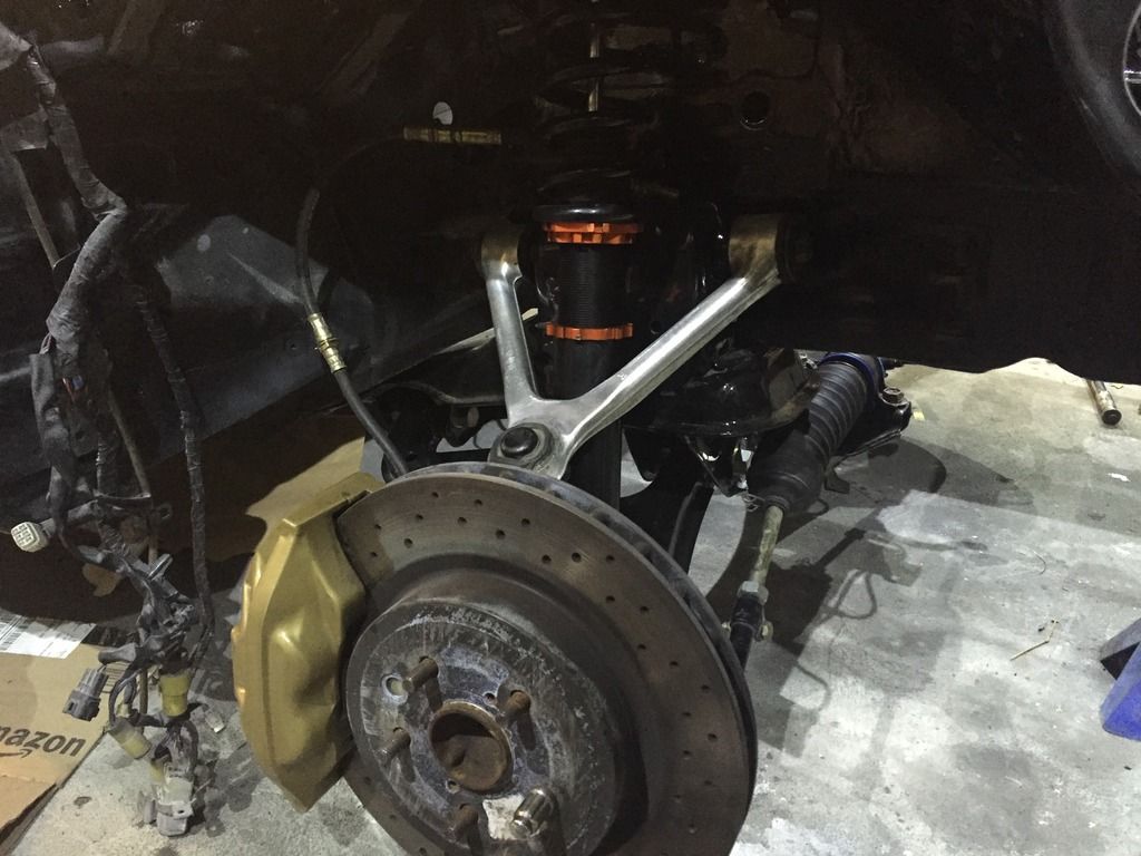

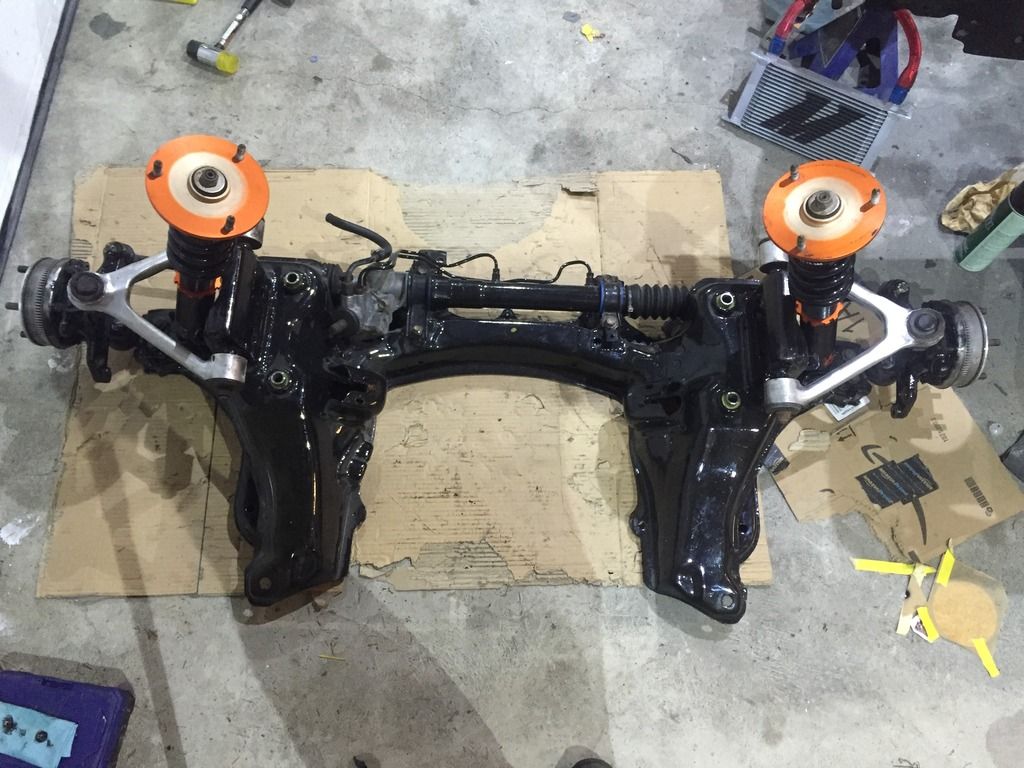

Front subframe got blasted and received 2 coats of chassis saver along with the lower control arms and spindles. Cleaned the uppers and relubed all poly bushings. Installed new yellow RonnieK subframe bushings.
Mounted front subframe with suspension and sleeper designs BBK.

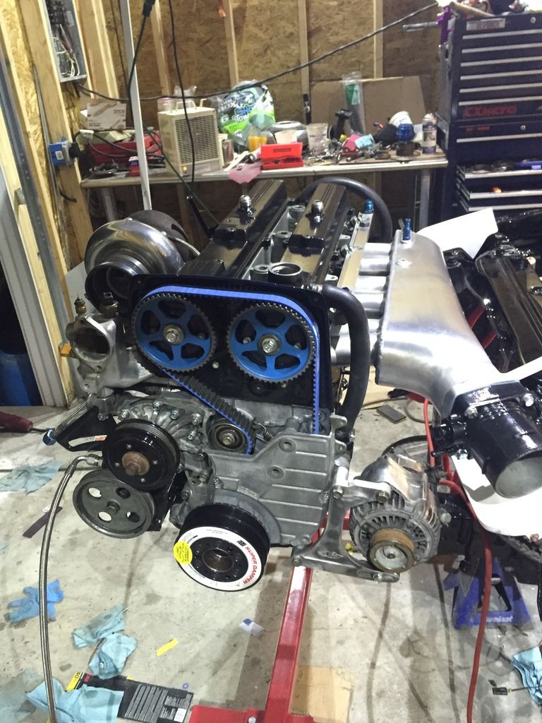

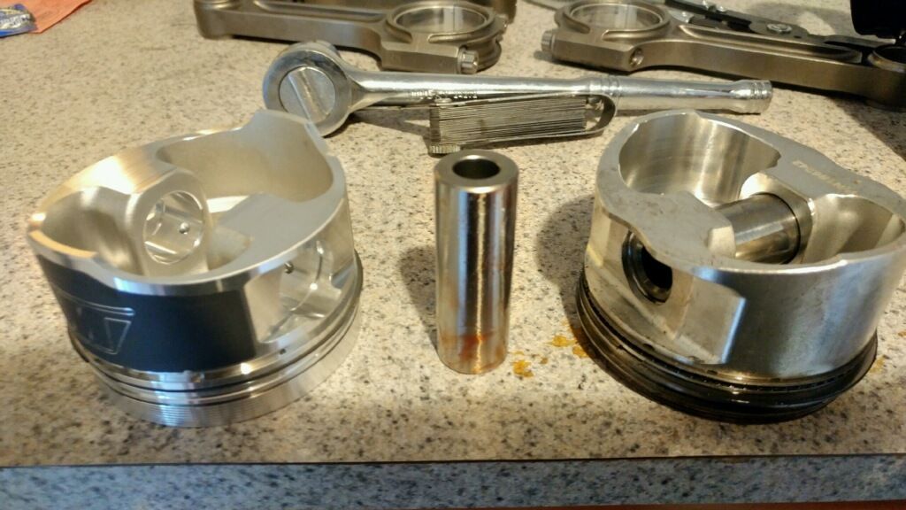

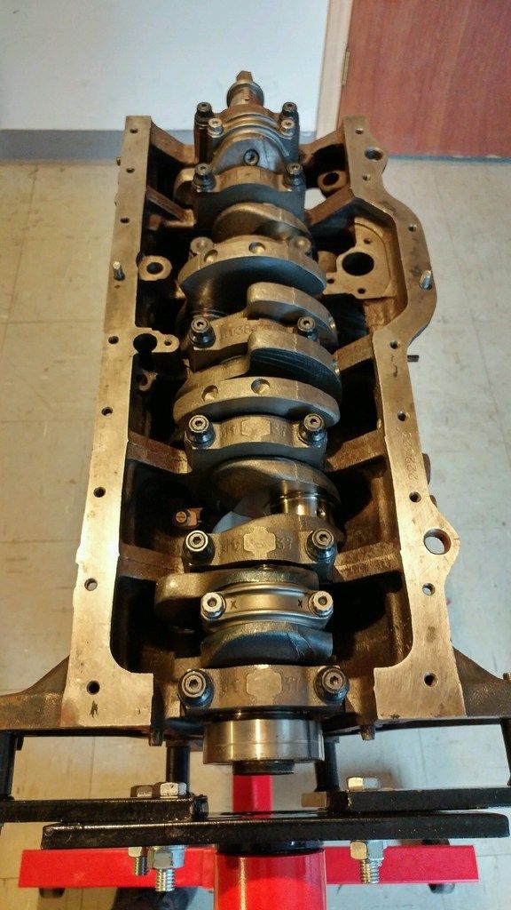

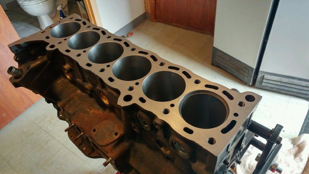

Meanwhile this whole time my short block has been getting finished up by a local who helped me tremendously.

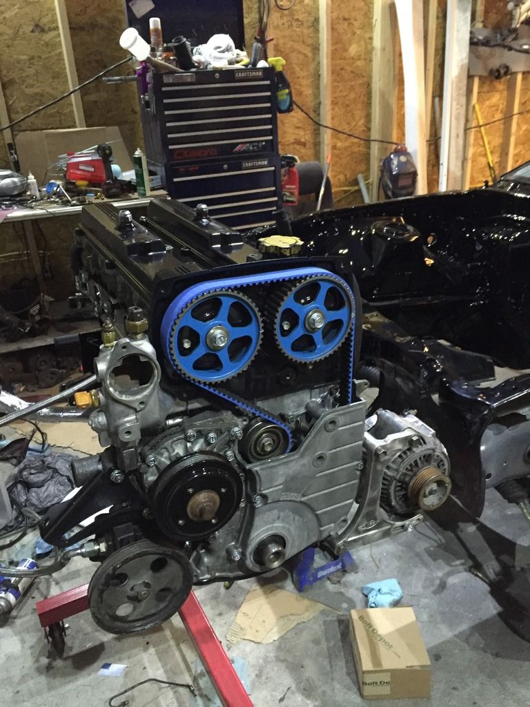

Now that the short block as been re assembled and all clearances spec'd I can start reassembly of the long block.

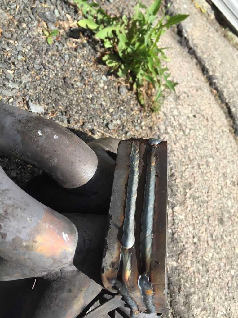

Welded the spacers on the cheapo manifold so i don't have leaks there anymore, while i was at it i welded nuts in the spacer so I can use the stock exhaust studs for that. Exhaust studs got drilled and helicoiled for the 7/16 kit from driftmotion.
New HKS stopper MHG and all the accessories slapped on via the power of the internet.

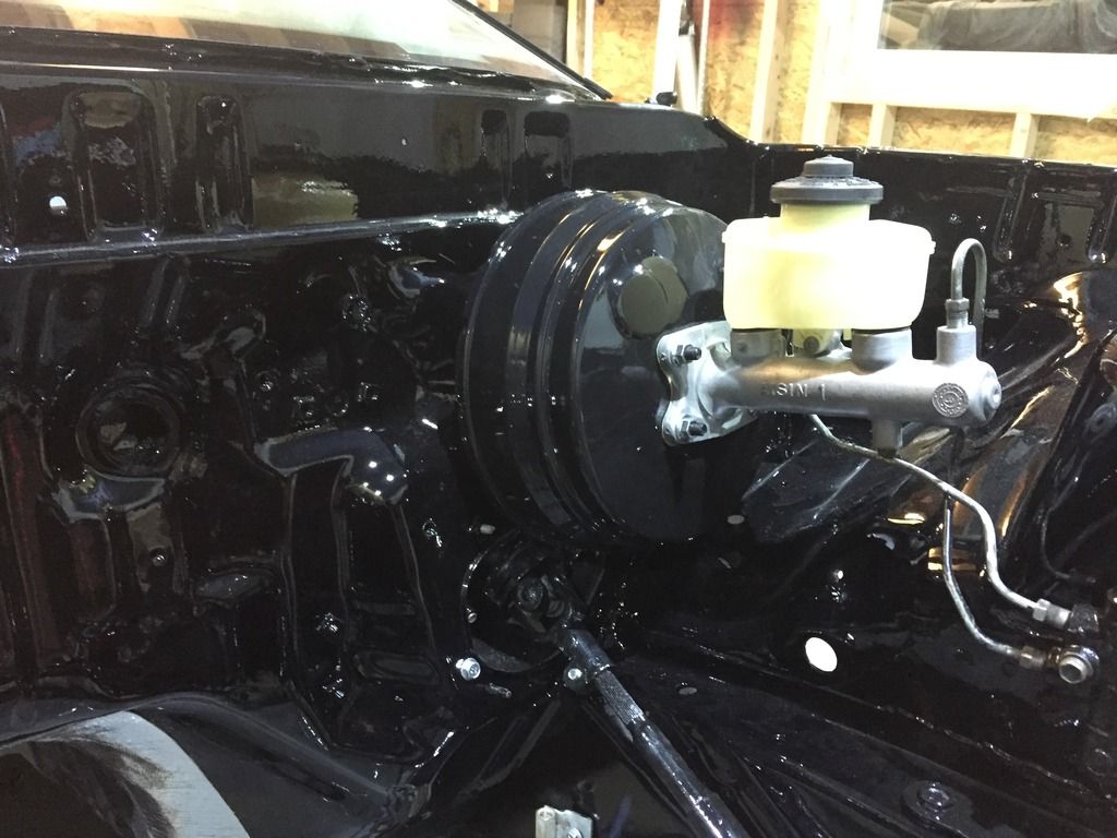

Trying to figure out my new brake lines since the non-abs hardlines have been discontinued from toyota. Freshly painted Non-ABS booster and cleaned master.

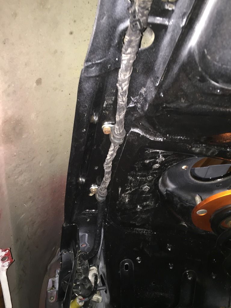

Tucked the harness wires up under there so the car doesn't catch fire again.

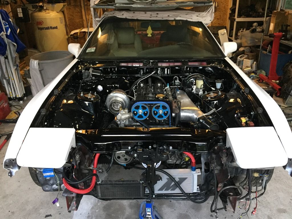

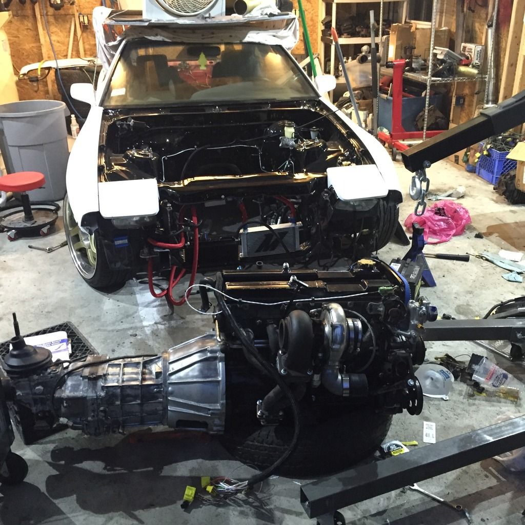

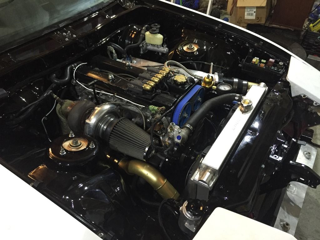

Almost ready to go, just finishing up some wiring.

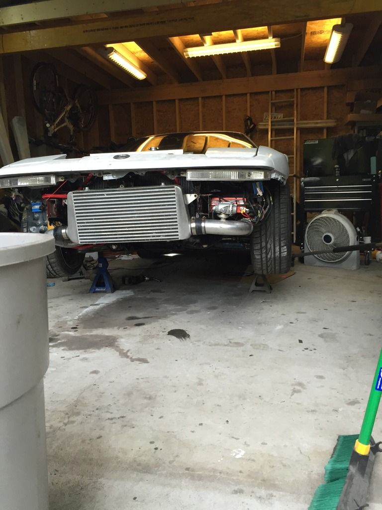

A buddy came by and helped my shoehorn it all in. No scratches!!!!!
yayimsohappy

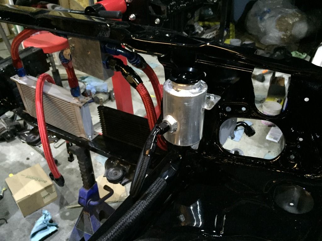

Don't need pics of putting the rad and piping and all that jazz so here's basically the finished product. I'm still trying to figure out my catch can but that's the only thing missing.

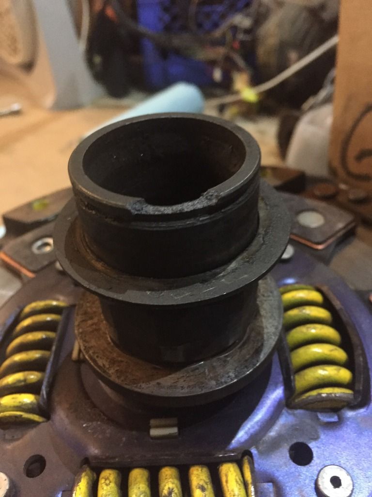

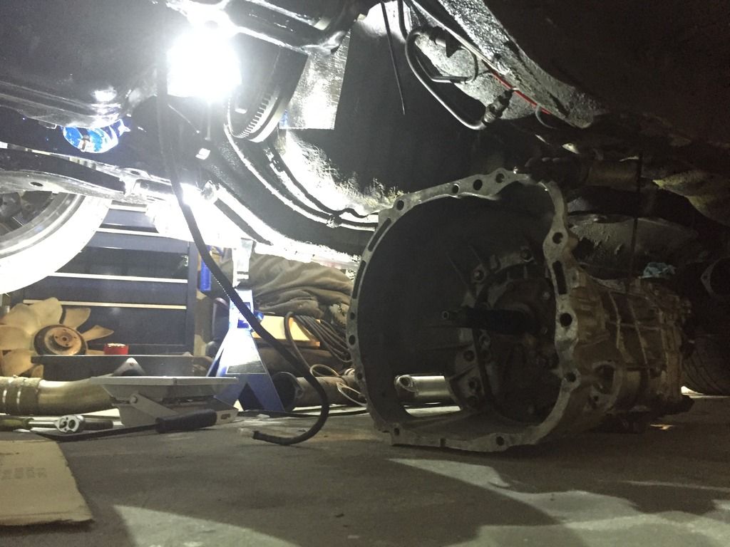

Next day i went to take her for the 1st drive. Made it to the top of my street then disaster! My throwout bearing hub decided it didn't want to hold the snap ring in place anymore. Had to push her back in and get back under the knife.... *sigh*
And now here we are. I Just finished replacing the entire hub/bearing assembly and bolted everything else back on. Hopefully tomorrow everything goes smooth on the maiden voyage and I can get some better pics and video during break in.
