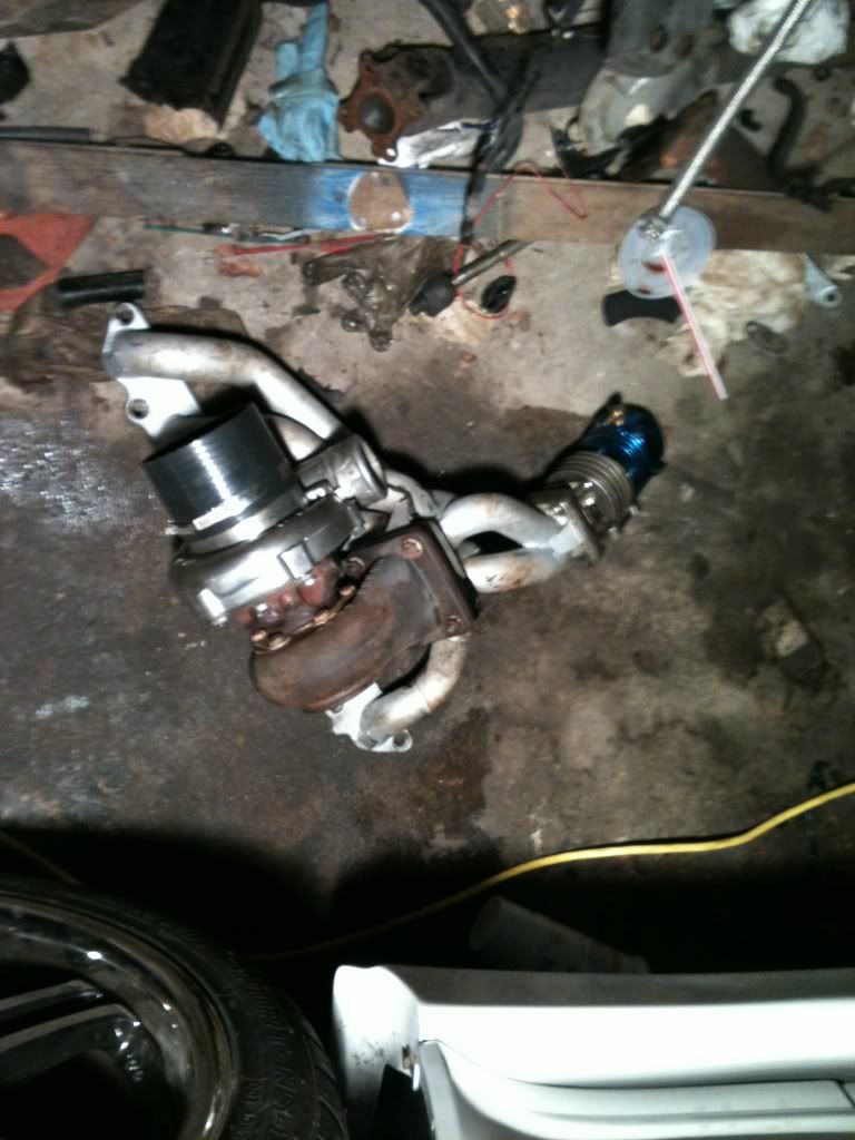

My turbo is absolutely junk, theres soo much shaftplay i can see it wobble when i rev it up a lil bit.
Got the car running better by cleaning the plugs, so the next step is swapping them out for my iridiums.
Picked up a used ffim off a member here for a good deal so when that comes in that'll be going on and i'll be relocating the alt to the a/c position. So now i have to get a batt relocation kit so i can put it in the hatch.

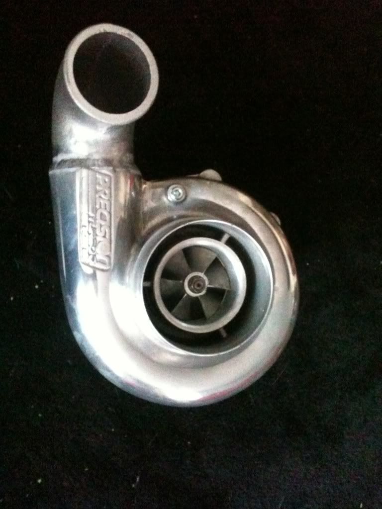

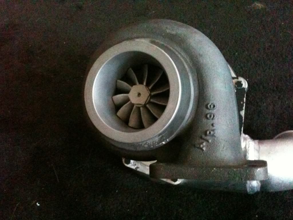

As for the turbo, tomorrow i'm picking up a freshly rebuilt precision 6365 with H trim comp housing.

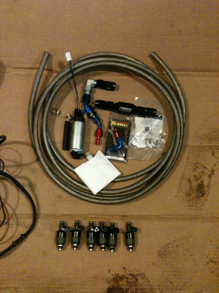

I'll also be swapping out the walbro for a DW300 pump so i can hit that 500hp number with no worries on going lean.

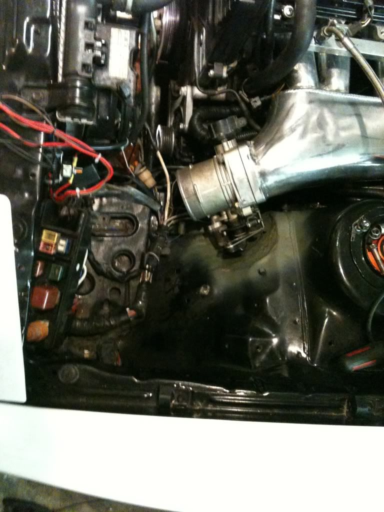

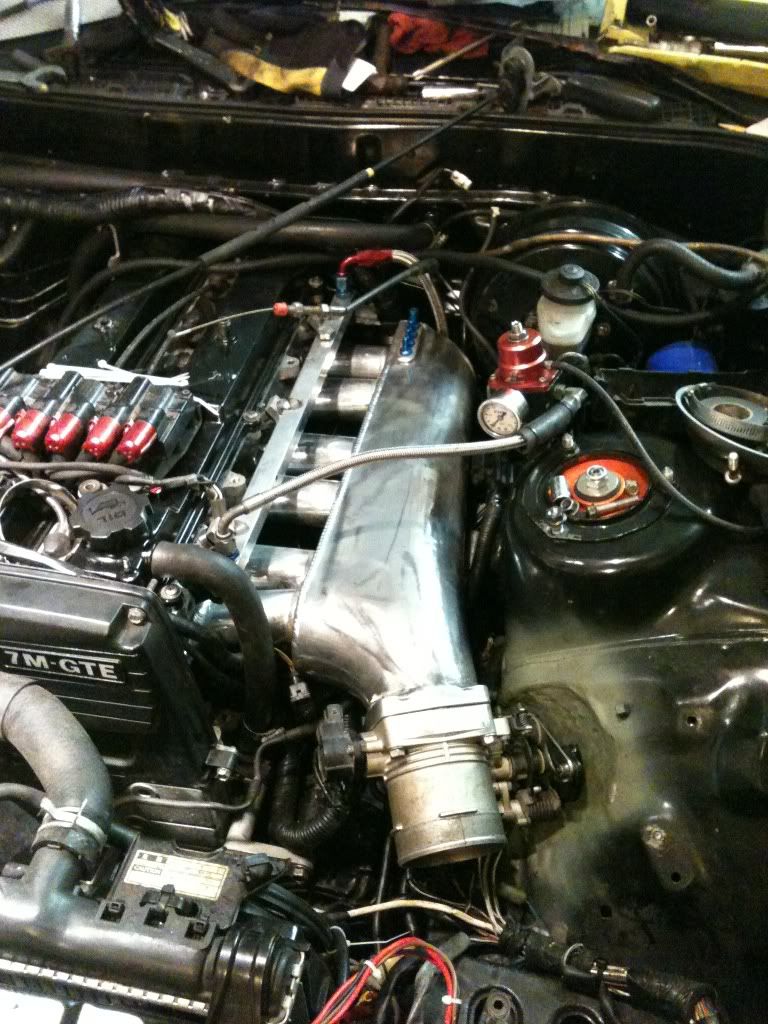

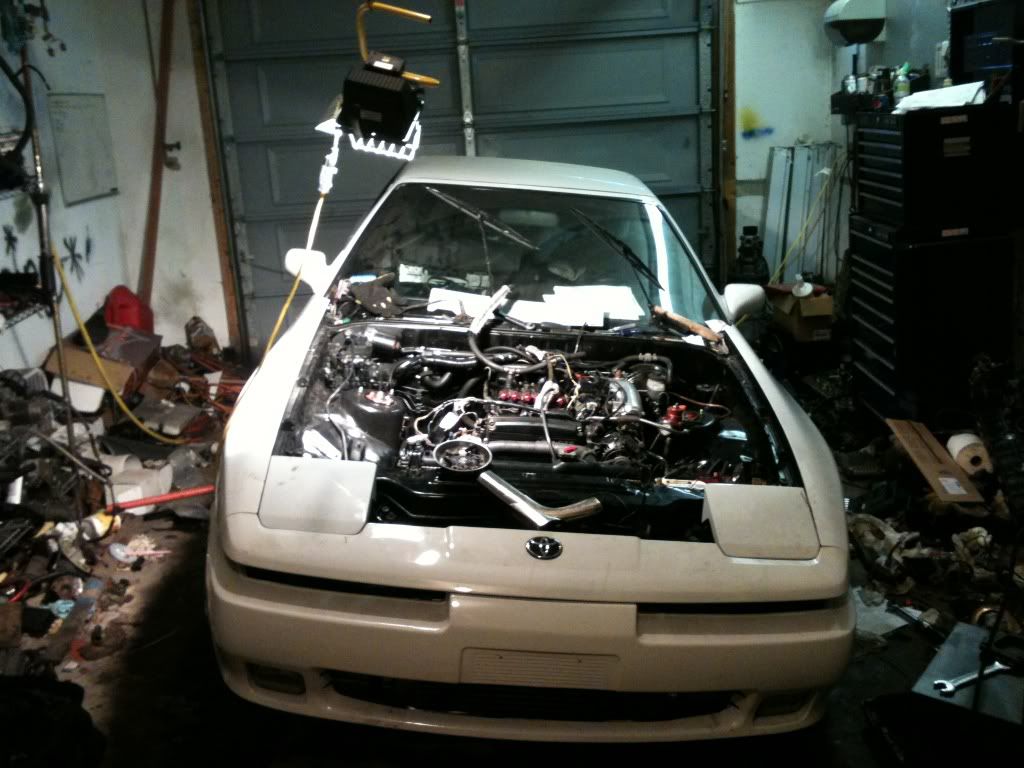

Updates!!!
Installed 880cc injectors with new o-rings and seals.
Relocated fuse box to under the fender and re-routed the wiring in front of the radiator instead of between it and the rad support.
Remounted the oil cooler while i was in there, i didnt like how the hoses were before.
Got the FFIM welded up to clear the brake booster, and banged out the fender so the q45 throttle body would fit.
Made a bracket for the throttle cable that bolts to the strut bolt.
Extended TPS plug so it reaches the TPS.
Clocked the turbo so the oil drain is facing down, and the elbow is facing the right direction.
Deleted CSI on the fuel rail.

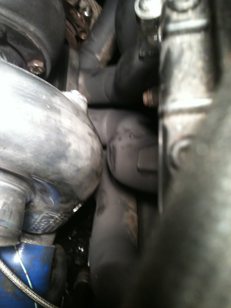

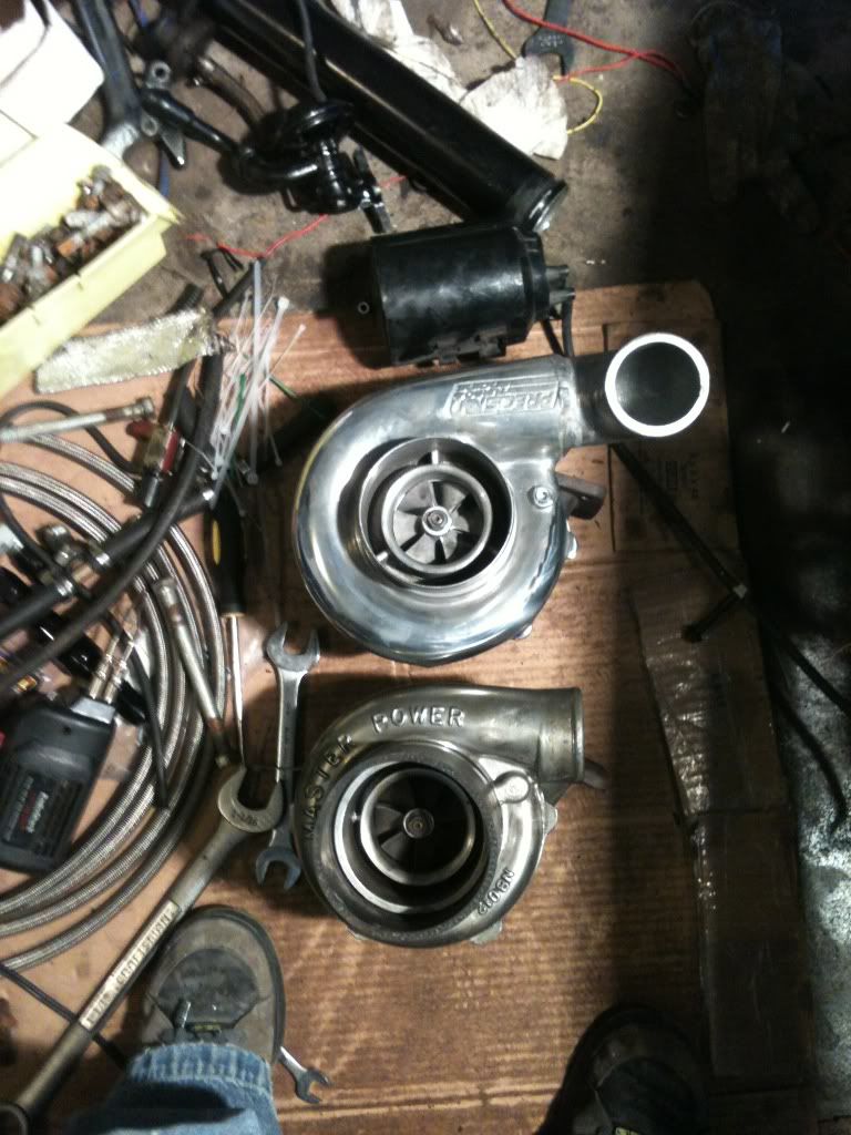

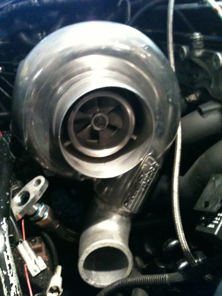

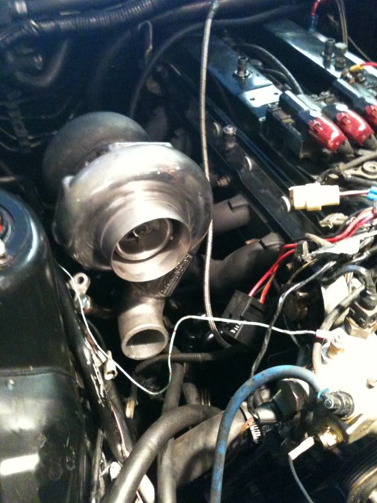

Today i got the turbo mounted on the new manifold, had to get longer bolts cuz i only had 2 studs that had enough thread with the extra spacer.
Also i realized i never compared the precision to the master power turbo.
Even though the Precision turbo is a 63mm it is a little larger in size over the 64mm Master Power. Wonder if this will change how the boost hits.
I did get the turbo mounted on the manifold, You can now see where i hit the manifold in to fit the MP64, with the extra spacer this turbo has no problem clearing it.
Next is getting the oil feed and drain hooked up, as well as the down pipe.

I'll be going with a single dw300 pump intank and in the future when i decide to go e85 i'll add an a1000 externally. -8 teflon lines from the tank to rail, gonna use the stock return for now.
