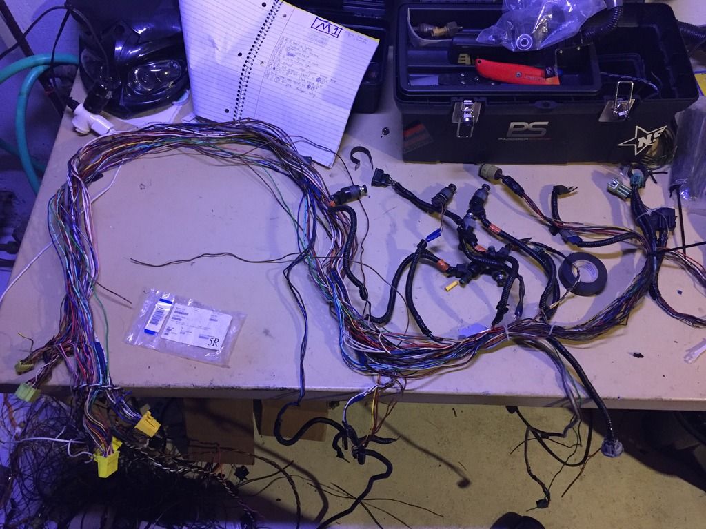

The engine bay harness with the fuse box will be getting replaced, I messed with my stock one and put the fusebox behind my foglight. Well I think this was allowing water to get into the plugs and corrode the contacts as well as everything else in there.
Hopefully when that comes in and swapped out it will fix the issues.
Also I'm collecting the parts I need to build a new engine harness from scratch.

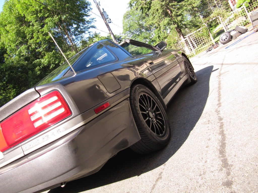

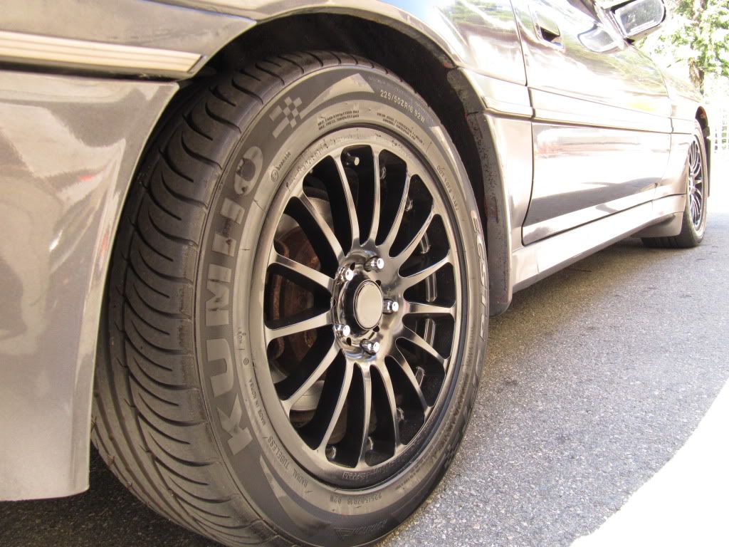

kotu100;1365694 said:
oh and new update for today, took the wheels that came on the car, cleaned em up and sprayed em black.
i dont wanna ruin the other wheels so i have some nice ones for when i get my srt-4 fixed.
What kinde of wheels are those? Looks awesome

After fixing the issues caused by the fusebox I put my focus toward getting the engine to run 100%. There was always that fuel issue and electrical problem that plagued me. The coolant temp would have random spikes and my tuner said that there was a lot of noise in the sensors that he couldnt work around.
I believe i found the culprit to be a coolant temp sensor actually grounded to chassis ground and not the dedicated sensor ground.

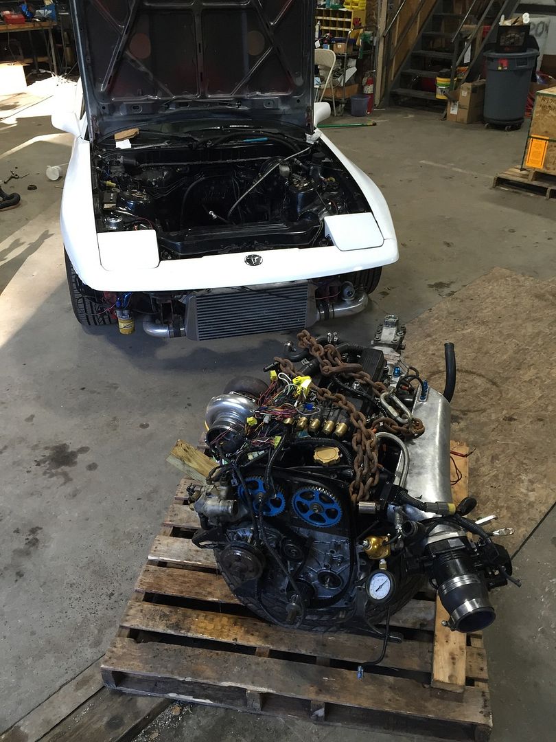

Unfortunately I was unable to put this to the test. The whole reason The harness came out in the 1st place was because the engine had to come out courtesy of a messed up oil pump driveshaft. So out comes the 7M again....
I know i've said in the past that i was done with it if i had any more problems but call me stubborn. I want to drive this damn car the way i intended to and that doesnt include a JZ!
I found someone local to me that i believe i can trust as he's made some big strides with the 7M. Currently the engine is getting:
Wiseco pistons .050 over
upgraded wrist pins
new toyota oil pump (last one in the us!)
arp head inserts
new oil pump driveshaft
Once the engine comes back it will be getting a fresh set of ARP heat studs to hold down onto a HKS stopper mhg. New oil cooler and lines to make sure none of that shit makes it back into the engine and bearings.

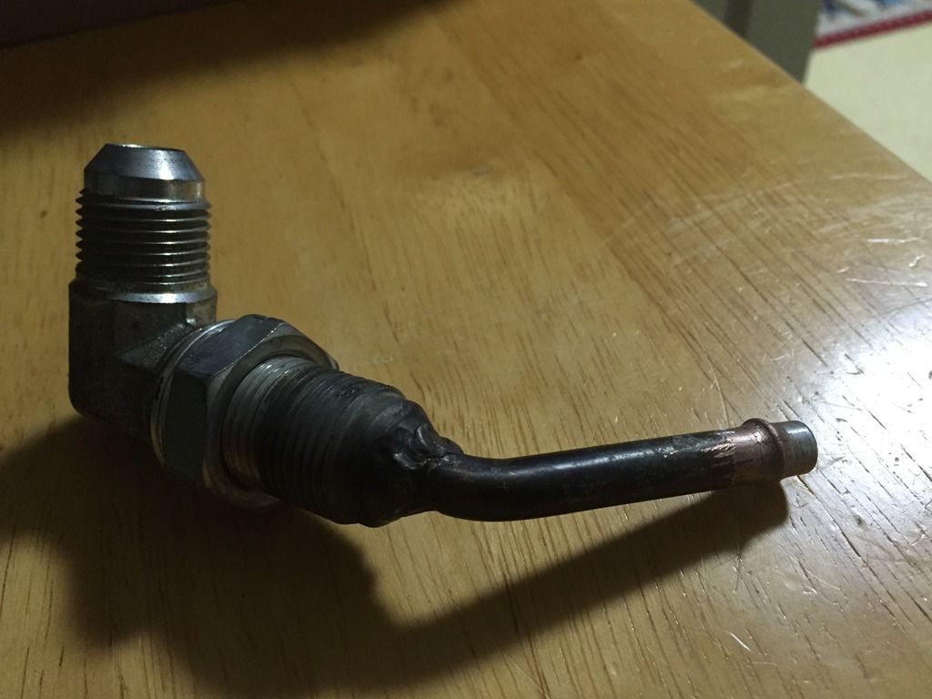

Next up is the fuel system. Currently with the 880cc injectors and AEM 320lph I should be good to at least max out 93 octane before i run out of fuel. I could never figure out what the damn issue was until my brother suggested pulling the fuel pump hanger assembly out and blowing some 35psi compressed air into the -8an bulkhead outlet. Sure enough air bubbles coming from where the soft line is clamped over the hardline. When I welded the hardline onto the bulkhead I had to cut it to fit and never put a lip on it. Big thanks to Abe at Kaizen tuning in MA he was able to put a nice bead on the tubing for me. This will get assembled and tested soon.

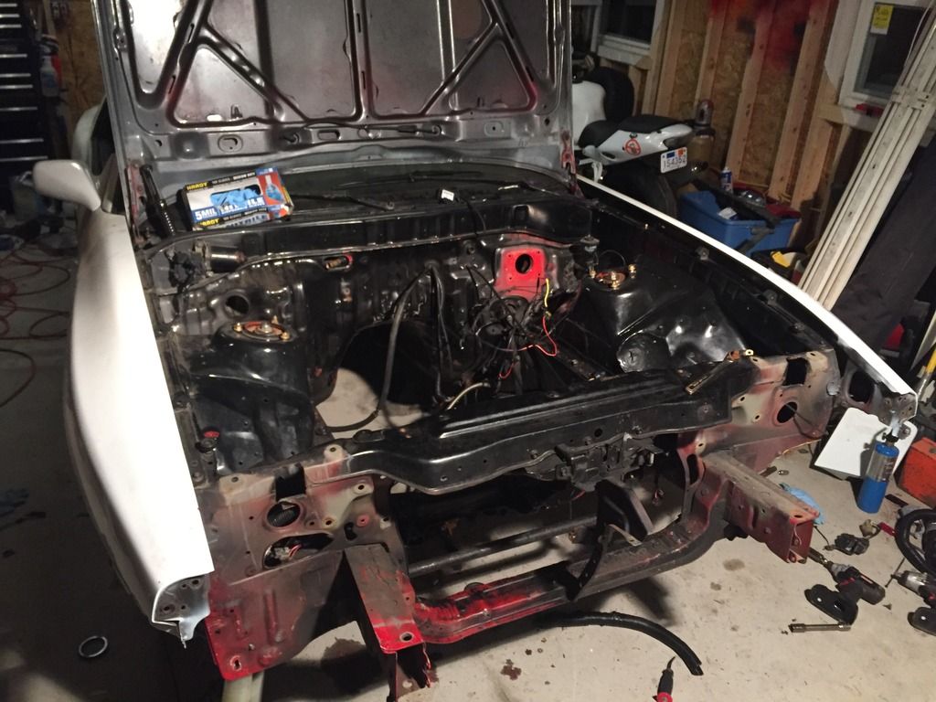

All this work being done to the engine just leaves the engine bay all empty and looking like shit honestly. The oil leak from the oil pump driveshaft and power steering rack leak have basically covered the bay and underside of the car in a nice slick of rustproofing crap.
Plans for the engine bay include filling all the useless holes and stitch welding the seams, fixing the rad support where i hacked behind the lights to clearance for the projector plugs, and fix the fender well where i smashed the shit out of it to get the throttle body to fit. Fenders are coming off as well and the ENTIRE front end of the car from the cowl forward will be getting fresh white paint. Its been below 40F degrees lately and no heat in the garage yet means no work getting done. I have managed to strip the bay 95% of the way and it shows how I slacked when i painted it before.
ABS has been removed and I'm currently looking at alternate brake booster options. Mine was dented and i'd rather replace it with a smaller unit if possible. I've read something about the MR2 one fitting but im not sure which. I know i do have to get a non-abs master so everything works correctly.

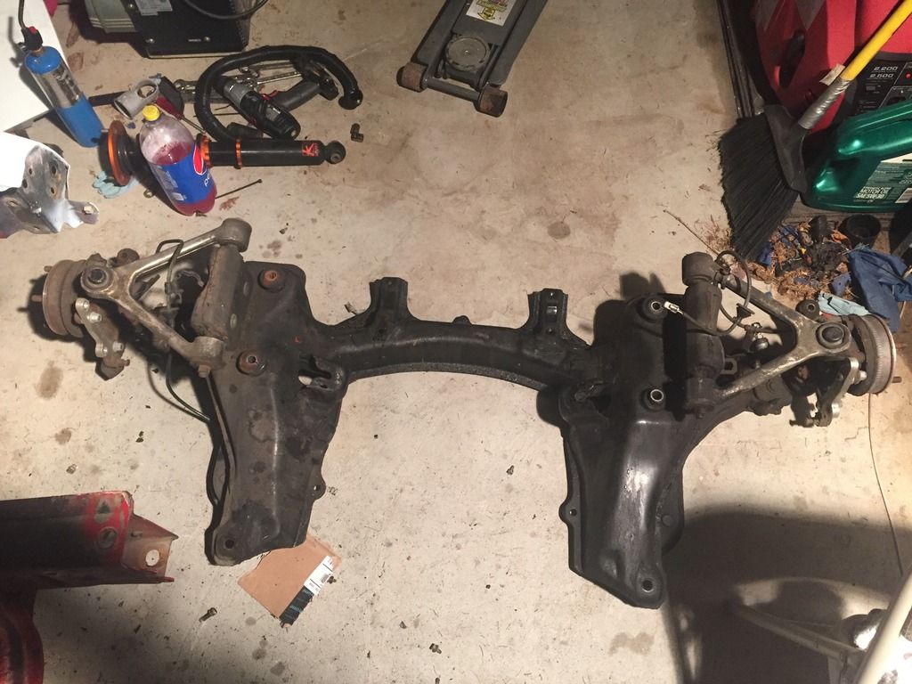

The front subframe has been pulled and RonnieK yellows ordered to match the rears. In process of cutting the rusty ass camber bolts off to get everything disassembled and cleaned so i can inspect and see what needs replacing.
