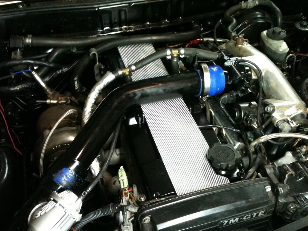

Cranked the engine for the 1st time friday after priming the oil system. It fired but i had a massive leak in between the TB and manifold.
I've wanted to hide the coil packs for the longest time but instead of just using some sheet metal i came up with this idea.
