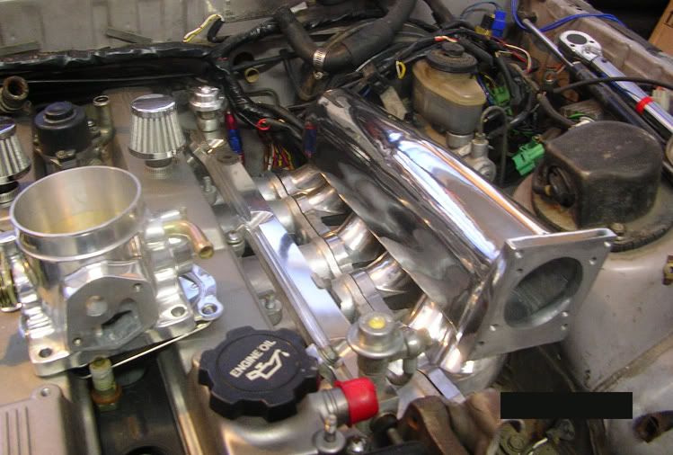

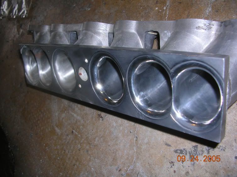

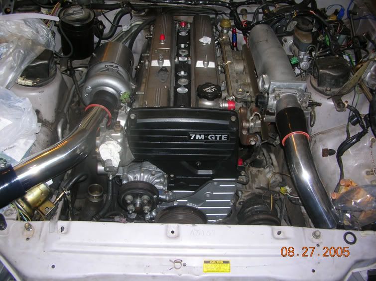

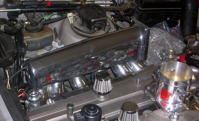

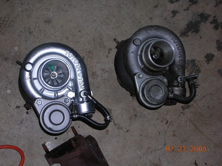

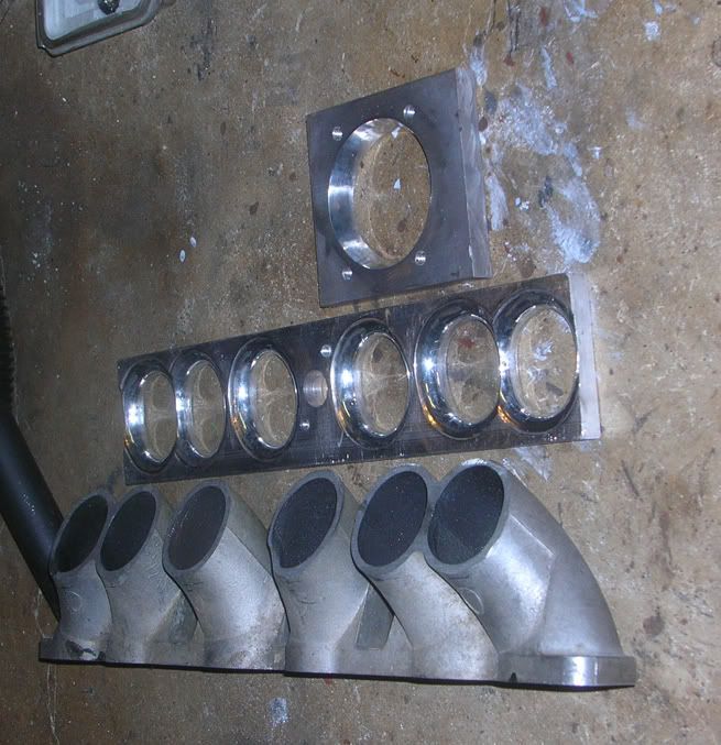

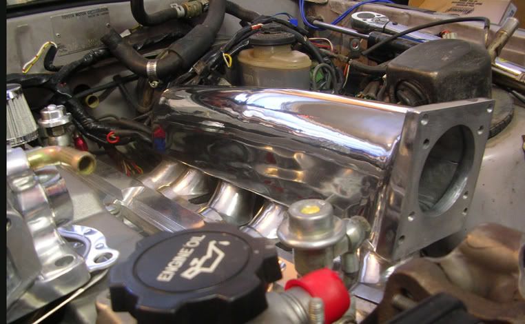

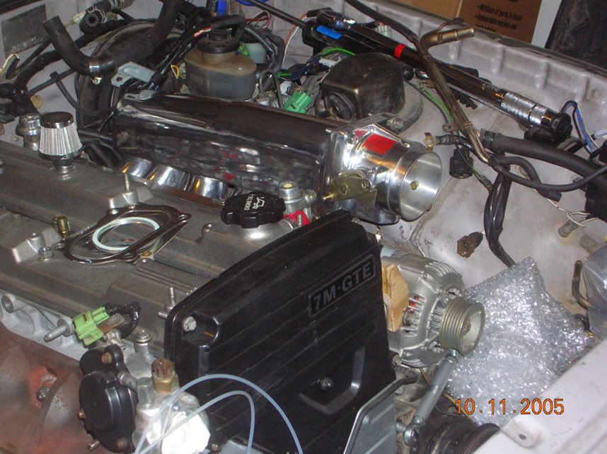

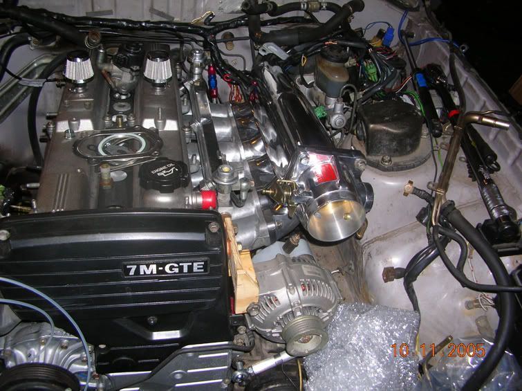

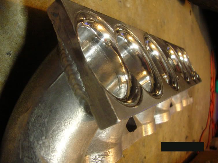

Ok, lets take a trip back in time, I'll set the flux capacitor back to before I was a member here........Ok, so here are some pics of the initial build progress including some intake mani "dummy" pics, used for test fitment and clearance. She's come a long way...........

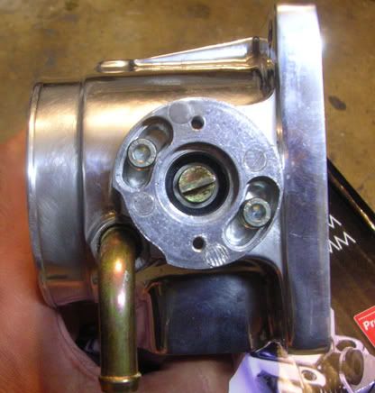

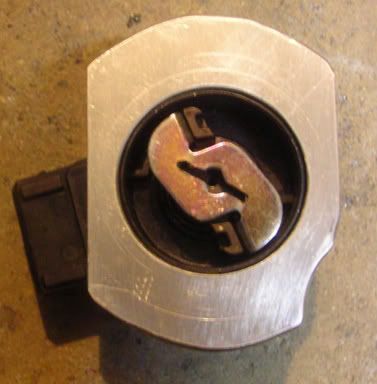

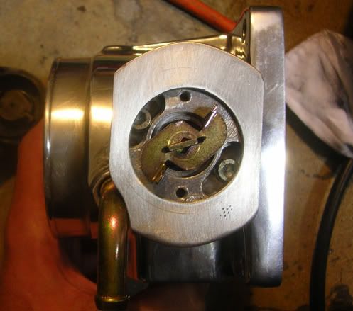

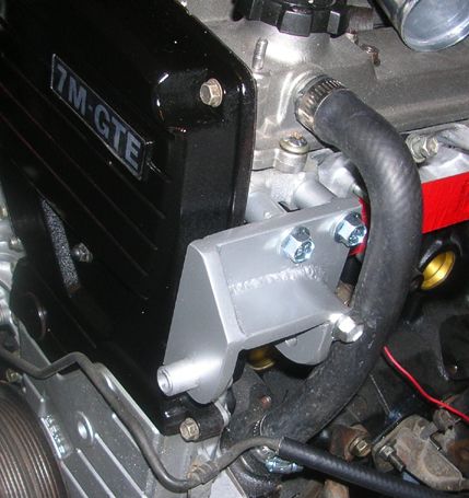

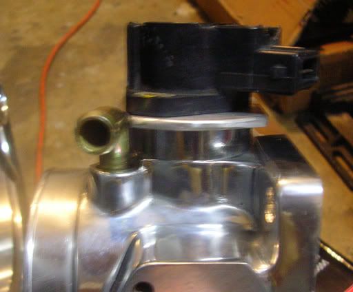

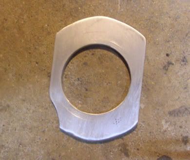

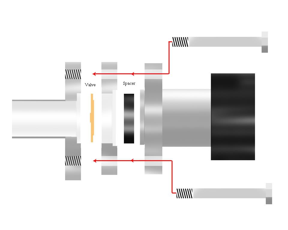

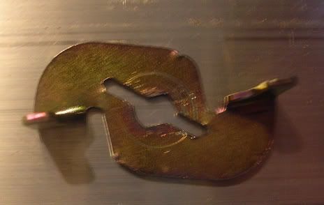

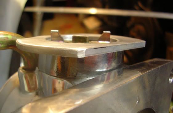

Ok I had someone on here ask how I relocated my ICS so I will just quote my own reply:
jimi87-t said:
I used 1/2" aluminum plate and some aluminum tube. I cut out the plates as seen in the pic, to fit the valve, spacer and so on. I welded the tube on and attached a hose to the tube and fed that to a similar plate made that fits on the bottom of my TB (engine side of throttle plate, TB already had provisions for a Ford ISC).
