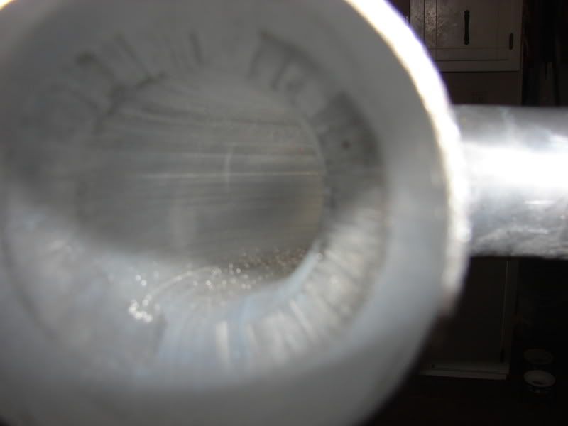

I kinda consumed a few too many adult beverages last night to be a whole lot of good for my car today. I did pull my suspected IC pipe even though I couldn't hear it leaking any air during my test. I have a spare, so I was gonna cut it to match this one. BUt when I pulled the pipe, I got a very disturbing sign. This is a picture of the metal shaving grit i found inside of it. Somebody tell me that this is normal for new metal piping and I have nothing to worry about. Otherwise, an elplaination would be appreciated even if it is not at all good.
gtsfirefighter
SM Expert on White trash
Sep 26, 2006
2,966
DFW
Are you sure it wasn't in there before? Check the fins on your turbo. You might consider cleaning out all your IC piping and IC.

I'm starting to think about talking to Jay about getting my car and Vonda's together for a good olde fashion Bama Bon Fire!
Honestly the idea of checking turbo fins is a good one Ken. It is the turbo that I got from Jay, that has the t04 "H" wheel in it, which is the largest wheel that will fit in a CT-26. I'm sure the slightest shaftplay is gonna cause some shavings sooner or later. He said that it has about 200 miles on it prior to going onto my motor, and I may have put 100 or so on it.

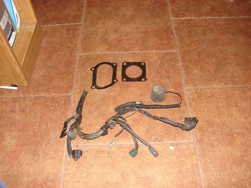

These are the parts I received in the mail today. I bought the turbo gaskets from BlueMKIII to keep as a spare. The wiring came from GTSfirefighter. As I think I have posted before, all of my brittle wiring at the thermo housing is broken and rigged. I was able to get wiring back into the green plug that I believe goes to the ECU temp switch, and I put it on this morning, clearing up my check engine light as expected.
I also replaced my bad passenger front brake caliper, and adjusted my fuel pressure up as Jay instructed me to do. Then, I put my intercooler pipe back on. The shavings in the pipe were probably original equipment, as the other 180 pipe I replaced it with had the same shavings, and it had never seen use. Lucky I have not yet been able to put much bost thru it yet.
After doing those things, I drove it around the block a couple of times. The brakes are way better, but I still have to do the back two. As for running, I believe it is a little better, as I was able to get it up over 5000rpm with little trouble. I played with my NEO settings a bit until I thought I was dangering the motor, and it did make changes like it should. Maybe a good tuning will help it now. It is still dog slow from a start though, and seems like it could still have some sort of leak.
