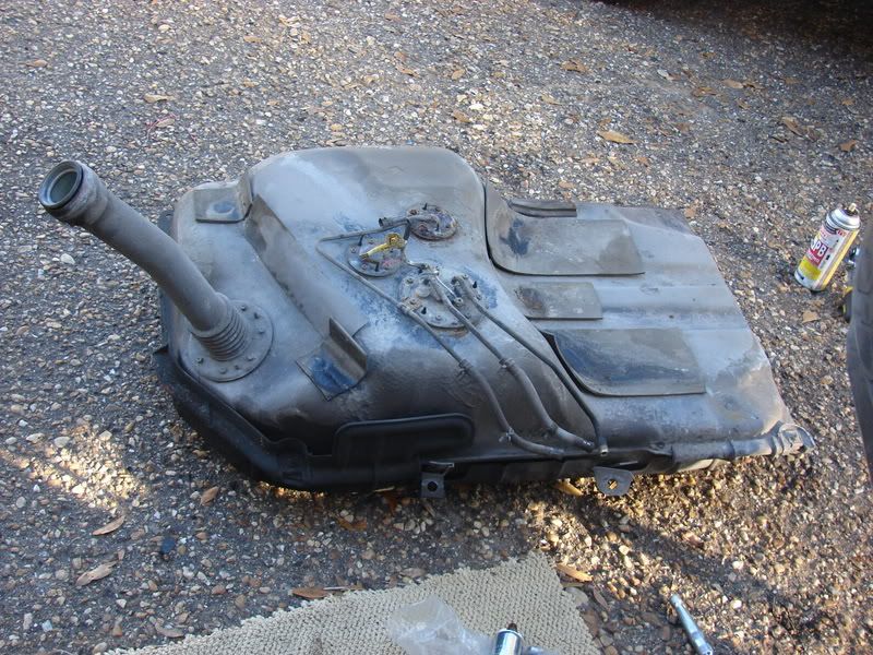

Here's a few pictures of today's progress:
Here is my tank out of the car! Took less than an hour to get it out. I sat and read my Walbro instructions after draining the gas to let things air out. Then I took another break as I let some PB Blaster soak into the fuel line. It did the job, and I didn't have to make any line repairs as I have read that many people have to do.

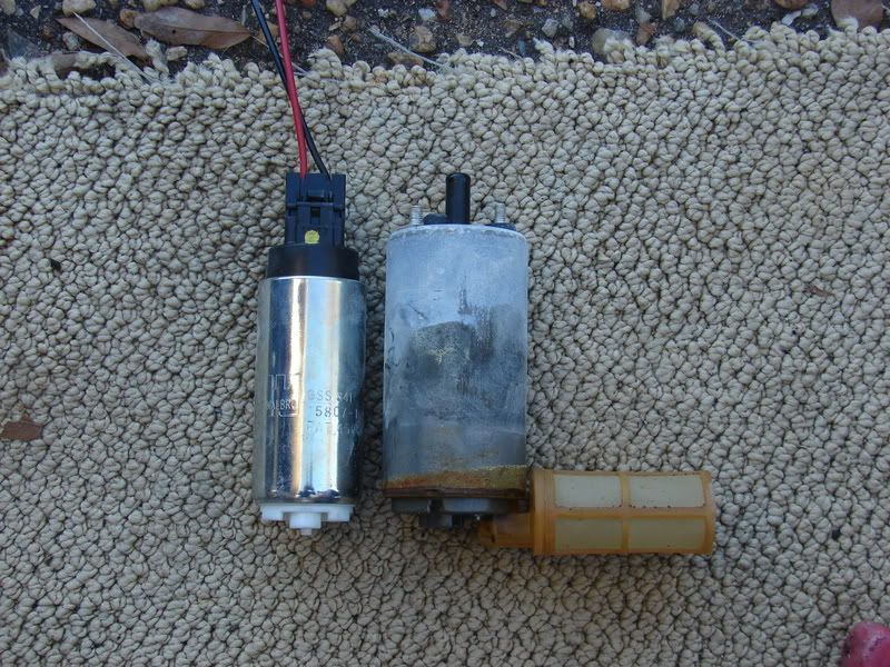

Here is a comparison of the stock pump against the Walbro. It's hard to believe the Walbro can pump so much more from such a small pump.

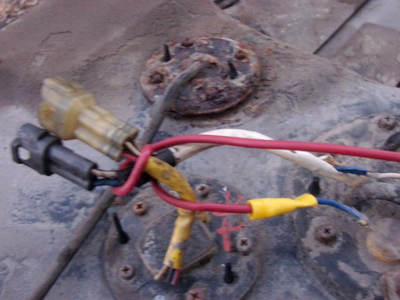

Here is the Walbro installed into the bracket. I'm fumbling my way through Sheaff's wiring thread, and I'm waiting on an answer from him about what I have done so far. I'm scared of the butt connectors in the tank, but I think they should be fine, as the stock wiring was bolted onto the pump in the tank with no covering at all. I just want to be sure it doesn't go boom the first time I turn the key.
And here is the pump installed back into the tank. I have the positive wire spliced into the stock wiring, and wrapped around the two connectors ready for re-installation into the car.

I think you can use the stock wiring, except for the two wires in the tank. It is said to be better to run the Walbro with a 12V relay to get it the most power you can. Maybe that is why the smaller pump can do so much more.

I ran mine with the factory wiring and had to turn down the AFPR as the stock fuel pressure was too fat. How much horse are you planning on?

It looks like you had some rust /corrosion going on inside the tank. The original tank on the red rocket was worse, the sock was plugged! It was like rust/ debris 1/4 inch thick on the bottom of the tank. It must have sat god knows how long with the cap off. Anyhow, make sure that sucker is clean inside before you stuff it back in the car.

Actually Ken, my tank was much cleaner than expected. I had planned on taking it and cleaniing it out, but I couldn't see anything in the tank. It was grey all they way across the bottom. i do see what you are talking about on the pump though. It looks like the pump itself was deteriorating a little. You can see the very small amount of stuff on the screen in the pic. And, sheaff answered my PM, and I think I can finish it from here.
