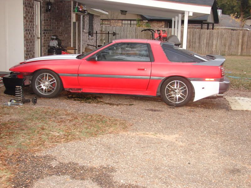

Yes the car turned around under it's own power........as in running! All I did was turn the car around tho. I have removed the springs from my parts car, and they can be seen in the photo sitting by the car with the spring compressor. I've been pretty sick, so progress is slow there. I removed the driver's side front and rear springs out of those springs. I'm gonna use front springs with rear struts in the front, so that i won't be in 4WD mode with my stock springs.
As for what I think the problem has been with starting. My guess is that it's got something to do with the cold start injector. It was very warm today when I tried to crank it, and it started after just a little bit of trying. Once it was warm, I can start it with no problem. I've gone back out every two-three hours to try again, with no problems. I think I will pull the CSI and clean it good.

The cold start problem usually ends up being the cold start injector time switch (in the t-stat housing). Neither of my cars ever starts on the first crank, the red one doesn't have a cold start inj any more....they fire right up in warm weather, but 2nd-3 rd try in winter depending how cold it is.
