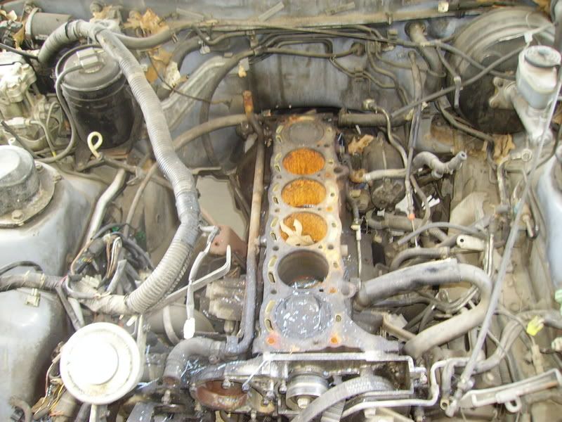

That pic makes baby Reign cry! :cry:

Don't cry, it's all better now. :icon_bigg You can see a pic in my build if you like. I don't want to clog up Scott's with anymore of my crap.
