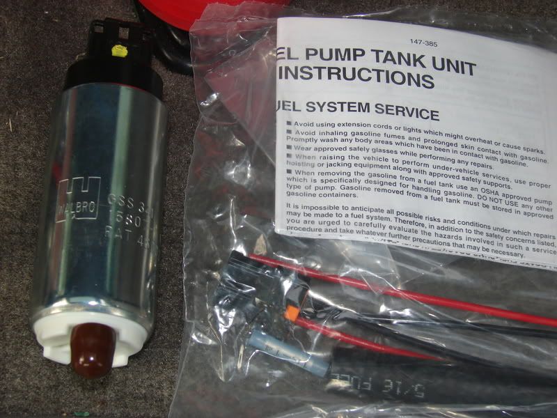

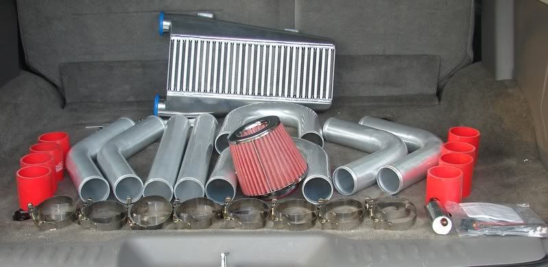

I got a bunch of new goodies today from Driftmotion!
I got my new intercooler, IC piping (with RED couplers), Walbro Fuel Pump, and Air Filter. I just got off work, and haven't eaten.......So pics will probably be tomorrow.

I just was a little shocked at the size of the Intercooler. It seems a little small to me. I'll compare it to my stock one tomorrow. Maybe it's thicker??? It is pretty! I sure hope it is more effective than stock.

Ya, that's the one. Was your's small? or did I possibly get the wrong thing? My stuff did all come in a box marked S13/S14. I doubt Aaron would have screwed up, just used whatever box all my stuff would fit in.

I was just looking at wills7mgte" thread with his install of this IC. It looks like the same thing. In the box it looks small, but mounted on the car, it looks pretty good. I'll get it out of the box tomorrow.

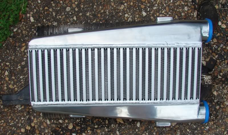

Well, I finally got off my ass and took some pictures.
The intercooler...sitting on top of my stock one. Length and height are the same. The new one is a good bit thicker, and hopefully the pressure drop won't be near as bad as the old.

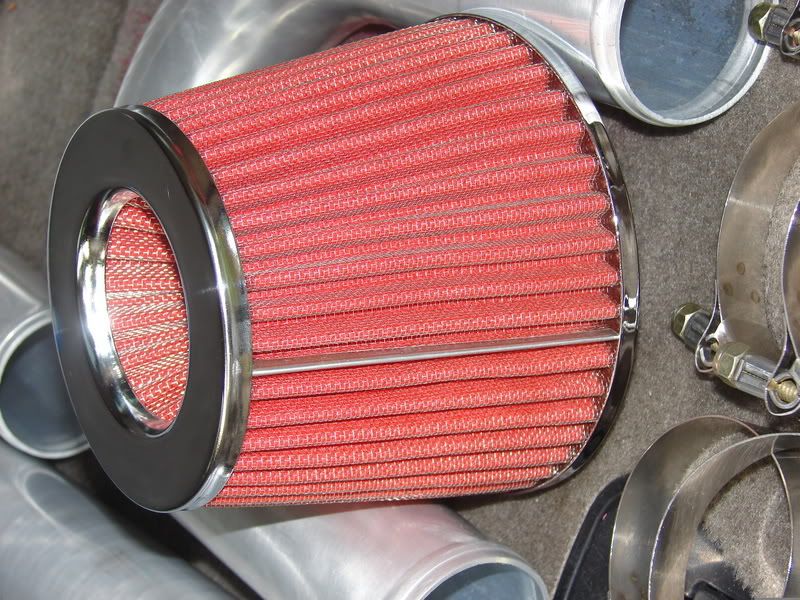

My Lexus will also appreciate this. Ya, it's a $10 driftmotion filter

Hmm that link doesnt work. As far as the fuel pump goes, dont make the same mistake I made. I would highly recommend not cutting the wires and crimping to the old. I recommend replacing the whole wire. I realized after cutting and crimping that the remaining factory wire was in bad shape and the sheath was peeling off. You will have to drill out the rivets to remove the old. I reinstalled with screws and nylon nuts on the other end so I wouldnt have to worry about them backing off. Just my .02

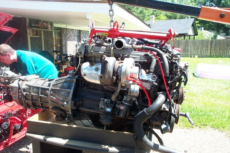

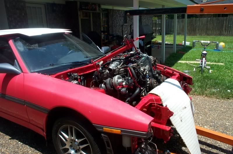

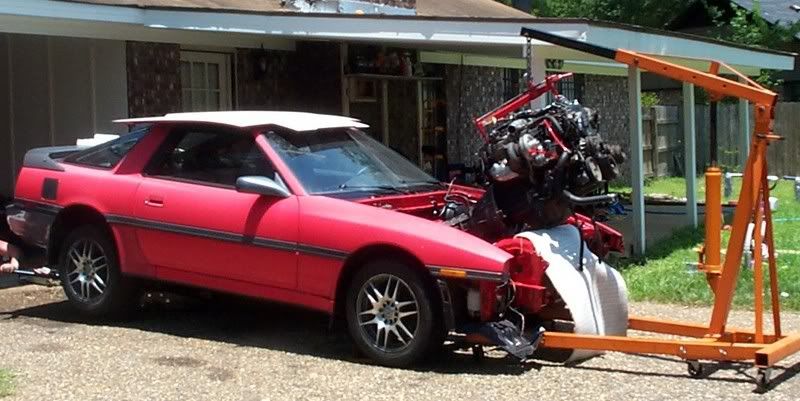

Here it is almost in the car
And this is a close up of the turbo. That's my nifty little motor rolling table it is sitting on
You'll have to wait on the next pic of it sitting in it's correct spot. We got it in, and found that my 89 has an 86-88 crossmember. Not sure if it has been changed, or if it is a carry over part in this 89. So, Does anybody have a set of square mounts? I gave my last set away.
