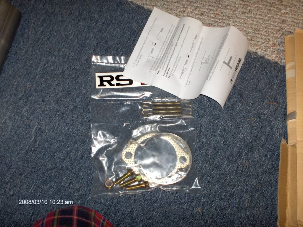

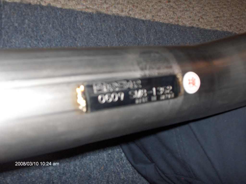

Got my stuff back and my RSR GTII exhaust came in!!!!

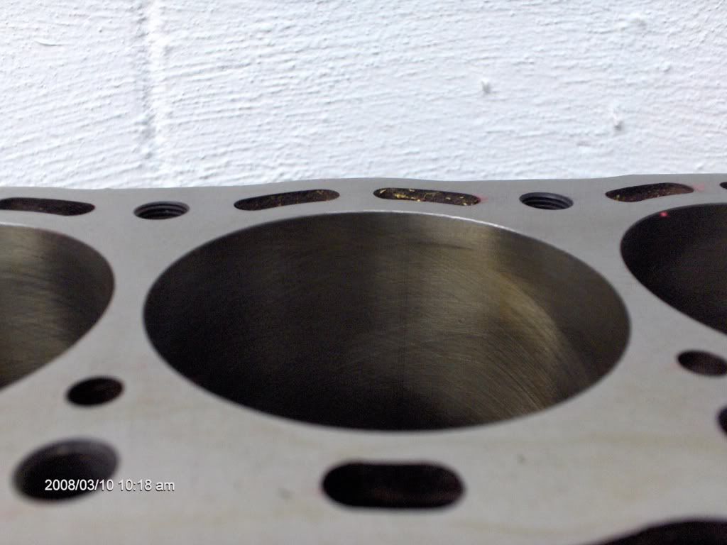

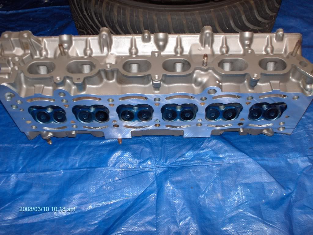

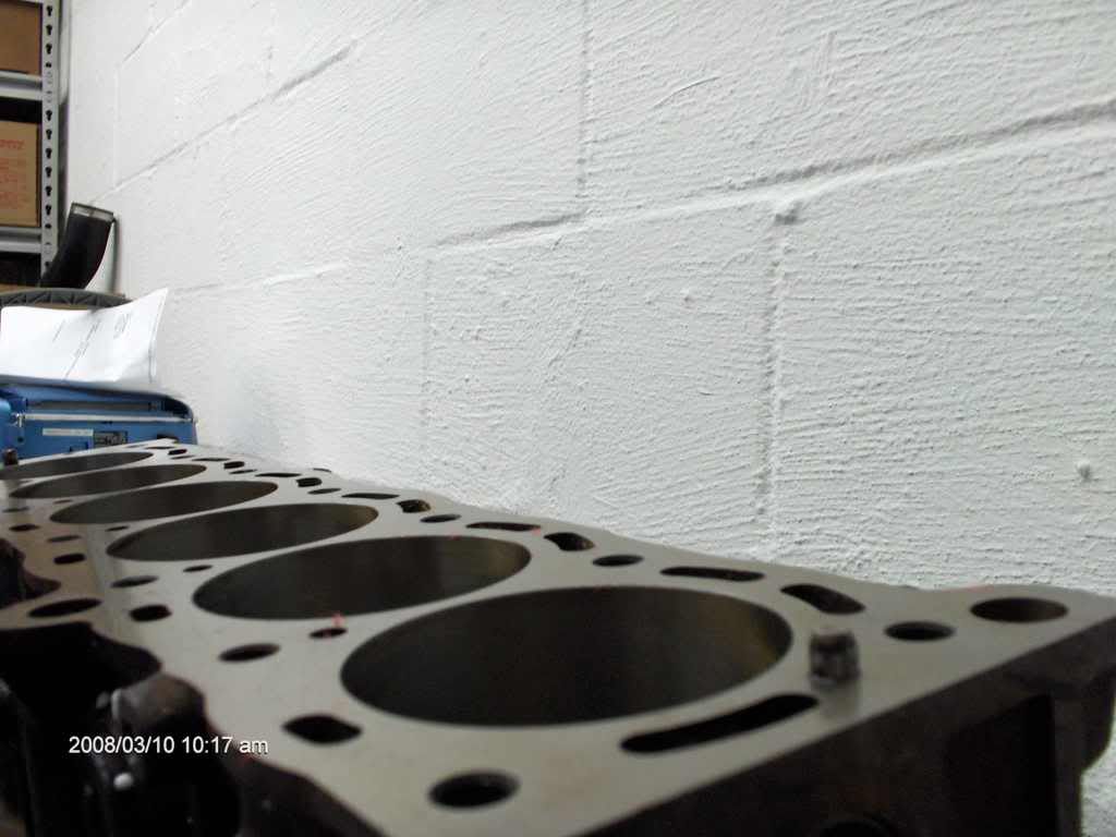

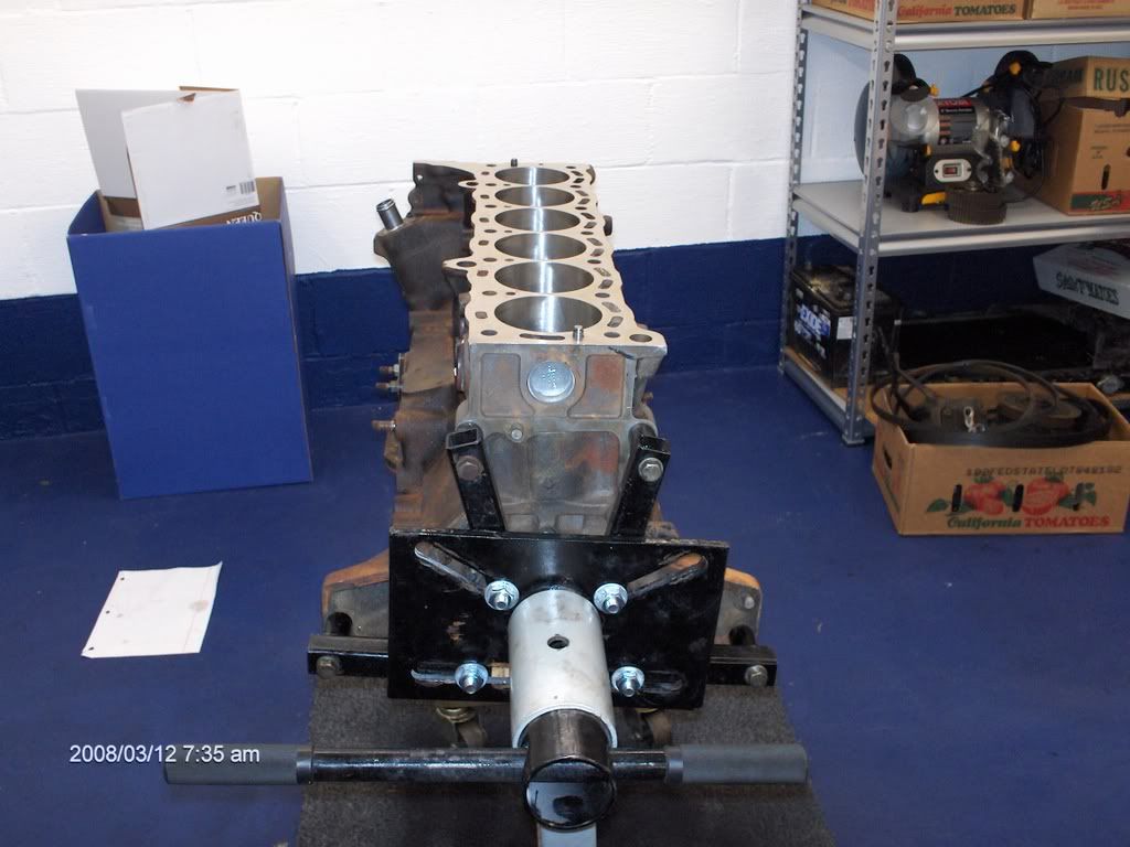

I asked the guy to measure my head and he said he would.he didnt mention anything when i picked it up so i figured the head is uncut.Well better safe than sorry so i checked. 115.47mm.This machine shop sucks!Looks like a 2.0mm mhg is on order.I guess the only way to check deck height is measure how far the pistons stick out? .012-.020" correct?someone chime in please...
Here are some pics.Enjoy :icon_bigg

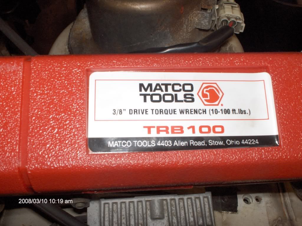

Matco torque wrench FTMFW...fuck snap-on AKA strap-on
stunning :icon_bigg

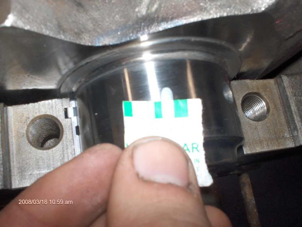

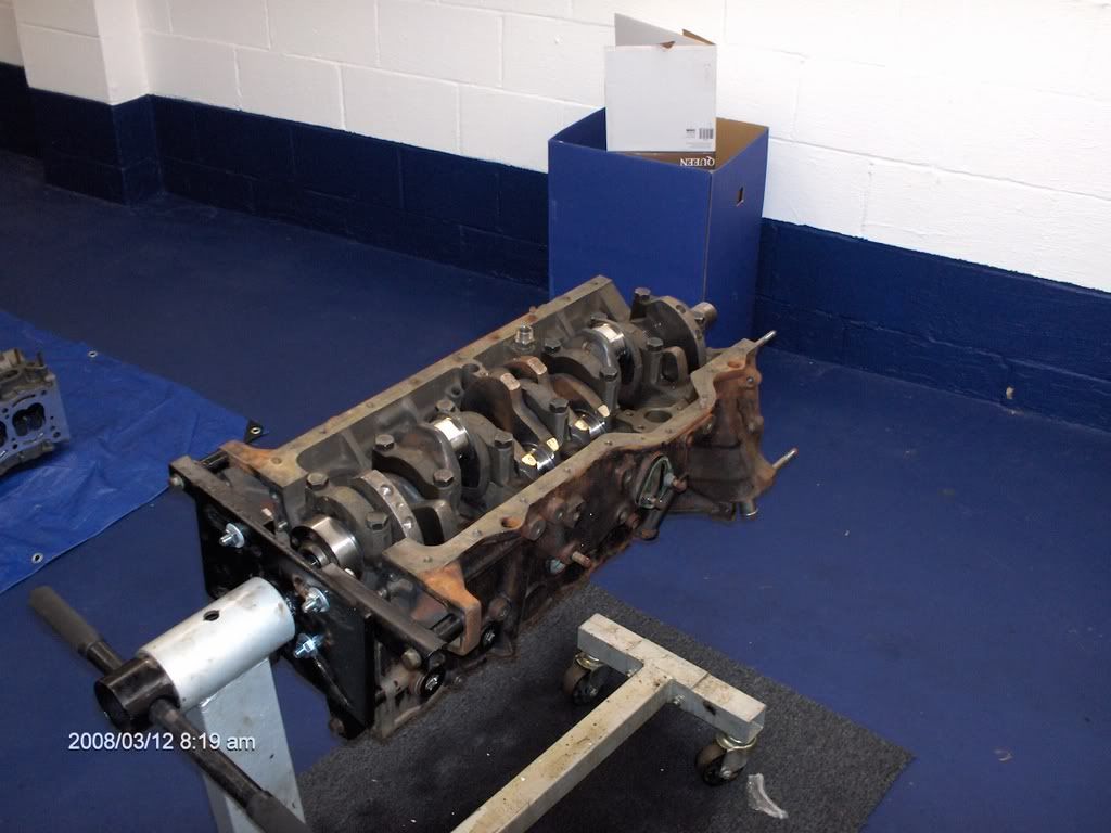

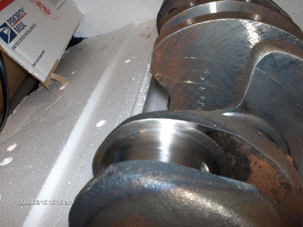

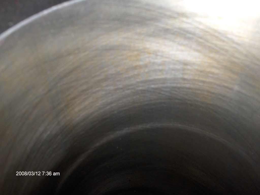

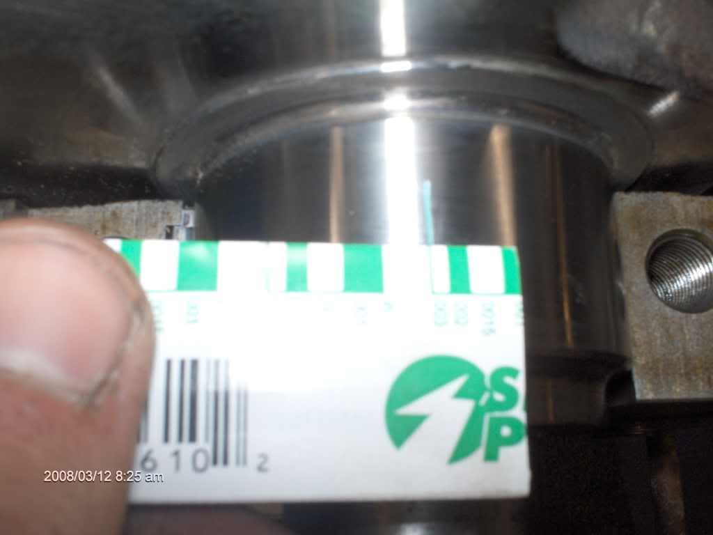

well this was depressing...i plastigaiged my main cap bearings with sad results...I thorqued the caps down to 75 ft lbs and pulled them back off.To my amussement, the plastigauge wasn't even crushed!!!!so i took the crank out and put the main cap back on with the bearings still in place and measured the inside diameter...2.361".i then measured my OD on the crank...2.350"... .011" clearance FUCK!So i'm guessing my crank was cut before?I got .003" clearance on my rods.
right now i got 2 choices: get oversized bearings or a new uncut crank...
my crank has blue heat spots around the journals...i'm leaning towards a new crank.
this is comparing it to the white .003" gauge.

my rods plastigauge good a lil on the loose side but i'll live with it so i ordered some clevite mains .010" under which should work fine...if any body wants some std size cleavite mains lmk...

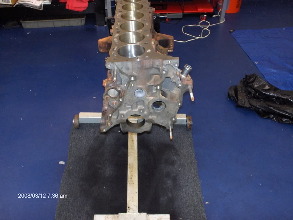

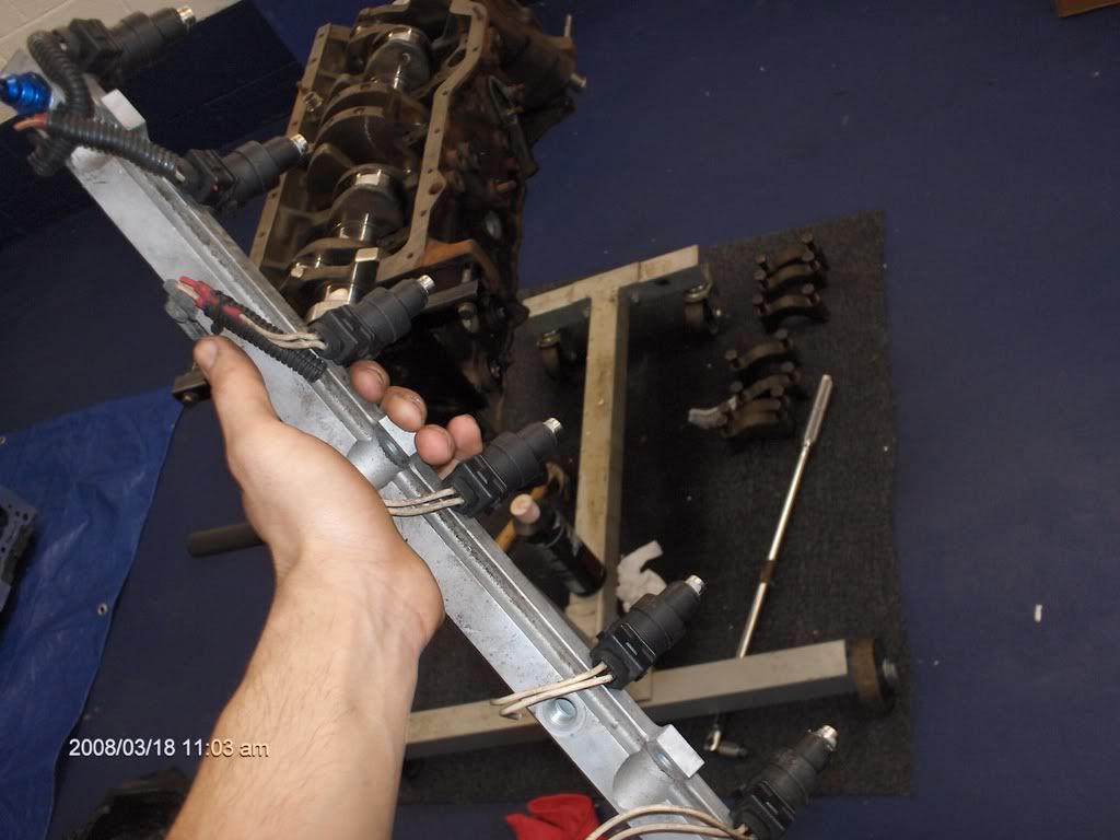

nothin really special but wth heres some random pics

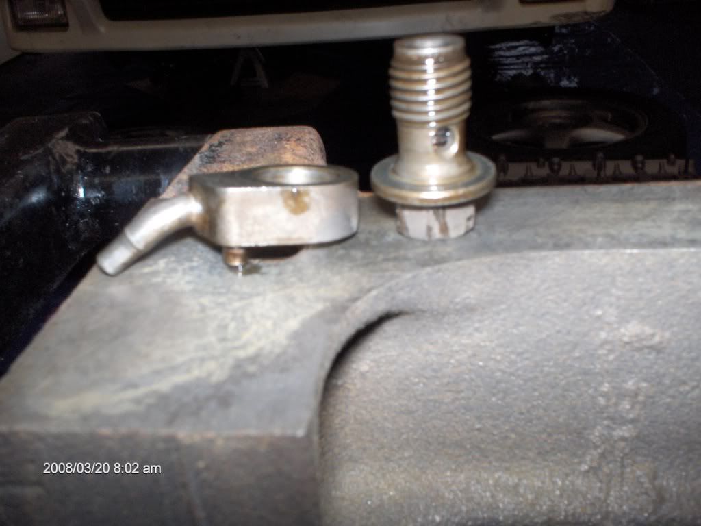

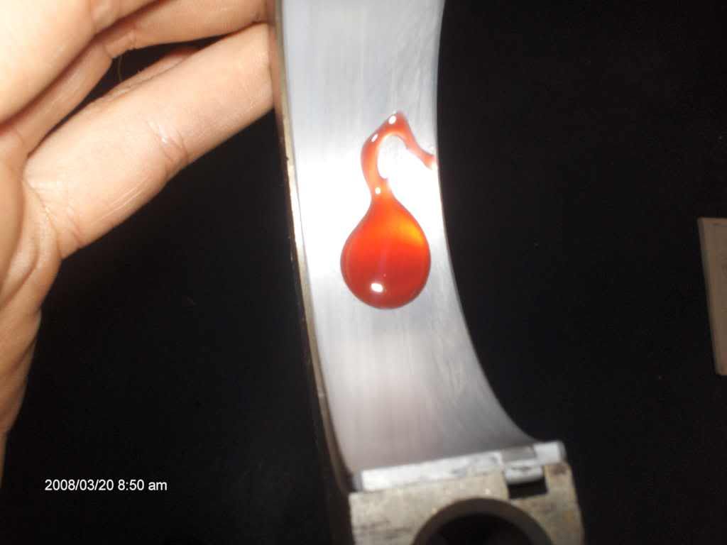

notice the main on the left, how the oil galley on the bottom is offset?normal?

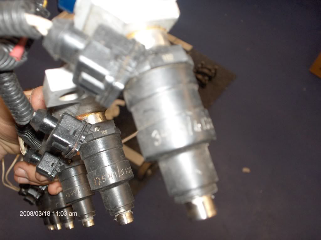

Also, my pte 550's came in...anyone know how to make sure exact specs on these?it doesnt say pte anywhere...

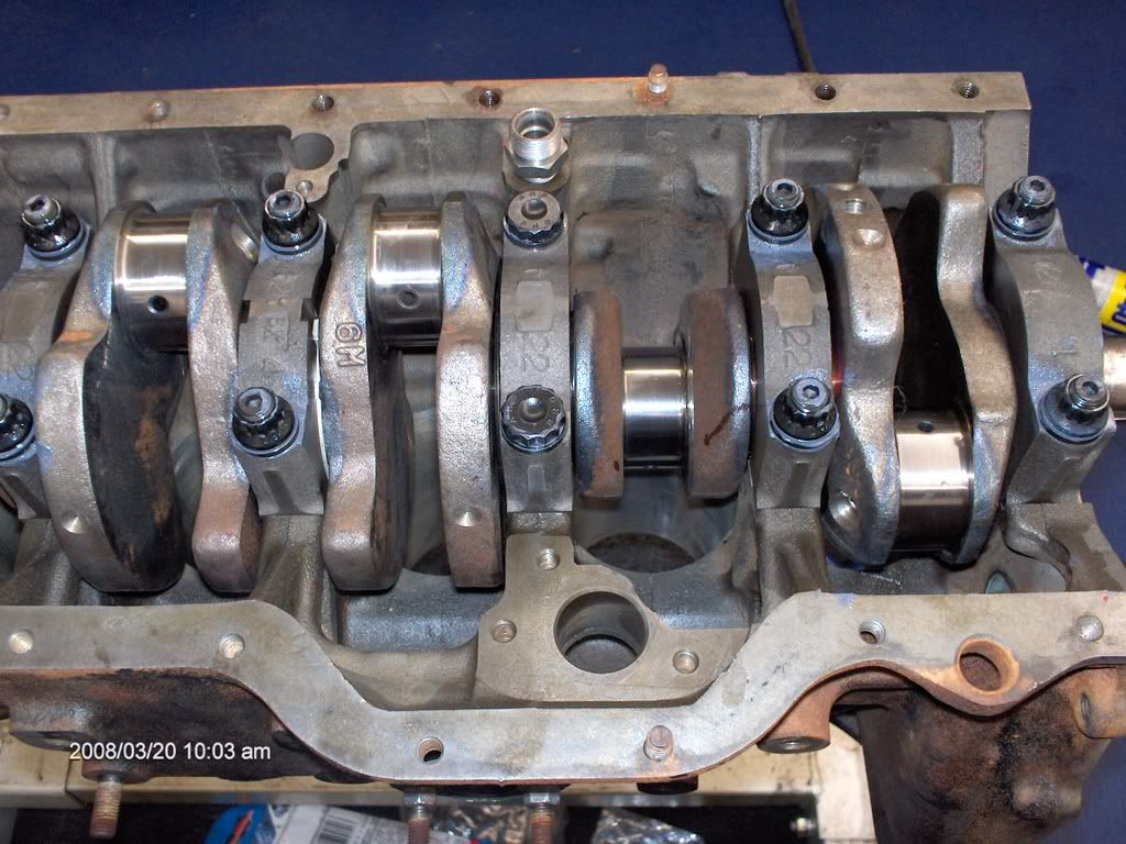

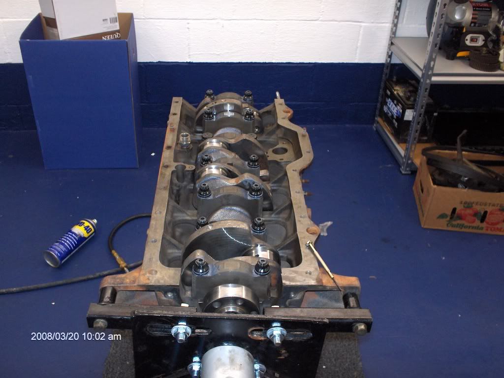

today i did th etedous work of measuring ring end gaps...thank god i didnt have to file or i would lost my mind.Every thing seems with in spec so i'm good here.
then I removed my pistons squirters and cleaned the shit outta them!

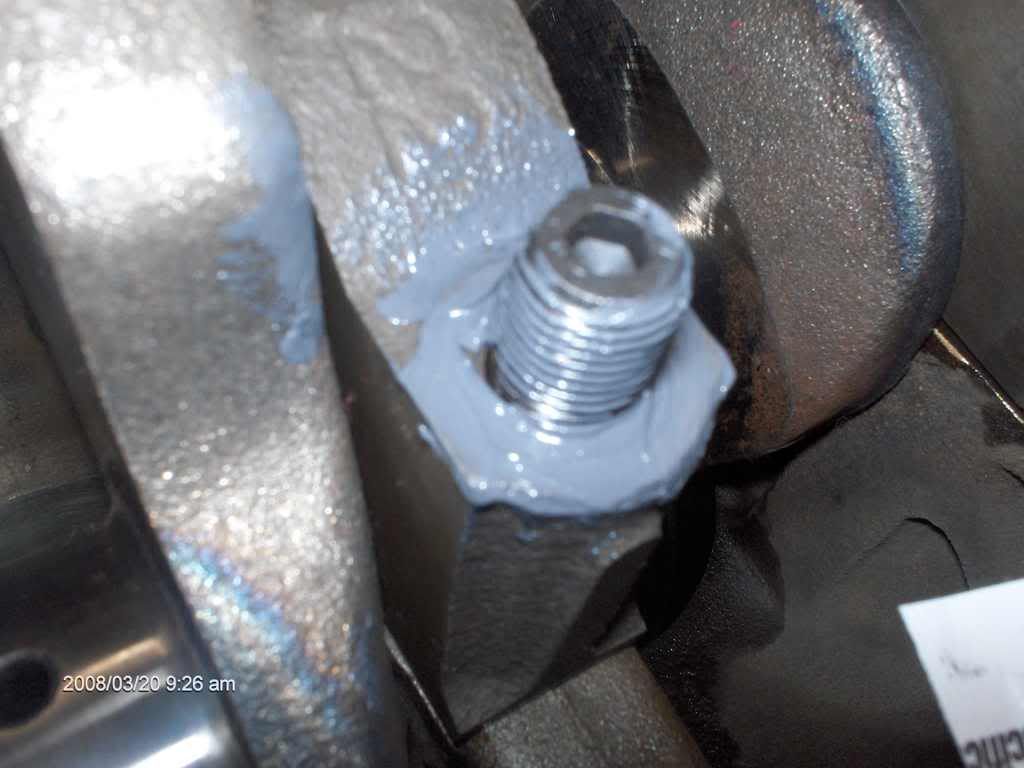

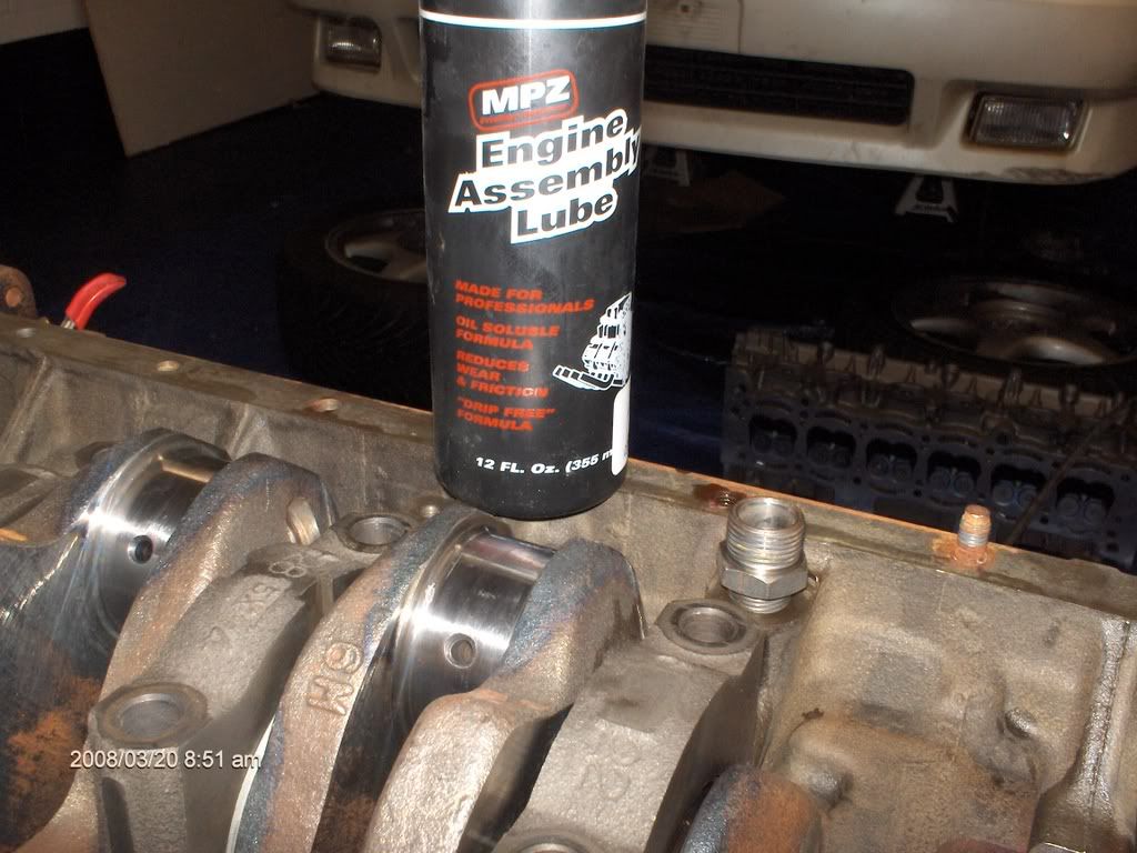

installed my crank, this stuff is the shiznit!
Moly lube mmmmmm......
ARP'd up..i followed IJ's advice and went
30 ft lbs, 60ft lbs, (80 ft lbs, loosened, x2 more times) then 85ft lbs.
Also for those of you wondering, the arpm main stud kit come with two bolts, they need to go on cap #3 so the oil pump clears.

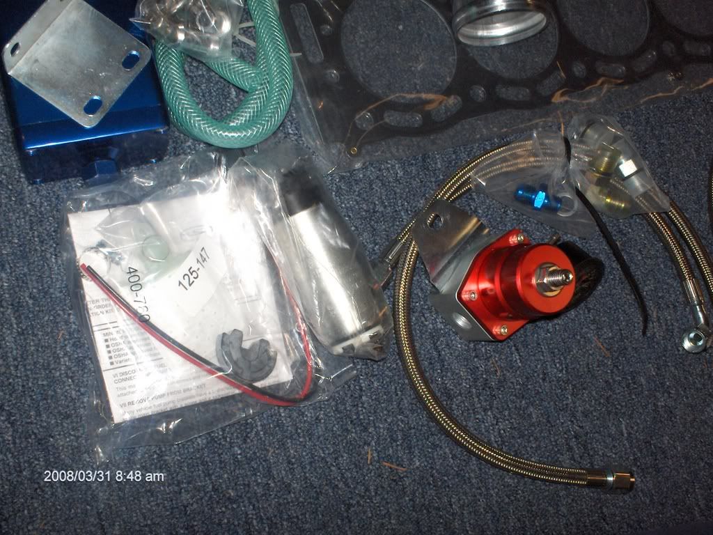

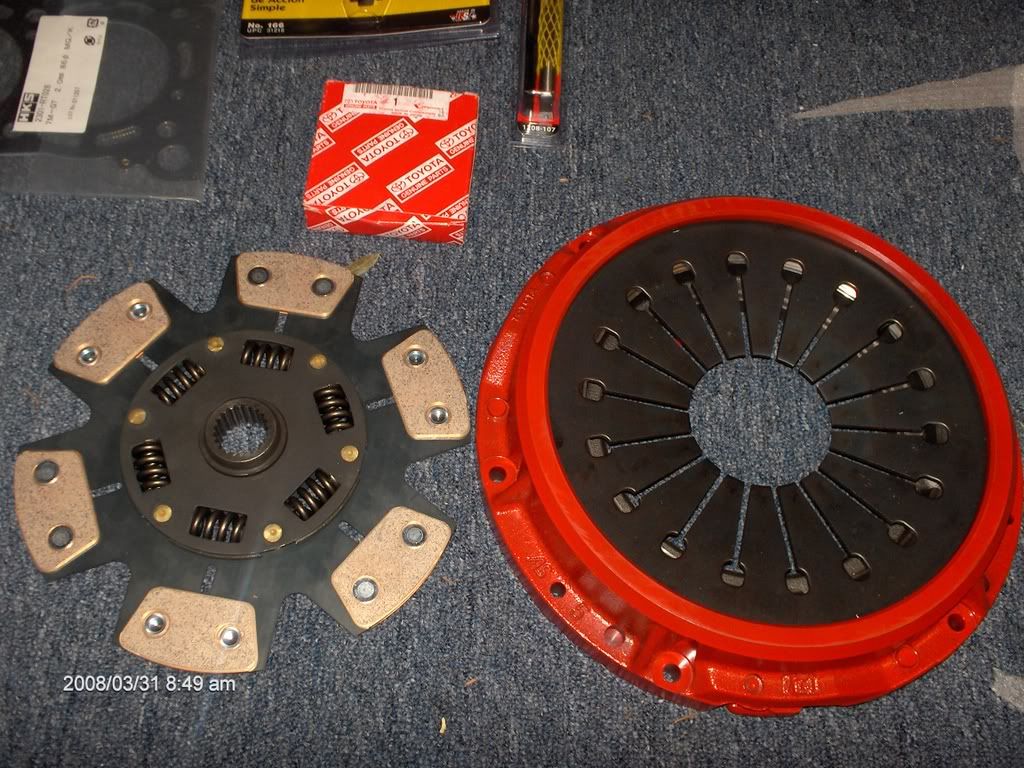

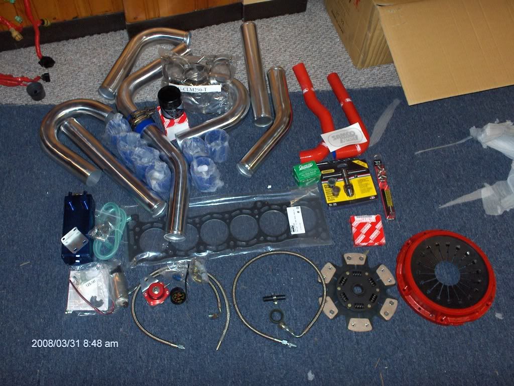

Pistons are in but no pics...just ordered the rest of my stuff from drift motion...stage 3 clutch, 2.5" IC pipes, HKS 2.0 mhg, AFPR, Walbro 255lph FP, 7/16 exhaust mani stud kit, shifter bushing, oem oil filter, catch can , samco red hoses...So all i need is to send my turbo and that should be it for now...then once motor get broken in map ecu and i'll install my 550's...I also really want a mishimoto rad to but i'll wait for my tax return...

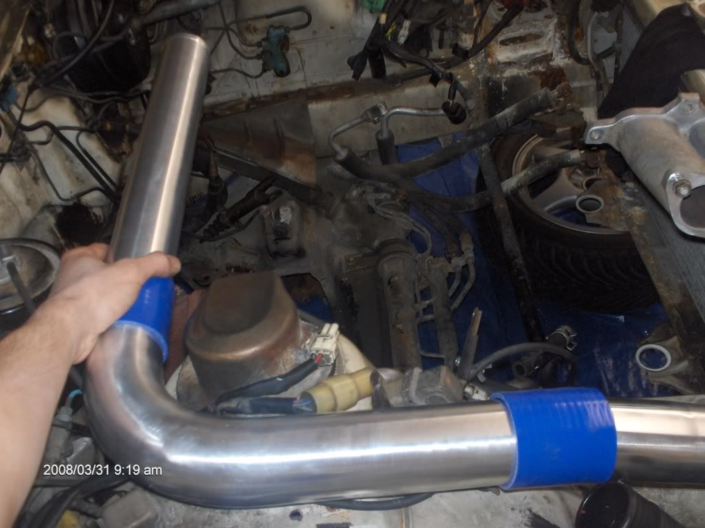

heres the IC i wanna get... 28x7x2.5 good enough?just as good as stock?28" should fit very nicely behind my bumper.It also comes with generic BOV and adaptor pipe.I really want an RFL but you cant beat this price...

I was planning on finishing up the block today but these came in :icon_bigg :

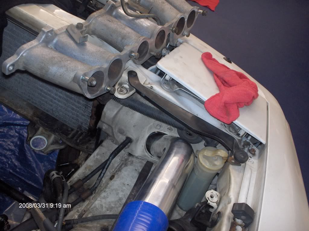

and heres how i'm thinking of routing the IC pipes, still gotta decide on IC first though...
