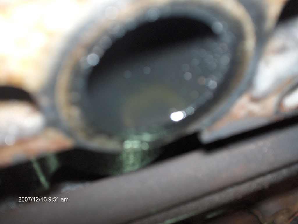

decided to start of easy and pulled the head off the motor yesterday...i dont feel like ripping everything off the engine bay yet and i've been spending time with the lady friend cause shes leaving this week to go back to school...

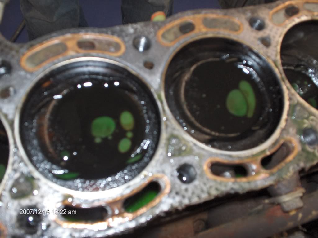

coolant was pretty much drained from the block, yet coolant on my pistons?

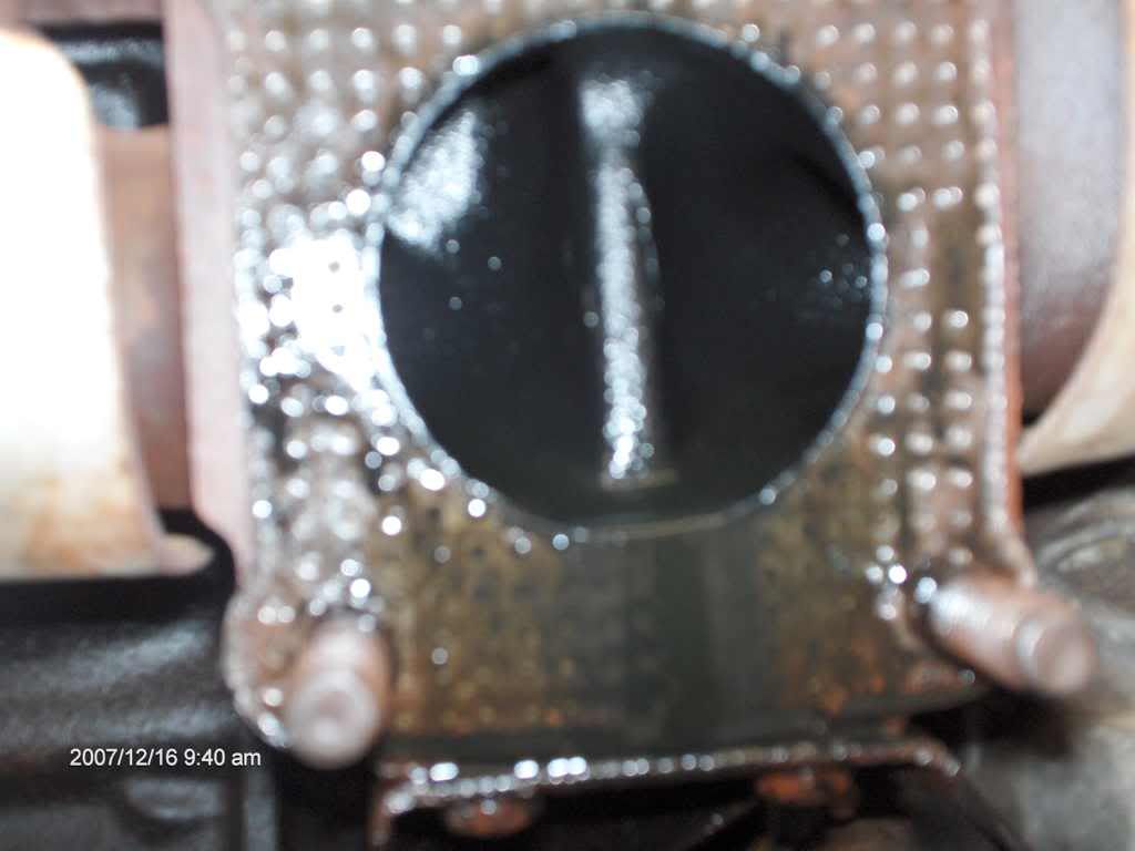

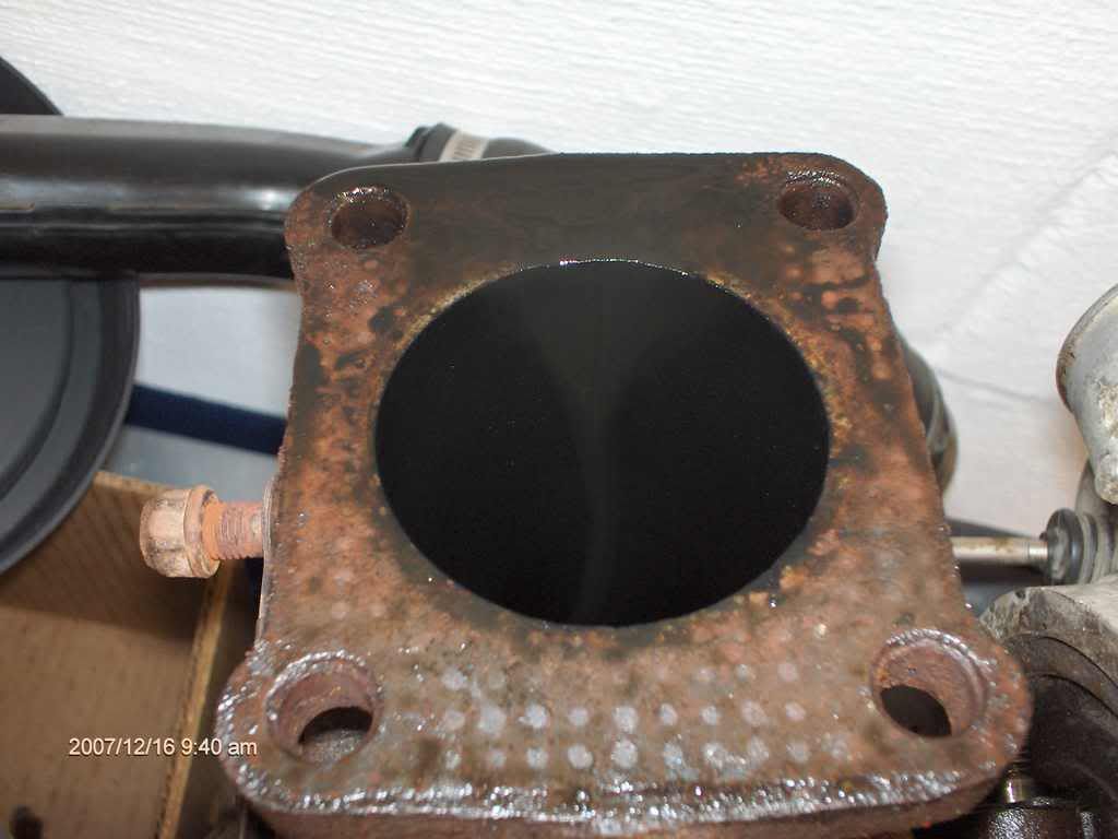

all of the exhaust ports except cyl#1 looked lie this...oil puking out the valve seals
so i guess i found out why it smoked so bad at start up :aigo:

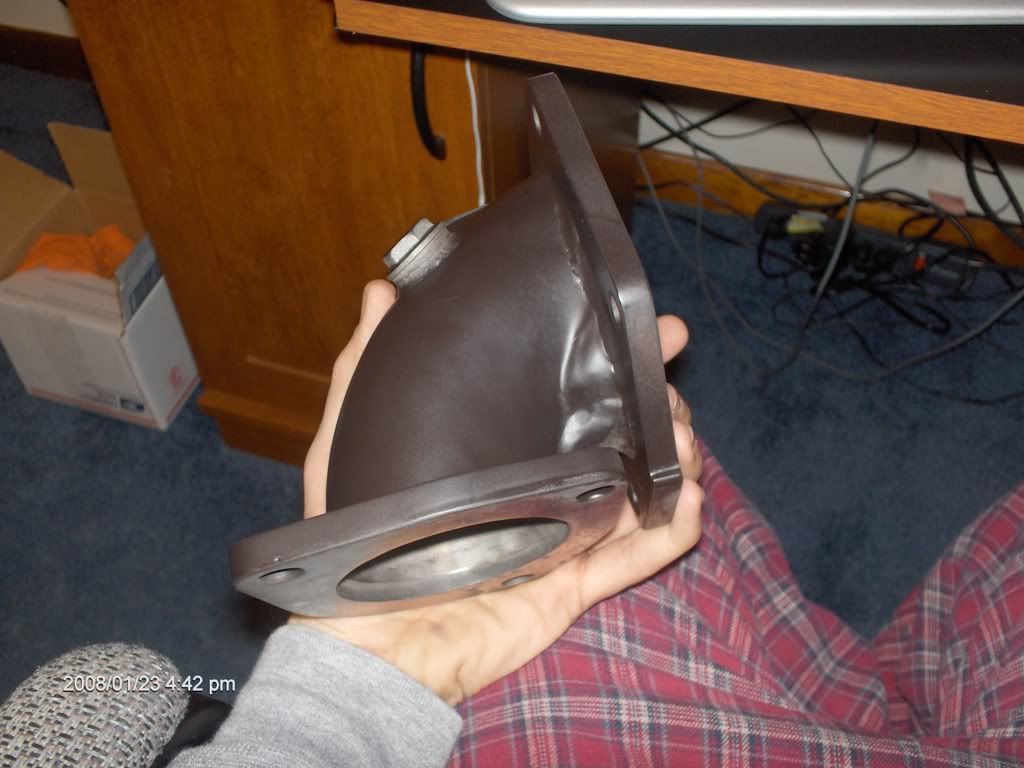

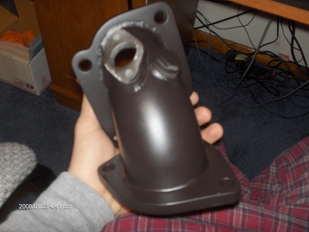

i also just received a 3" turbo elbow from a member here...took it to school and sandblasted it then painted it high temp black :icon_bigg looks purdy i'll post a pic later.

btw heres my pretty elbow...looks better than when i got it...sandblasted and painted.
