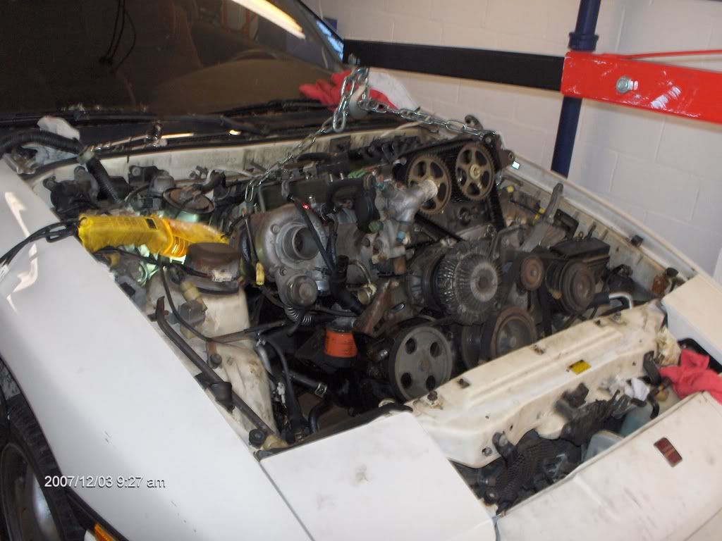

a lil history first... got the car back in may for 800...ran but had a blown turbo and shitloads of boost leaks...put a new turbo and drove it for a while till winter came...never had the tiem to work on it yet untill recently me and my da got the garage finished.wanted to wait till christmass before i spend any money...i have however bagan to pull the motor.its really not as easy when you spend all day working on cars fo a living come home from an hour drive to work on this lol...about 3 hrs worth of work here.

finish pulling the motor...hopefully christmass day..all i got left is driveshaft, motor/trans mount, exhaust and fuel feed line...i think that should be it.after the motor is out i'm opening it up to check it out and off it goes to the machine shop...in the mean time i clean and paint engine bay.also need to repair rust under battery tray...

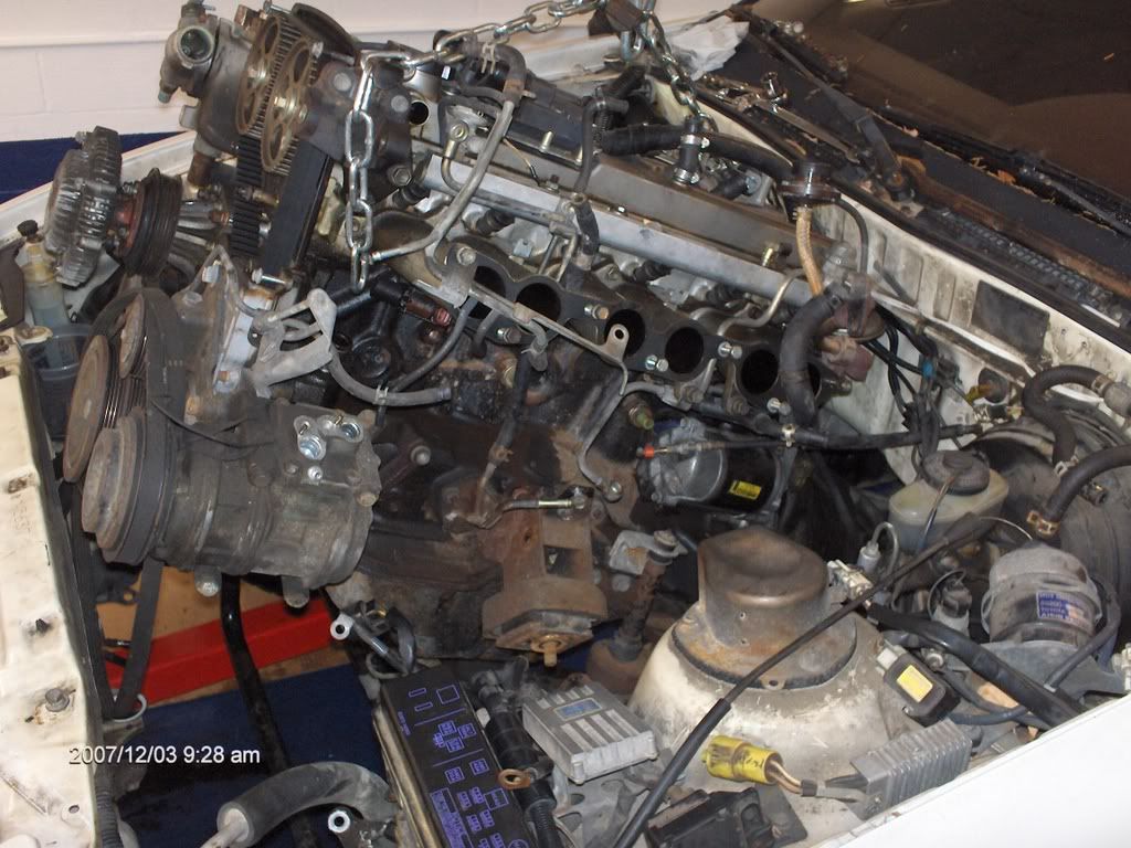

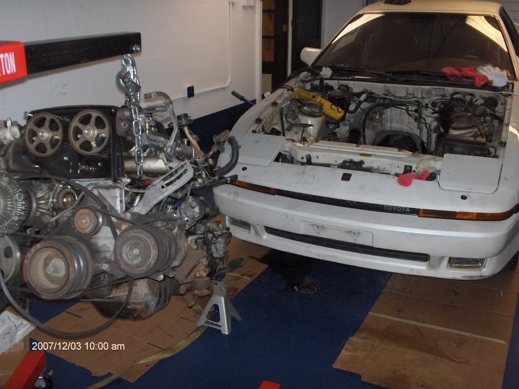

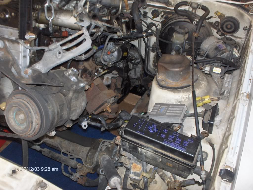

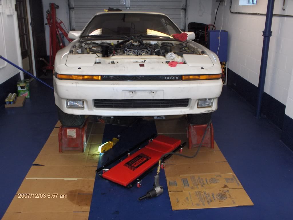

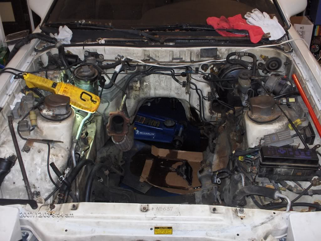

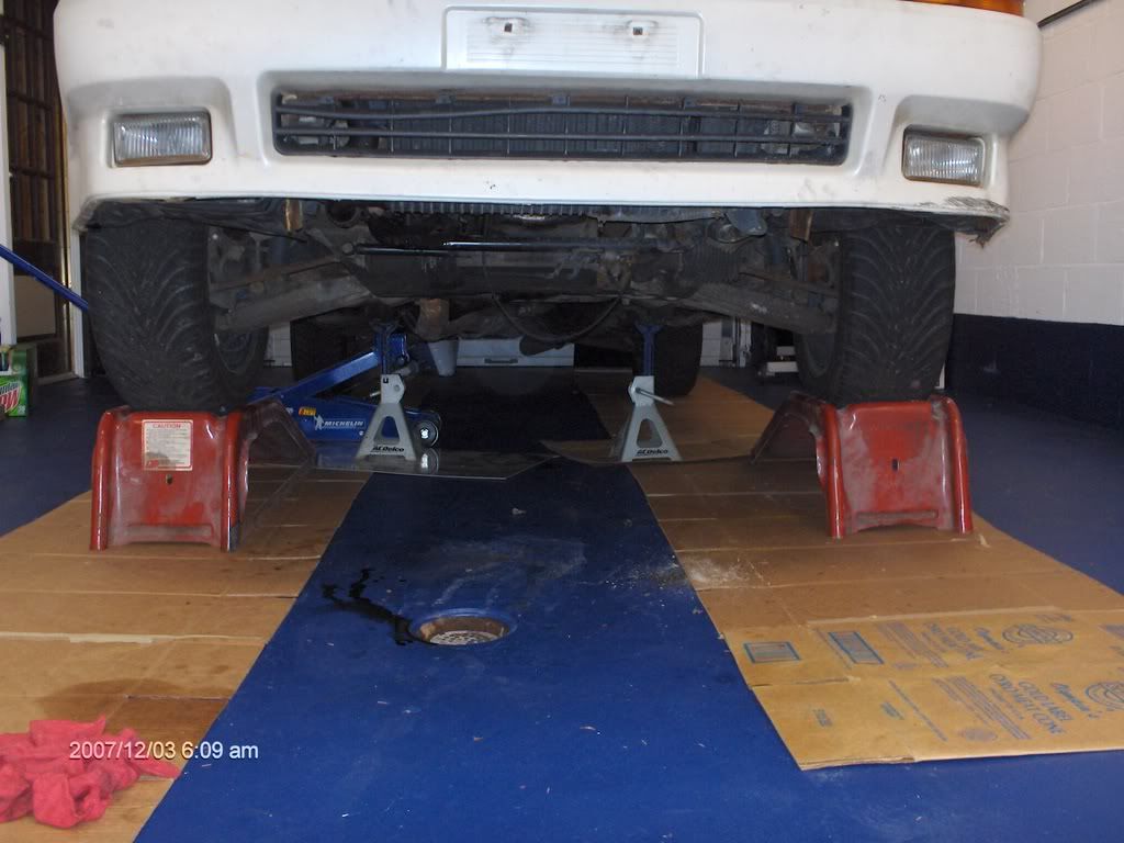

Got the motor out today!!!woot woot!!!
pics for your pleasure i guess

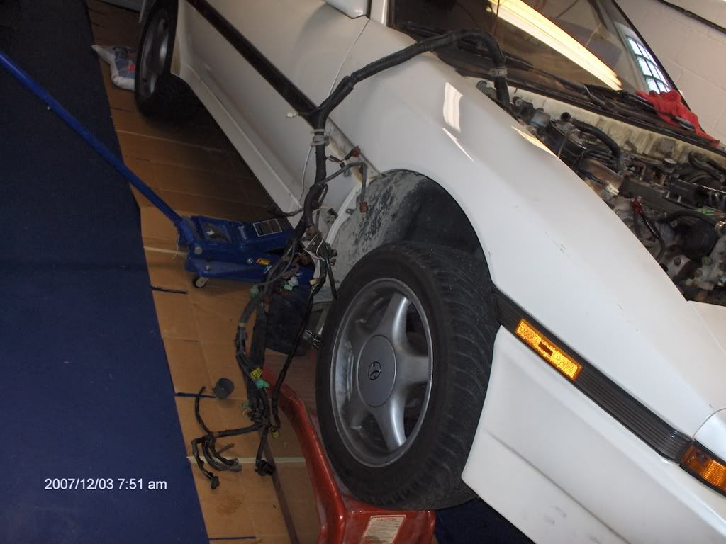

when you are alone in the house make sure the damn car is secure if you are working under it!!!!
pb&j break
this is my holy shit face
lesson learned...take the damn harness out off the fire wall not the engine!!!!makes removal a lil easier but i still dont think its worth it!!

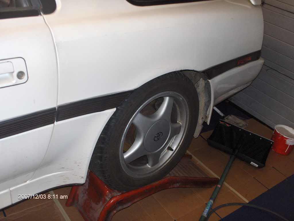

wish i only had this much wheel gap...

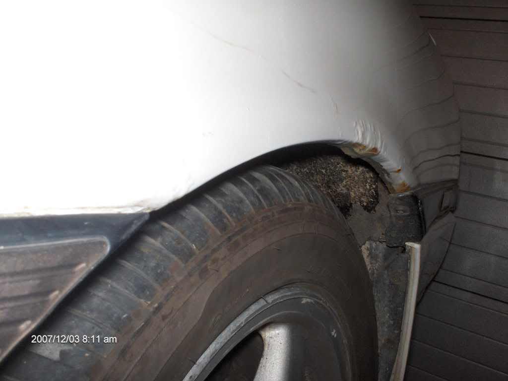

rust i was talking about
getting there...
finaly

nice, looks like you got a lot of work done. looks like i wasted 45mins taking the ac compressor off... :(. that rust doesnt look TOO bad, lil bit of grinding will let you know if it needs to be sectioned. this isnt as hard as it sounds espcially for such a small spot., time for some simple green in that engine bay, should clean up nice.

haha why did you remove your a/c?i'm completely eliminating the a/c systme...the car IS targa after all:naughty:
also i'm planning on removing everything from the engine bay to degrease and paint it black...once the car is done (engine, supension, interior,)i'll take it to the body shop and they can paint it for me:icon_bigg i mite do the body work myself, but i'm to anal it would take me years just to make sure everything is straight lol

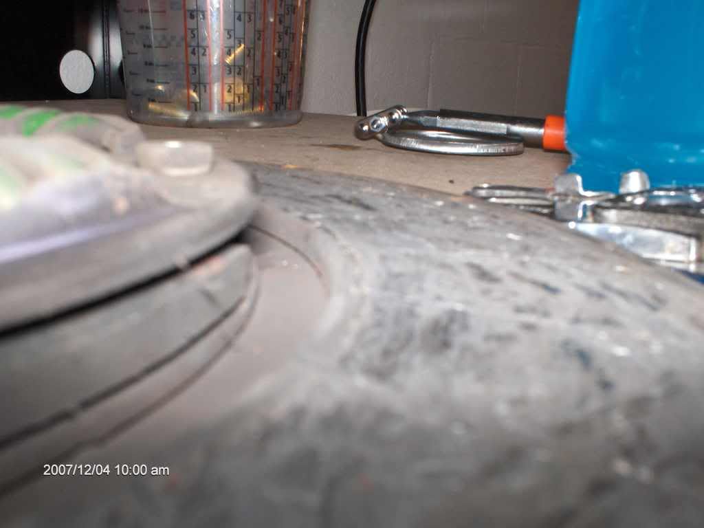

today wasnt very productive... pushed the car out so i can clean up the garage...got the tranny seperated from the motor.not really an update just thought you might enjoy some beat up clutch pix
****~I had no part in the condition of the clucth~****

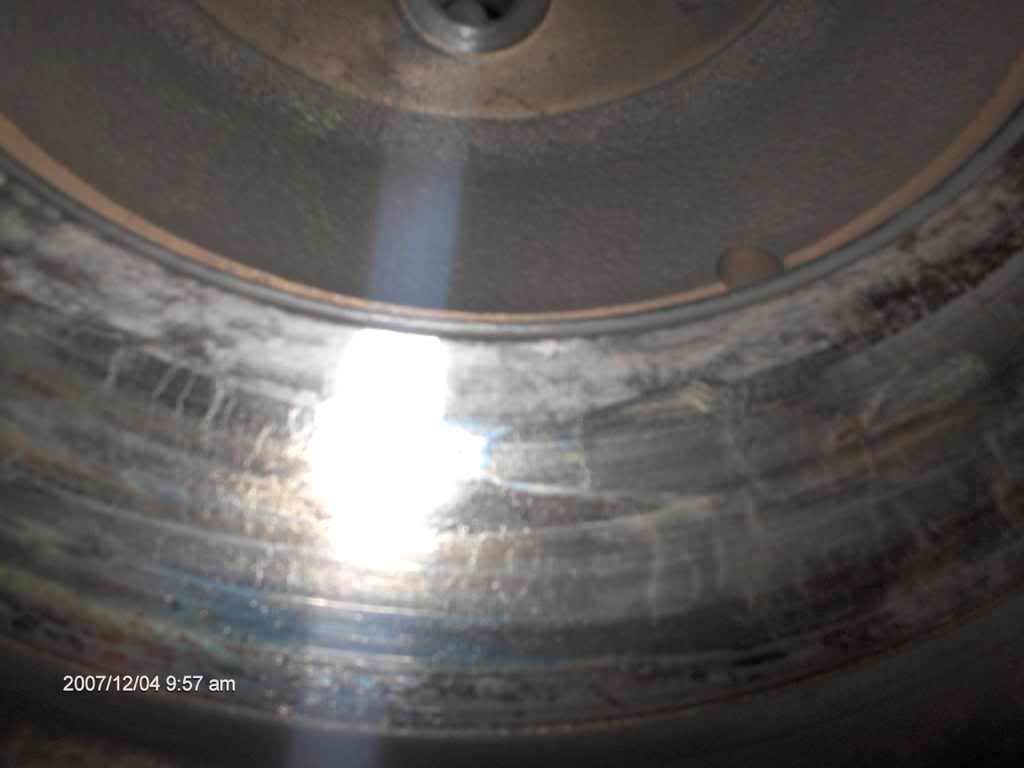

Can't see in the pics real well, but the flywheel is cracked al around.some cracks i can feel with my finger nail.i was planning on getting this resurfaced, anyone know if i still can?
camera sux, but the clucth disk is pitted, small little chunks missing...also its almost down to the rivets.
