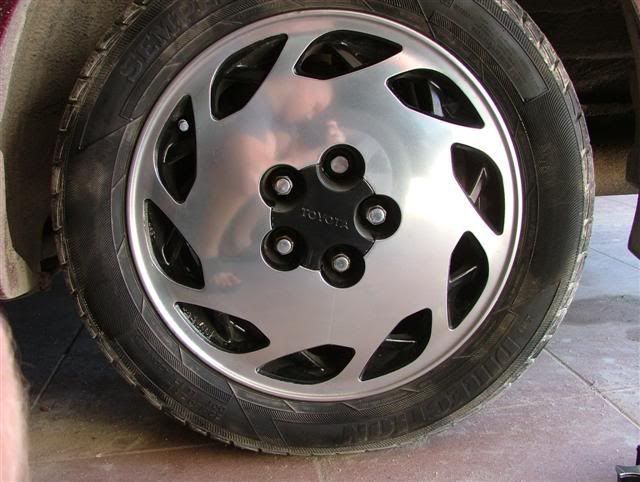

exactly:icon_bigg And they are made from somekind of metal ( I don't know what) and they kinda don't get polished...The scrubbing does nothing. Dunno why. Even with like 400 wetsand I had to push really hard to get any marks on the caps.
Sorry for the dirty rim :)

Sooo... I stripped the paint, then wetsand with 400/600/800/1000/1200/1500 then used some different polished, like 30, 75 or smt.. and then handpolished with 80 or 85. Then I covered the rim with adhesive papertape and cut out the slots, and painted them.
My car has almost black moldings, and I can try with black center caps, though I don't think I'd like the style. Let me go and try :)
Edit: Damn, the cap wasn't full black :(
Yay, I can see myself :D

sex, i think i know what im going to be doing with my saws now.....
what kind of paint did you use? just some rattle can wheel paint?

Yep, some acrylic black paint and then acrylic lacquer on it. Let's see how it holds up :D
It is the coolness in the sun, when looking under angle.. Or just under angle :).. you can't see the scratches then :D
Now some guys advised to use boatwax on the whole rim... Gotta try that.

^Btw... I'd like to know, maybe someone has ideas, how to paint the TOYOTA letters black....on the metal caps... It'd be kinda hard to it the way I did the big holes.
