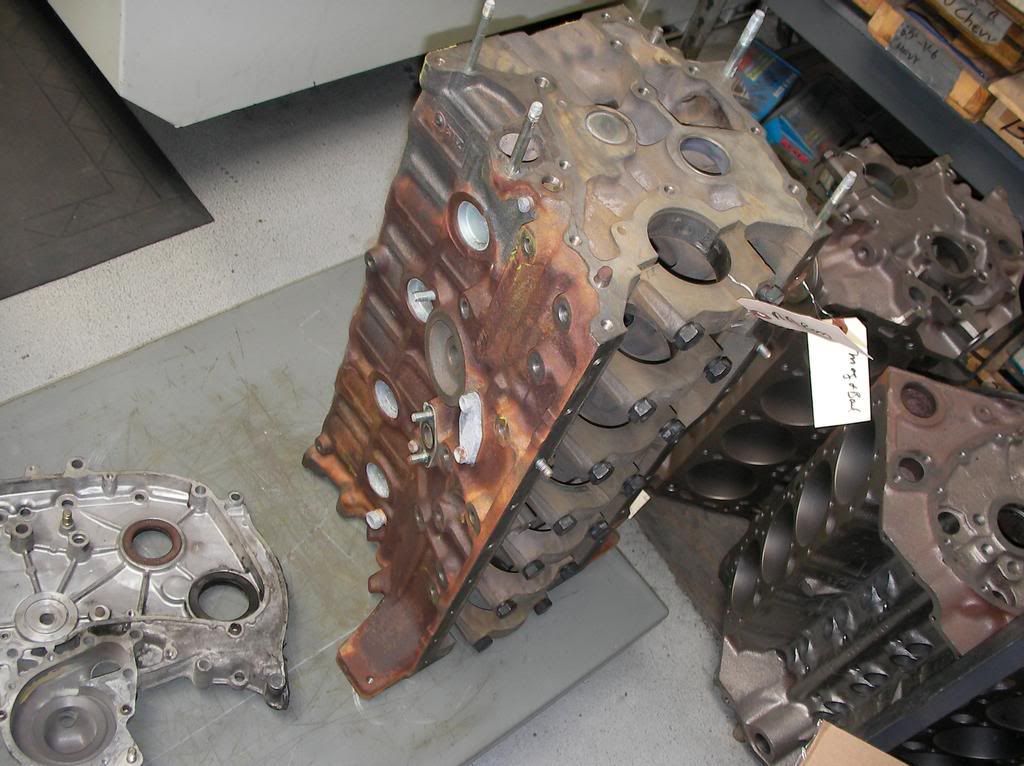

bigaaron said:
Block was cleaned and magnafluxed, ready for the full treatment!
I saw your block over at SA, I was checking it out. Didn't know that you guys used that shop.
Post pics when you get the crank back!
