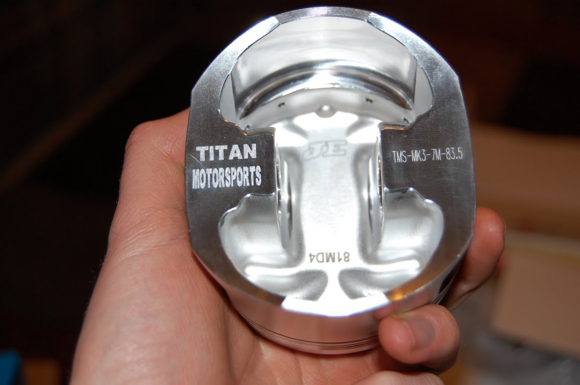

Titan motorsports .020 over pistons (basically JEs slightly modified):

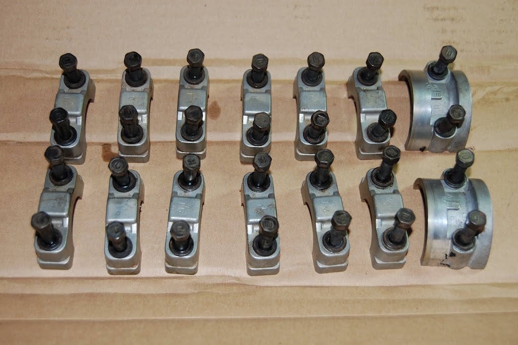

Cam caps cleaned up. Just realized there is a little bit of FIPG left on the #1 caps though...need to clean that up:

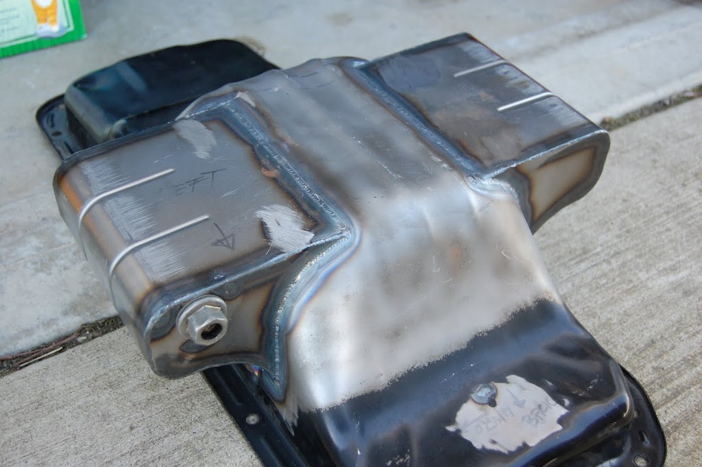

Oil pan modified with kickouts, trap doors, and a -10 AN turbo drain. Also had a custom sump added to the stock tank with two -10 AN ports. Thanks to Wes @ Beech Performance for the great job on these!
