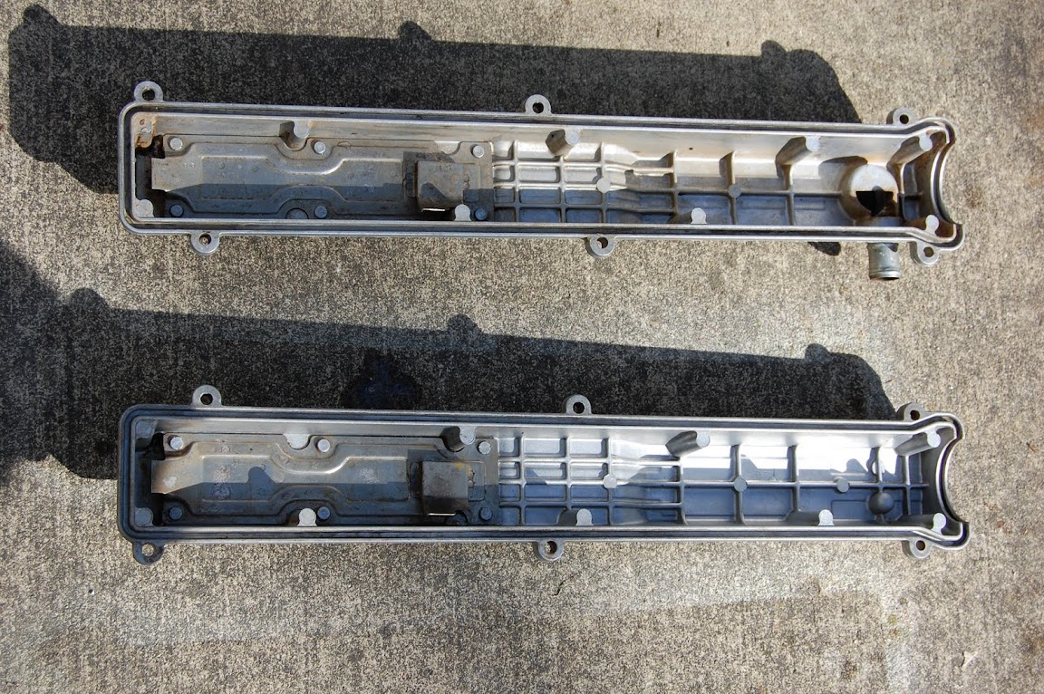

Everything should be coming back from the machine shop this Friday! Now I just need to get my fuel system installed. In the meantime, the valve covers have been stripped:
Before:
Aircraft paint stripper is some SERIOUS stuff. After 10 minutes:
After. Still trying to decide if I want to polish or paint.

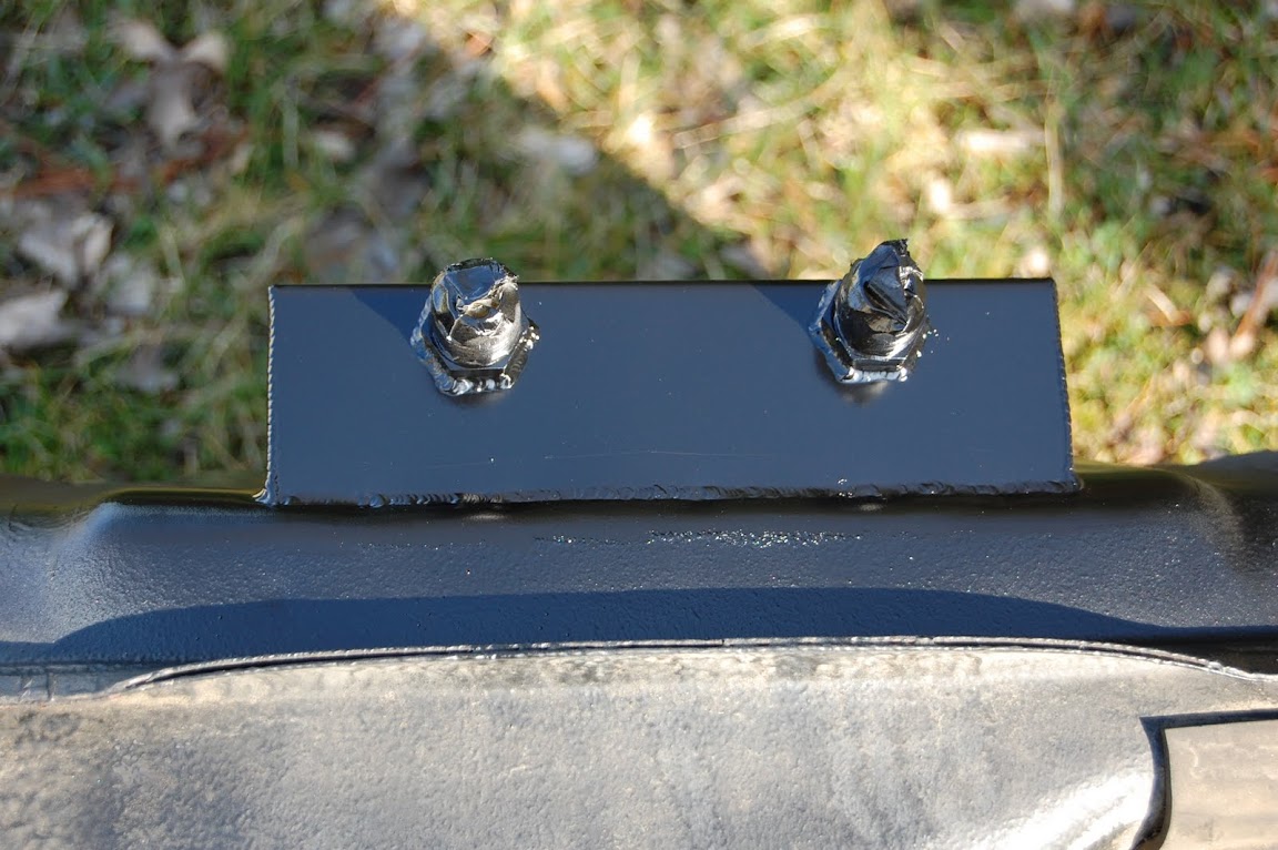

Oil pan painted:
Sump painted black:

Can I make a suggestion on the valve covers? Grind off the letters and stripes.. then maybe weld some aluminum to the section that divets down. and make it flush.
would look pretty nice.. also tap the PCV hose outlets and tap in or weld on some AN fittings (you would also need to drill out and tap the baffles for cleaning) . and use some nylon lines for the catch can ;)
All good ideas. If I get time I'll have some AN fittings put in the valve covers. Otherwise it will be shelved for a future date. :)
