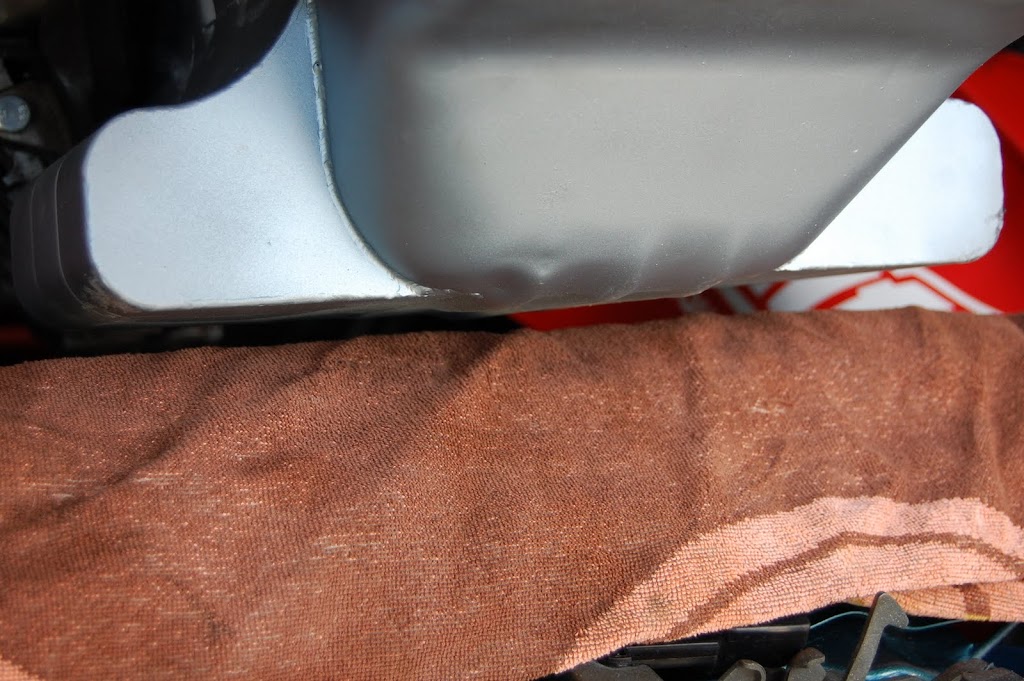

Hmm, I was hoping this turbo would clear the hood. Obviously not...

Supra28;1863861 said:
What are you going to do about the turbo/hood clearance? Cut it? CF maybe?
Car sounds real healthy, job well done! I bet you're excited haha.
I really need to just drive it this year, so for now I think I'm going to get a junk hood and cut it/paint it. Next year I'll worry about it more. In the end I'd like to get one molded to fit around the turbo, but that's a lot of $$. Oh, and yes I'm super excited :)
