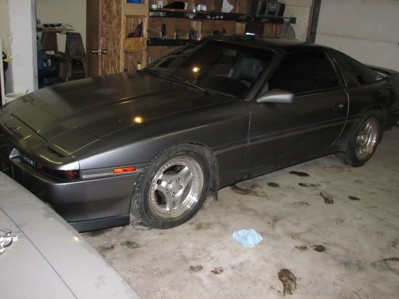

Updated pics on post 9 and 10. Yersterday I got the rear view camera installed, cleaned up some wiring and went to Sean's shop to lend him a hand. Wile we were at the shop we put his rims on my sup to see what it looks like. Here is one more
