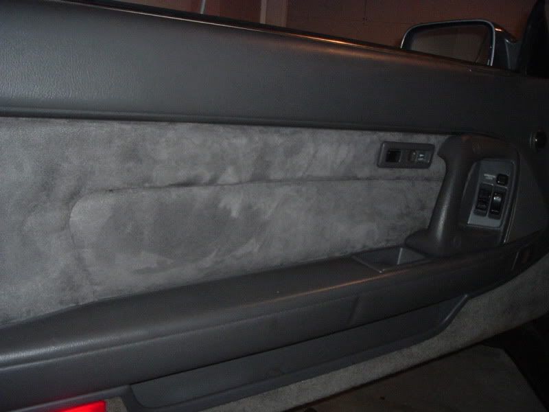

We also finished the suede on the front door panel inserts. So project suede is finished. Sorry haven’t loaded pics yet, but it turned out dam good. Just the way I wanted it, not too much not too little. I took her out for a quick rip last night ( down to the local pub ) and dam it, I can hear the door handle rod (behind the door panel) rattling around on the passenger side. So I might have to rip off the panel once again.

Recap, suede door panels done and installed. We didn't just put the suede over the old leather rather completely took the insert apart and replaced the leather with suede just the way toyota did 20 years ago. Looks really, really nice. Also installed a different grey door panel that isn't cracked up. Thank you again Emilio!!

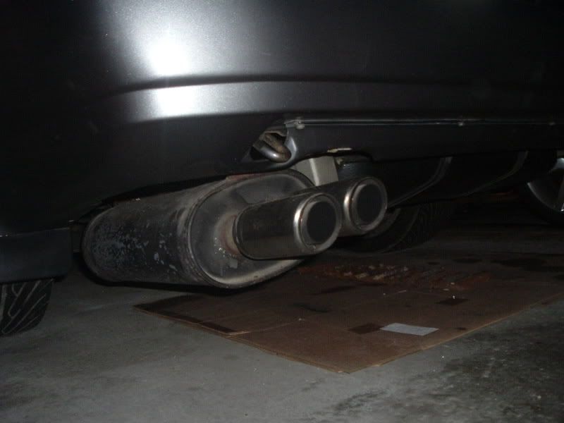

Here is the pic of the hks exhaust i was talking about, notice how the tips are not even close to level :( If anyone has had this problem feel free to share how to fix it besides chopping it up and rewelding it.

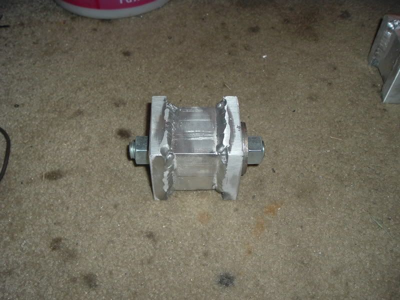

I will be also be installing the solid motor mounts I made when ever Im not feeling lazy. Withthe exhaust being quiet now, the way I like it, I can hear the intake manifold hitting the shock tower when the motor torques around.

If you look at post 10 you can see that the exhaust piping is tight up to the rear sub frame( in the arch opening that is there). So it cant really go up any higher unless I cut out the sub frame, but I will check it out and see if there is anywhere else it can go up. Thank you for the Idea Poo!!

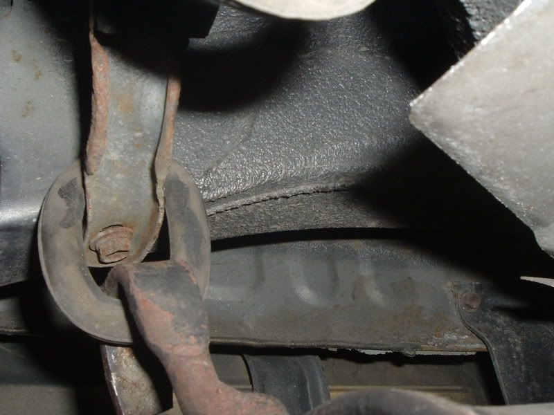

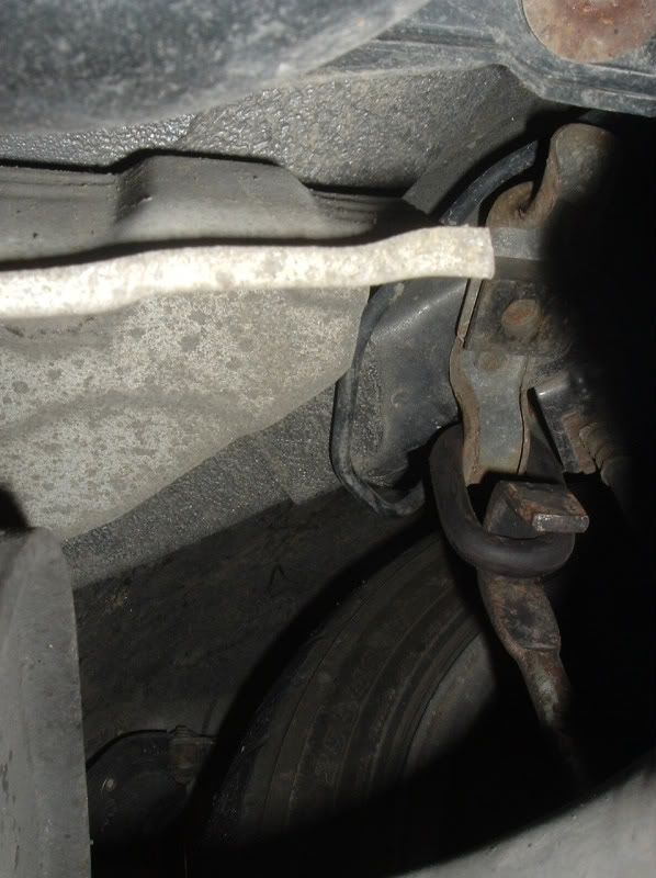

Sorry the pics are kind of crappy but it is the best I can do laying on the ground in my garage. Both rubber hangers are not streched as I put them on my hand with no pliers or anything. and any one that has put them on before they are hard as hell to strech
Here is the front hanger (towards the front of the car in front of the muffler)
Here is the rear hanger ( above the tips by the rear bumper)

There should be 2 rubber hangers per bracket, they are separated spreading the load and centering the bracket in the middle.

Ok I can try and install the rings on the the other side of the hanger( I have them ) but as you can see from the pic it will be one hell of a strech. It is around 6-8" away from the hanger and dont even know if the rings strech that far. But also it would pull the 3" piping up and towards the passenger side of the car and the piping is already hitting the sub frame ( inside the arch of the opening) so I dont even know it it will go up or twist up anywhere. But tomorrow after work I will take another look at it. It is sleepy time for me. thank you also for the idea, keep them coming :)

What exhaust system do you have? There is supposed to be two rubber rings on each of the rear-most brackets. I don't think putting both rubber rings on the rear-most bracket will do much for you. I believe there should be two hangers on the muffler for the rear-most hanger, one rubber ring per muffler hanger.

Luke, it is the HKS turbo exhaust. I only have one rubber ring for each hanger but I am going to remove it and try some thing new for installing it.
Im going to completely drop down the exhaust (just not the DP). Then first Im going to hang the muffler and tips first, then hand the mid pipe second, then last bolt everything together and see if this way helps out at all. At least this way I can install 2 rings per hanger with out streching the shit out of them :)
