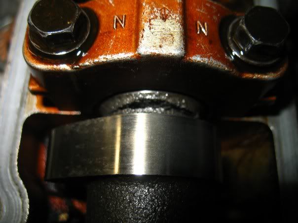

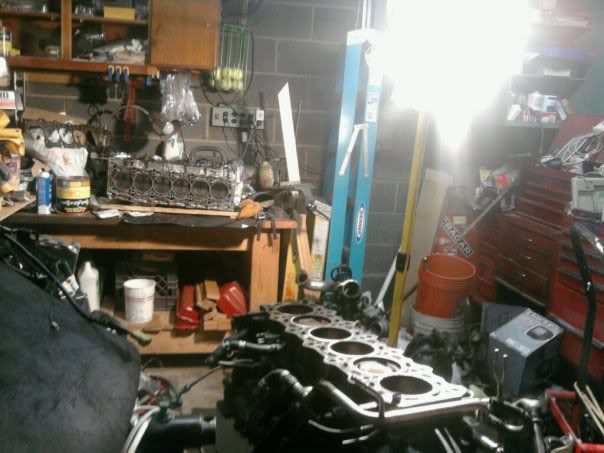

Little Update:
I found that the Exhaust camshaft was broke right after the third lobe.
I pulled the cam caps and I didnt see any signs of seizing or over heating. I did however find out that I had a leaky head gasket that could of explained the smoking I was getting.
So I pulled the head and Im going to send it to the machine shop along with the block to get work done.
Ill be putting new things in while the engine is apart:
Oil Pump
HG
ARP Studs
Valve seals/guides
Cams
New gaskets all around

Hey guys long time since my last update. Well the engine is at the machinist right now and it turns out that I can use stock sized pistons and Hg. So im putting in new oem pistons and HG. Im putting acl bearings in and replacing all the seals on the engine. I should have the engine back sometime this week so I will post pics when I get it!
