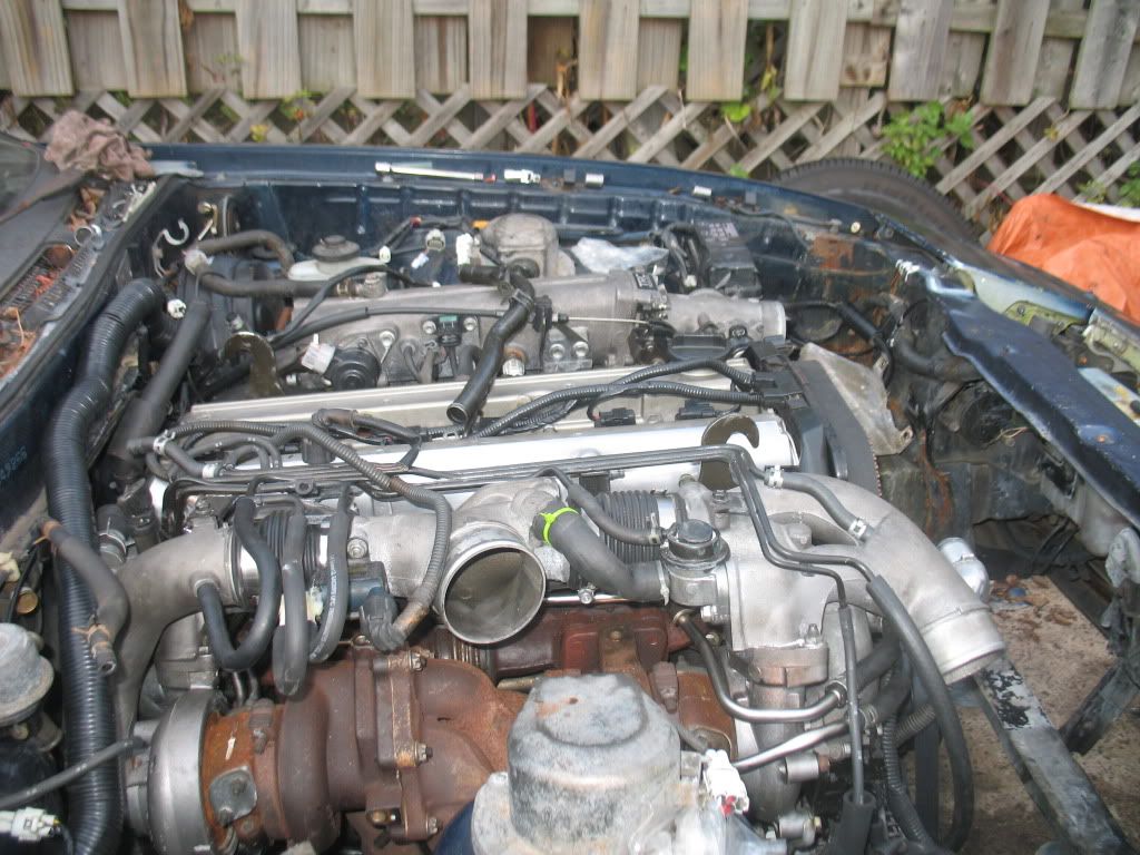

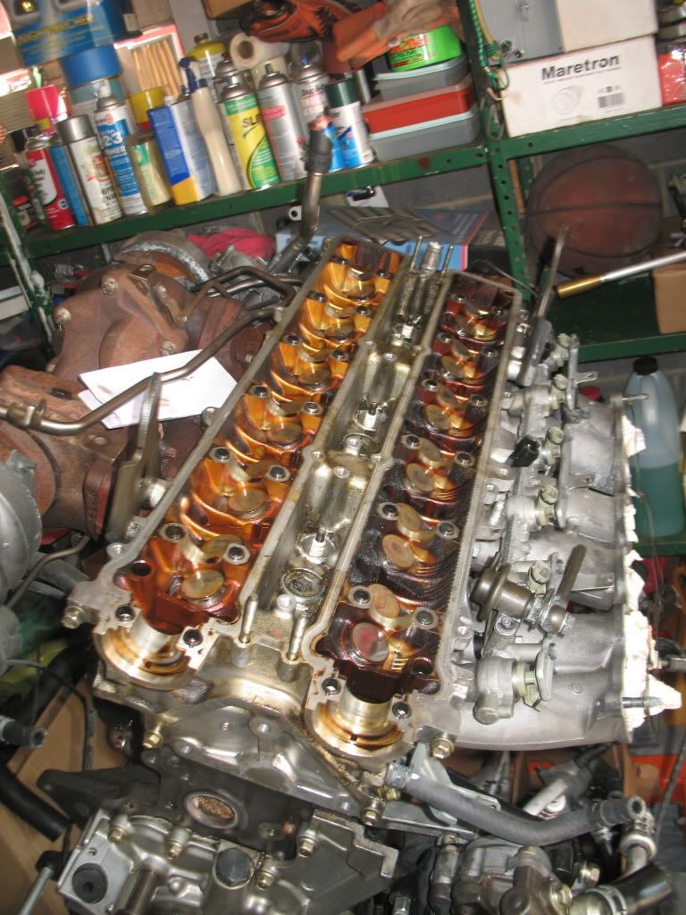

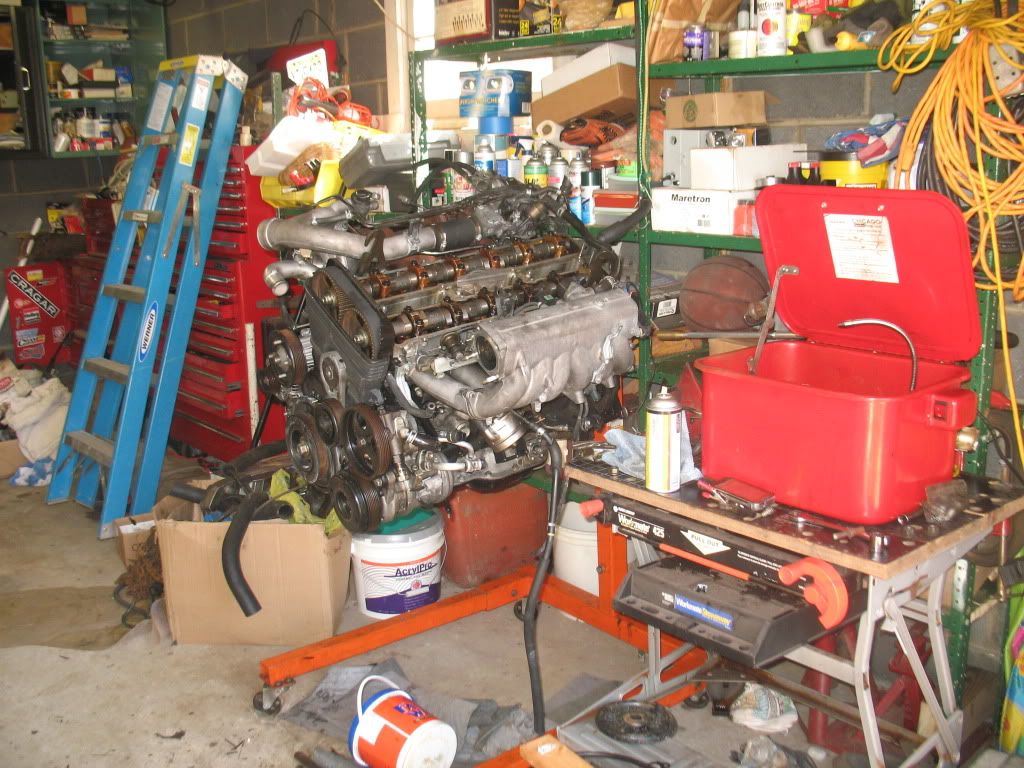

just need the pulley now, Last part I need (except fluids)

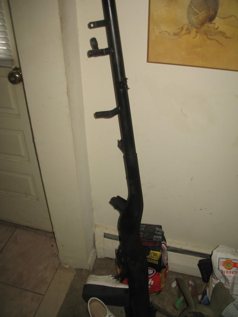

Painted my crash bar, I will never see it but it beats it being full of surface rust

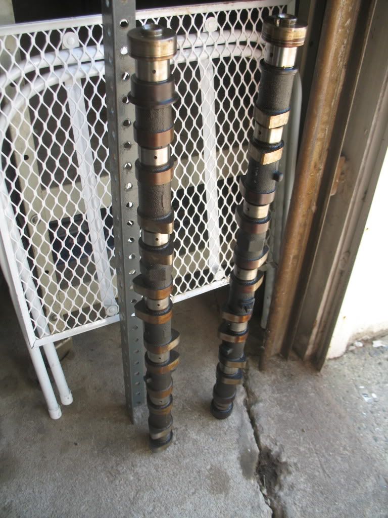

USDM cams

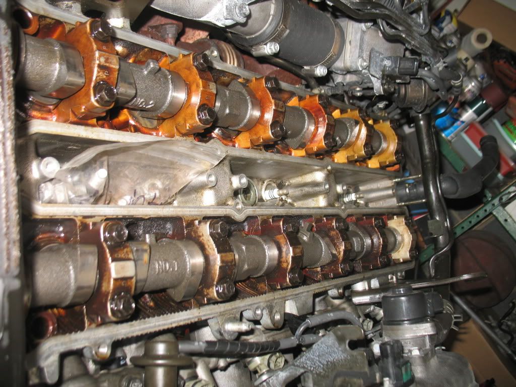

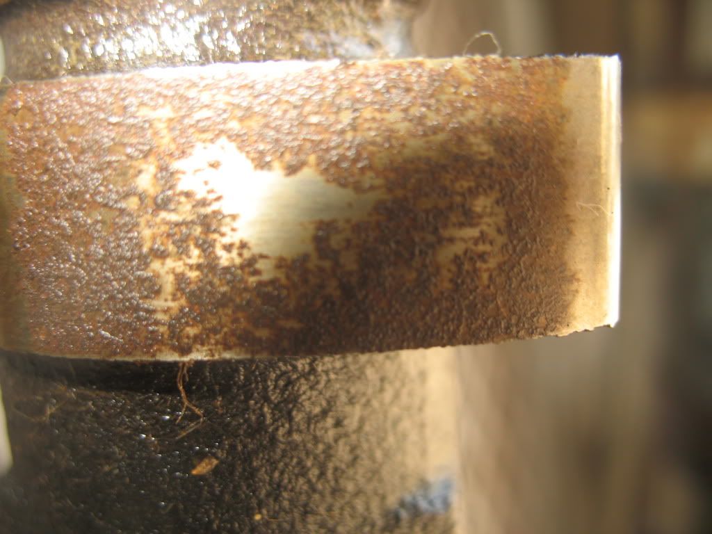

Old cam, See my reason to get new cams? =D

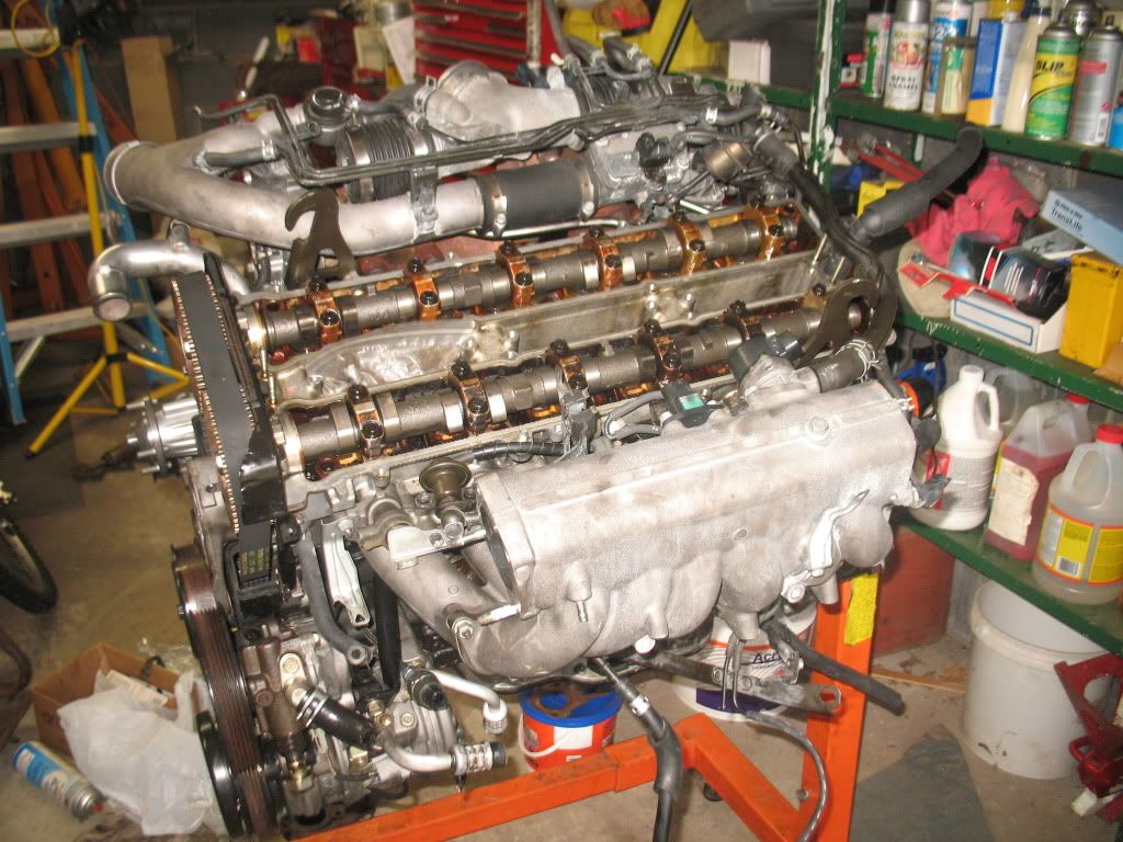

Water pump, Timing belt/tensioner/idles, cams, and some other little work will be done with this week coming up. I hope to have my harness before labor day, that way I have a 3 day weekend to drop everything in. Im making some parts look purdy too =D

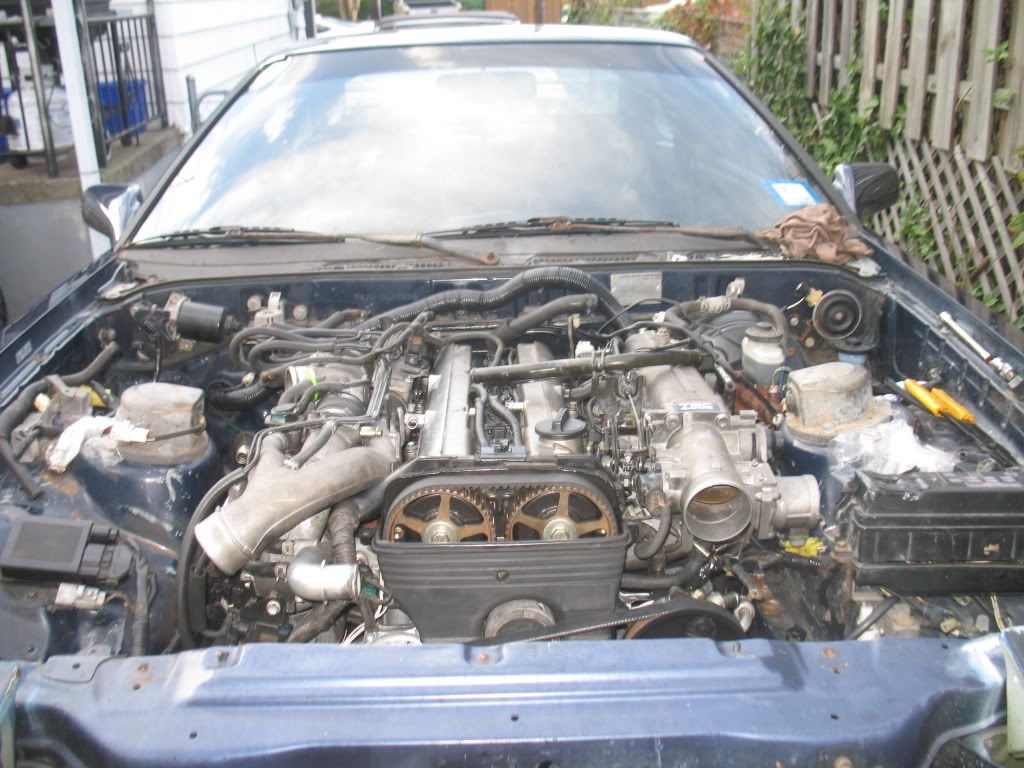

How she sits right now

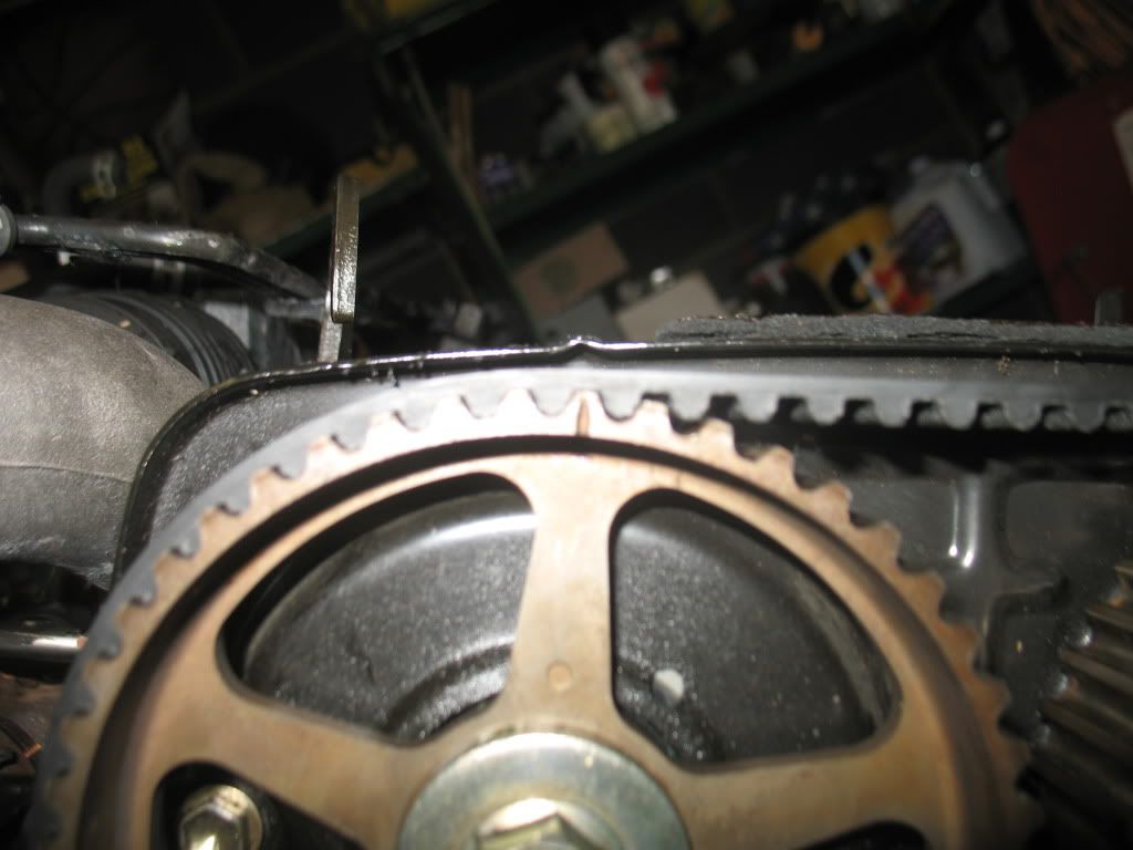

new cams

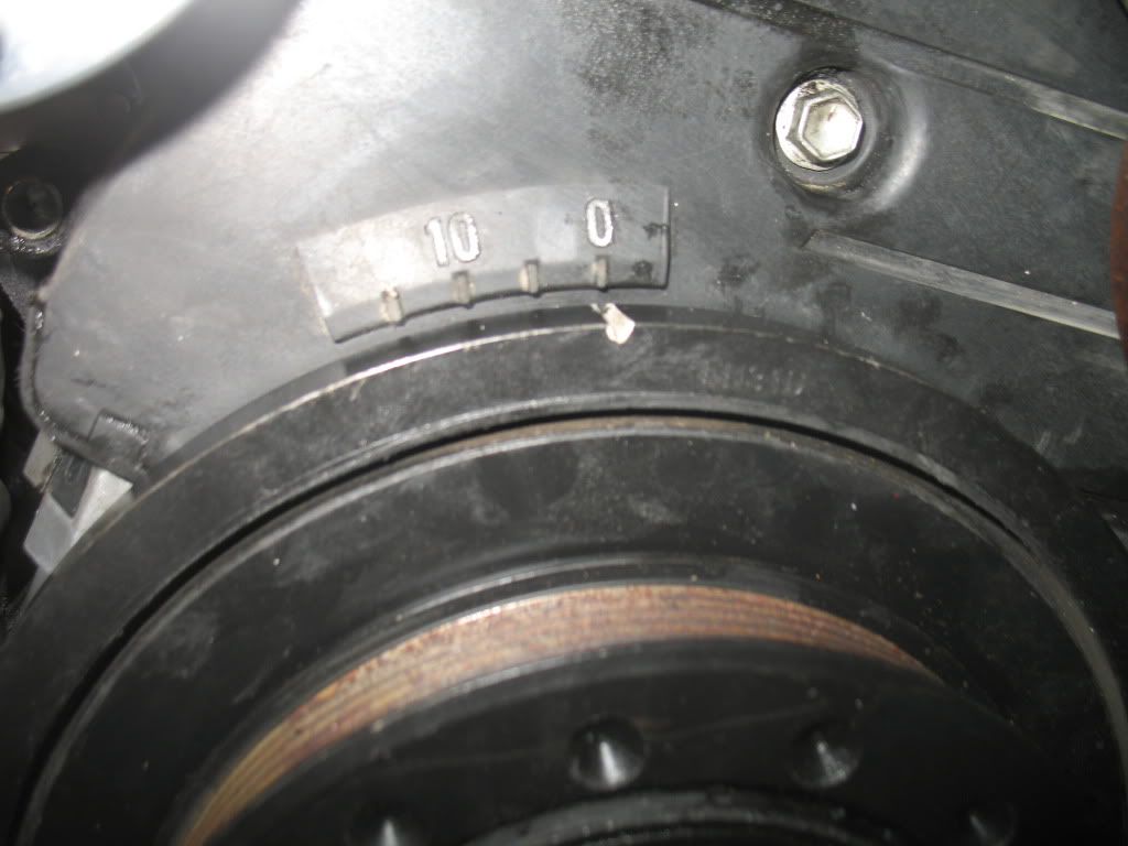

crank tdc
intake cam lined up
ex cam lined up

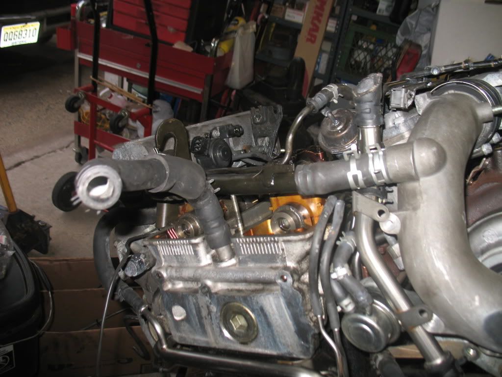

which hose is the inlet for the heater core and outlret?
ghetto fix, i hope it works

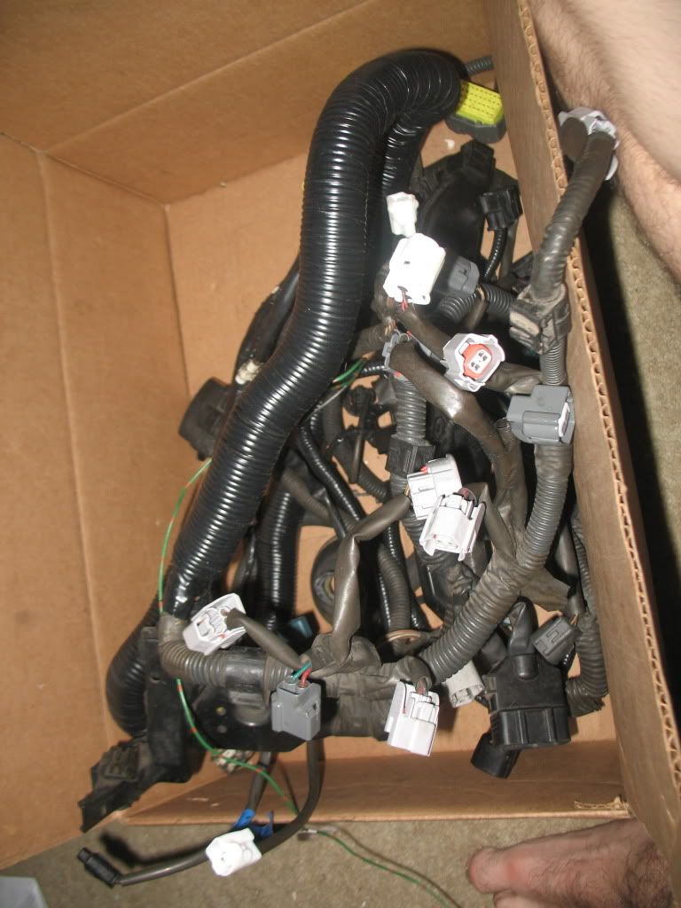

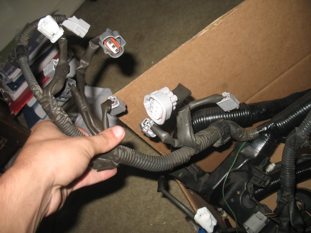

This weekend im pulling the 7mge out, and maybe even putting this bad boy in. The harness is done, Dr Tweak is the man for making my harness look new. Im hoping to have it running by next week. Im waiting on 2 gaskets at the moment. My goal is to have it started up and mayne even running on the streets before october 9th. And all the bugs out by the supra meet.

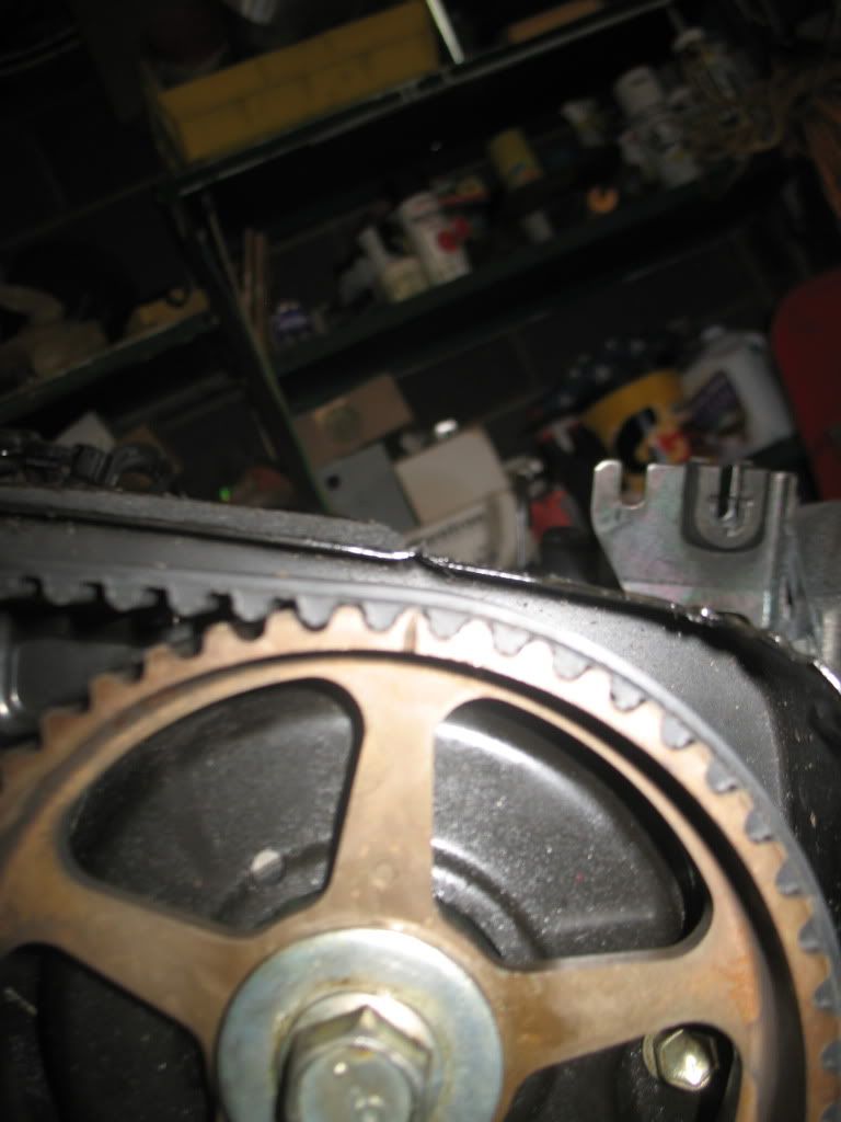

Looking at the picture of the cam :nono::aigo:, I wonder what the rod, and main bearings look like. Also wondering what the bottom of the cylinder walls look like when you cycle the engine?
steveyblack
Jun 21, 2007
529
34
Nj
the bottom of the crank(not the bearing surface) was a little surface gunk, just took a rubbing with a brush to get off.The walls of the cylinder looked good from what I can tell.
MA702Tone
Jan 28, 2009
55
Tennesse
The crank did not have any scoring, pitting nor did the cylinder walls? Do you plan on replacing the bearings ( Rods, and Mains )?
steveyblack
Jun 21, 2007
529
34
Nj
They could of sprayed some wd40 down each cylinder, when I looked under the engine and up into the cylinders, I didnt see anything to throw up a flag. I do plan on doing a mild build sometime in the future.

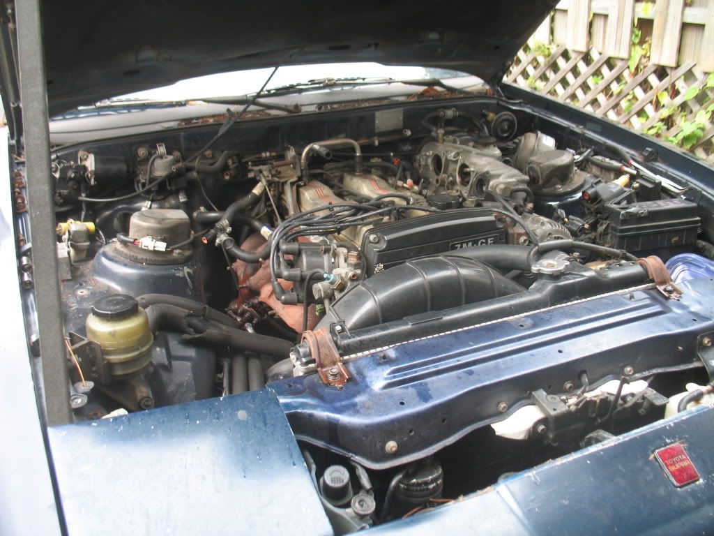

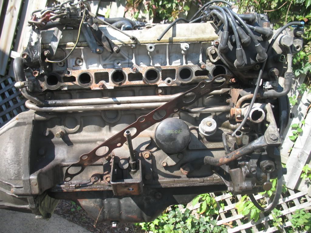

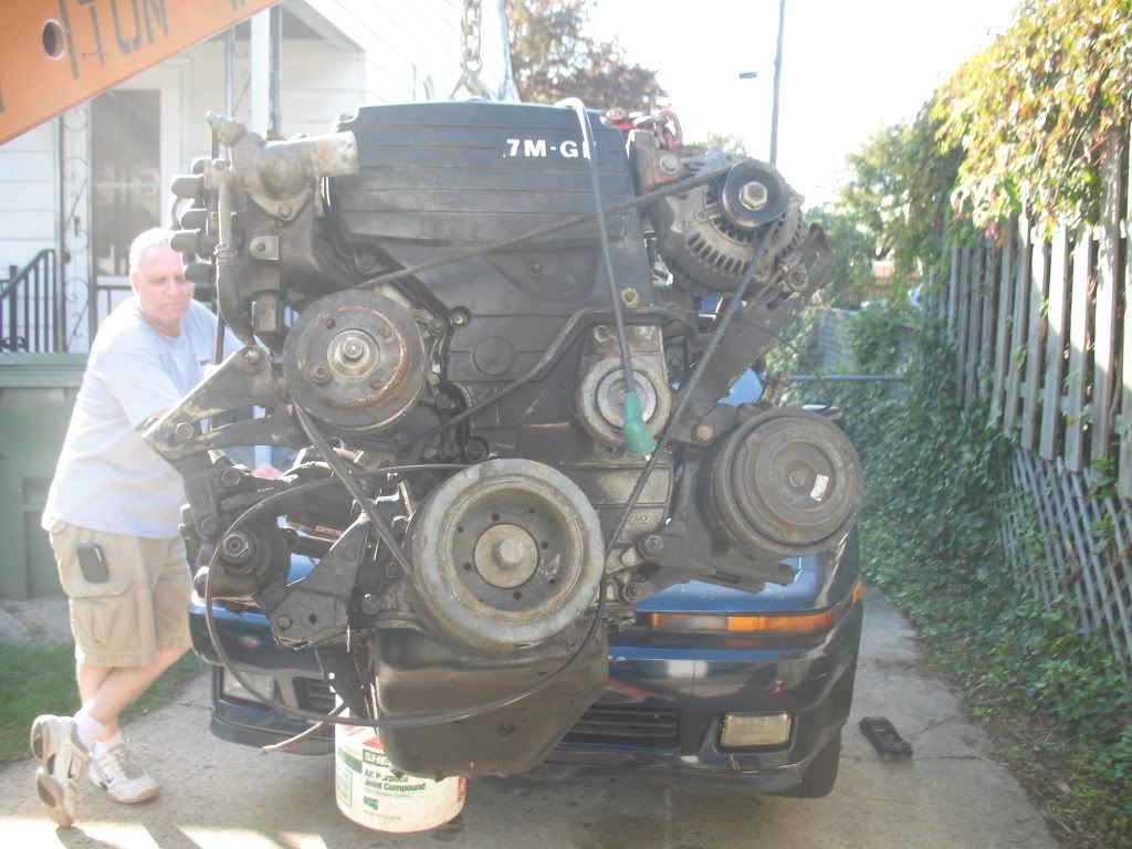

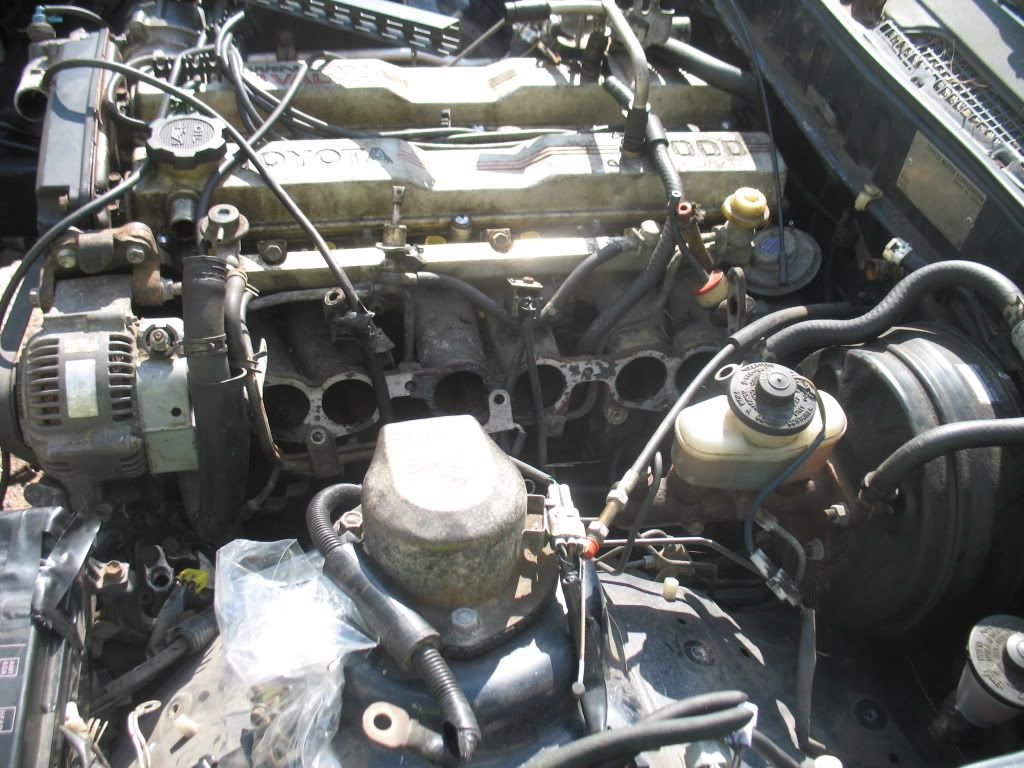

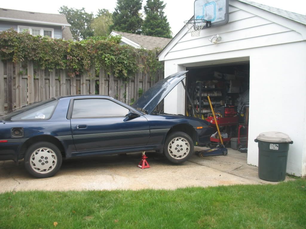

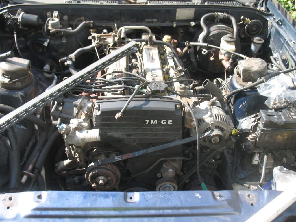

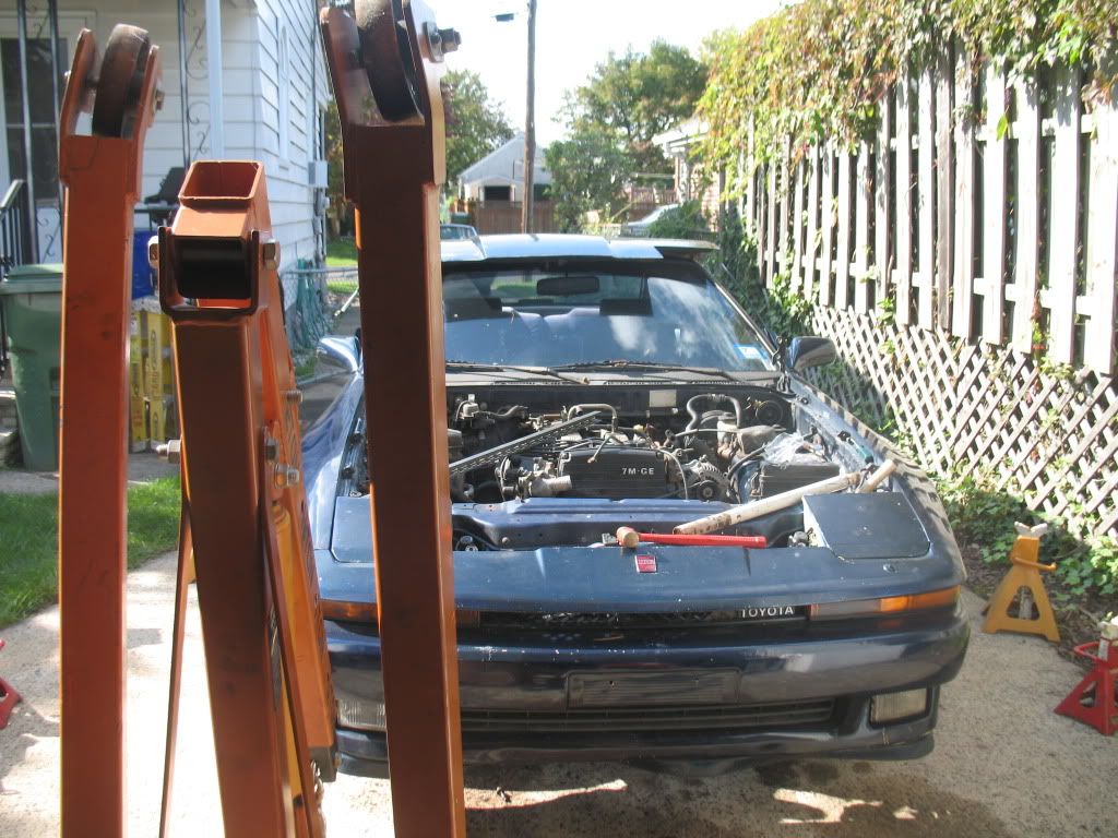

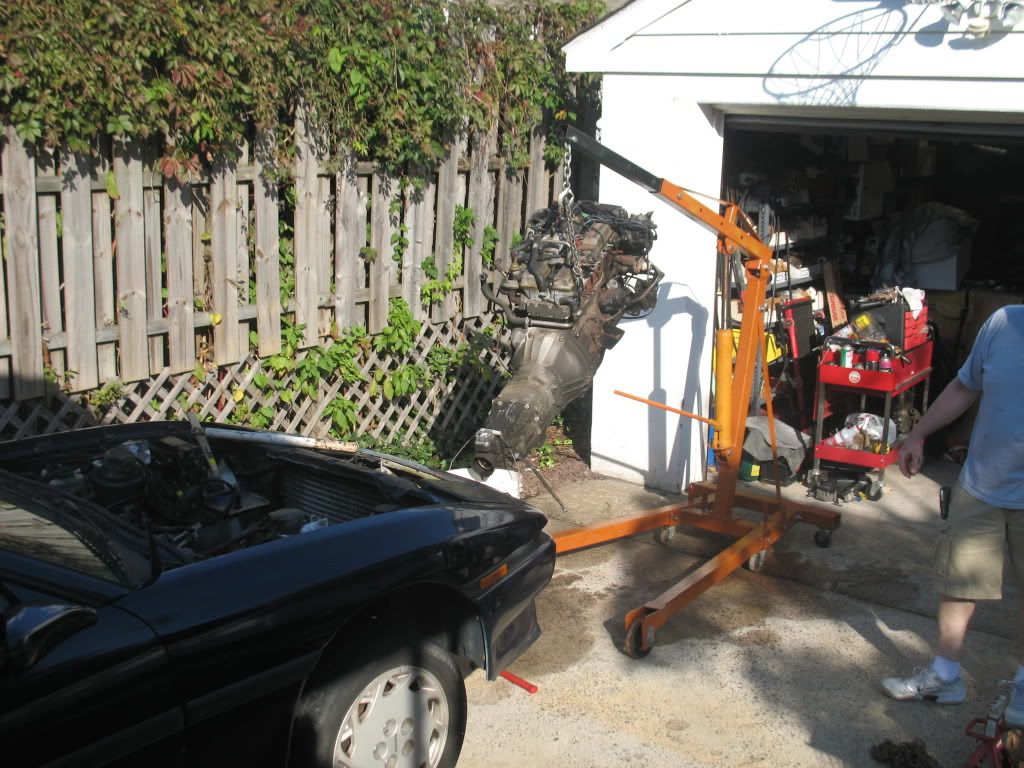

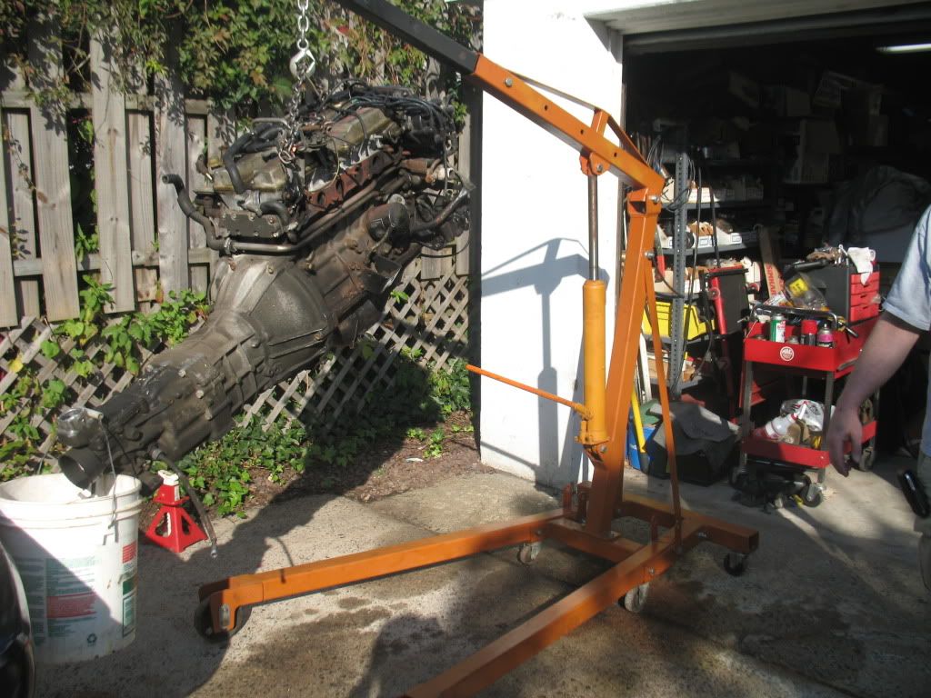

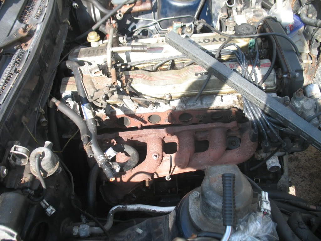

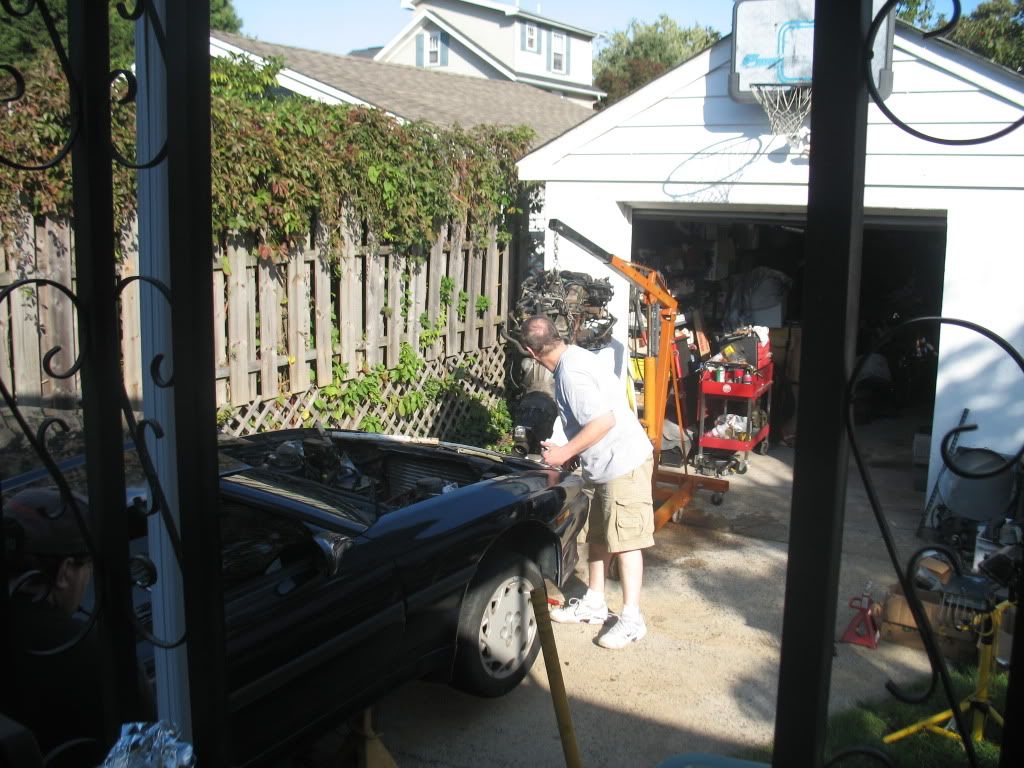

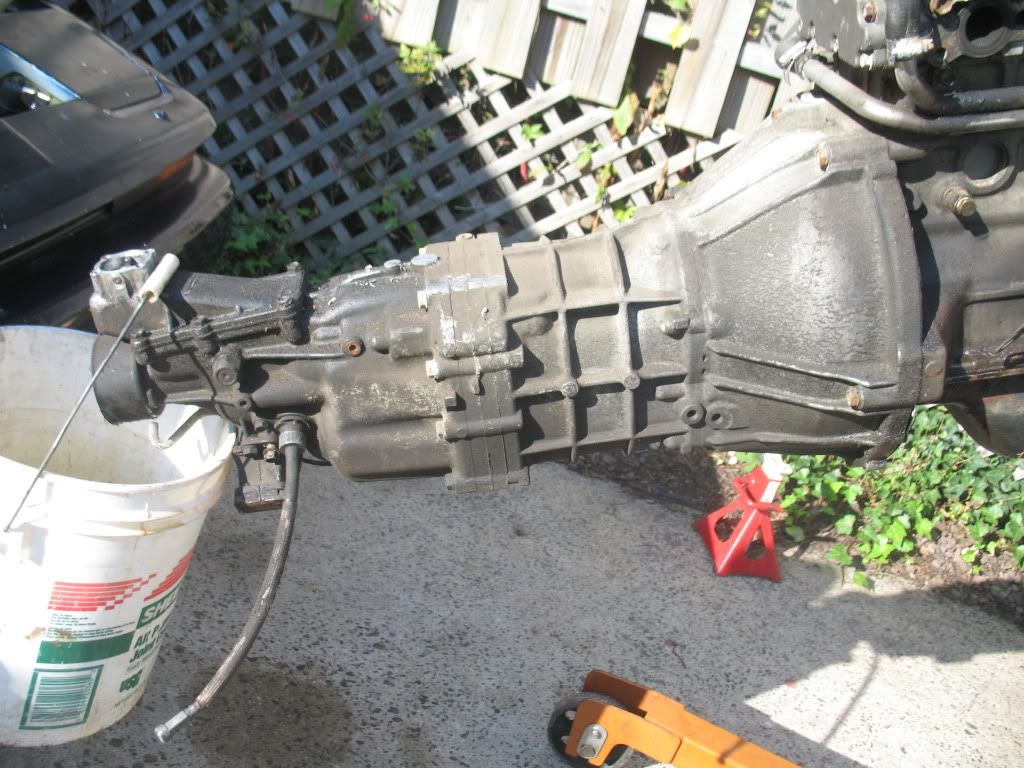

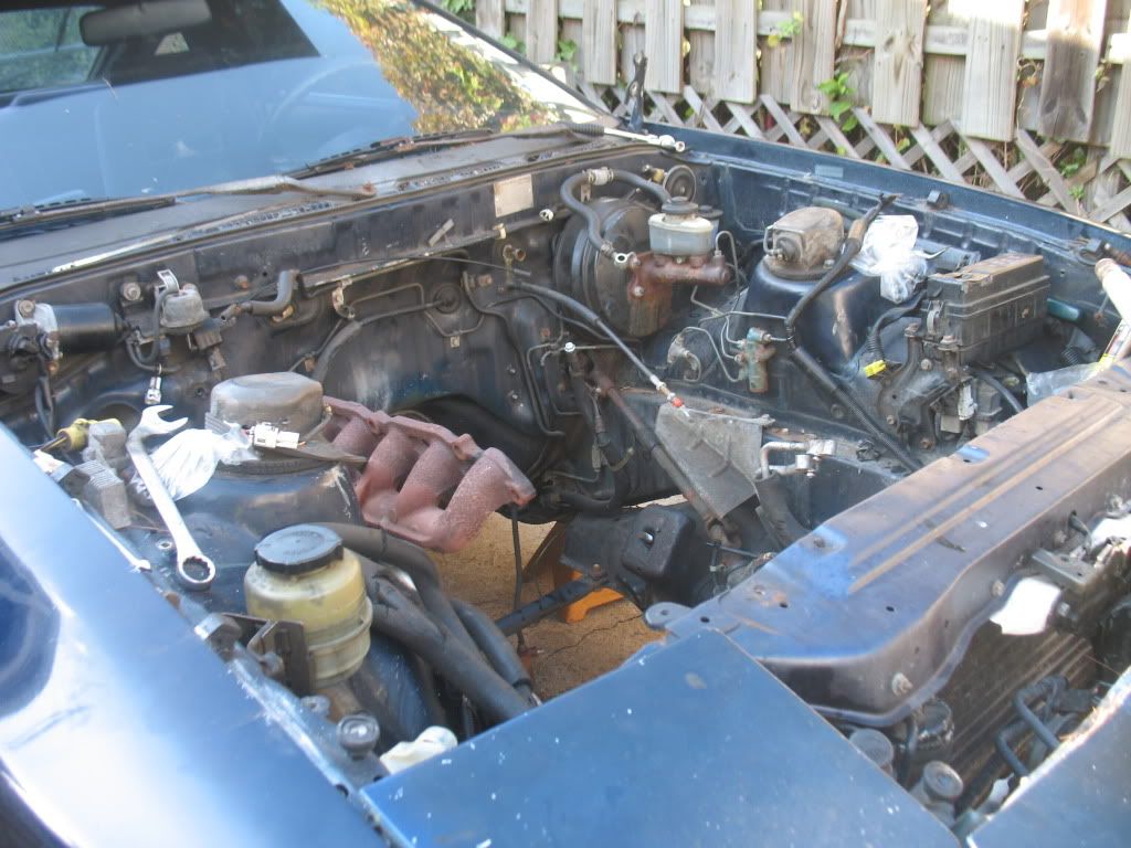

Rained out on sat, did as much as I could today. I atleast have the engine out and the 2jz is a couple of hours work away from being in.
7m wasnt as dirty as I thought it was going to be =D. Mating the trans up with the engine by tuesday. Going to be pressure washing the engine bay and cleaning the trans too. I hope to have the engine in by thursday

I got the car started tonight, Ran it for 20-30 second only. I was not getting power to the fuel pump, so I jumped it for now. Ill be setting up a relay for it to come on when switched. I needed to mess with the TPS to get it started too. so ill me fixing that too.
