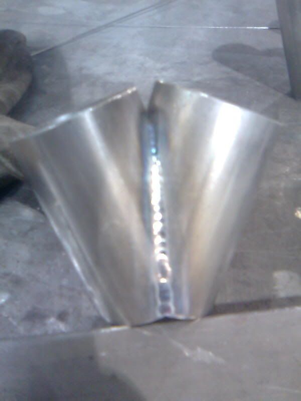

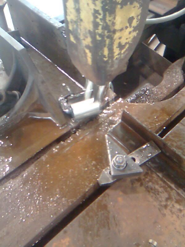

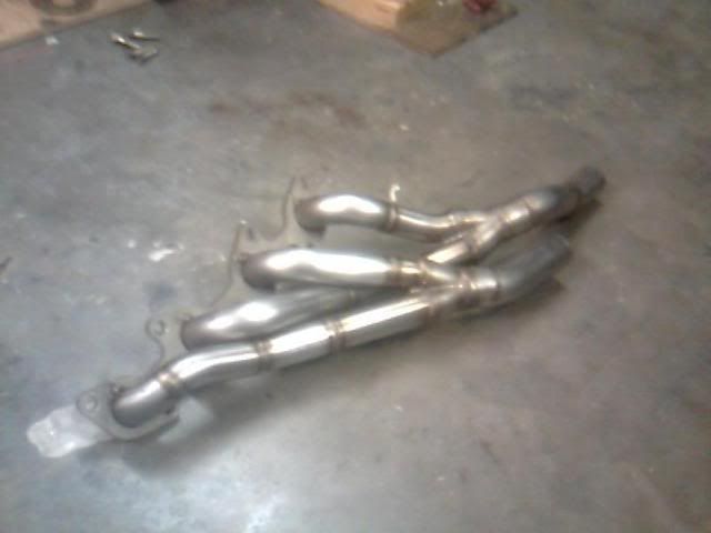

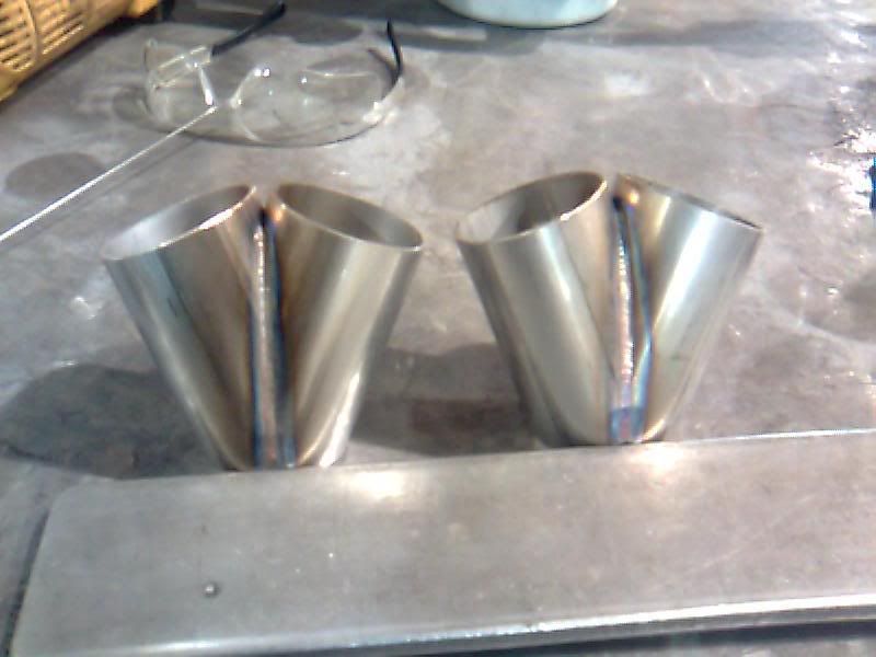

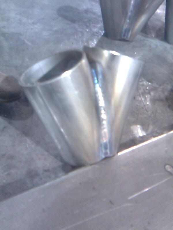

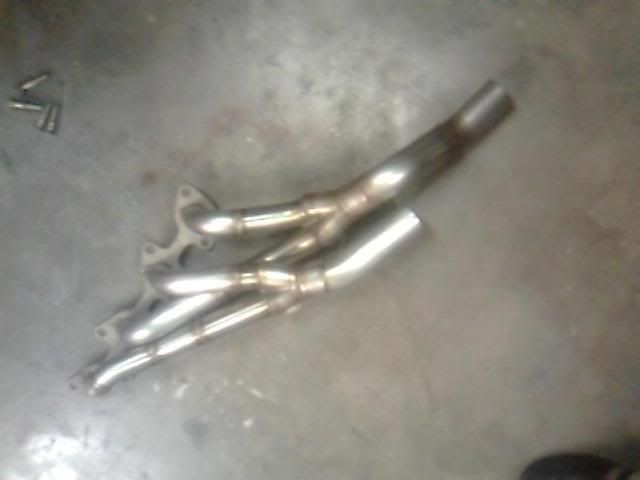

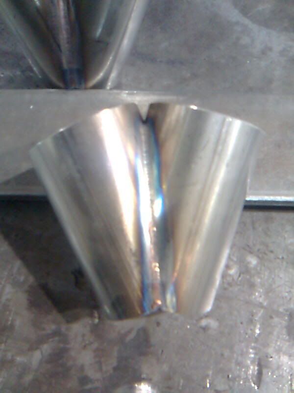

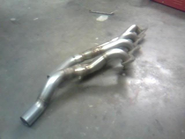

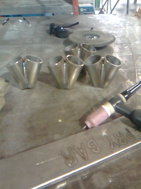

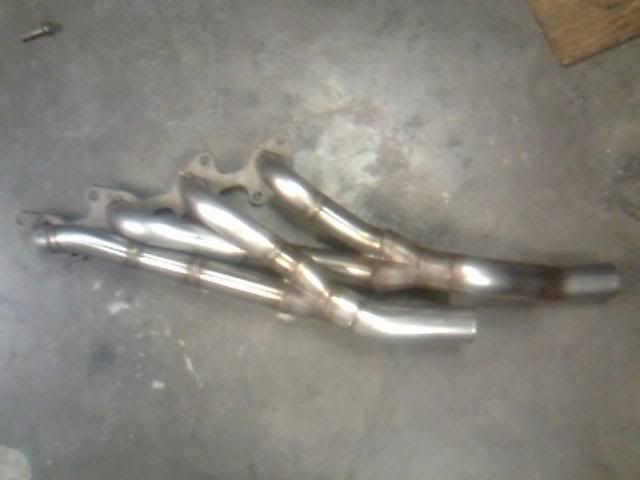

Well a bit of a small update despite not having extra money to spend (only because I had the material at the house... Just some more header work on the left side header (almost done). I had to stop though cause I didn't have any 1.875 straight stainless pipe felt over to joint the two secondariers together. All of the 2 into 1 collectors are done though. Enjoy the shitty pictures cause as usual, I forgot to bring the cameral.... I need to get another one a velcro it to the motor (lol) so that way its always there when Im working on it or something for it....
Just a couple of pics of cutting the pieces for the 2 into 1 collectors.
A few shots of the 2 into 1 collectors welded and waiting to have the ends cut off.
And a couple shots of the left header at its current state of completion.
