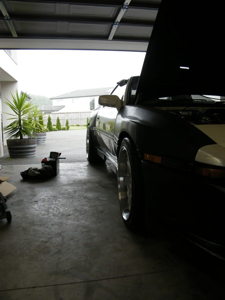

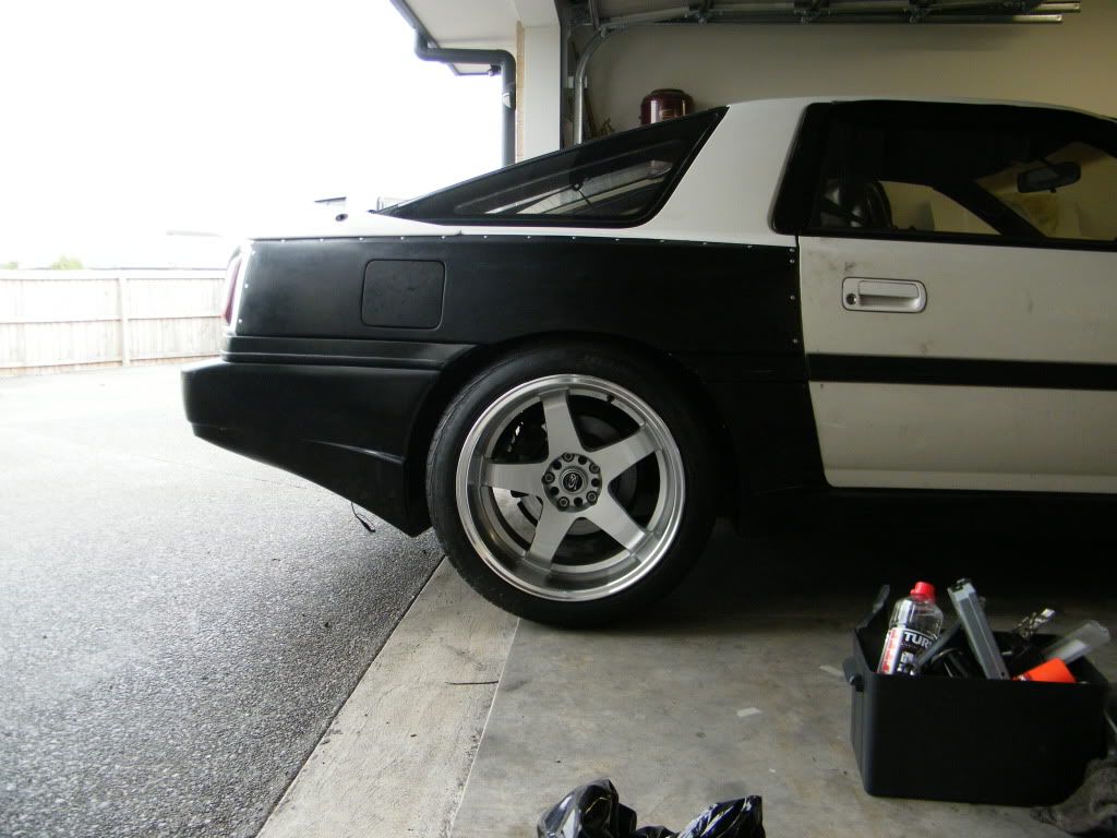

Cheers just got the otherside mounted removed the left hand blister and painted the underside so can properly attach that tomorrow then will do the same on the right hand side.
Trying to get the regulus sides to work is a little frustrating the bits that go up the body flare out about an inch at the top can pull them in but not sure how to keep it there also need to trim them around the door cause it hits.
So I pulled the stock rubber end cap off and flared that out that fills the gap nicely too and my bomex sides work so undecided with what side skirts to use the bomex looks like it may be the easiest but will have another play with the regulus ones with a fresh mind later they both look good anyway and I have bomex front and rear mmmmmmm decisions

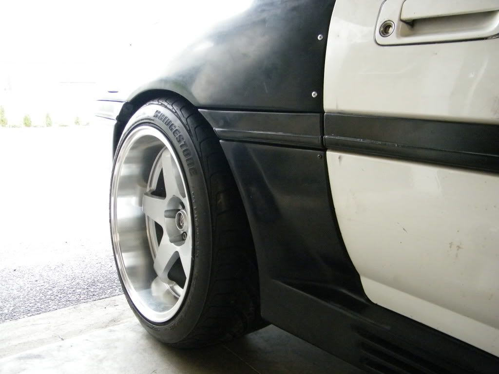

Yea I've cut out the guards already and sealed them all up so no rusty
As it stands I have 90mm clearance before the tyre rubs but may lower the car a little bit more

Were talking about the rear quarter pannels/ guard I have a build thread in the members rides section
I cut the top line 1st then just above the lip removed that section
Cut the lip off bashed the living crap out the the inner liner
Sectioned it bashed it some more ground down all sides cleaned etched primed then bent tabs over and then rivited them to the body
Cleaned/ground surfaces back again re primed then wend over the whole lot with window sealant making sure there was no holes/gaps for water to get in and cause rust
Obviously welding is a far better option if you look at mobes thread he has done his "properly" I have limited funds and resources and wanted to get this done not be one of those people that talks big buys the parts and never fits them
My car I'm sure with be the least pretty off the group buy list but I will also be driving mine this week which will be the 1st I'd say

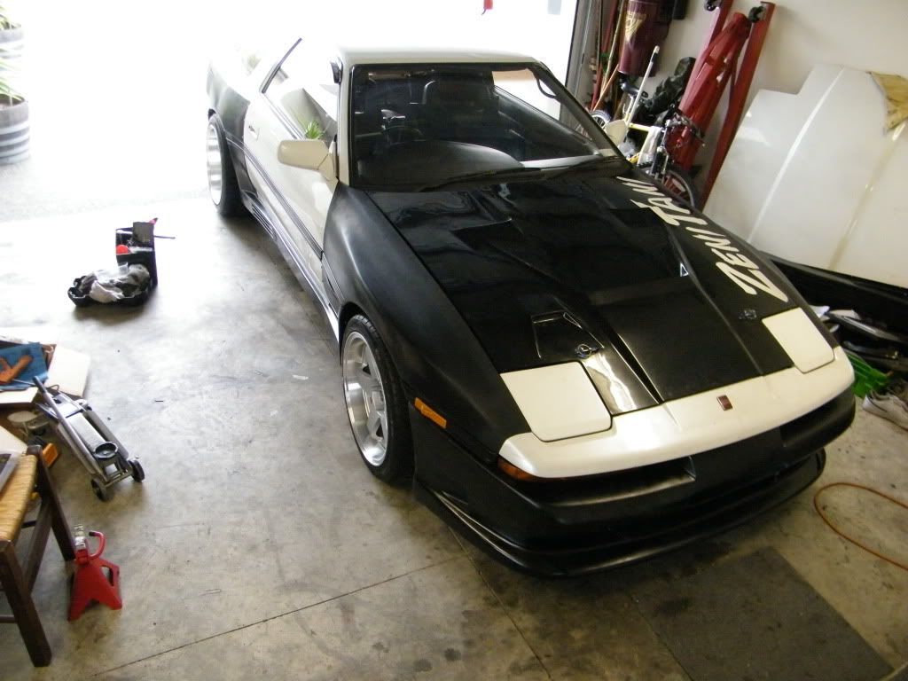

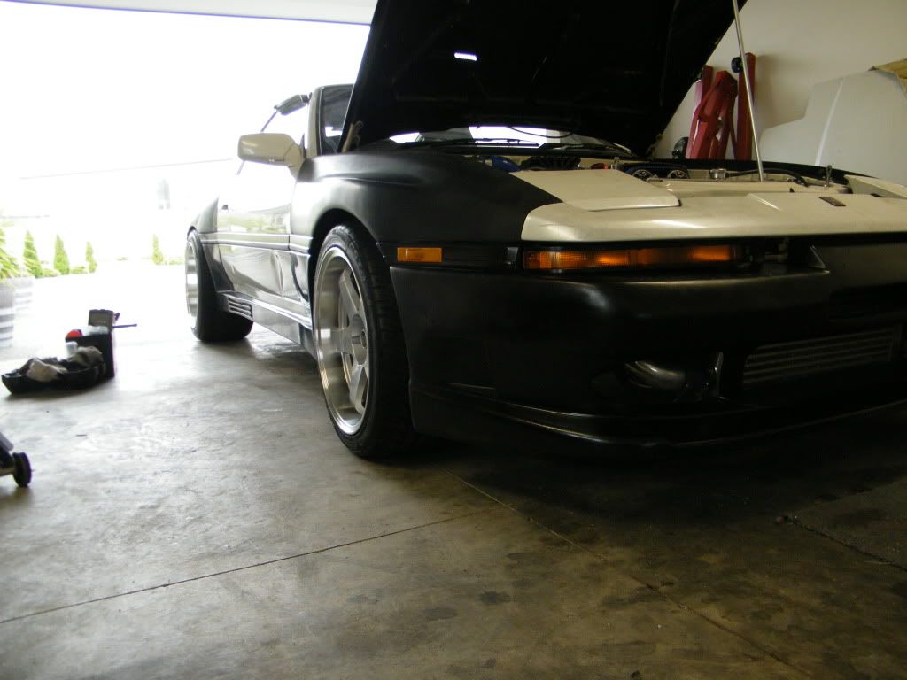

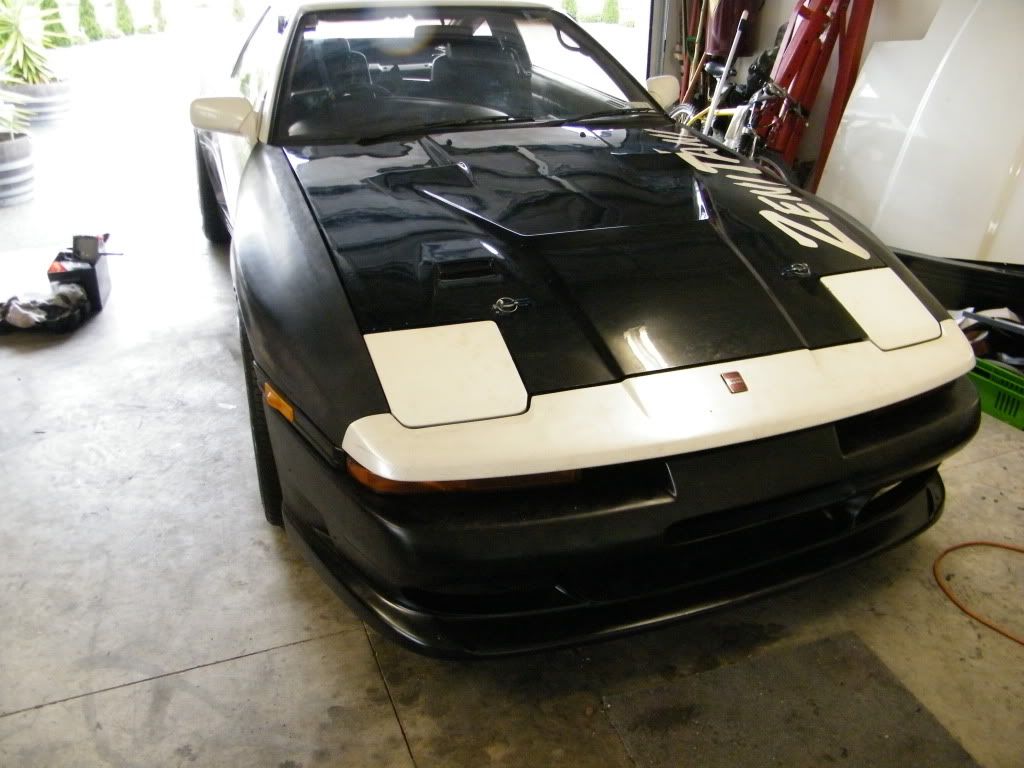

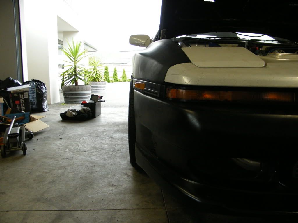

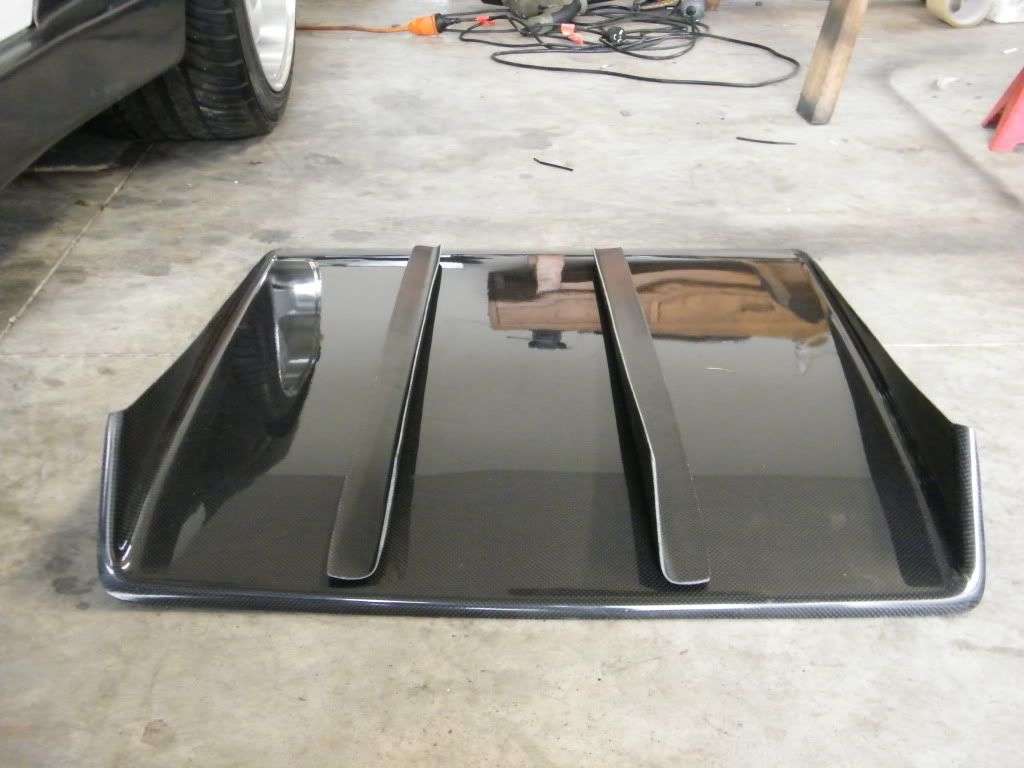

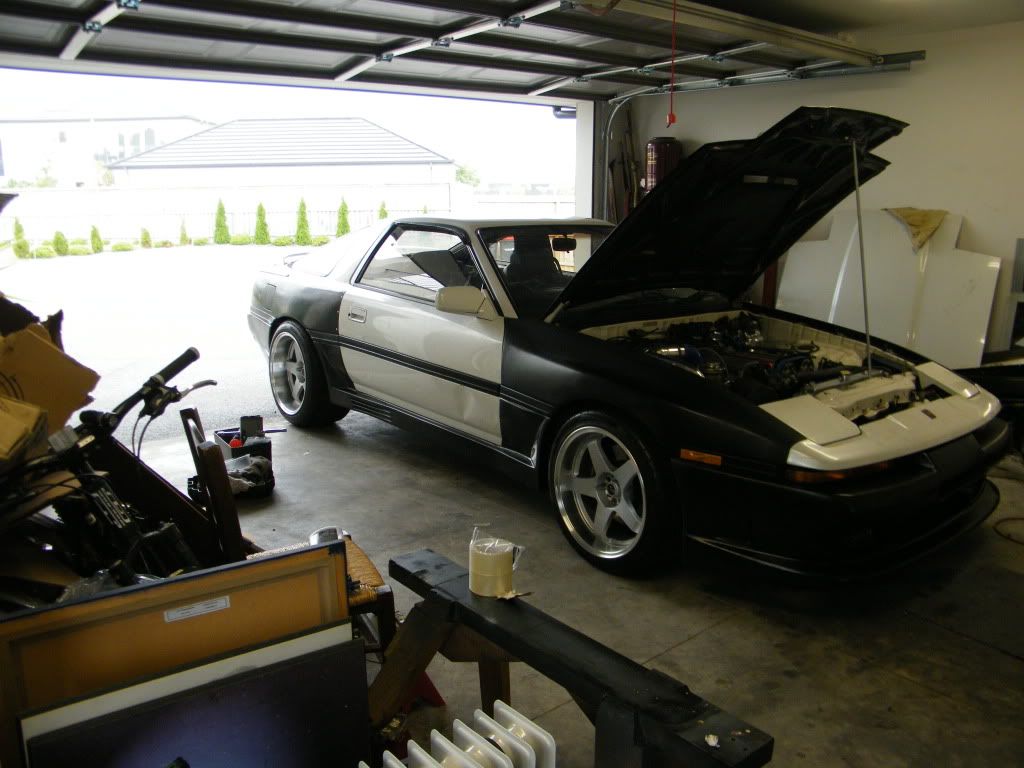

got A bit more done today pretty much just the left hand sideskirts and diffuser to go as far as "test" fitting is concerned will try to get atleast the skirts done tonite

By the way, the front and rear "tips" of the diffuser inserts, do they sit flush and follow the lines of the main part, or will you have to press them down when you fit them?

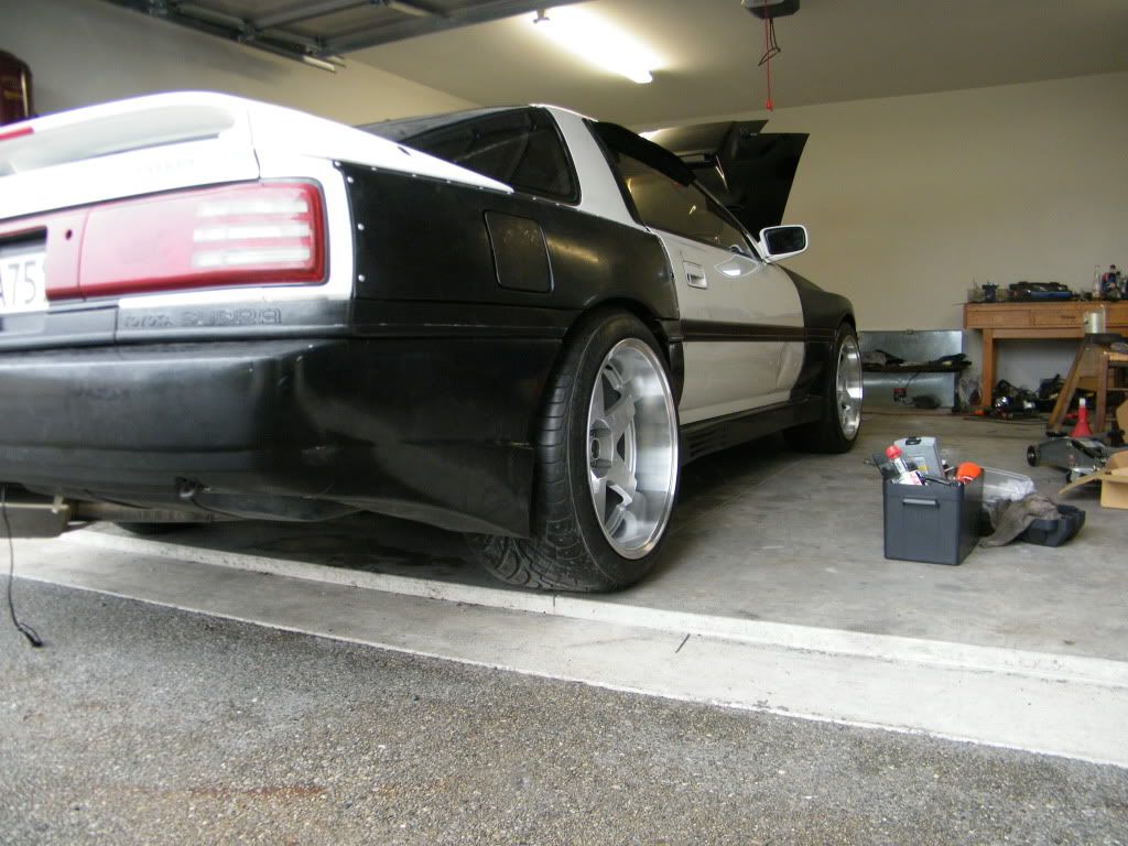

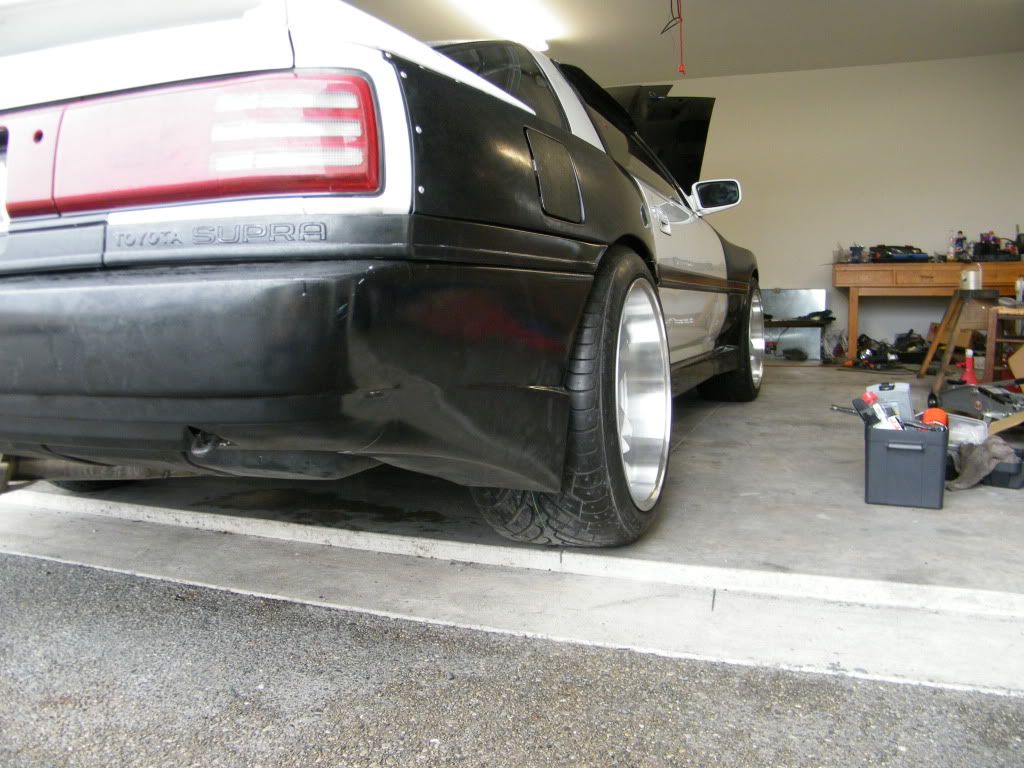

I'm extremely pleased at how well the sides/blister/rears flowed there obviously stretched out to suit IMO karmani would probly be the best suited to this kit for ease of fitment (never tryed just guessing)
I was apprehensive at the beginning about having a gap below the blister but pleased with the choice I've made now if I only got a slightly less aggressive offset wheel I may not get so many death stares from the police lol

reaper_mk3;1803964 said:
what are the wheel and tire specs pictured?
18x12 +0 offset 295/35/18 I have a bit of poke on the rear +10 offset might have been easier to get my car legal as we have rules against stretching ect here in NZ
