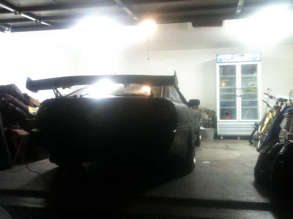

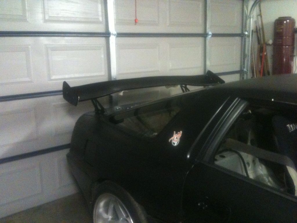

Those are what I run 18x10 +12p 18x12 +0p these photos there are no spacers if you wanted to run a full size tyre on the rear I would get the 18x12 +17p that they offer as my rears stick 12+ mm out of the widebody guards on the front could probly do with a 15mm spacer to have a more aggressive fitnent like the rear
As for lowering the teins in mine are 5mm off the lowest setting fine for street but I have a track day coming up which I will raise it for

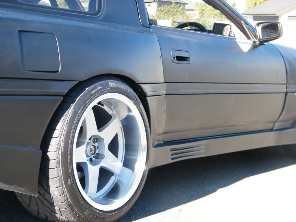

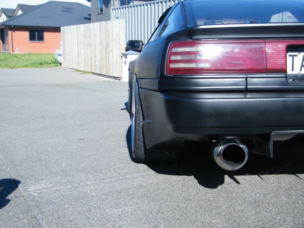

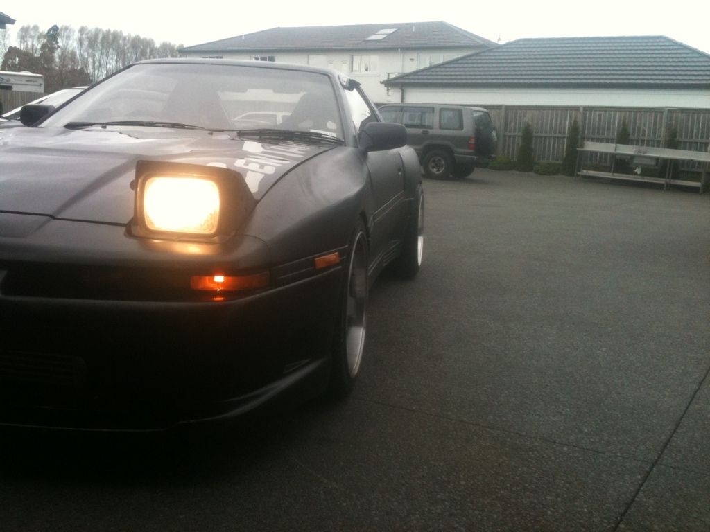

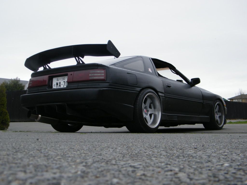

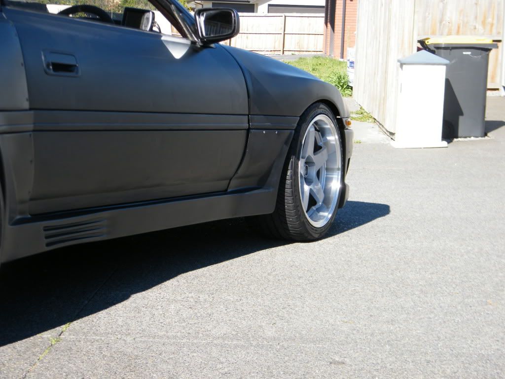

well seen as you are buying the same wheels as me and we have the same kit this IS how it will look
18x10 +12 265/35/18 - could easily run 275 if you wanted
18x12 +0 295/35/18
side shot of both
with the fronts anything more than the +12 offset you will regret as for the rears with the 0 offset 12's the biggest tyre you can run is a 295 so I really wish I got the +17 offset so I can run a 315 because were im from it is illegal to stretch tyres so I have to use different wheels for 6 monthly vehicle checks
I hope this helps also the higher the car/ less camber you run the wheels will stick out farther at the top I have -2g camber on the rears at -.05 camber and about 1" higher it looked quite mexican
