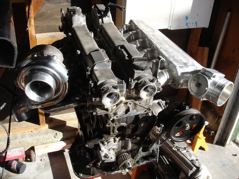

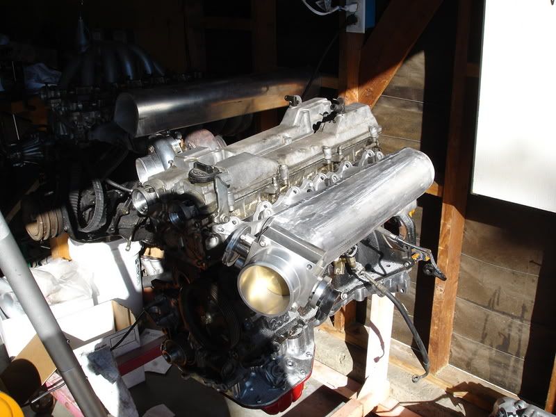

I just built one for a friends NA-T MK4. It wasnt quite finished in these pics. It has billet velocity stacks and a 90mm TB.
