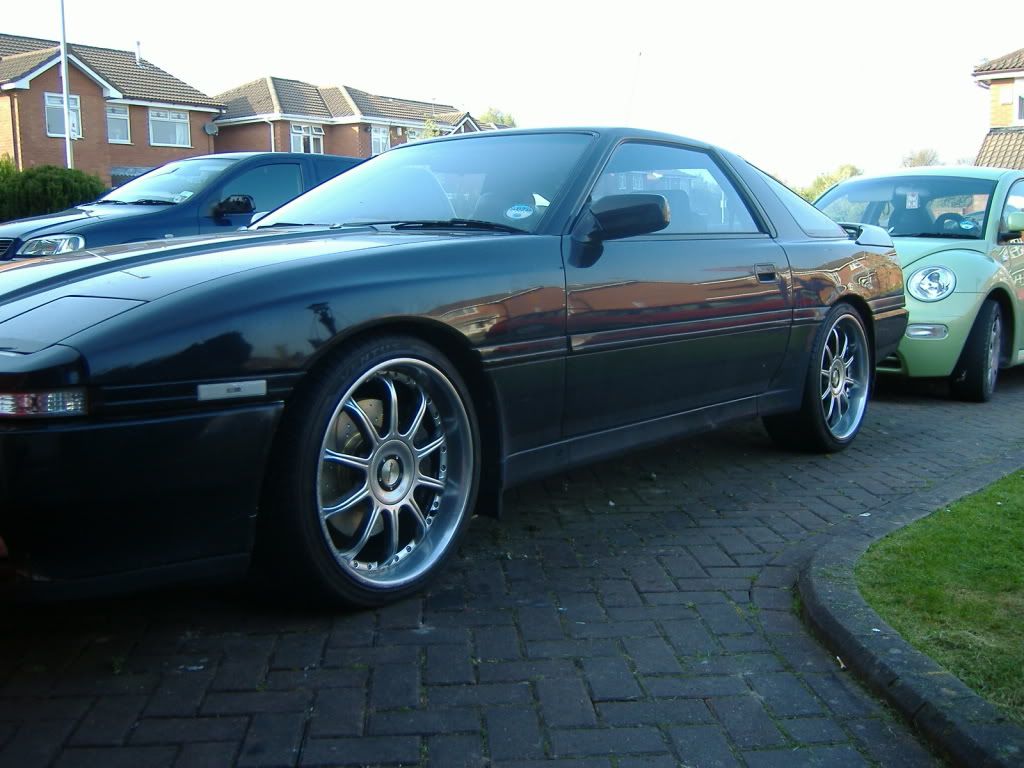

19 x 8.5 front +30 19 x 9.5 rear +40

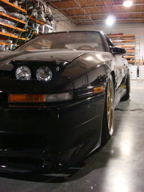

Below is my car, though we have different diameters and widths, our wheels stick out of the car the same distance. I intended for my car to be low, so I had to make my car fit the wheel.
The rear wheel on this car is 10.5+18,which has 265/30/19. My fender was rolled, then flared out. (The suspension also has a negative camber. For your wheel, you'd run 265/35/18
The front wheel below is 9.5+24 has 235/35/19. Again, the fender was rolled then flared out and the suspension has negative camber. For your wheel, you'd run 235/45/18
