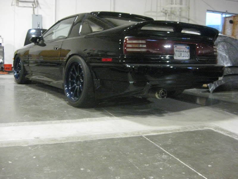

Amar;1293250 said:
18x9 +9 & 18x11 +20:icon_evil
Whaddya think:naughty:
19x9.5+24 front 235/35/19
19x10.5+18 rear 265/30/19

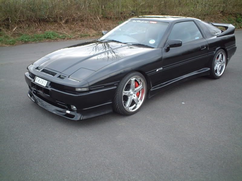

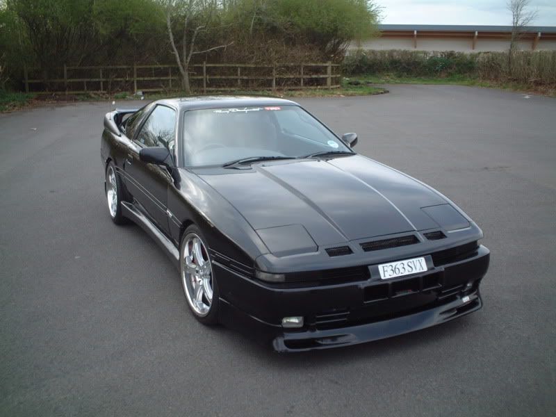

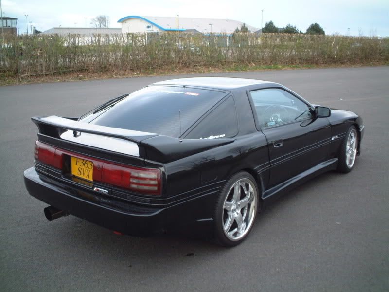

Thought i would add mine to this since i have a new set on these days.
Fitment is 19/8.5 on the front with a +30 offset. Tyres are 235/35/19.
Rear is 19/10 with +35 offset. Tyres are 275/30/19.
Had some minor rubbing with this set up but did a small amount of arch work on the rears to cure it.

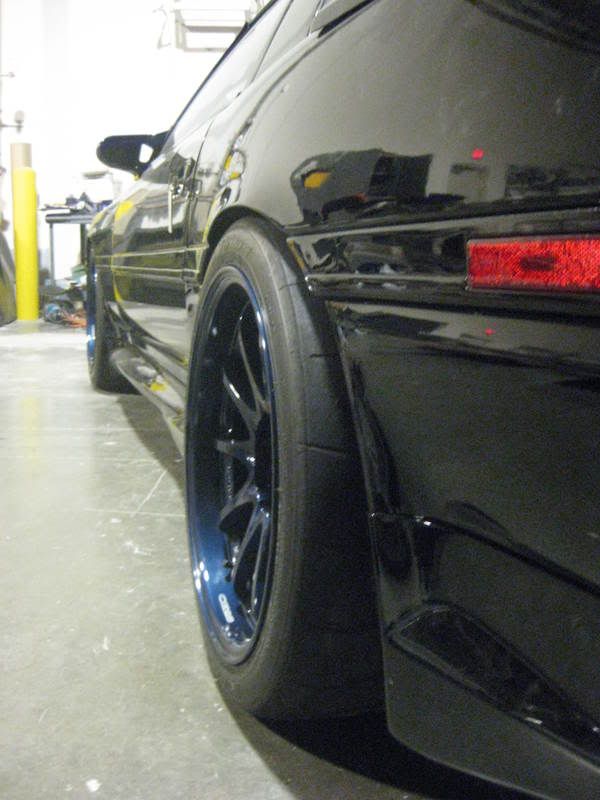

Amar;1293635 said:
I was thinking 275's......After looking at Rodel's post with the 19X10.5 +18 in the rear, I don't think I can make 18X11 +20 work without fender pulling, and i don't wanna do that.

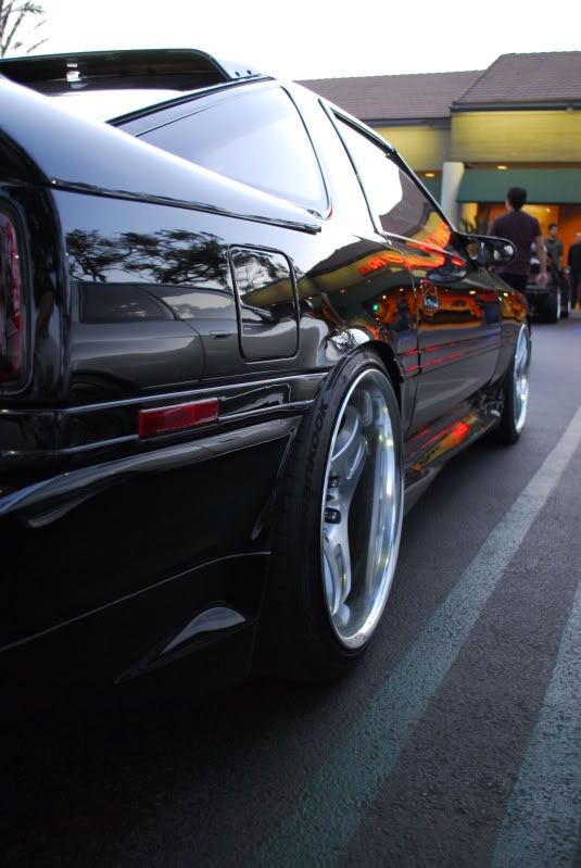

Here's a better perspective:
18x10.5+22 with 275/35
19x10.5+22 with 245/40

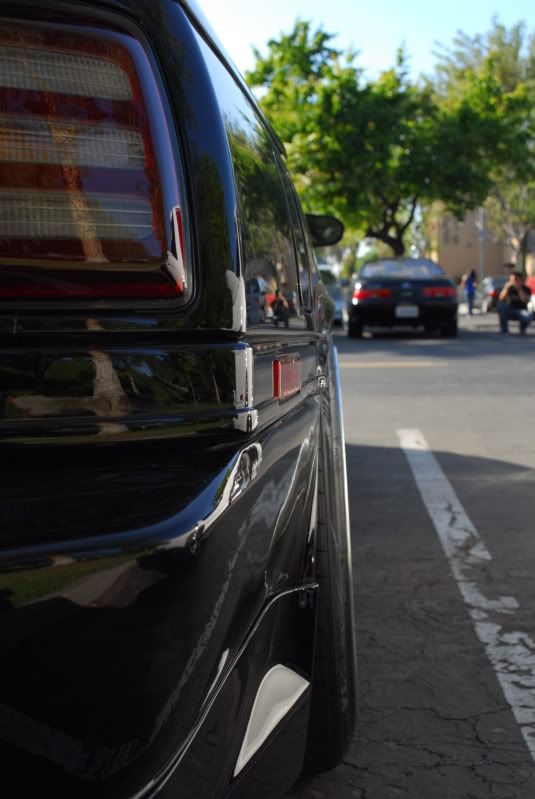

:bowdown:Nice fitment....This is the similar to what I'm looking to accomplish, but you pulled the front and rear fenders, correct?

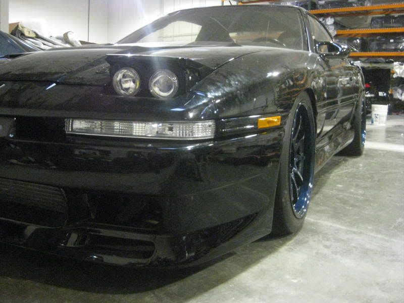

The front and rear fenders are "flared"
Here's the front BTW, 18x9.5+22 with 245/40/18 tires
