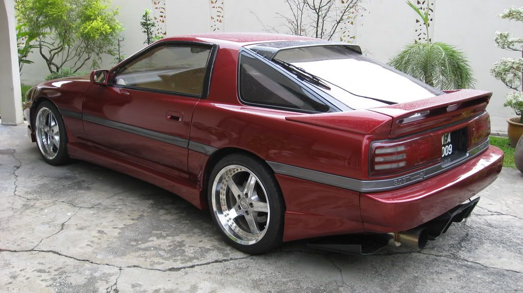

HIDPLANET
89 1JZGTE
Front: Volk GT-C 18x10 +30 235/40/18 Falken Azenis RT-615
Rear: Volk GT-C 18x10 +24 245/40/18 Falken Azenis RT-615
In retrospect, I should have put 245s up front as well. The 235s are too stretched and slightly rub the inner fender at full lock just as the 245s would...I thought they would clear.
Pictures were taken PRE Coilover adjustment so it will be a little bit lower but not much.
Your car looks amazing. I'm not a fan of the stretched tire look, but the body and the rims themselves are very sexy!
